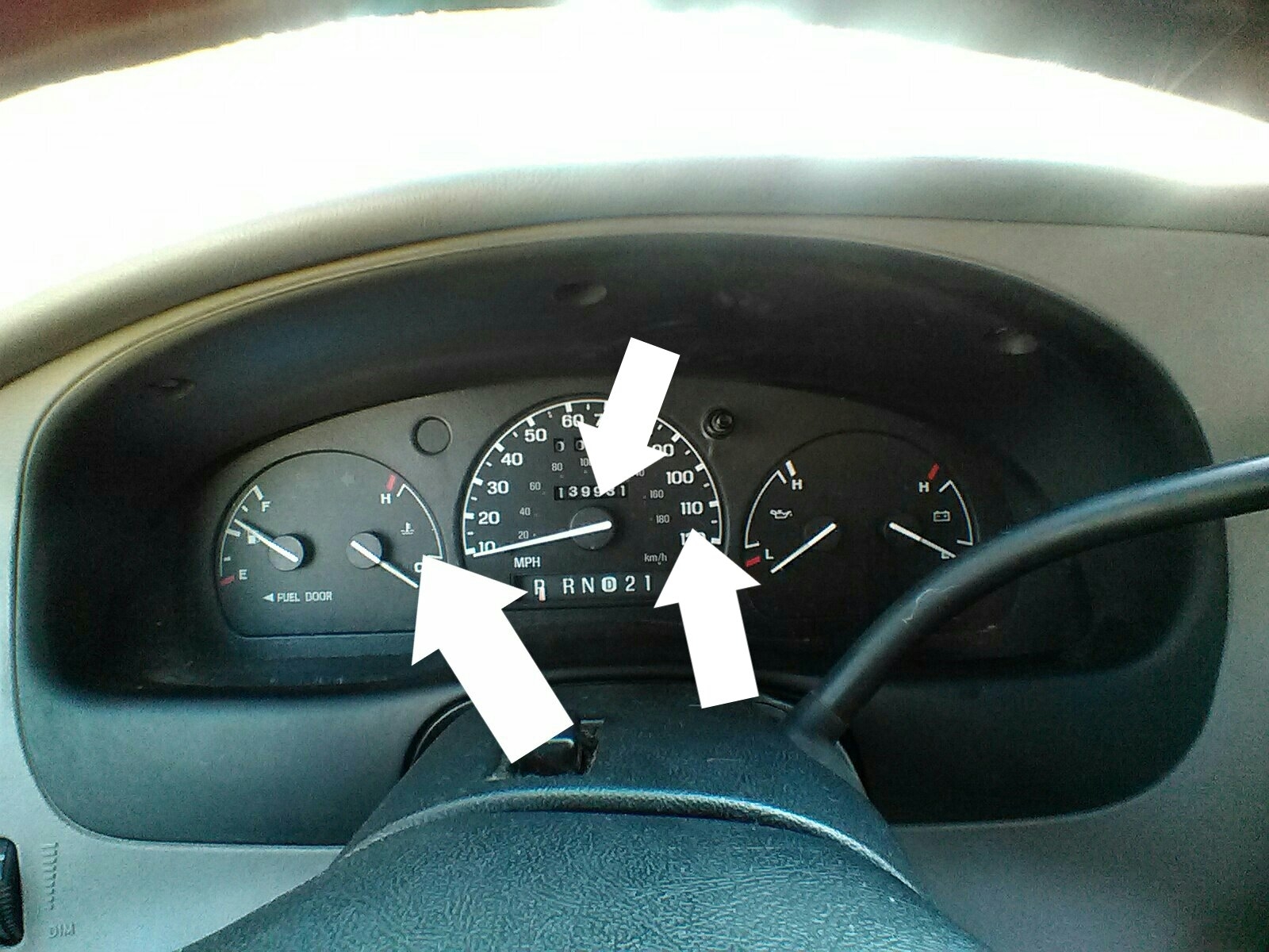

Radio is not working, temperature gauge is not working, speedometer is not working.Everything else is working.

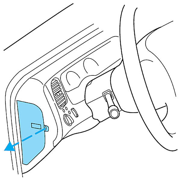

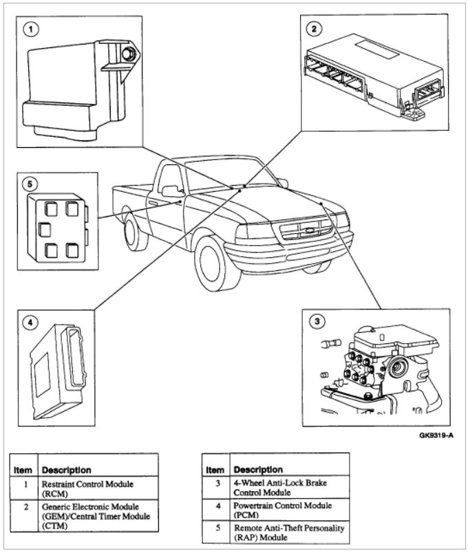

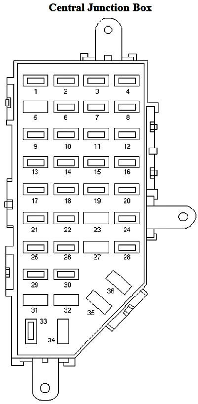

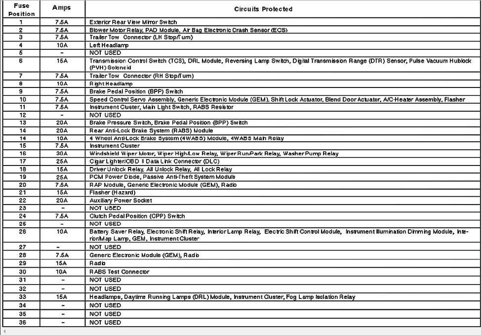

Check your fuses. I am including some pictures. The first shows the location of the fuse box. The second is a legend, telling you which fuses power which systems. The third shows a layout of the box. The forth is a comparison of a good fuse and a blown fuse. I would definitely check numbers 11, 15, and 33.
Just pull out the fuses and look at them. Replace any blown fuses. Let us know what you find.

Well it's possible that one is blown but looks ok. In that case you would either (1) just change them with new ones or (2) use a multimeter to check continuity from one terminal of the fuse to the other. Using the ohms function, if you get an infinite reading, then the fuse is blown. Only other possibility is a wiring issue of some sort. We'd have to do some serious digging to look into that. I'll do some more thinking while I work on other stuff and let you know what else I come up with

These trucks had a problem with the GEM module which is located in the dash and it sounds like your has gone out. Here is the location.

Please check the GEM

As Ken stated, check the GEM module. He has included the pertinent information in an earlier post. He's probably right.

My daughter and me took the dash apart today there is no cable connected to it and no place for to go everything is plugged in as it should be still and still not working , I found the GEM how do I find out if it's working or not

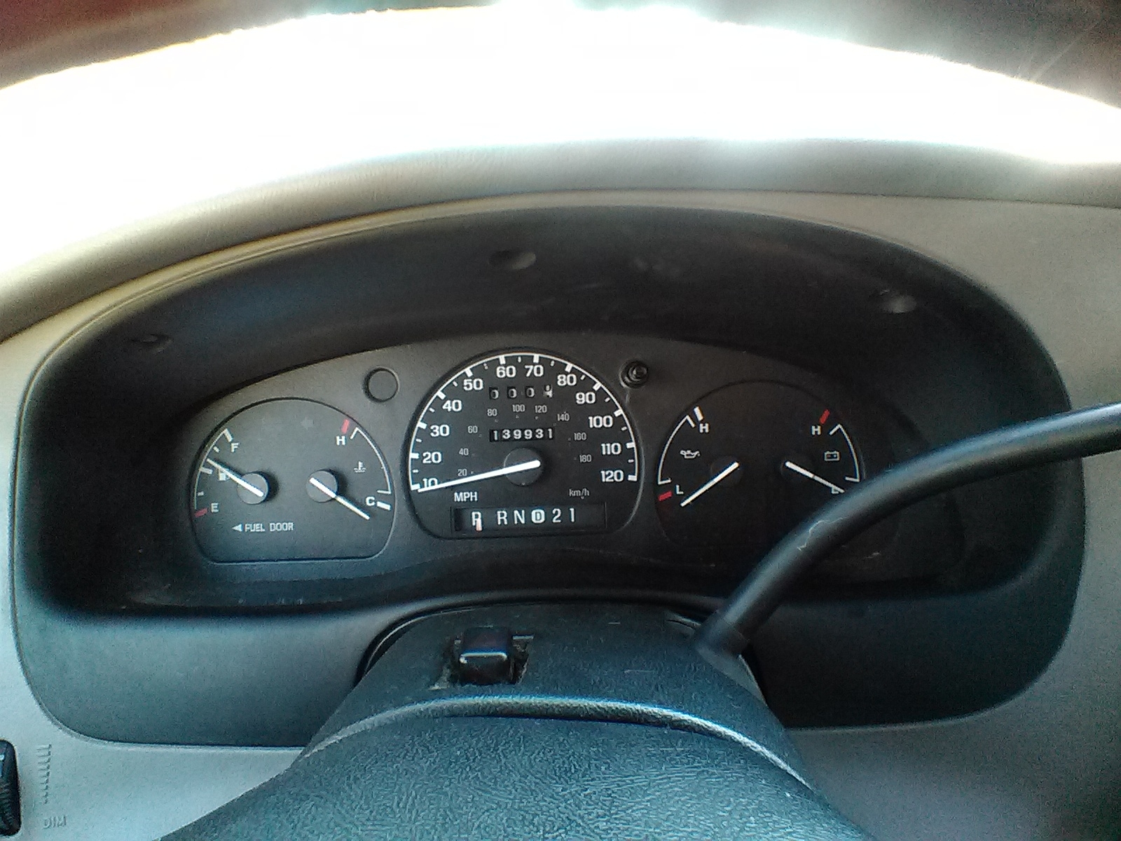

I replaced to cluster still not working I'm not sure but I believe someone had already replaced mine I think it's the wrong one what is my different person look like here's what's in there now when I Google it shows me a different one

No but can it be tested do I have to do any reprogramming? I think someone took the cluster out before because have marks on it one marker and they cluster says 99 one we went to pool and pay for my year( 2000 )it was a total different cluster
Mar 9, 2018 at 5:21 AM
  • 55,433 POSTS
The cluster much look the same to work the GEM does not need programming.
Mar 9, 2018 at 5:26 AM
BARBARA ERSKINE
  • 11 POSTS
How do I know what the word gonna look like I believe my has been replaced before because when I go to the pool and pay all the 2000 look different than mine the part that I found came out of the 95 just like mine does not work .how do I find out what the original cluster in a 2000 Ford Ranger looks like? I am not the original owner
Mar 9, 2018 at 6:30 AM
  • 55,433 POSTS
It depends on the trim package here is a search i did which shows the different ones.

Are you 100% sure it's a 2000? Post the VIN here and we should be able to see exactly what it is and maybe if it's a 2000 instead of a 2000.5 (sometimes they release an updated model in the middle of the model year).
Mar 9, 2018 at 10:27 AM
BARBARA ERSKINE
  • 11 POSTS
1FTYR10C5YPB16676
Mar 9, 2018 at 11:58 AM
BARBARA ERSKINE
  • 11 POSTS
my ven number is 1FTYR10C5YPB16676
Mar 9, 2018 at 12:21 PM
HARRY P
  • 2,292 POSTS
OK so it definitely is a 2000. I can't find any evidence of there being a 2000.5 Ranger, so the difference in gauge clusters is likely just from different trim levels. For example, the XLT with an automatic transmission has a different cluster than the base Ranger with a manual transmission. Basically, you're going to have a hard time just walking up to a Ranger and just pulling it and going. You might have better luck looking on ebay for a cluster and matching one up to yours.
