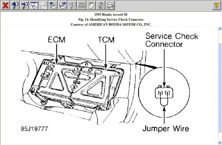

KHLOW2008
  • 41,814 POSTS
Hi kennyd42,
When the D4 light shows and would not go off,the TCM is most likely to be faulty or there is some shorting of wire circuits.
See if you can retrieve any Diagnostic Trouble Code by bridging the SCS connector.
https://www.2carpros.com/forum/automotive_pictures/192750_SCS93Accord_3.jpg
-1
