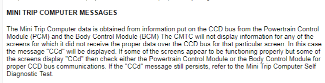

My compass temperature and trip display just went black
2000 CHRYSLER SEBRING
170,000 MILES • 4 CYL • 2WD • AUTOMATIC
CINDIQ
How do I fix it? is there a fuse to change out?
Thank you!
Aug 8, 2019 at 12:37 AM

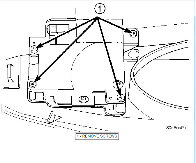

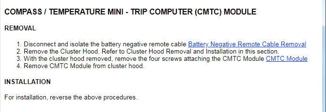

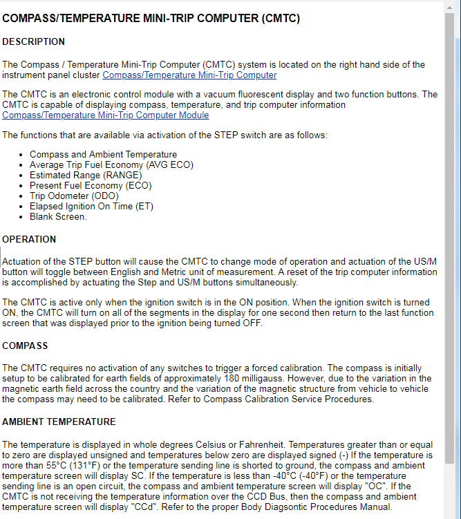

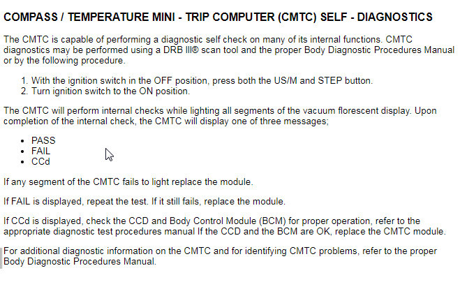

Here is the information on this module. There is a test that needs to be performed. Unfortunately, this is done with the scan tool called the DRB III. If you don't have access to one, I would think that the safe bet is this module has failed.
Please let me know if you have questions. Thanks
