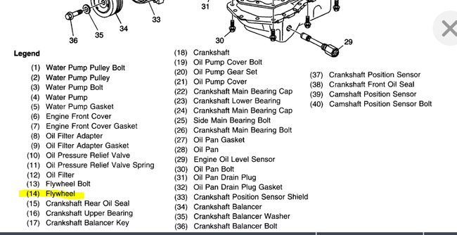

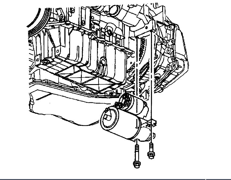

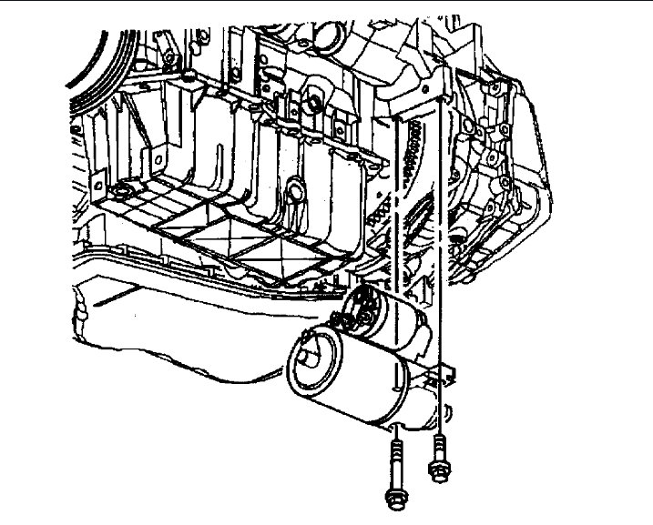

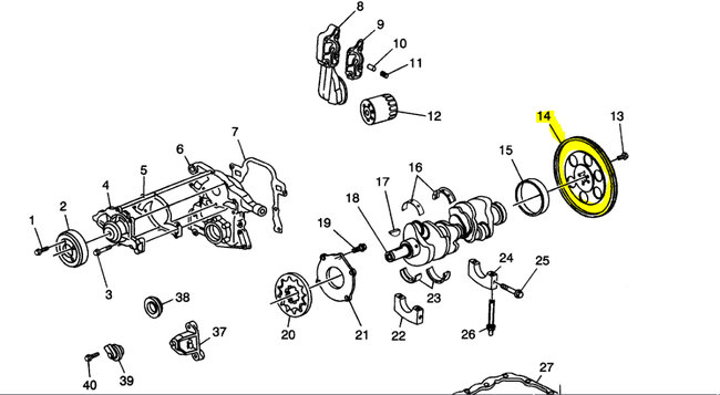

Was told the flex-plate needed replaced. but it was driven then a loud clank was heard now car wont start.
Aug 4, 2020 at 9:08 AM (Merged)
SCGRANTURISMO
  • 4,897 POSTS
This could be a problem with your vehicle's flywheel. If the teeth on your vehicle's flywheel are the teeth on the Bendix gear of your vehicle's starter, neither will mesh with the other and your vehicle will not start. The best way to check this is to remove your vehicle's starter and inspect the flywheel and the starter teeth. In the diagrams down below I have included an exploded diagram of your vehicle's crankshaft and associated parts with the flywheel highlighted for you, as well as step by step directions for the removal and installation of the starter.
Please go through these guides and inspect both the flywheel and starter and get back to us with what you are able to find out.

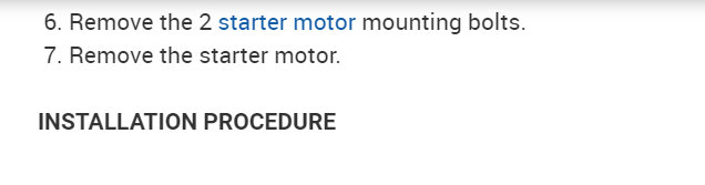

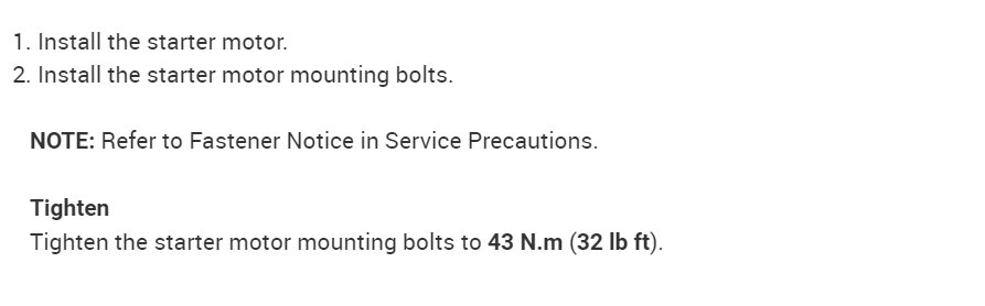

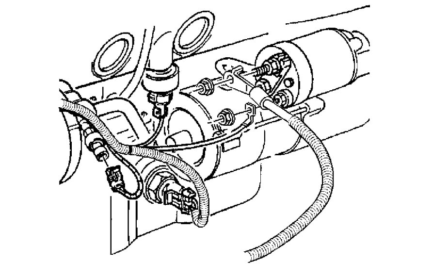

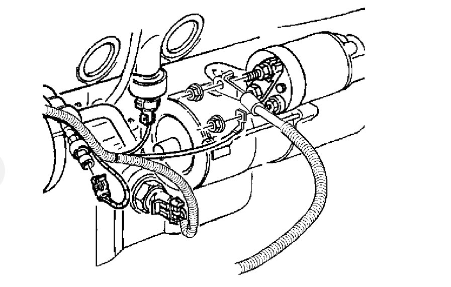

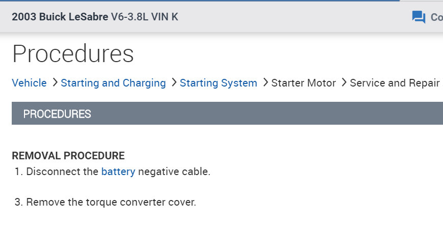

If two terminals at the relay were hot, then the computer may not be grounding the relay. The computer gets a crank sense signal from the ignition switch, tells the computer to ground the relay.
Aug 4, 2020 at 9:09 AM (Merged)
CBTENNESSEE
  • 5 POSTS
tried that and it sat for 20+ minutes and security message stayed on and the light flashed the whole time
JDL
  • 16,098 POSTS
https://images.2carpros.com/forum/automotive_pictures/170934_buick_lesabre_1_1.jpg
https://images.2carpros.com/forum/automotive_pictures/170934_buick_lesabre11_1.jpg
As far as a relearn procedure, the above is all I have.
