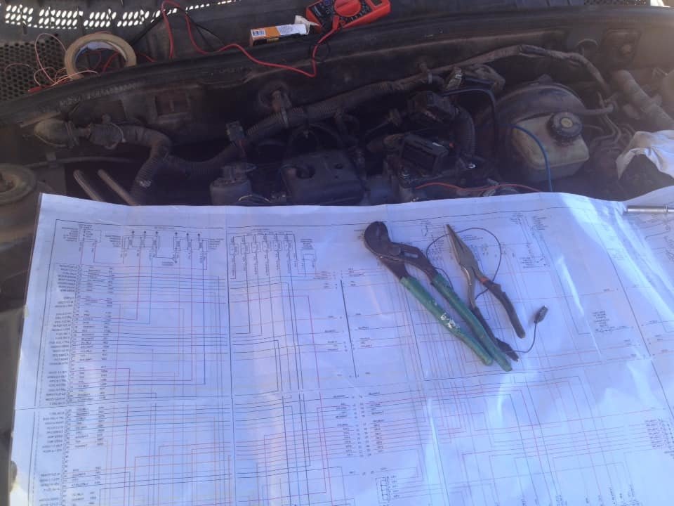

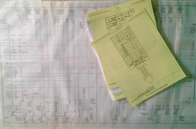

Took the measurement form the TPS harness on the brown and yellow wire. i have the full diagram of the Saturn, soy made some test according to the cars manual, i don't remember right now the exact voltage, i guess 4.5 to 6 on brown wire and 2 more or less on the yellow wire. i tried to check the obd2 connector its a SAE J1850 VPW, last scanner show U2106 code, it is a problem with communication to ECM. can you help me? thank you. :) below shows you a picture of the connector and the diagram.

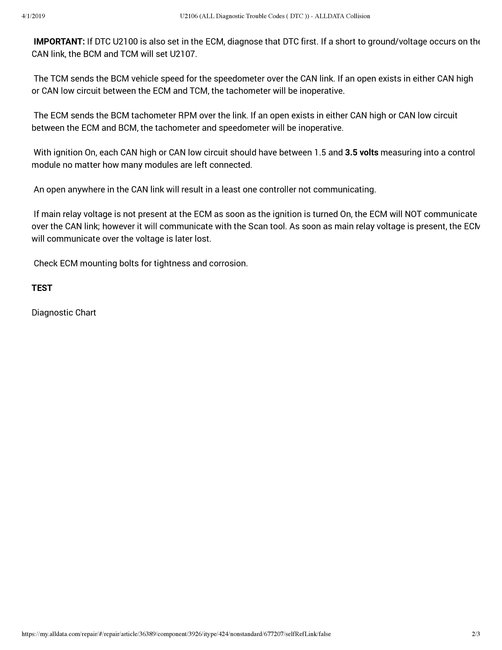

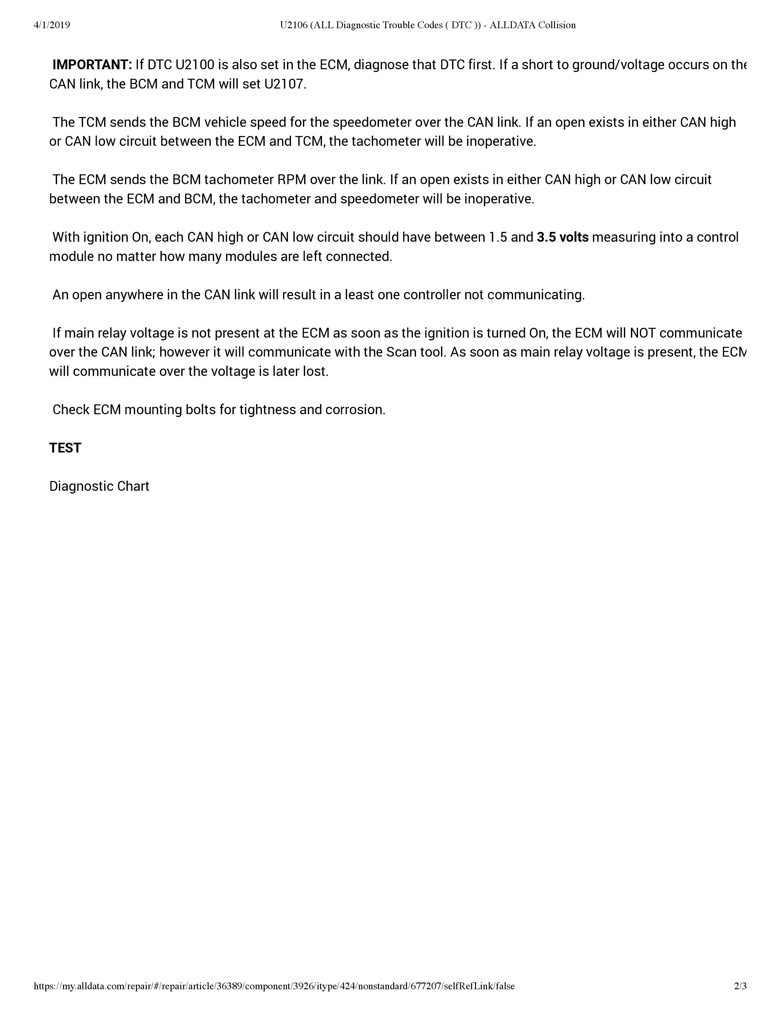

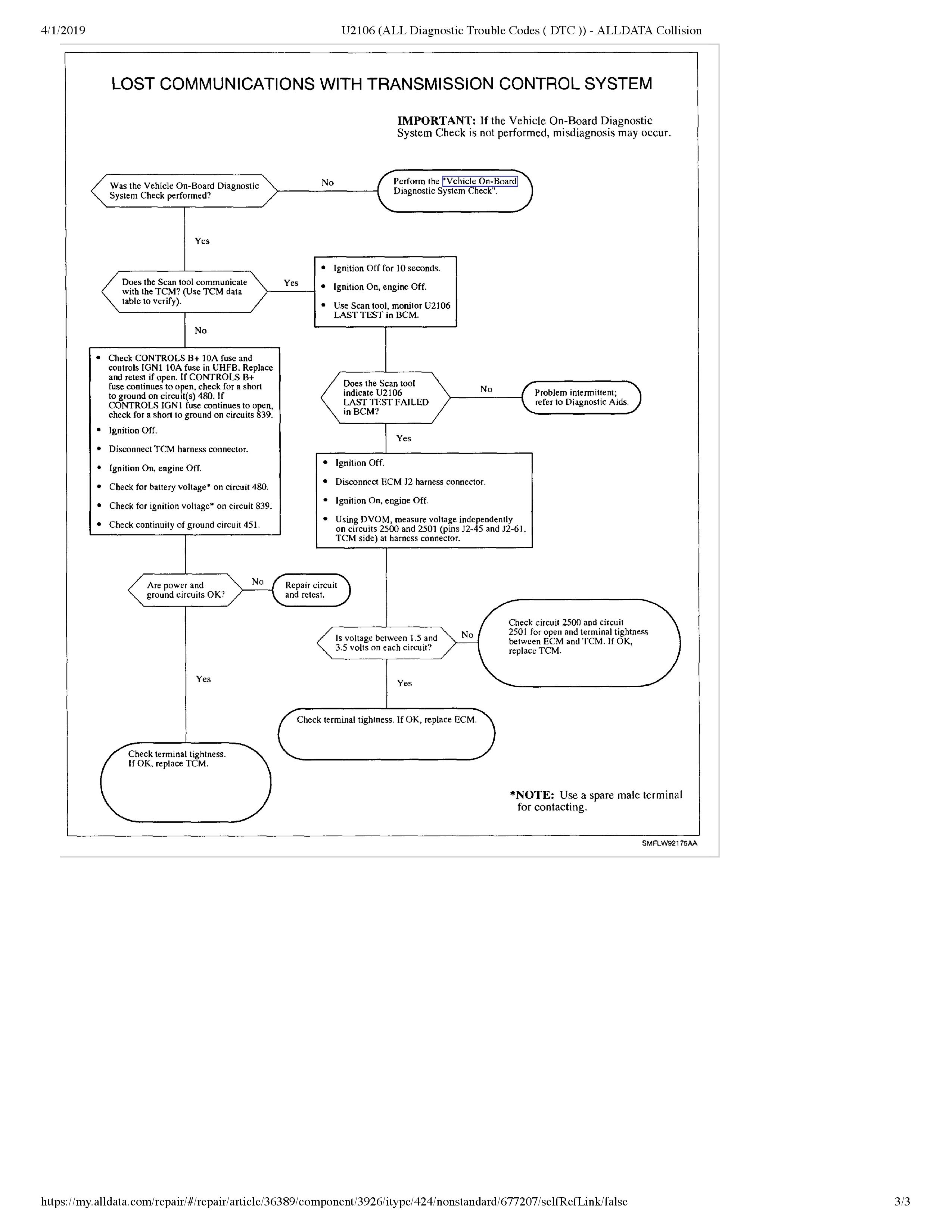

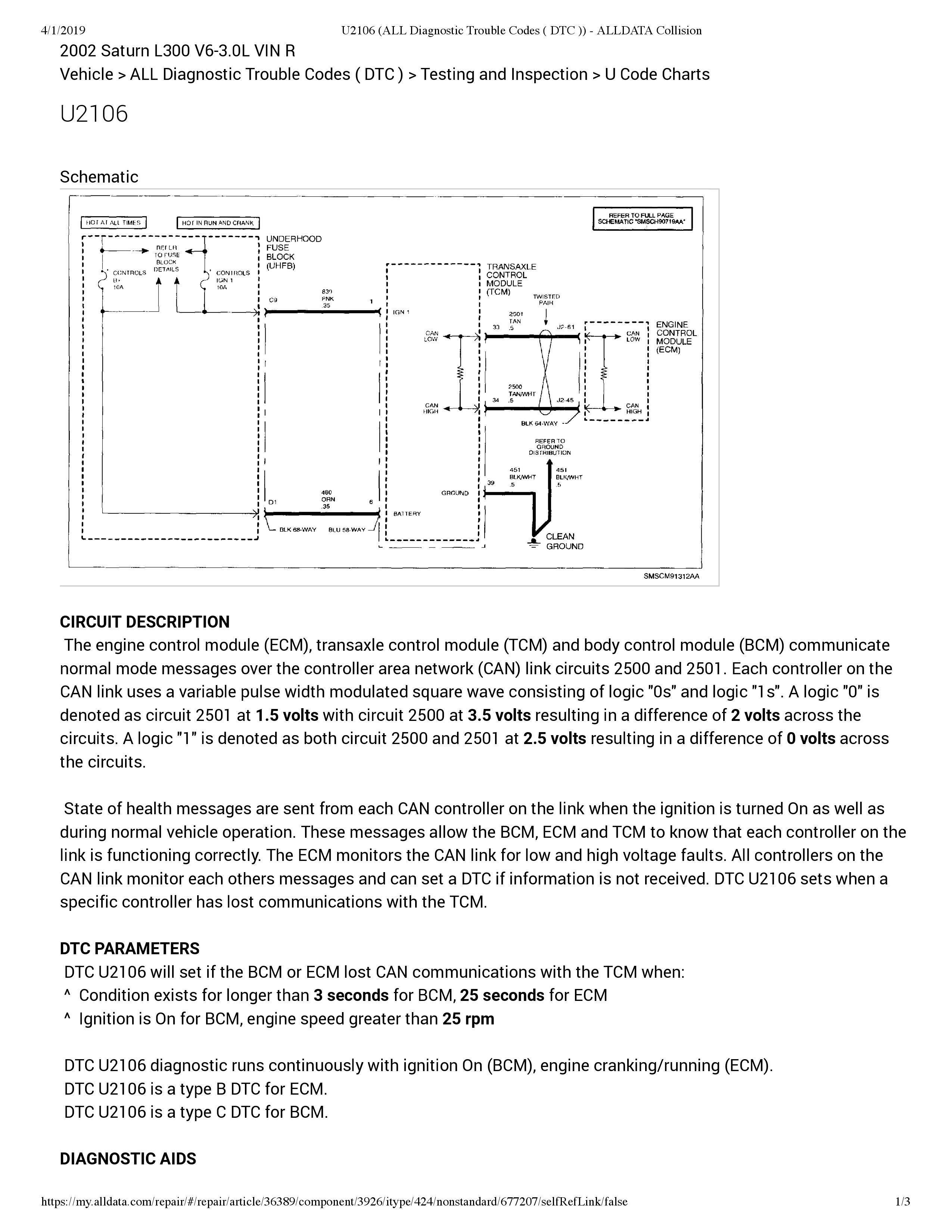

It looks like the U2106 is a communication code for loss of signal from the TCM.
The TCM communicates with the BMC and ECM and when there is a missing message it logs this code.

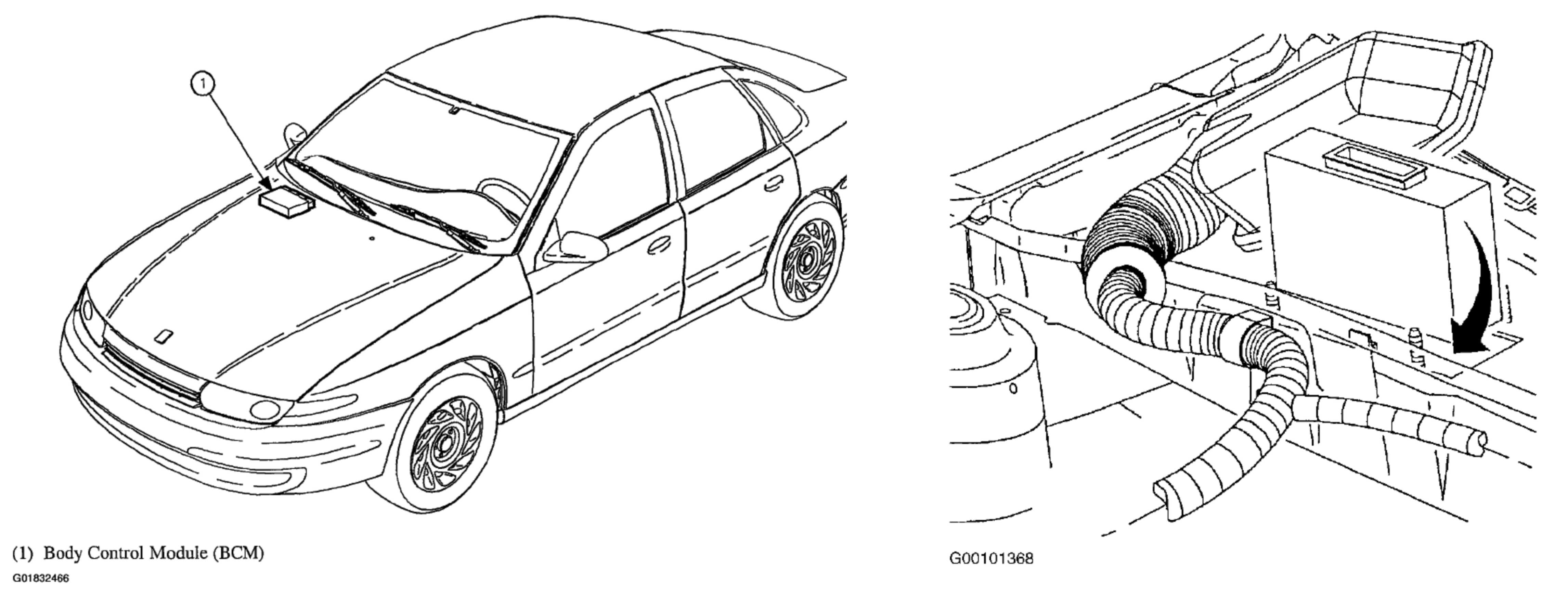

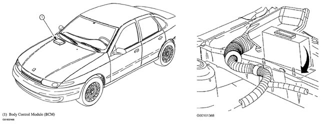

The first thing to do is to check the fuses, power and ground to the ECM,TCM and BCM to ensure all are present.
I have attached a diagnosis guide for the U2106 code.
Is this the only code you have stored?
Regards, Joe
