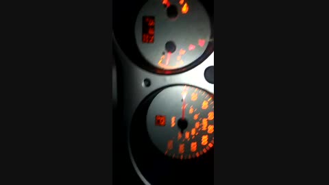

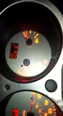

KMB24
  • 19 POSTS
Here is a video:
Mar 7, 2019 at 9:54 AM
  • 110,251 POSTS
Welcome back:
The engine sounds great, but I do see a slight delay on the restart. Honestly, that could simply be a fuel pressure related issue. Based on what I heard, I wouldn't be afraid to drive it.
