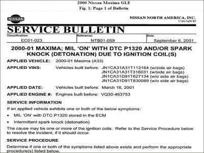

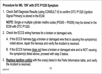

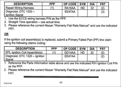

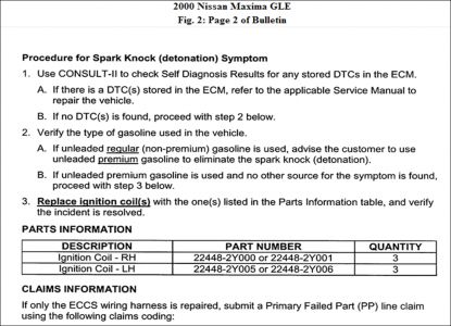

Hello - Thanks for the update. I have been searching through some TSBs on your car and came across this one. It does talk about the coils for ping. See below... TECHNICAL SERVICE BULLETIN Reference Number(s): NTB01-059, Date of Issue: September 6, 2001 NISSAN: 2000-01 Maxima CLASSIFICATION: EC01-023 SECTION: Engine Control System APPLIED VEHICLE: 2000-01 Maxima (A33) APPLIED VINS: Vehicles built before: JN1CA31A31T112164 (w/side air bags); JN1CA31A31T316031 (w/side air bags); JN1CA31D91T627134 (w/o side air bags); JN1CA31D91T830089 (w/o side air bags) APPLIED DATE: Vehicles built before: March 16, 2001 APPLIED ENGINE #: Engines built before: VQ30-463753 Related Ref Number(s): NTB01-059 ARTICLE BEGINNING DESCRIPTION 2000-01 MAXIMA; MIL ON WITH DTC P1320 AND/OR SPARK KNOCK (DETONATION) DUE TO IGNITION COILS BULLETIN CONTENT
https://images.2carpros.com/forum/automotive_pictures/248015_1_173.jpg
https://images.2carpros.com/forum/automotive_pictures/248015_2_115.jpg
https://images.2carpros.com/forum/automotive_pictures/248015_3_80.jpg
https://images.2carpros.com/forum/automotive_pictures/248015_4_54.jpg
I wouldn't do the computer yet............Lord willing this bulletin about the coils it the answer.
