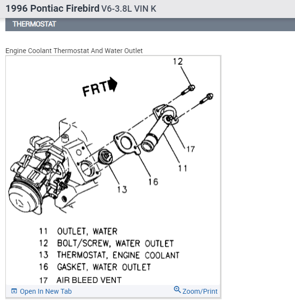

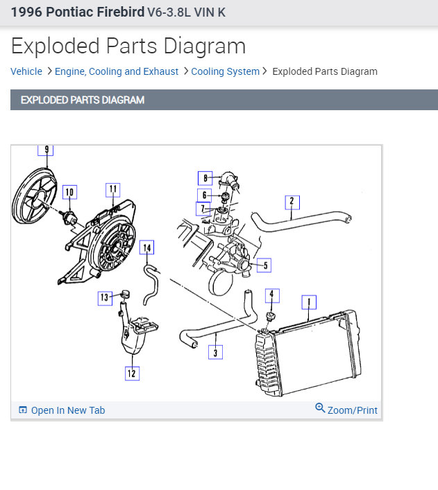

An engine can overheat due to a stuck closed thermostat, which can fail without warning. Also due to a bad water pump, faulty radiator, inoperative cooling fan. It can also overheat simply being low on coolant.
Have you made sure the coolant is at the correct level?
When the thermostat fails in the closed position it will prevent coolant from flowing, which will lead to the engine overheat fairly quickly. Typically, with a stuck thermostat there will be noticeable temperature difference between the upper and lower radiator hose.
Here is a helpful guide that covers the typical overheating issues:
https://www.2carpros.com/articles/engine-overheating-or-running-hot
Go through this and let me know what you find or if you have any questions.
