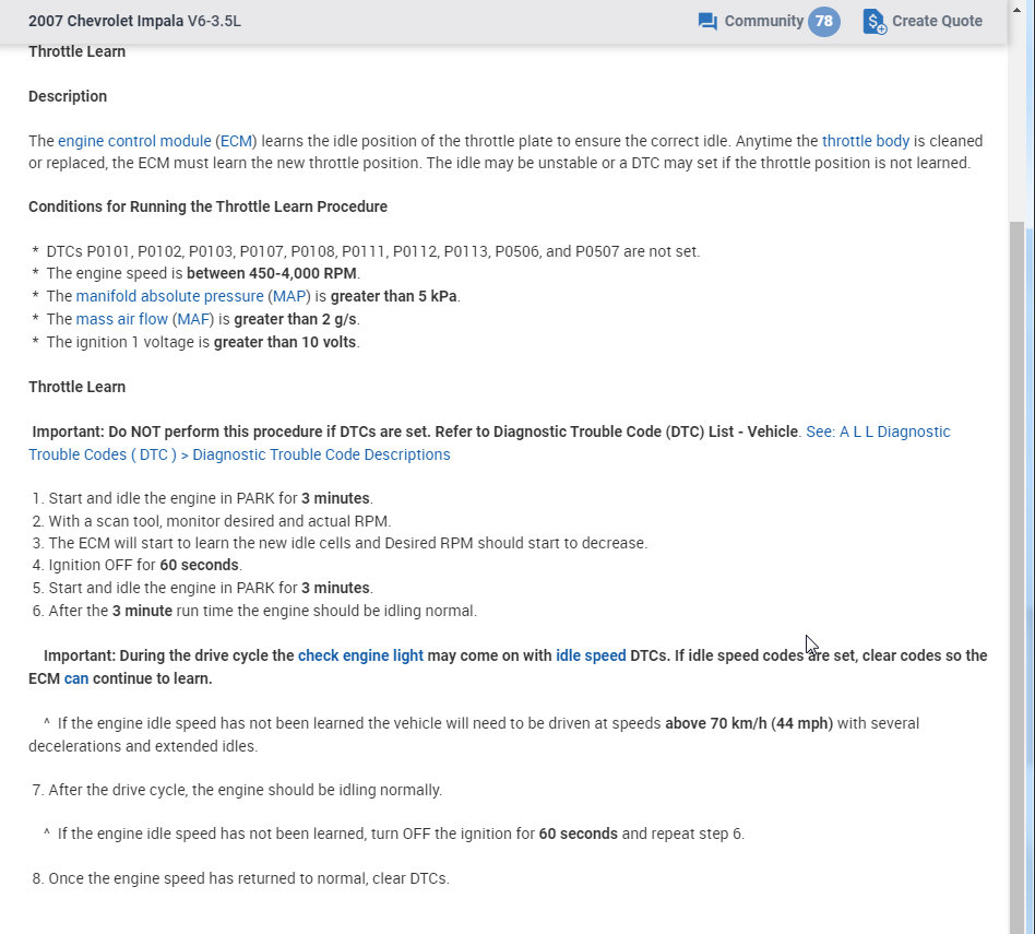

There are a couple things that this could be. Most likely you have a vacuum leak. It is odd that it would only set one bank for the lean code, but I would start with this:
The next thing is a possible throttle issue. However, your vehicle has an electronic throttle so it may just need to be cleaned.
I attached the info on this code as well. You could have an issue with an o2 sensor.
Run through this material and let me know what you find. Thanks

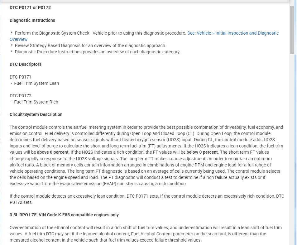

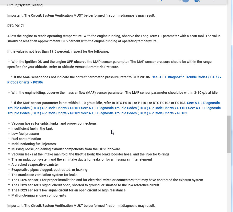

Check for any of the following conditions:
a) An incorrectly routed harness. Inspect the MAF sensor harness to verify that the harness is not routed too close to the secondary ignition wires or coils, solenoids, relays or motors.
b) A low minimum air rate through the sensor bore may cause this DTC to set at idle or during deceleration. Inspect for any deposits on the throttle plate or in the throttle bore and any vacuum leaks downstream of the MAF sensor.
c) Inspect for any contamination or debris on the sensing elements of the MAF sensor.
d) Inspect the air induction system for any water intrusion. Any water that reaches the MAF sensor will skew the sensor and may cause this DTC to set.
e) A wide open throttle acceleration from a stop should cause the MAF sensor parameter on the scan tool to increase rapidly. This increase should be from 3-10 g/s at idle to 150 g/s or more at the time of the 1-2 shift. If the increase is not observed, inspect for a restriction in the induction system or the exhaust system.
f) A skewed or stuck TP sensor.
g) A skewed or stuck ECT sensor.
h) The barometric pressure used in calculate the predicted mass air flow value is initially based on the MAP sensor at key ON. When the engine is running the MAP sensor value is continually updated near Wide Open Throttle (WOT). A skewed MAP sensor will cause the calculated mass air flow value to be inaccurate and may result in a no start condition. The value shown for the MAP sensor display varies with the altitude. With the ignition switch in RUN position
and the engine OFF, 101 kPa is the approximate value near sea level. This value will decrease by approximately 3 kPa for every 1000 feet 305 meters) of altitude.
i) High resistance on the ground circuit of the MAP sensor can cause this DTC to set.
j) Any loss of vacuum to the MAP sensor can cause this DTC to set.
k) High resistance on the ground circuit of the ECT sensor can cause this DTC to set.
Problem could also be caused by aftermarket accessories.

Lets try the idle air control valve
Disconnect the air intake ductwork from the throttle body.
Start the engine, then increase and hold the idle speed to 1,000 to 1,500 rpm.
Spray the throttle cleaner or engine cleaner into the throat of the throttle body, aiming for the idle air bypass port (usually located on the side or top of the throttle body opening). Give this area a good dose of cleaner (about 10 second's worth).
Turn the engine off to allow the cleaner to soak into the IAC passageway.
Wait about three minutes.
Restart the engine, rev and hold at 1,000 to 1,500 rpm, and repeat the cleaning process again.
Turn the engine off again, and reattach the air intake ductwork to the throttle body.
Start the engine and rev and hold to 1,500 to 2,000 rpm until no white smoke is coming out of the exhaust pipe.
If this fails to make any difference, you can remove the IAC valve from the throttle body and spray cleaner directly on the tip of the valve and/or into the ports in the throttle body. Let the cleaner soak awhile, repeat as needed, then reinstall the IAC valve, start the engine and run it at 1,500 to 2,000 rpm as before until no white smoke is seen in the exahust.
If the idle speed still surges after this, the IAC valve is defective and needs to be replaced.

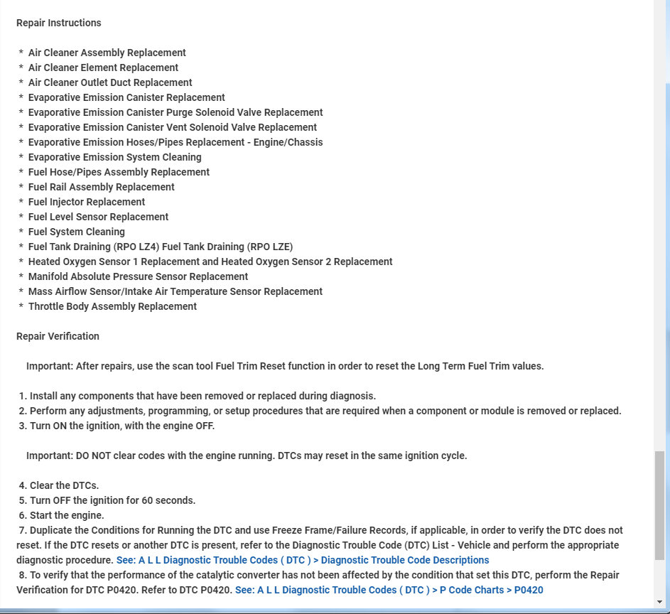

HUGOX25
Thank you very much for the feedback, in the en it ended being the mass air flow sensor that needed to be replaced. the car now starts fine and rides smooth, but after clearing the codes and 1-2 days after the check engine light come on, and the code P0141 comes out on the scanner, I had a new 02 sensor on hand (brand new) and replaced thinking this would solve the problem but it didn't. The check engine comes on and the same code P0141, what's next or what other sign I should look for?
