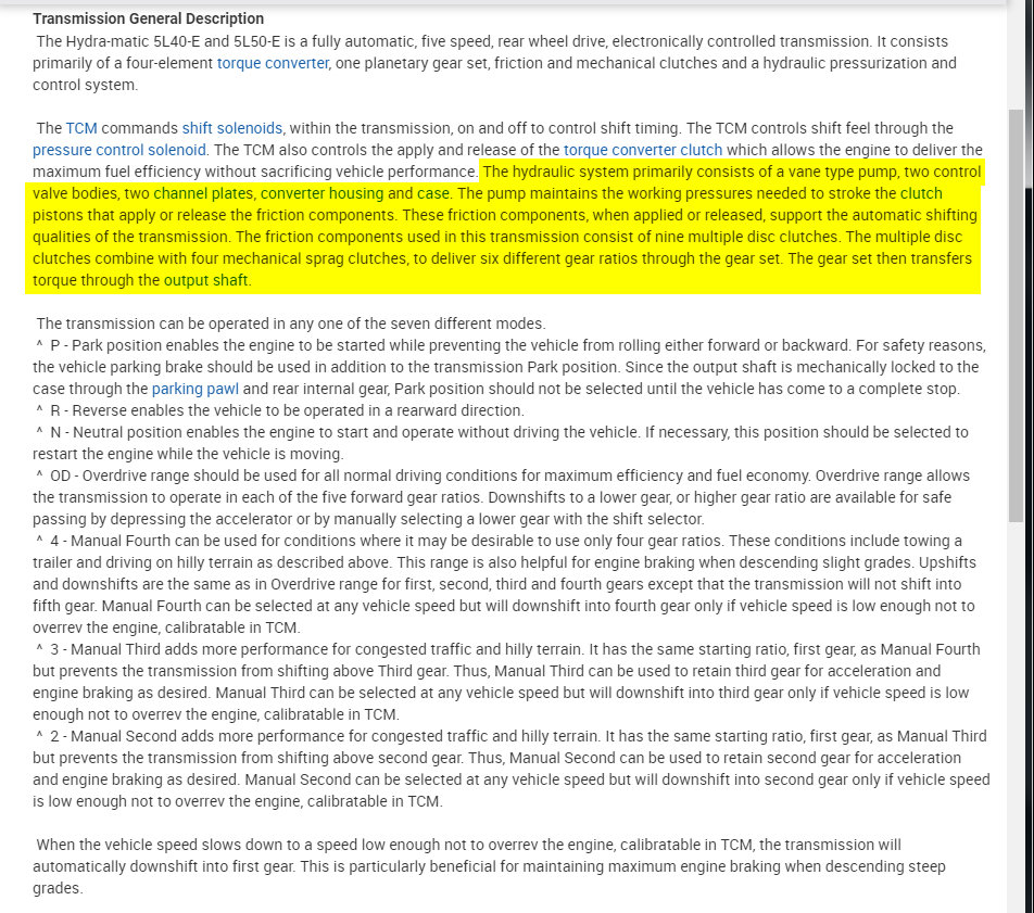

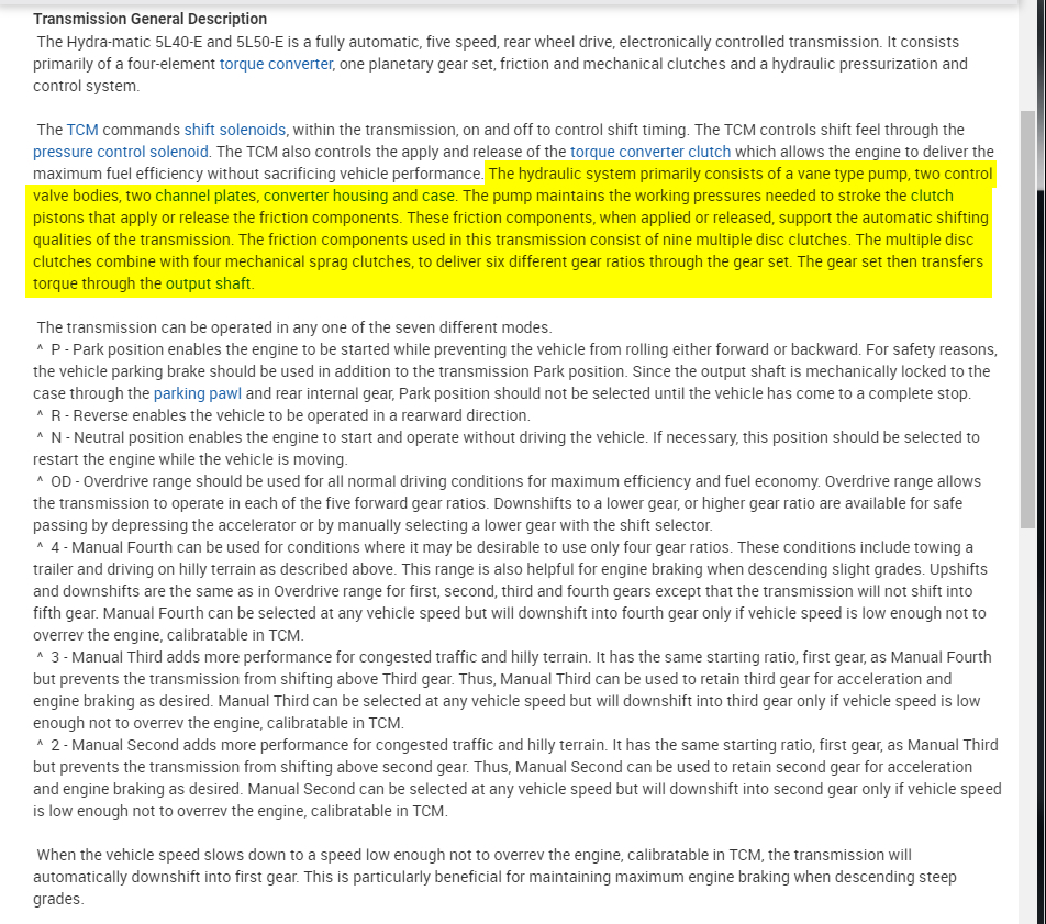

The slipping and no engagement at this point sounds like a pressure issue inside the transmission. You have a pump in the transmission that maintains the proper amount of pressure needed to apply the clutches that engage each gear. I attached the system information about this system for your review.

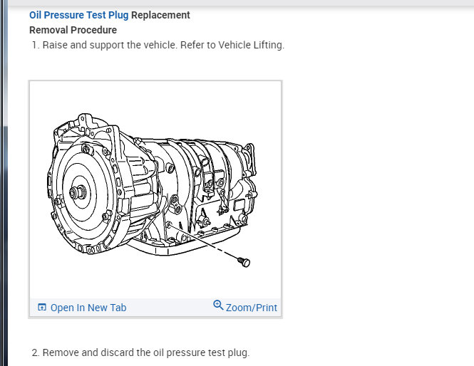

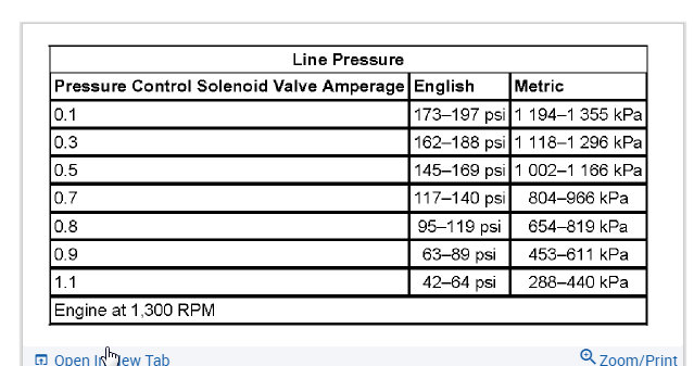

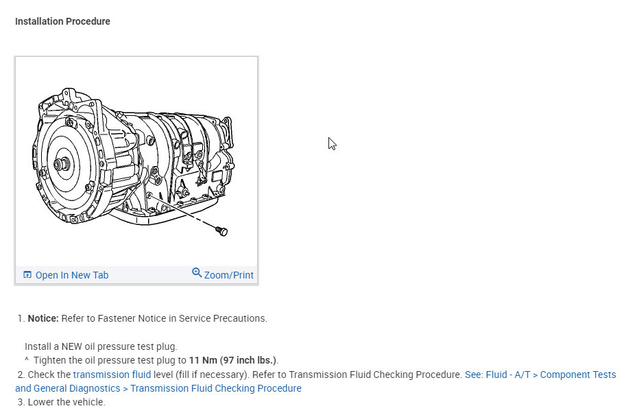

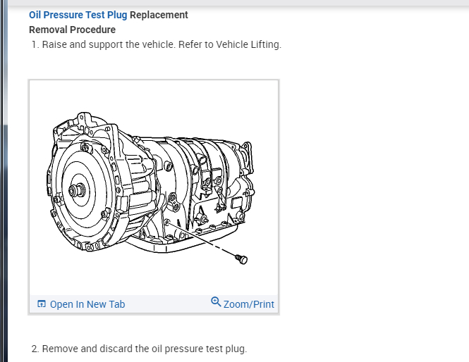

Let's start with checking for codes because this could just be a bypass valve issue but if the fluid is full then I suspect it is an internal issue. If you can, let's check the line pressure of the unit and we can confirm proper pressure. I attached the spec for line pressure and the test port location.
