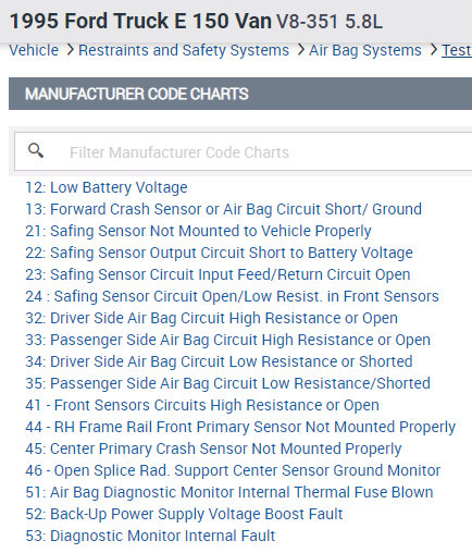

Airbag light flashes in different bursts while driving. What do I do?

Here is the information you requested. You must first check the airbag codes that are stored in your vans computer so we can determine which codes and and their number to help properly diagnose the fault. Here is a tutorial showing how to retrieve OBD1 codes:
https://www.2carpros.com/articles/ford-lincoln-mercury-obd1-1995-and-earlier-diagnostic-trouble-code-definition-and-retrieval

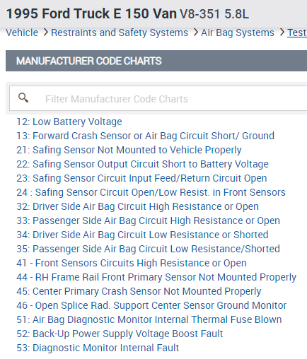

Once you perform this get back to us with the code number or numbers and we can then figure what the fault is. I've attached below a picture list of the possible airbag fault codes on your van. Hope this helps and thanks for using 2CarPros.
