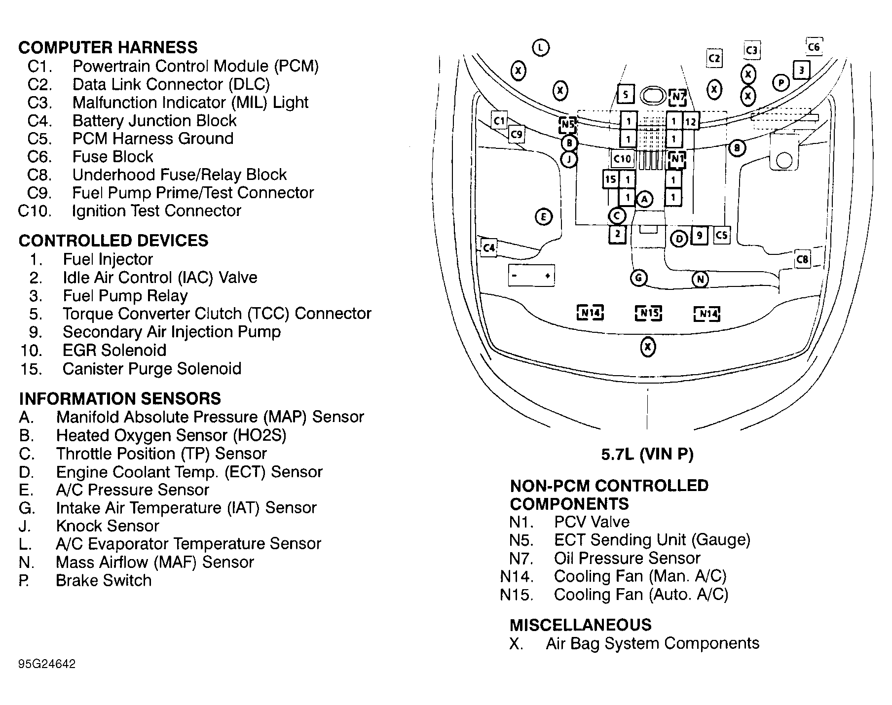

I have a Z28 model that will not stay on. I have had injectors checked, changed fuel pump, changed ECM, computer under dash and checked Opti. Whatever it is seems like a simple fix.

This could be the result of many things. First, if you are able to keep the engine running by pressing the throttle, suspect a plugged or faulty Idle Air Control valve (IAC). This component maintains engine idle speed. It is located on the throttle body. I have attached a picture for your review.
Next, confirm that you are not losing spark or injector pulse once the key is released to the run position. Here are links for checking:
https://www.2carpros.com/articles/how-to-test-a-fuel-injector
Some additional thoughts. Make sure you have a 5 volt reference to the opti-spark ignition control module in the distributor.
