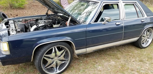

sputtering and bogging down when accelerating
1991 FORD LTD
120,000 MILES • 5.0L • V8 • 2WD • AUTOMATIC
JFREE2107
This is a Crown Victoria LTD with a 302 engine.

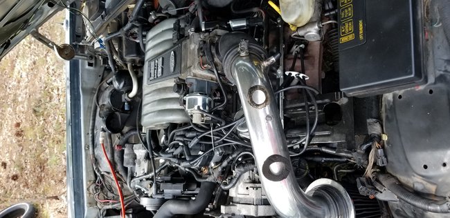

Sometimes it accelerates decently, but not as strong as it used to, other times it sputters and slowly starts to accelerate, then occasionally it nearly stalls out barely a crawl sputtering and backfiring. I release the gas and press until it finally catches. It also cranks a bit slow. New starter, distributor, cap, rotor button, wires, plugs, water pump, and cold air intake. Redid the exhaust system and put a new fuel filter on a few months back. bought this as my first car eleven years ago with 60,000 miles on it. odometer stopped at 64,130 around a year later, so it has over 100,000 miles on it. did not drive it for maybe two years between being stationed in the northern states and deployed to Kuwait and have not driven it but occasionally on the weekends the last few years. I have also replaced the EGR, IAC, and MAF sensor. I have been noticing skipping and stuttering when slowing down to around twenty then attempting to accelerate. it is hit or miss when coming to a complete stop. no issue when going downhill, but definitely still there when going uphill or not coming to a complete stop.

Was it acting this way before the work was done recently? Especially the "cold air intake" was added? I have seen those mess up the air entry into the MAF and cause strange problems like missing and loss of power. Plus they cause issues as the engine bay heats up and the intake air temperature goes higher due to pulling in the hot engine air.
The plugs/points/wires and the rest were done trying to repair it?
Because it has sat for so long I would start with flushing the fuel system out and trying new good gas, then check fuel pressure and flow rate. That car has a steel tank and setting could have let the tank rust and the fuel would turn to varnish, new gas with ethanol in it would break that all down and plug the in tank sock and the dissolved varnish could cause injector clogging.
Check all the vacuum lines for cracks/splits as well.
Letting a vehicle set for long periods is actually worse in many cases than driving them.

From that description, and that it did run better after the work, I would test the fuel pressure and do a pressure drop test on the injectors as well. It sounds like a lack of fuel.
You might try replacing the fuel filter and cutting open the old one to see if it collected a bunch of crud. That would let you connect a pressure gauge as well. You can get the gauge from many parts stores as a loaner tool.
