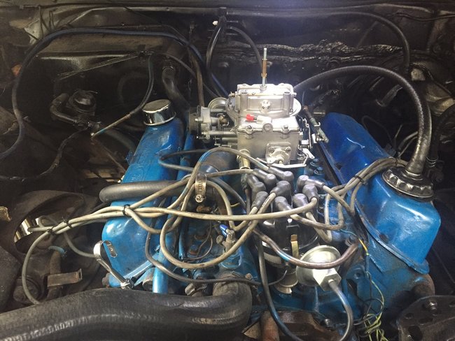

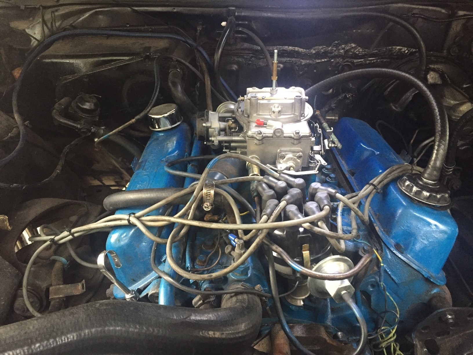

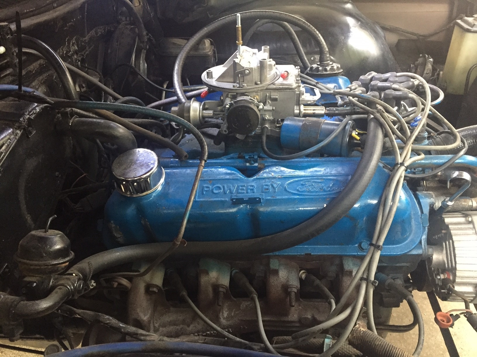

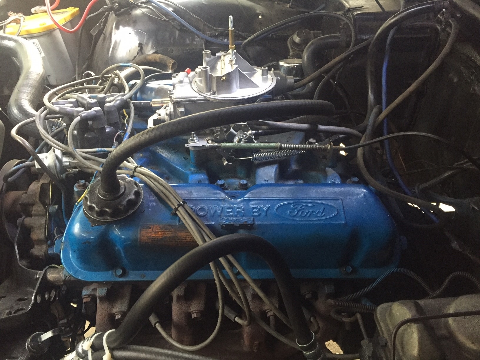

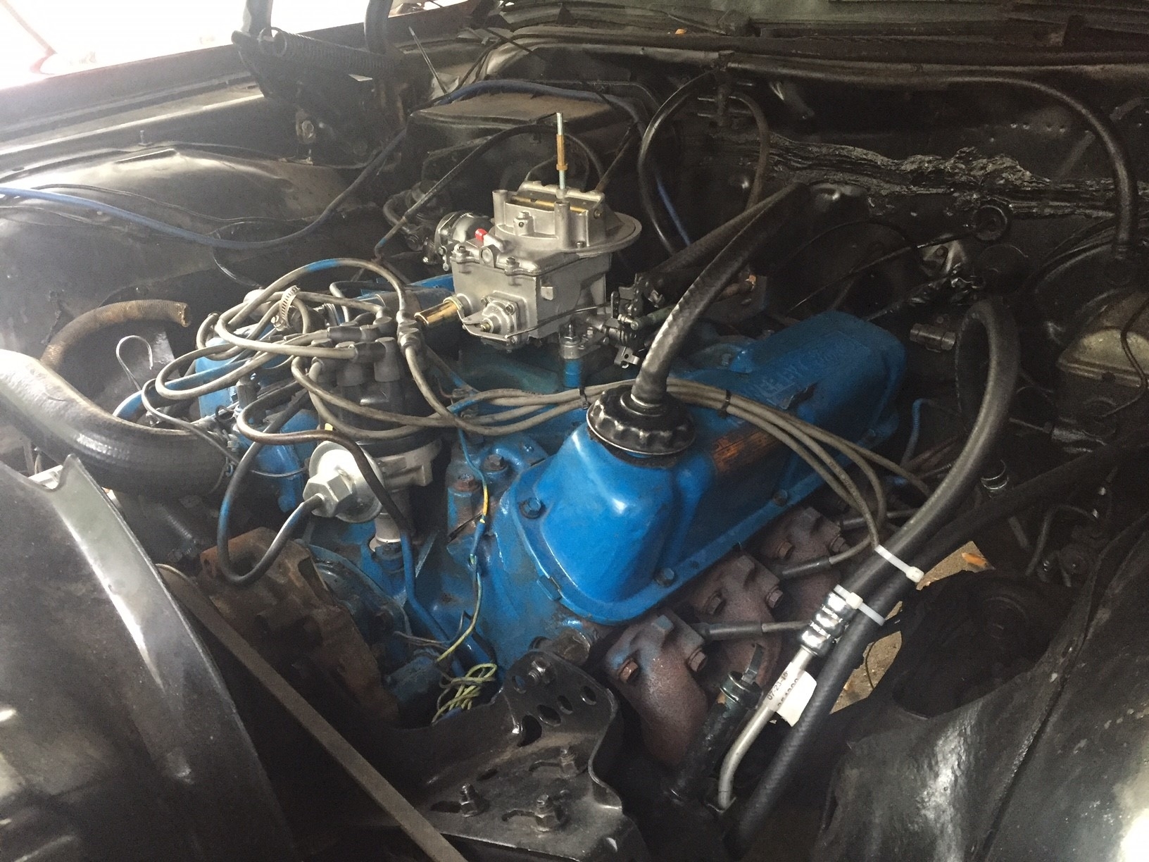

So here is what I have done since replying. I have replaced the accelerator pump, capped any vacuum hose that weren't sure where they plugged into (they were just hanging before). The car won't even start at this point. You turn the key it will turn over and over, but won't actually start. I have tried spraying started fluid into the carb to no avail. I beginning to wonder if its not getting a spark. I know gas is getting to the carburetor as it pours out when I replaced the accelerator pump. I'm attaching pictures to see if they might help.

Have you actually checked for spark? How about looking for the two nice streams of fuel squirting in when you work the throttle by hand?
One vacuum leak that is often overlooked on Fords is the metal tube that runs from the air filter housing, down to and through the right exhaust manifold, then up to the automatic choke housing. That pipe often rusts out below the manifold.

So I have used a tester on all of the points. The light is extremely faint but it still lights up. I had a spare ignition coil so I tried that to no avail.Wonder is there is an accurate vacuum diagram I can compare to ensure I have the hoses in the correct locations.

What are you testing? What "points" are you referring to? What kind of "tester"? What is the connection between a test light and vacuum hoses?

My apologizes. I was testing the ignition system. I purchased the inline spark tester, and hooked it up each one of the wires coming from the distributor. I did this to see if I was getting any spark to the engine. The light was the indicator from the inline tester to indicate whether or not I was getting any spark to the engine.

I've seen those testers but never used one, so I don't know what "normal" is, but if you have some spark, everything in the system is working. WEAK spark can be caused by a partially-shorted ignition coil, which you replaced already, and by a defective condenser. The condenser blocks the 12 volts DC from being shorted to ground while providing the needed path to ground for the coil's primary AC current to flow. With a missing / defective / open condenser, the primary AC current has to go backward through the circuitry and to the battery. That severely limits its efficiency and results in reduced spark voltage, possibly reduced to the point it can't jump the spark plug's gap. Even if it does jump the gap in a spark gap-type tester, or across a plug you're watching, higher voltage is needed when you add compression in the cylinder. That compression makes it harder for the spark to occur.
