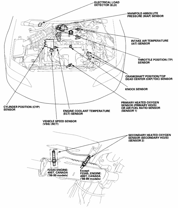

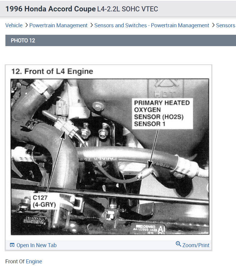

Oxygen sensor location(s) for replacement?
HEMANKAPS
Thanks for the reply.
I will try to put some lubricant. And just to confirm, the Bank 1 Sensor 1 is located on the back side of the engine, right?
Friday, June 25th, 2021 AT 9:39 AM (Merged)
KHLOW2008
  • 41,814 POSTS
Yes, Bank 1 is rear sensor.
https://www.2carpros.com/forum/automotive_pictures/192750_O2Sensor03Accord_1.jpg

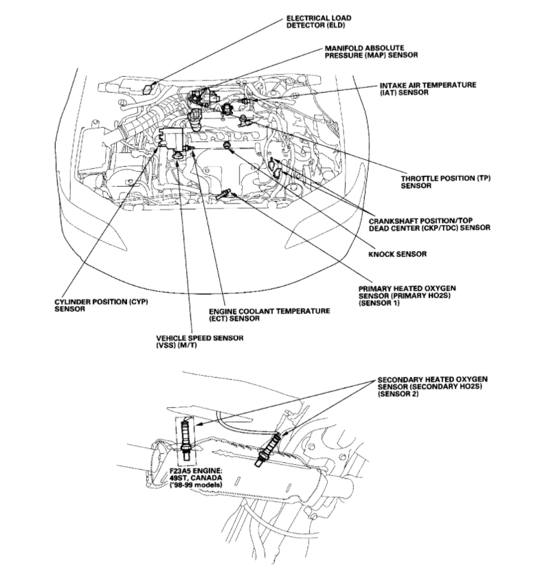

WAKEDOG38
  • 2002 HONDA ACCORD
  • 4 CYL
  • FWD
  • MANUAL
  • 170 MILES
It is a 2.3l california emissions, I've had a pesky check engine light off and on for the last couple of months. I had a diagnostic done and was told I need to replace the B1 S2 sensor. After scouring the web I can't get a solid answer on where the sensor is located. Any help would be appreciated. Thanks
Friday, June 25th, 2021 AT 9:40 AM (Merged)
  • 75,992 POSTS
Here is a guid to help you change the oxygen sensor out and the locations of the sensor for your car below.
https://www.2carpros.com/articles/how-to-replace-an-oxygen-sensor
Sensor 2 would be in the catalytic converter.
+1

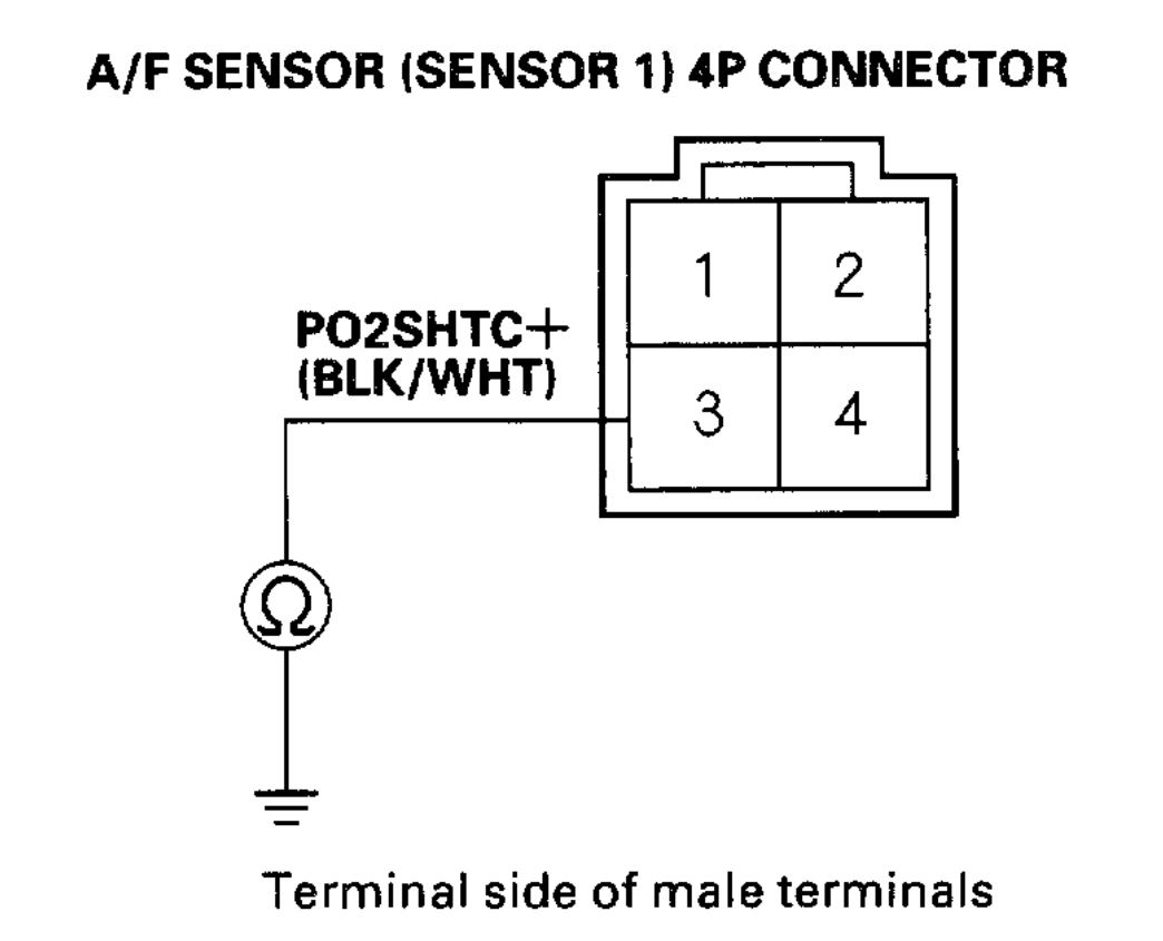

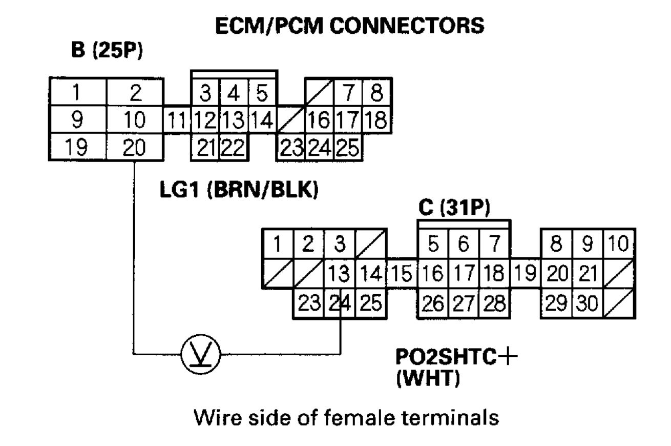

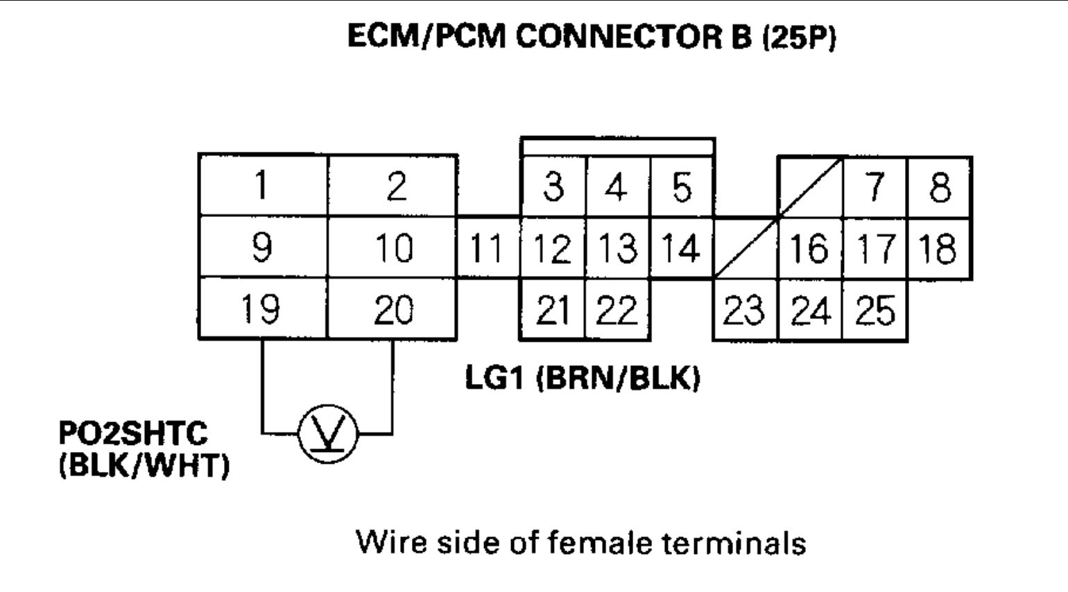

Hi Have 2001 accord, 4dr, 4Clynder, model. Got error codes P1166 and P1167 indicating O2 sensor issue. How do I know which one, Bank1 or 2 and if Bosch aftermarket sensor is good enough for replacement. Thanks!

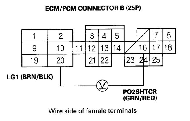

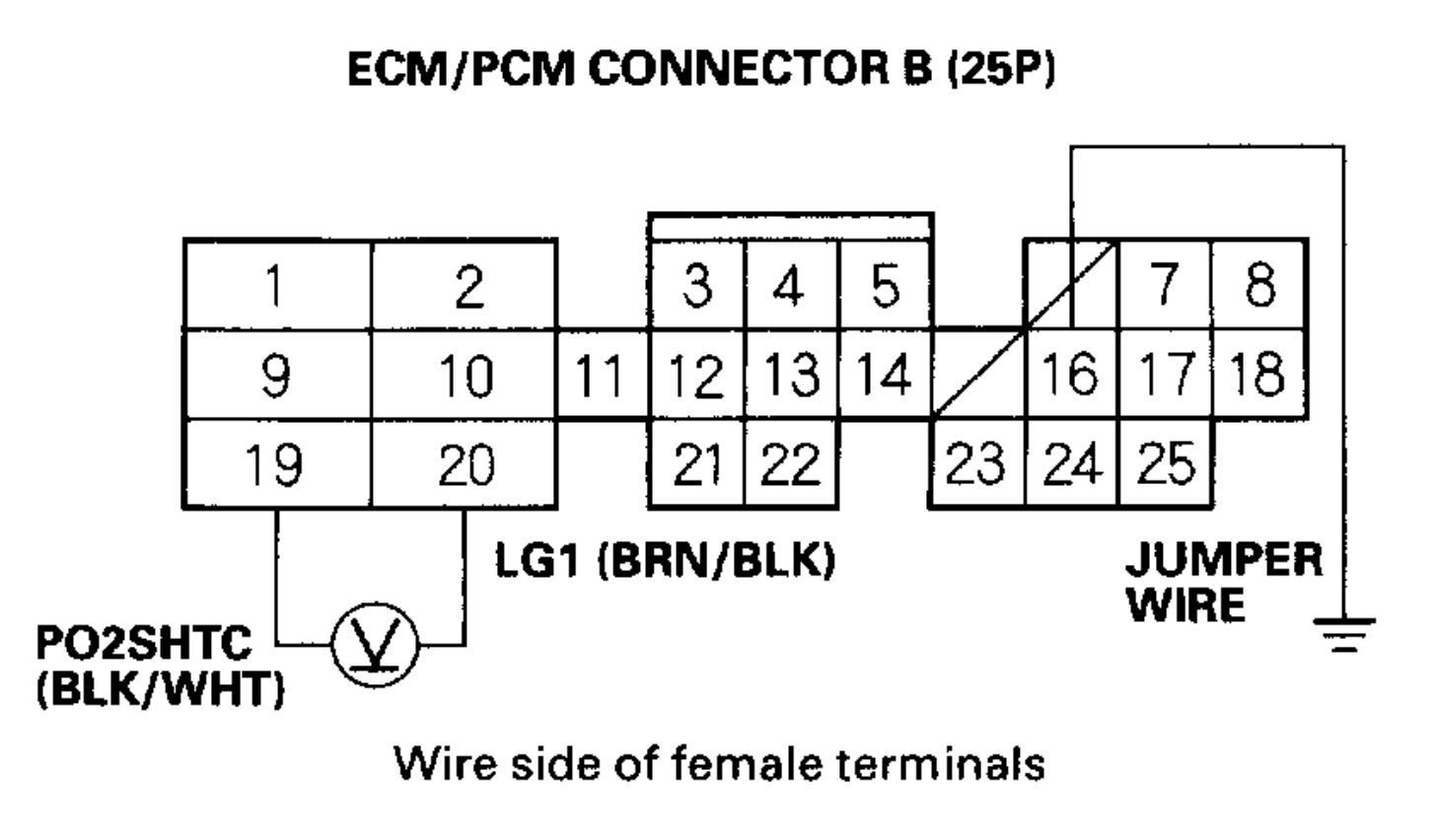

F4I_GUY
  • 3,302 POSTS
Those are both codes for Bank 1 A/F sensor heater. See diagnostic chart below
DTC P1166: A/F Sensor (Sensor 1) Heater Circuit Malfunction
1. Reset the ECM/PCM.
2. Start the engine.
Is DTC P1166 indicated?
YES - Go to step 3.
NO - Intermittent failure, system is OK at this time. Check for poor connections or loose wires at C102 (located under the under-hood fuse/relay box), A/F Sensor relay, the A/F Sensor (Sensor 1) and the ECM/PCM.
3. Check the following fuses:
- POWER SEAT (20 A) fuse in the under-hood fuse/relay box.
- No.4 ECU (ECM/PCM) CRUISE CONTROL (15 A) fuse in the driver's under-dash fuse/relay box.
- No.6 LAF HEATER (20 A) in the passenger's under-dash fuse/relay box.
Are any of the fuses blown?
YES - Repair short in the wire between the A/F Sensor relay and the fuses.
NO - Go to step 4.
4. Measure voltage between ECM/PCM connector terminals B19 and B20, 30 seconds after the ignition switch is turned ON (II).
Is there battery voltage?
YES - Substitute a known-good ECM/PCM and recheck. If the symptom/indication goes away, replace the original ECM/PCM.
NO - Go to step 5.
5. Measure voltage between ECM/PCM connector terminals C13 and B20.
YES - Go to step 6.
NO - Go to step 10.
6. Turn the ignition switch OFF.
7. Disconnect ECM/PCM connector B (25P).
8. Turn the ignition switch ON (II).
9. Connect ECM/PCM connector terminal B16 to body ground with a jumper wire, then measure voltage between ECM/PCM connector terminals B19 and B20.
NO - Repair open or short in the wire between A/F Sensor (Sensor 1) and ECM/PCM (B19).
10. Turn the ignition switch OFF.
11. Disconnect ECM/PCM connector B (25P) and the A/F Sensor (Sensor 1) 4P connector.
12. Check for continuity between A/F Sensor (Sensor 1) 4P connector terminal No.3 and body ground.
Is there continuity?
YES - Repair short in the wire between the A/F Sensor (Sensor 1) and ECM/PCM (B19).
NO - Go to step 13.
13. Turn the ignition switch ON (II).
14. Measure voltage between ECM/PCM connector terminals B16 and B20
YES - Repair open in the wire between the ECM/PCM (C13) and the A/F Sensor (Sensor 1) or Secondary HO(2)S (Sensor 2).
NO - Go to step 15.
15. Check for continuity in the wires between A/F Sensor and the fuses.
YES - The wires are OK. Replace the A/F Sensor relay.
NO - Repair open in the wire between the A/F Sensor relay and the fuses.
The corresponding diagrams are attached below

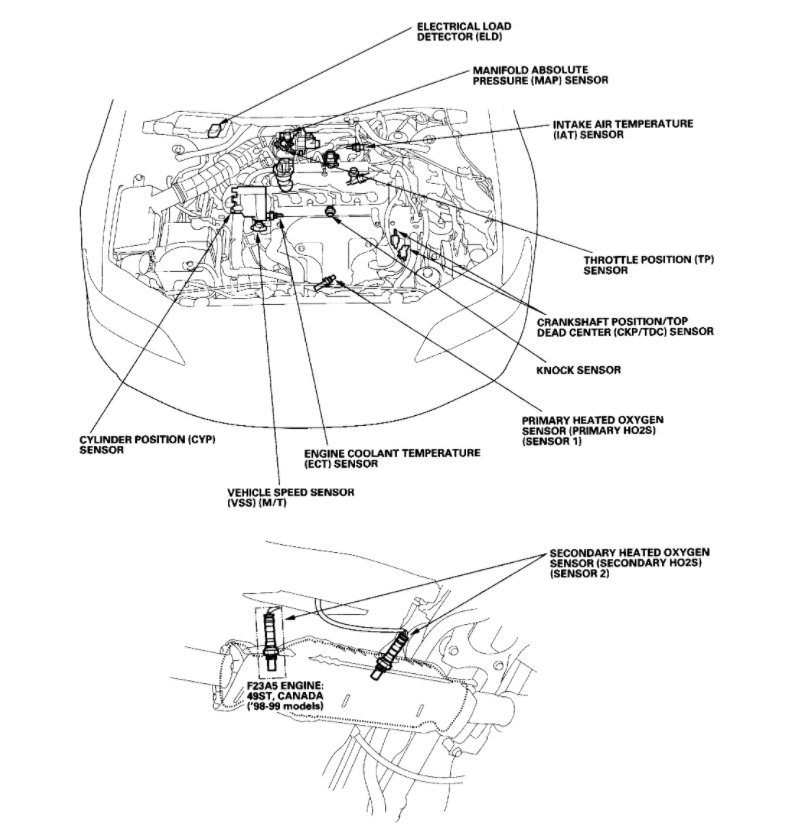

What causes oxygen sensor to blow out?
Friday, June 25th, 2021 AT 11:10 AM (Merged)
  • 52,797 POSTS
Good morning.
Please explain blowing out? I need more detail. Here is how you can replace the sensors and there locations in the diagrams below.
Check out the diagrams (Below). Please let us know what you find.
+1

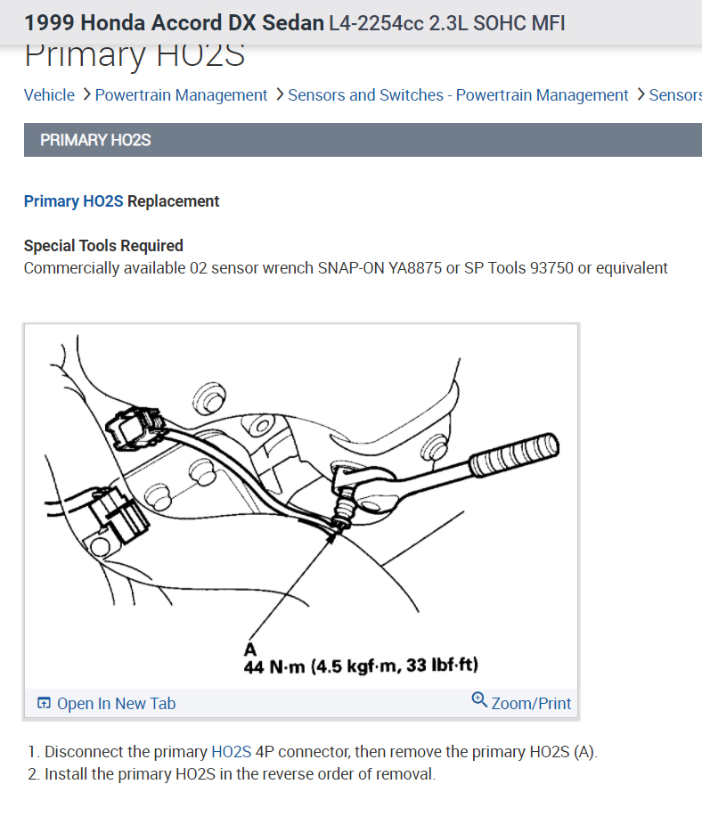

WICK333
  • 1997 HONDA ACCORD

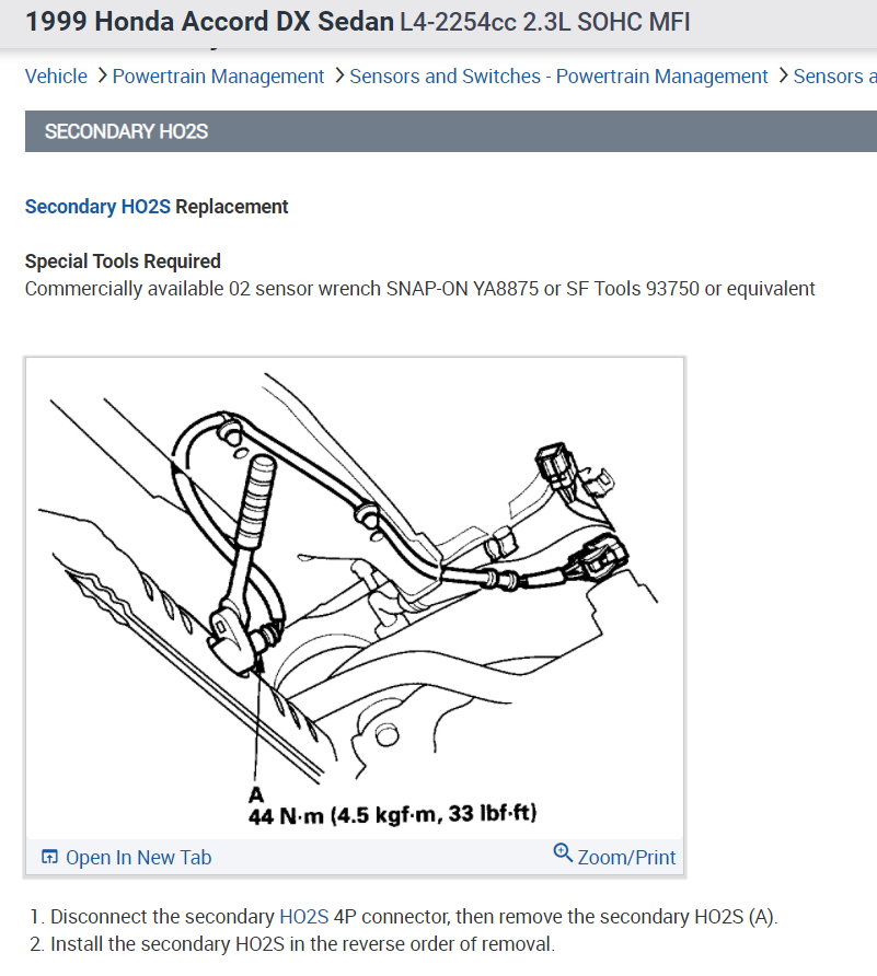

I'm replacing the exhaust, from sleve (that is in-between the manifold and the cat) to the back. I have the cat disconnected and it is attached only by the o2 sensor wires. Does the o2 sensor unplug or do you need to remove the nut at the base (there is no room to get a wrench on it with any leverage) The sensor appears to have three seems where it might pull off/unplug, but I have been unsuccessful in seperating it by pulling on it with a vice grip. I am about to mark the wires and then cut them and then splice them back together.
I live in Minnesota and there has be nothing about this exhaust removal that has been easy. To start I'm doing it with jack stands and really wishing I had a lift. I'm replacing the Cat because I stripped the nuts on the back of the Cat even after WD 40 and a torch. I'd just cut the bolts with a die grinder, but the bolts are welded into the cat. So the nuts have to come off or you need to buy a new catalytic converter. Nice!
Everything on the web is very matter of fact in the description or removing the cat. With vivid descriptions like "disconnect the o2 sensor from the converter" or it is not mentioned at all. Disconnecting the sensor is either so simple that it warrants no explanation or the other left that out to frustrate a weekend mechanic like me.
With me a picture is worth a 1,000 words where does it unplug? And if that nut at the base has to come off is there a special tool and what does the tool look like.
Friday, June 25th, 2021 AT 11:14 AM (Merged)
KHLOW2008
  • 41,814 POSTS
Hi Wick333,
The HO2S is bolted on.
Special Tools Required
O2 sensor wrench SNAP-ON YA8875 or SP Tools 93750 or equivalent, commercially available
https://www.2carpros.com/forum/automotive_pictures/192750_HO2SReplacement00Accord_2.jpg

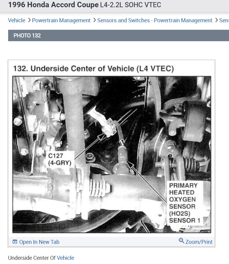

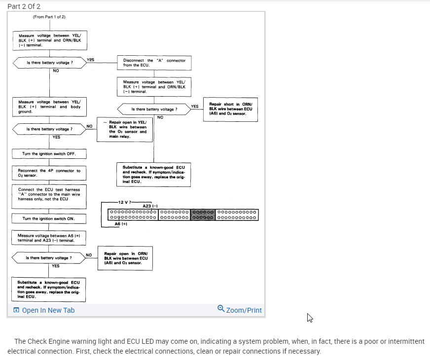

THOMG
  • 1996 HONDA ACCORD
My check eng light came on - AutoZone says it is code P0141 - heater for bank 1, sensor 2 oxygen sensor is bad. This car only has two sensors - one on either side of the cat. Hanes manual shows a 3rd sensor at the bottom of the exh manifold - I'm 100% positive there is no sensor there. Which O2 sensor should I focus on?
ZACKMAN
  • 4,202 POSTS
You have two sensors. What Haynes is referring to is for V6 application (3 sensors). Bank 1 sensor 2 is the one after the cat. Before you replace the sensor, check and make sure that the wiring is not damaged. If you don't see any damage on the wires, then replace the sensor. Bosch PN 13176 or equivalent. Here is a guide to help walk you through and the oxygen sensor locations in the diagrams below.
-1
THOMG
Thanks Zackman!
I checked the rear sensor and it does have a bad heater circuit. I ordered a replacement Denso since that is what was installed. Thanks you very much for your input!

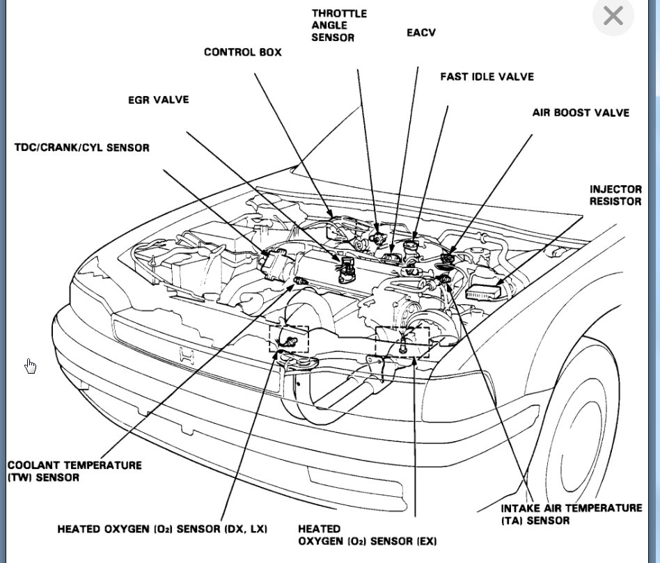

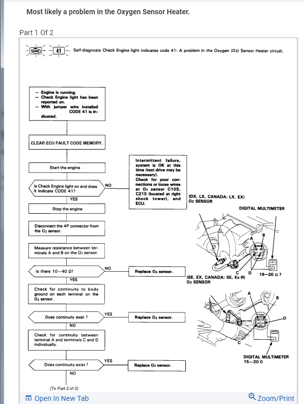

KARL GRAVES
  • 7 POSTS
  • 1992 HONDA ACCORD
  • 2WD
  • 240,050 MILES

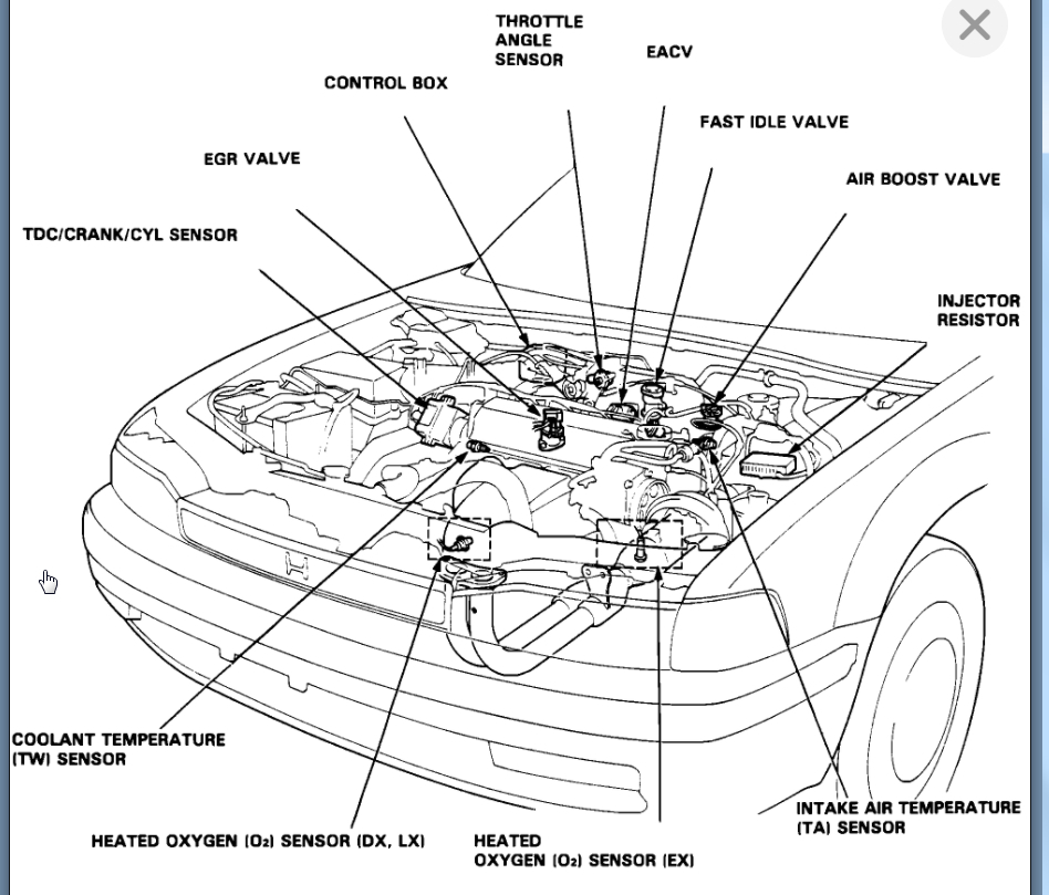

Where is the oxygen sensor heater located? I got a code 41 today.
Friday, June 25th, 2021 AT 11:16 AM (Merged)
I attached the info for this code and the location. This guide will help walk you through the repair with diagrams below to show you how on your car.
Let us know if you have more questions. Check out the diagrams (Below). Please let us know if you need anything else to get the problem fixed. Thanks
