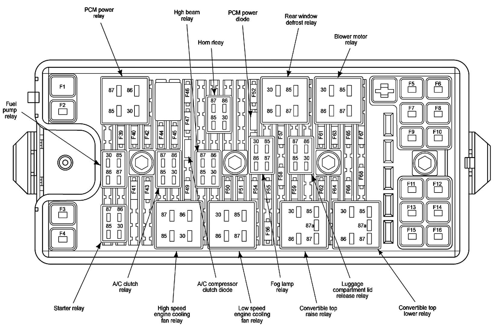

Welcome back.

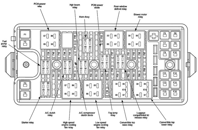

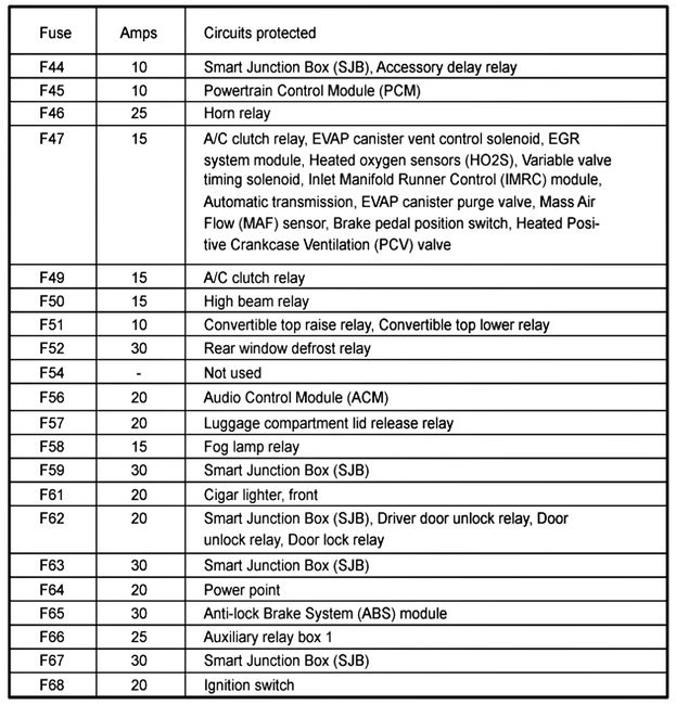

I am going to start with the basics. First, under the hood locate the power distribution box. Open it and remove and replace fuse 47 (15 amp) even if it looks good. It may be losing connection when it gets hot. Next, when the fuse is out, inspect the terminals in the box. Make sure they are clean and not pushed or damaged in any way.
Do this and let me know what happens.

I have replaced and inspected the fuse terminal and there has not been any difference in the way the car behaves. I have provided a short video so you can hear how the car acts and see how it bucks and struggles to pick up speed in any gear. I went half throttle and held it at half throttle.

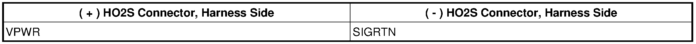

DW14 DTCS P0053, P0054, P0055, P0059 AND P0060: CHECK FOR VPWR IN THE HARNESS
Note:If DTCs P0053, P0054, P0055, P0059, or P0060 are present, test their related circuits individually.
- Ignition OFF.
- HO2S connector disconnected.
- Ignition ON, engine OFF.
- Measure the voltage between:
Is the voltage greater than 10 V?
- GO to DW15.
- REPAIR the open circuit. CHECK the fuses.
- Clear the PCM DTCs. REPEAT the self-test.

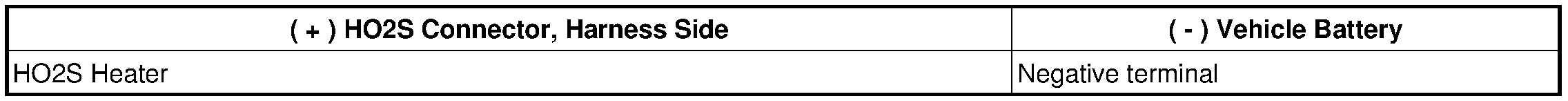

DW15 CHECK THE HO2S HEATER FOR SHORTS IN THE HARNESS
- Ignition OFF.
- PCM connector disconnected.
- Measure the resistance between:
Are the resistances greater than 10K ohms?
- GO to DW16.
- REPAIR the short circuit. Clear the PCM DTCs. REPEAT the self-test.

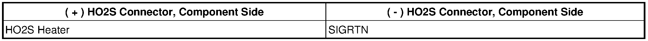

DW16 CHECK THE HO2S HEATER CIRCUIT FOR AN OPEN IN THE HARNESS
Is the resistance less than 5 ohms?
- GO to DW17.
- REPAIR the open circuit. Clear the PCM DTCs. REPEAT the self-test.
DW17 CHECK THE INTERNAL RESISTANCE OF THE HO2S HEATER
Is the resistance between 3 - 30 ohms?
- GO to DW18.
- INSTALL a new HO2S.
- RESET the keep alive memory (KAM). REFER to Section 2, Resetting The Keep Alive Memory (KAM) See: Computers and Control Systems > Diagnostic Trouble Code Tests and Associated Procedures > Resetting The Keep Alive Memory (KAM).
- REPEAT the self-test.
DW18 CHECK THE HO2S HEATER CIRCUIT FOR AN INTERNAL SHORT TO SIGRTN OR GND
Is the resistance greater than 10K ohms?
- GO to DW25.
