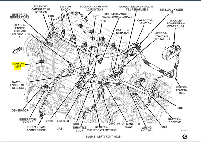

I attached a pic below of the MAP sensor. This vehicle doesn't have a MAF. Is this the sensor that has broken? Also, do you have a live data scan tool?

No, I don't have access to live data. it's throwing the same codes as before. Coil number 3 yes the MAP sensor is not even plugged in. I think I'm giving up on this one it seems to be wiring related that same coil c or number 3 has been giving me trouble since I bought the car. I dropped my meter in a dog's water bowl now it's not working right .. I think this is a job for the pros I'm tired of the guessing game it's getting more expensive every day. I'm just going to take it in if they can fix it for $500.00 if not I'll junk it. Never buy a Caliber Joe. Thanks for all your help. JC

Okay, that's encouraging. the MAP sensor was broken taking off the manifold. But I do see an improvement in the overall engine performance with the map and manifold runner valve unplugged. That sounds crazy but it's true. Tomorrow I will send you a list of the codes in order. what type of scan tool do you recommend from Harbor Freight? Also how do you feel about a circuit detection tool? It will alert you to the area where there is open wire/broken/etc. Harbor Freight sells them as well. And I will buy another volt meter. Talk to you soon. Thanks Joe.

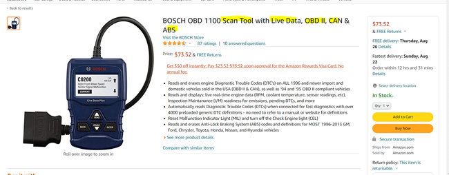

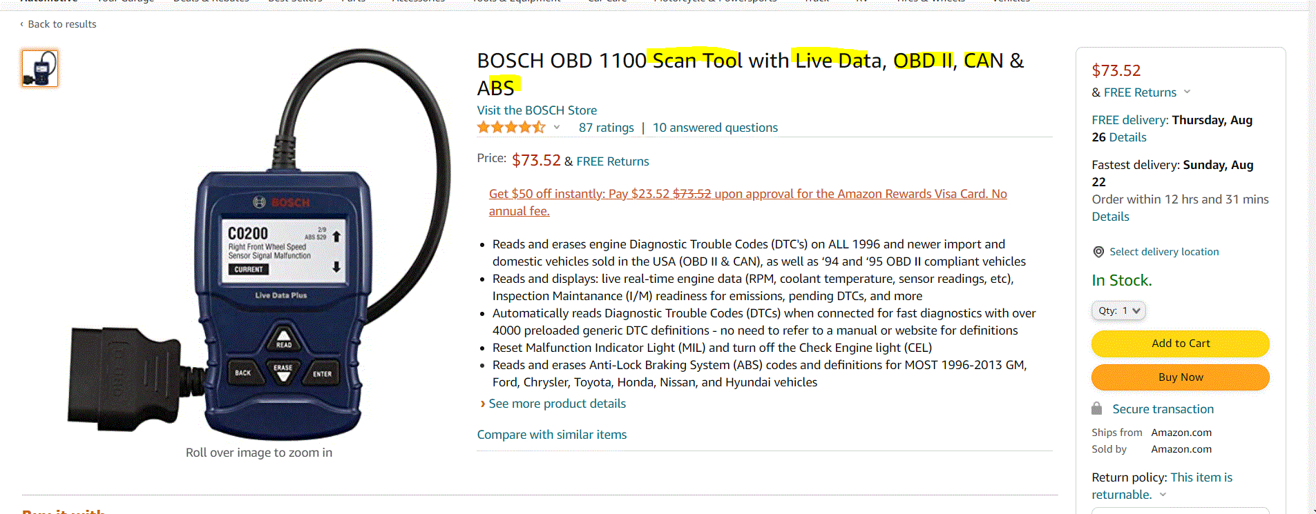

As far as scanners, although I love harbor freight, I never looked at their scan tools. Here is what I suggest: If you are going to purchase one, try to find one that can scan the entire CAN. CAN stands for controller area network. Basically, all the different modules/computers are tied together via a few wires. A basic scanner will only read basic codes. A CAN scanner can read all codes regardless of the module it's stored in.
I've seen them on Amazon as low as 50 dollars. I'm sure Harbor Freight will have something similar.
I'm suggesting that type because the newer the vehicle, the more it is needed. When you purchase a scanner, chances are you plan to keep it for some time, so if you get newer and newer vehicles, it will benefit you.

As far as scanners, just look for one that reads all codes from the CAN-BUS.
I attached a pic below of a scan tool on Amazon and highlighted the things to look for when you are at Harbor Freight. Again, I'm suggesting this type simply because it will last with the changes in newer vehicles.
See pic below.

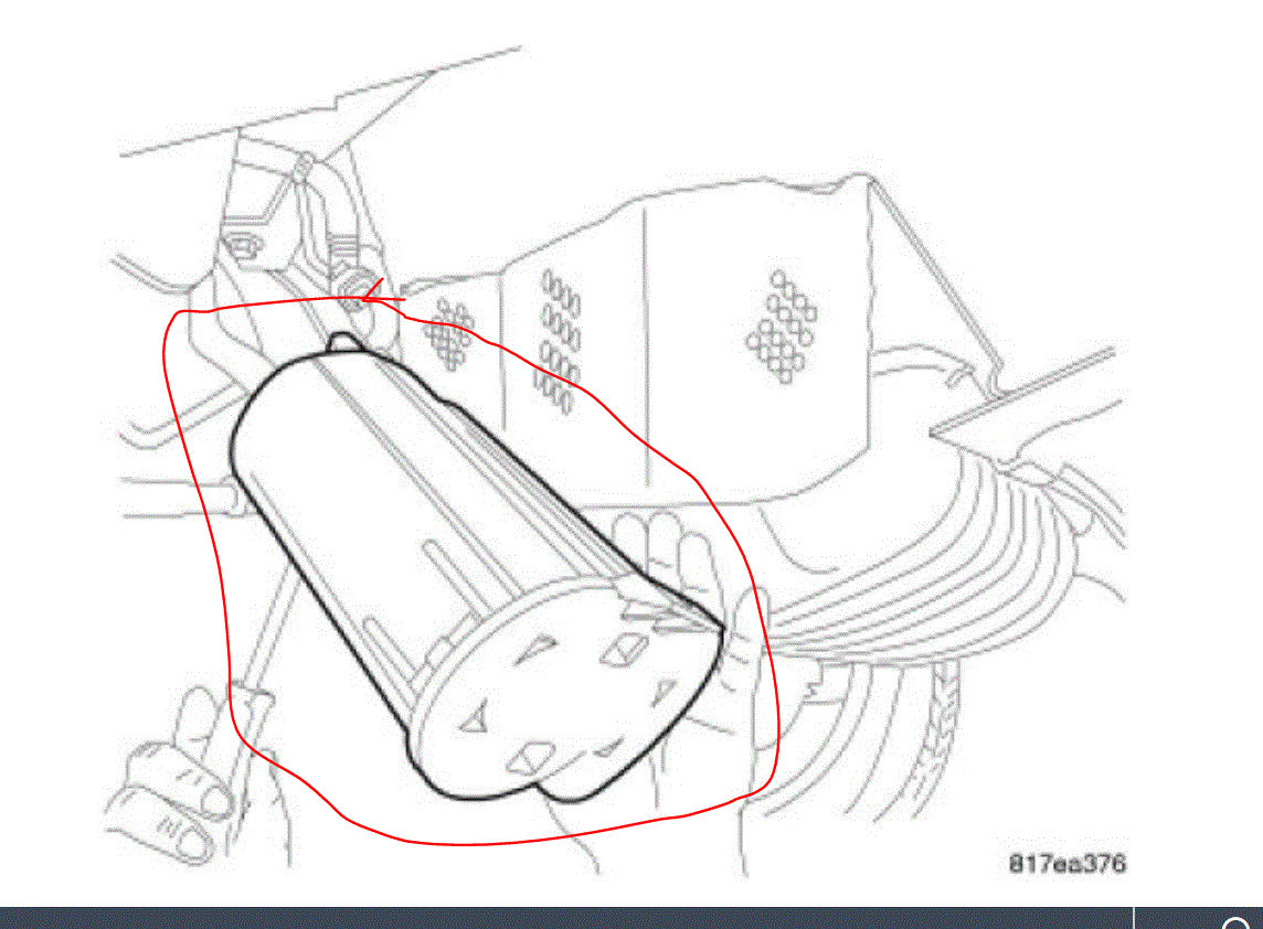

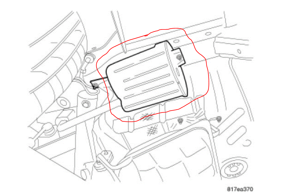

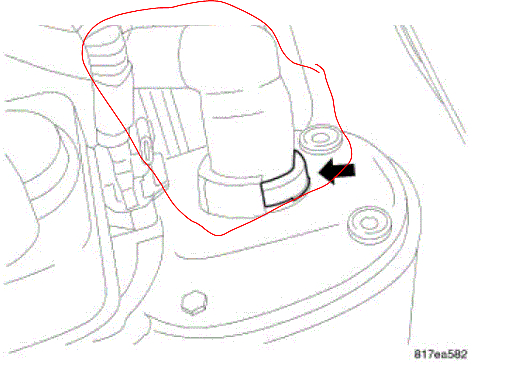

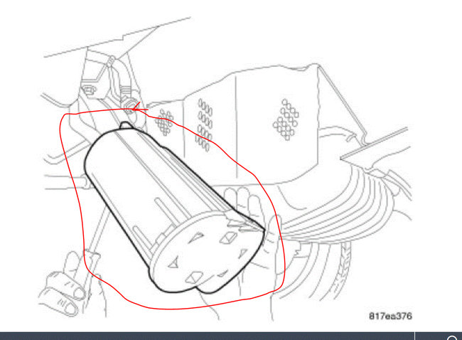

Correct, the large evap leak will open the fuel tank to the atmosphere. It will smell like raw fuel. Check around the exhaust with the engine off to see if you can still smell it.
The charcoal canister is in the rear of the vehicle. The canister mounts to a left rear frame rail in the rear of the vehicle. That is the area where I suspect the large leak is located. I attached some pics below for you and circled the things to check.
