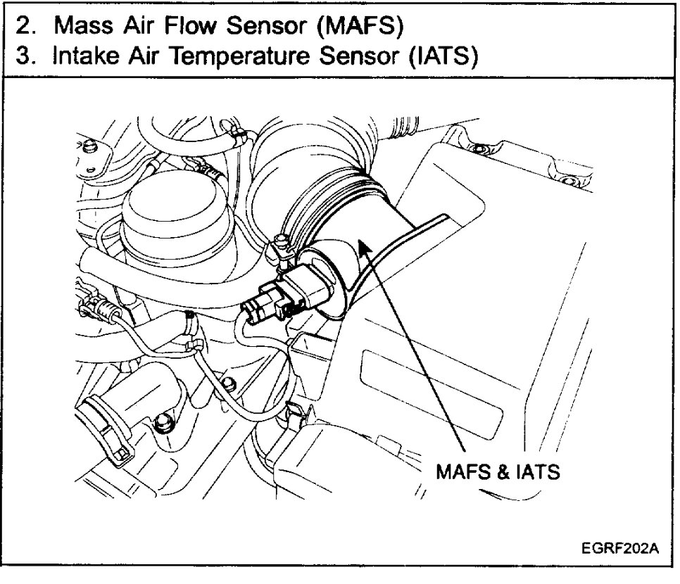

The code P2173 (too much airflow to the engine) is the one we should concentrate on which I would unplug the MAF sensor and start the engine to see if there is any difference. Here is the location of the sensor so you can check it out. Check out the images (below). Please upload pictures or videos in your response of any problems so we can see what to help you with.
Sep 27, 2024 at 6:02 AM
BENBOWYER
Unplugged the maf and the car started and ran again, going to buy and install a replacement and see how it goes from there, appreciate it!
