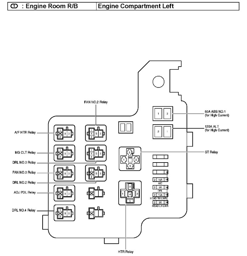

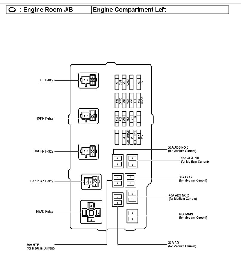

I wondering if all of these are possibly on one fuse or relay that I can try replacing or what to do next. I'm not very good at reading wiring schematics or determining what fuses or relays to check or if there's a fusible link somewhere.

I would check to make sure the engine wiring harness ground is secure, next let's check the fuses because anytime there is a spark a fuse can be blown. Here is a guide to help and the fuse locations as well, please test the fuses with the key on.
If you find a blown fuse, replacing it can clear the codes. Check out the images (below). Let us know what you find.

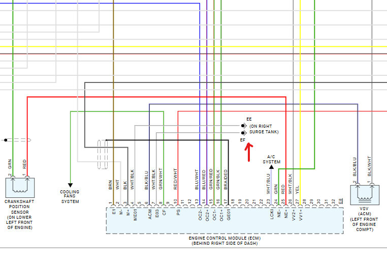

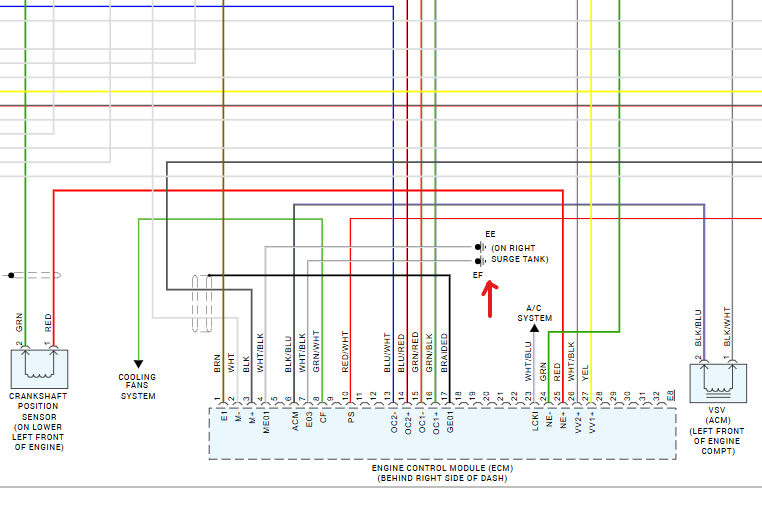

Can you tell where the engine wiring harness ground is?
Nov 8, 2024 at 7:33 AM
  • 54,837 POSTS
They don't show the locations exactly, did you have this problem before the repairs? If not, I would look around the area where you were working. It says the ground is on the right side of the surge tank. Check out the images (below). Please let us know what happens.
Nov 8, 2024 at 10:32 AM
MICHAEL POWELL
  • 20 POSTS
Thanks so much. It did turn out to be the ground wire bolted to the driver's side of the engine block. All the codes are gone at the moment. But the maintenance light is still on. I guess I'll just have to wait for the computer to go through a few cycles and see if anything comes back.
