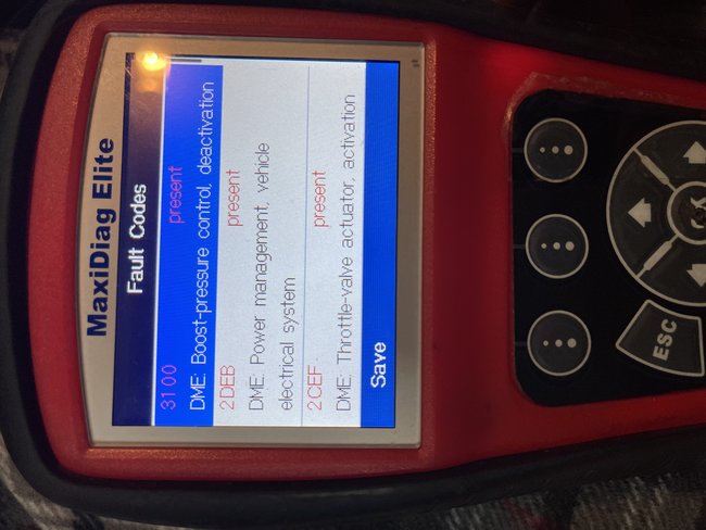

This car was in limp mode and still is, with reduced power message and barely any throttle response. Took ECU to be checked out and they said there was a minor repair needed and they fixed it, installed it same codes pretty much. Battery is good, alternator charging. Checked throttle body harness and is fine, cleaned throttle and it's now clean. Checked air box connectors and no cracks there. Engine sometimes would start from first time especially if cold. Sometimes it would take a lot to get it to run. And i notice tachometer doesn't move when it tries to start. When it runs now it stays running but engine RPMs is up and down continuously, that is the only different since ECU repair. Checked 50-amp fuse in engine bay by ECU and is good. Here are the codes. Any ideas would be appreciated.

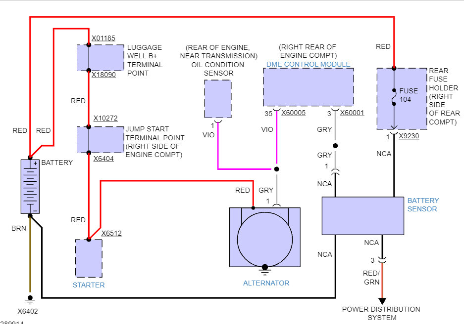

When you say the "rom" will move, are you talking about the tachometer? The RPM signal? If so, I would expect that with all the Crankshaft and Camshaft codes, you have. The main codes that would concern me the most, (and these codes are in Hex Code) are the first couple codes 2ACB, which is the Power Relay circuit for the DME (Main ECU), and 2DEB which is Power management Overvoltage or Under Voltage, Since the codes are in Hex you don't have the whole code. For instance, Hex Code 0x2DEB is actually P160C, D, or E,. C is Overvoltage. D is undervoltage Etc.
But I think here you're having a voltage issue to the DME, possibly a wiring issue. Since you're getting the 2ACB ECM/PCM Power Relay Circuit code, this relay feeds the DME power and is supposed to be hot all the time. I will put up diagrams.
If you have put a meter on the charging system and the voltage is very steady. Then there's a wiring issue going on somewhere before that Relay.

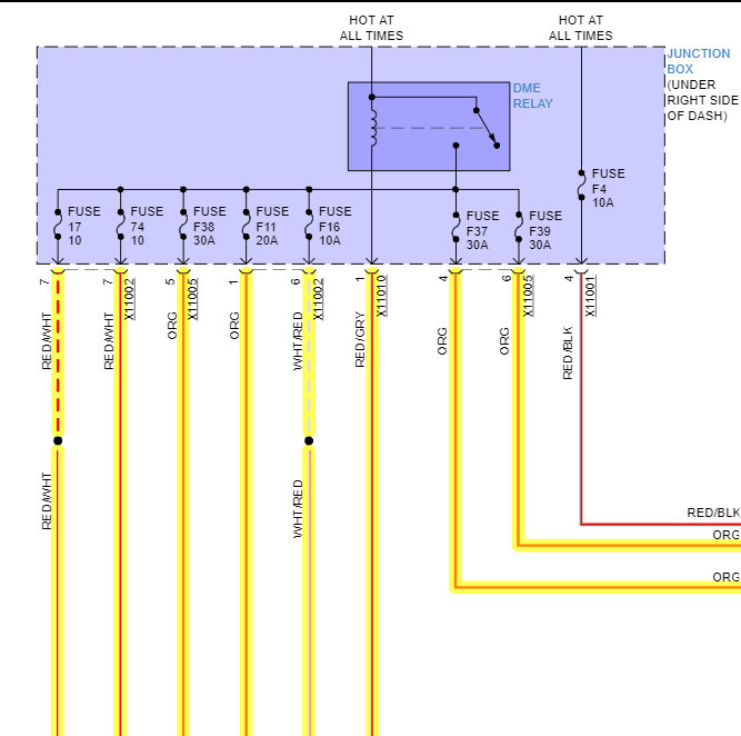

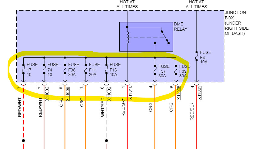

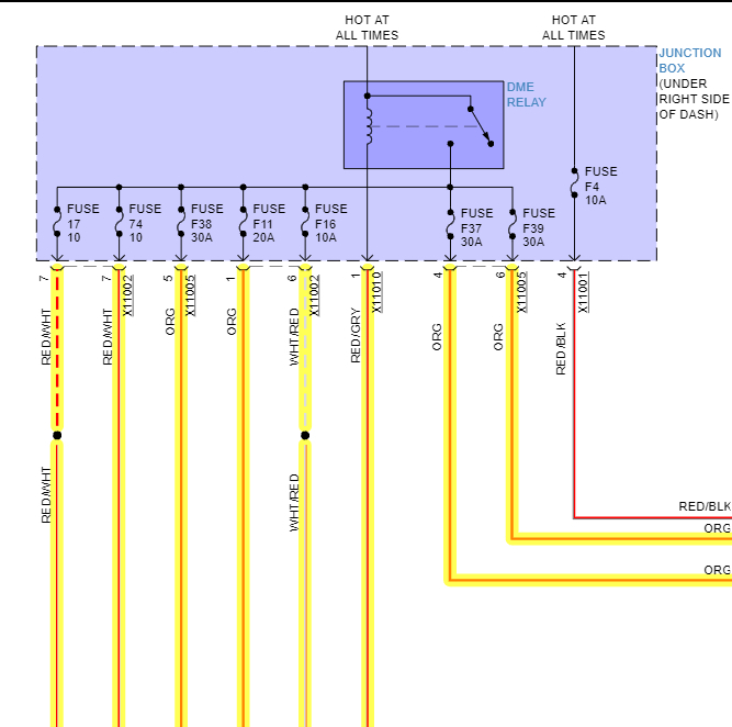

The relay is located in the Junction Box under the right side of the dash (Passenger side). You may want to take a look at the backside of that fuse/relay junction box for any melted, loose terminals, or wires. Fuse F4 (Red/Black wire) feeds the DME, as well as fuse F39 (orange wire).

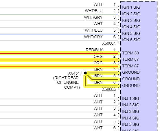

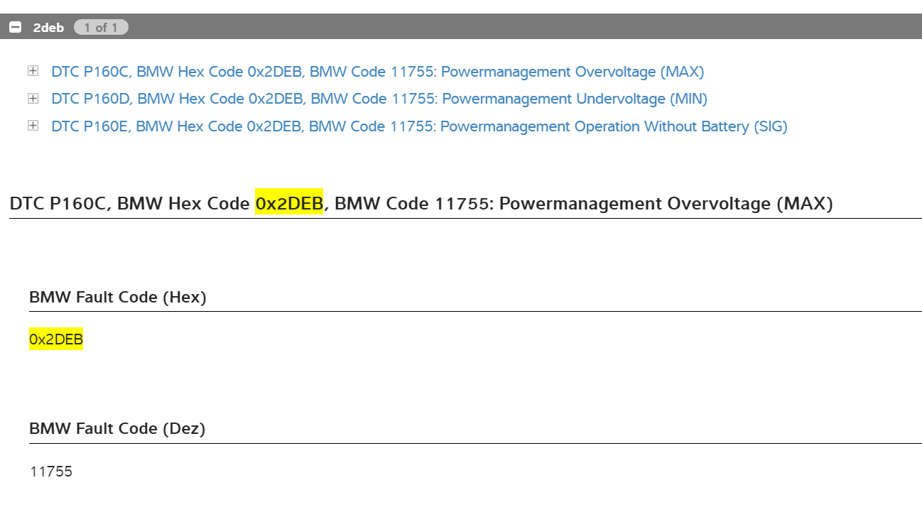

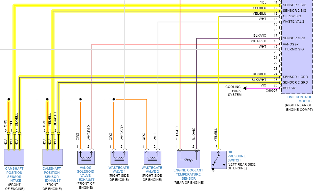

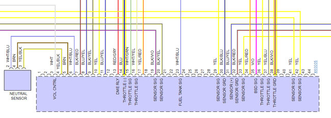

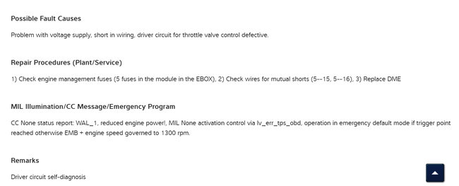

On the second diagram is the Powers and Grounds for the DME, they are all highlighted in yellow. Three powers labelled Term 30 and two labelled Term 87. You'll see the three below that are the Grounds. I would check all of these while the car is running so the circuits are loaded.

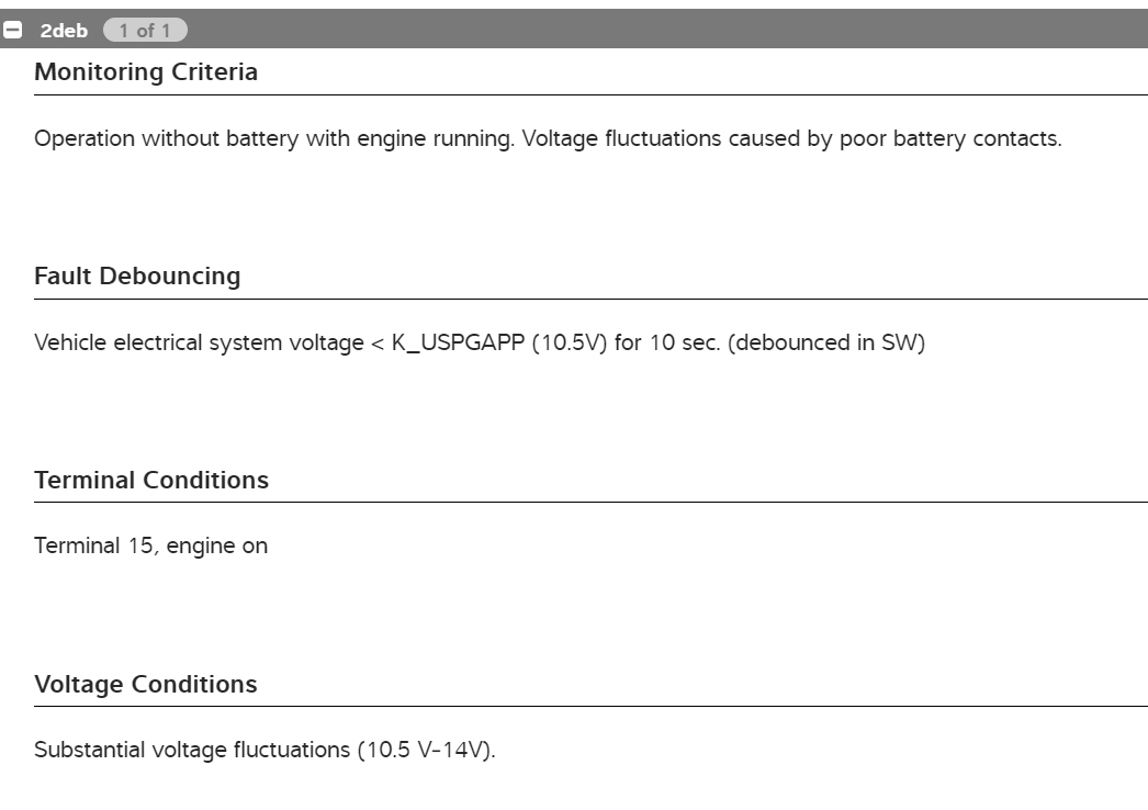

All the other codes could be caused by low voltage to the DME,

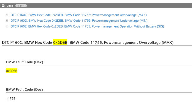

Some of these 2DEB codes are labelled as Voltage Fluctuations 10.5v-14v.

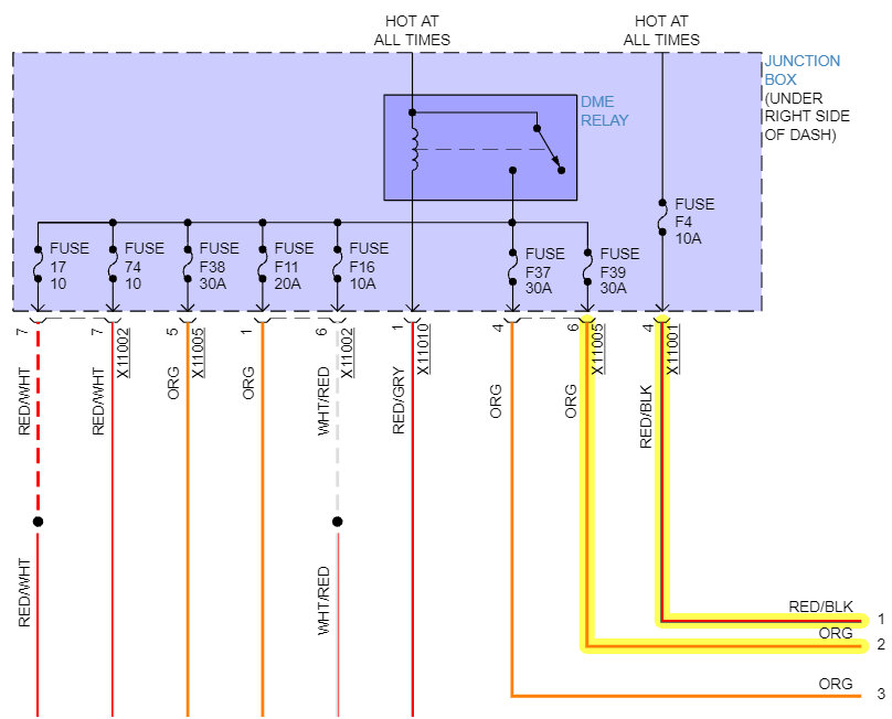

The third diagram is an example of one of the three possibilities with this code.
Second diagram is another example of 2DEB. But either way I would check all the power and ground connections at the battery and also the grounds going to the body, frame, and engine block.
The Crank and Cam sensors may not be getting the correct voltage to operate and that might explain the codes for those.

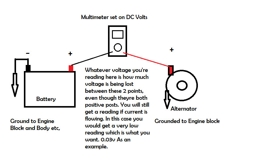

I would do a voltage drop test on these circuits from the Battery to the DME and see what you have. The Crank and Cam codes can be keeping this thing in Limp Mode to prevent Catalytic Converter damage. But this definitely looks like a voltage issue to the DME (ECM/PCM). Hopefully there's no shorts to ground that have damaged the DME,

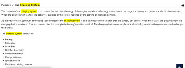

https://www.2carpros.com/articles/how-a-car-electrical-system-works

Oh wow, that is a lot to take in, lol. But with you it is an electrical issue, which is usually not the easiest to diagnose, ugg, I'll start digging and see what i find. Thanks

I'm thinking an electrical issue because of those 2 codes, if you don't have the correct voltage at the points where it needs it, it's going to affect other circuits and any code that points to a power issue with an ECM I would always attack that first because it's the brains behind the whole system. I know electrical issues are a pain, but if you think about it, why are those 2 codes being set? Your first post said that it stays running now. I'm not saying you may not have a Crank/Cam correlation issue, but I would go after the codes that are going to affect the ECM first and get rid of those codes if possible. And if other codes come back after, then attack those. Especially with BMW, everything in those vehicles is pretty complicated, they're not your average bear.
Going through the wiring diagrams, things are labelled strange, some things you just can't tell what the abbreviation stands for, so you have to just follow the wiring on the schematics,
If you wanted to check the crank to cam timing you can scope those sensors and see if they line up properly, but while I was reading, I noticed that with the ECM/PCM power issue code it said that you would have throttle body related codes with it, and you do.

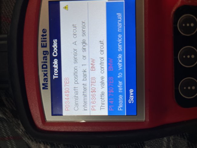

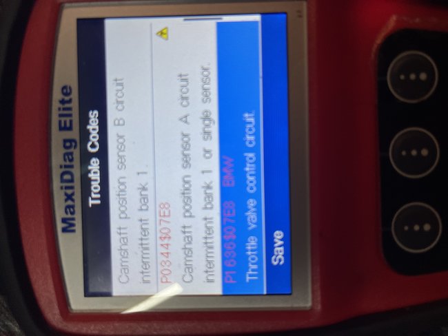

I think it's the third picture, it's a throttle valve code, so all the more reason to make sure the ECM(DME) are in good working order first.
This is just how I would start my diagnoses.

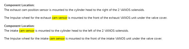

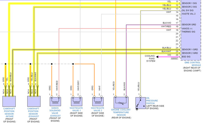

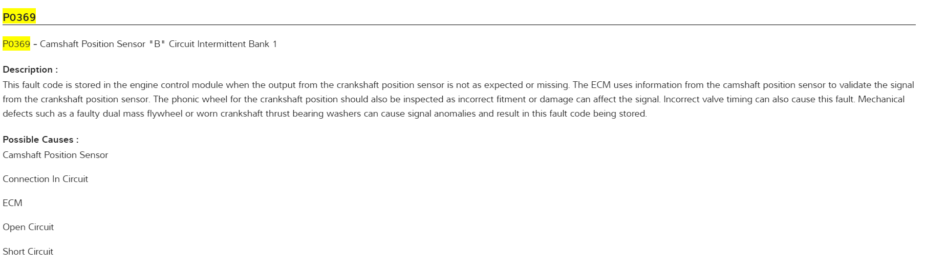

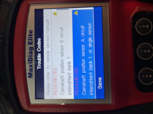

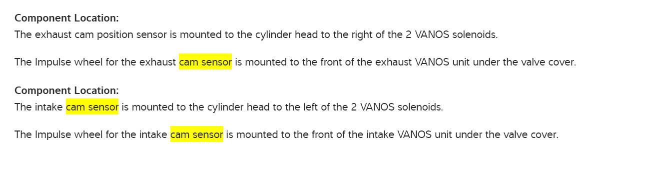

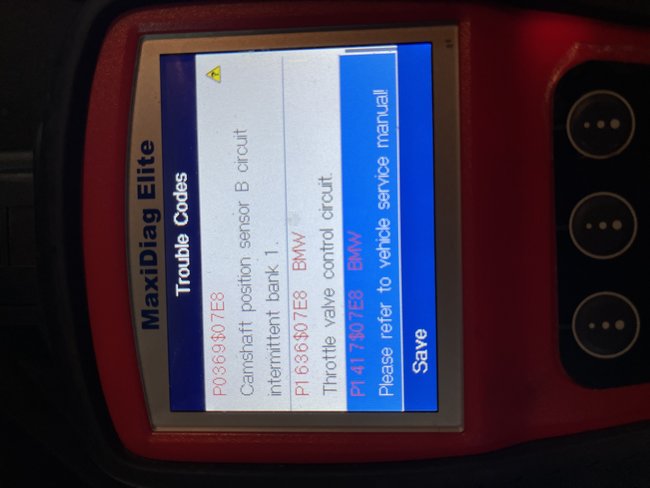

okay. So, it looks like you meant p0369 for that cam sensor. This is the Exhaust Cam Sensor synchronization error.
Are you checking these voltage levels with a multimeter? or just a battery tester?
The 15.2 volts on the charging system is too high for one, and can you check what the actual reading at these fuses is in first diagram, because even the 14.2 volts is still too high. that's a level you would see with a battery that's very low.
But here's the wiring diagram for the Cam sensors so you can check the voltage levels at them as well. They should be 12-volt hall effect sensors. The 15 volts may be causing them to malfunction.
The Orange wires should be the 12v feed to the cam sensors. (Second diagram) and the others are just explaining the Cam sensor location and Code setting criteria.
I want you to also do a real good inspection of the turbo, look for any broken tubes to it or any sensors on the turbo that may have been damaged, like a boost pressure sensor. There's a charge pipe that connects to the throttle body, inspect as much as you can. Look for cracks or anything broken.

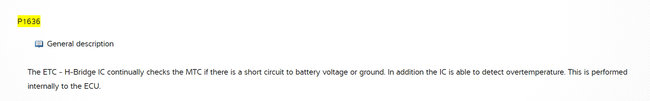

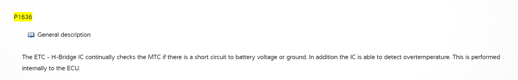

This p1636 has something to do ETC (Electronic Throttle Control) monitoring the circuit for a short to ground or short to battery power. (Last Diagram) The H Bridge IC is a chip in the ECM that does this monitoring. There isn't a lot of information on this subject, except that the ECM monitors this Throttle Control circuit internally and is seeing a fault and possibly an over temperature condition.
Have you tried disconnecting the battery for 30 min or so and trying to reset the system?
I would be concerned with the high charging voltage and checking for any leaks around the throttle body.
Those original codes set for a reason and may not have had enough time to come back yet, especially since the ECM is either in sleep mode or Limp Mode. This vehicle has more than one issue right now, which is making it difficult to diagnose.
Check the Cam sensor voltages and if the DME is receiving that 15.2 volts on its main power feeds, because that's way too high. Look behind the fuse panels for any melted wires as well.

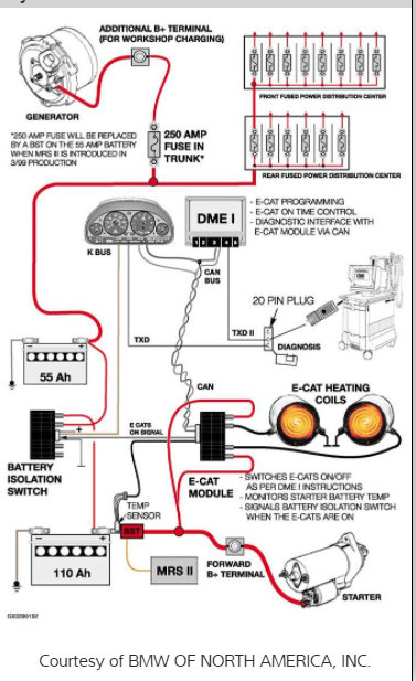

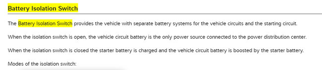

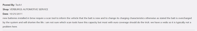

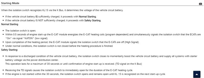

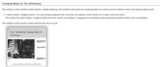

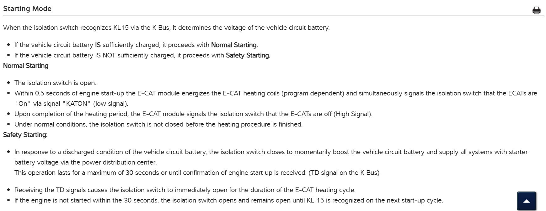

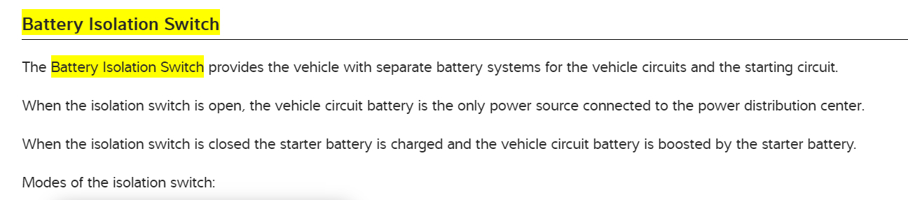

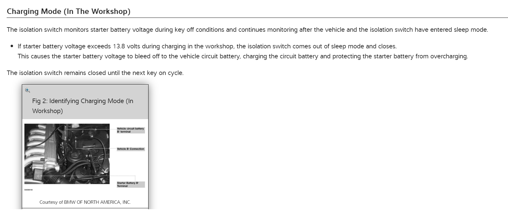

I had thought about this but did not see it anywhere in the diagrams, this car has a second battery, I remember them being a small 12volt battery, almost the size of a lawn mower battery. I don't remember its exact location but here's all the information I found. Things will start to make a little more sense now as to what may be happening.

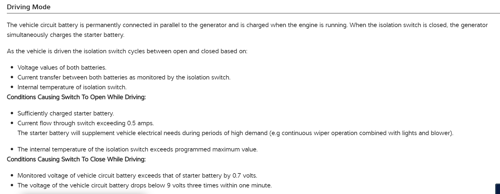

The other battery is a vehicle circuit battery, and the main larger battery is the starting battery, They're switched on when either needs to be charged. I will bet the smaller circuit battery is bad. I think it might be somewhere under one of the seats but I'm 100% sure. It has been a long time since i have seen this issue. But it was in the back of my mind, that there might be a second battery somewhere.
So, this information talks about an Isolation switch that can turn on to charge or not charge the either battery.
This might be one of things, that if you called a dealership and just asked them how much the second battery costs, you could get some info out of them without having to bring your car there.
I also made a goofy little drawing which ill post last to show you how to do a Voltage Drop Test with a multimeter if you're not sure. It's an invaluable test that I use all the time and is best because you can run the car, so the circuits are loaded and do voltage drop measurements to find problems quick. Please excuse my drawing, it was just easier than explaining it.

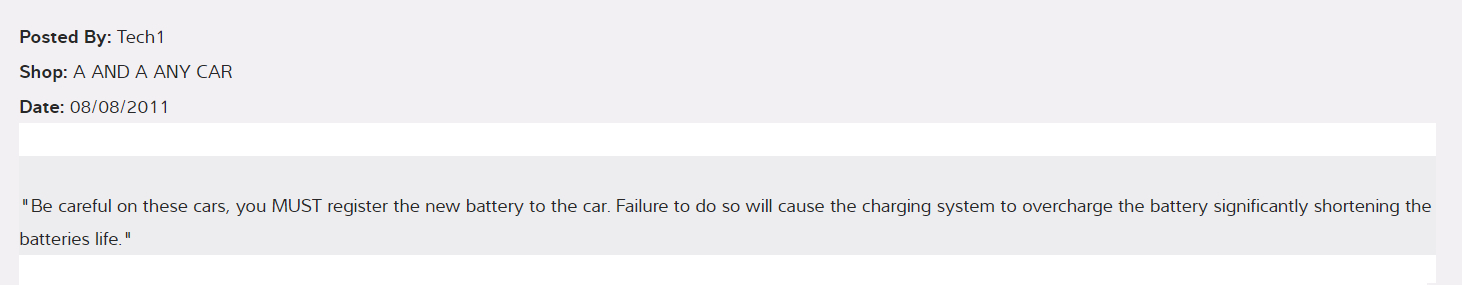

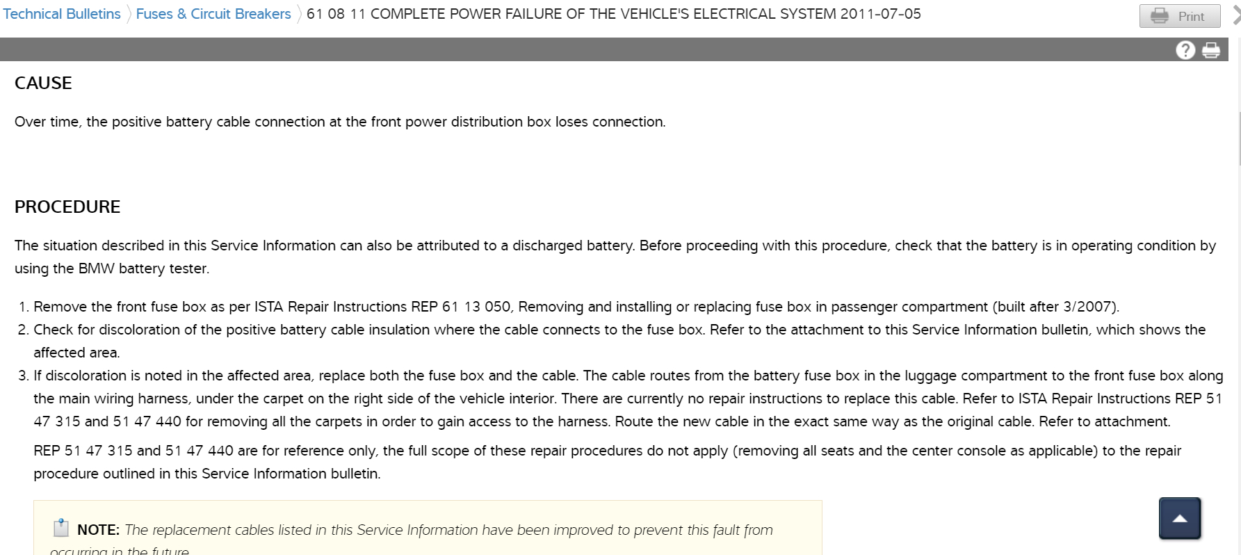

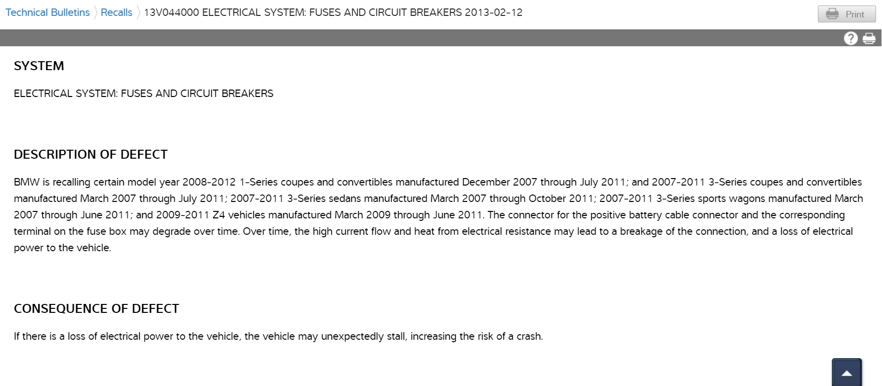

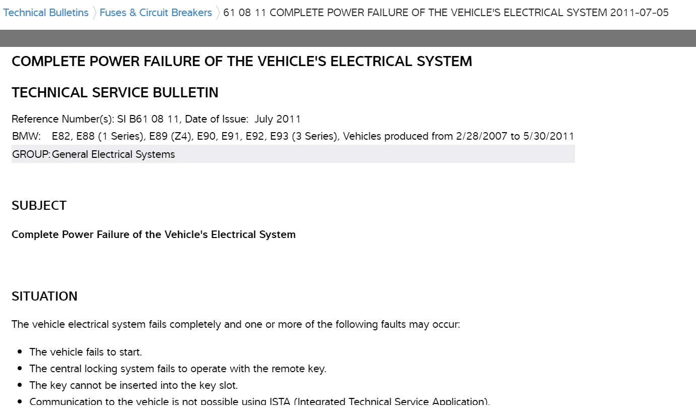

Well, it was listed under this model BMW, so I'm not sure then. You can check powers and grounds on the cam sensors, but to see if they're in sync you'll need at least a 4-channel scope to watch all the cam and crank sensors at once to determine the sync. or if the cams are advanced or retarded too much (late timing). But that still doesn't explain the charging issue.
The information I read said that the ECM looks for the Intake cam sensors to sync and if they don't it goes to the exhaust cam sensors to see if they sync and repeats this process until it sets a code. Did you check to see if there's 15volts going into the DME? or check the Grounds?

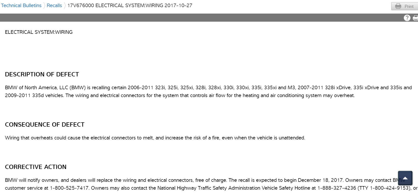

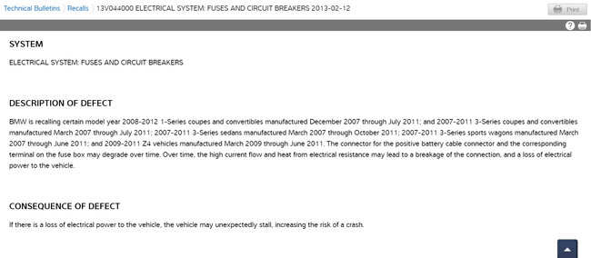

There's a ton of Technical Service Bulletins on electrical failures.
And if the car is in sleep mode, it's not going to show any other codes if the ECM isn't functioning. Those cam codes are hard faults that's why they're showing up. But at least check the sensors for power and grounds before replacing them. Or you could do it the old fashion way and pull everything apart and line up all the timing marks. If its circuit/harness issues though they will line up fine, It's in sleep mode to protect the Catalytic Converter from damage due to the fault codes.

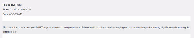

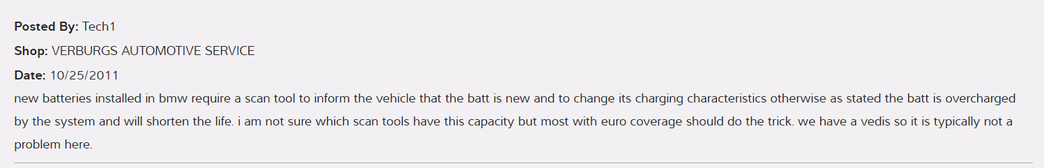

Have you replaced the battery at any point during this? I'm finding some Tech Tips here as well.

Did not replace the battery, it tested fine and even with the drop test it is fine. I can tell it is strong, and it looks new.

Cam sensors are okay. Replaced alternator as it had a loose positive cable stud and ton of oil in it, still same issue, replaced the throttle body from another car, same issue. I will check volts at alternator to see if its steady, how can i check volts at the ECU or make sure this relay is acting like it should?
Oct 20, 2021 at 10:09 AM
DIVIDES
  • 903 POSTS
Is this a cut wire at the positive jumping point am looking at? Could that be it?
Oct 20, 2021 at 11:33 AM
AL514
  • 5,668 POSTS
Yes, a broken wire could definitely be the issue. If go back to page 1 i put all the diagrams up for you, I will post them here again, first picture is ECM powers and grounds, second picture is the DME relay, if those fuses have power the relay is working correctly.
Those fuses #F37, F39, AND F4 go to the DME.

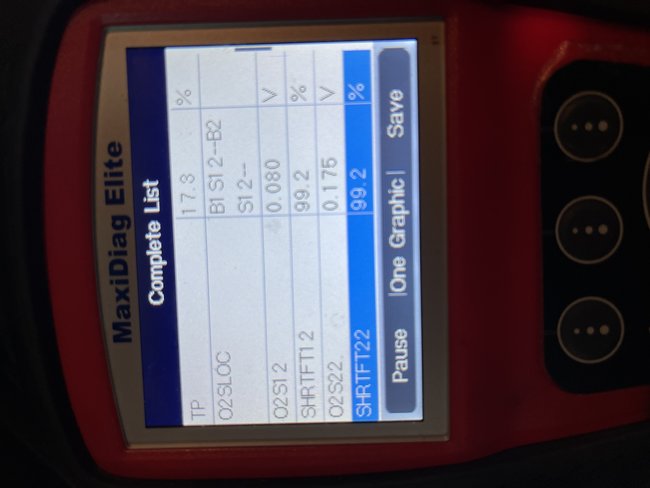

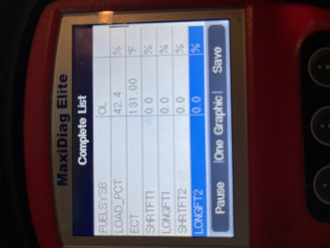

I have a smoke machine, couldn't find a thing, also tried the water test. Just strange. I am now thinking it could be fuel related. Anything you see here out of the ordinary? Car running. For once i had a fuel related code, the other ones just keep coming back, throttle and can sensors.
Oct 21, 2021 at 3:03 AM
AL514
  • 5,668 POSTS

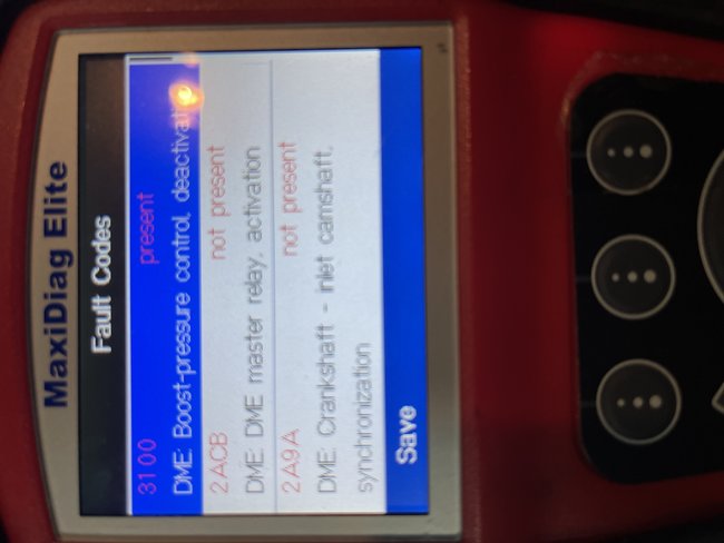

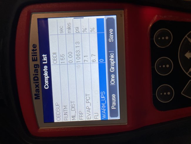

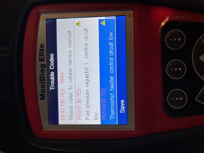

Okay, i do notice some things here, the first thing is, is this data while the car is at an idle? Just sitting still not driving, correct?
The next I notice, and this is strange, is that your rear 02 sensors short term fuel trims are reading 99% on both banks, but the actual fuel trim on pic 4 is reading 0,% actually they're all reading 0%, they should be reading something if the car is running, the system is saying open loop, so you defiantly should have some type of fuel trims. The fact that its reading 0 on all 4 is not good.

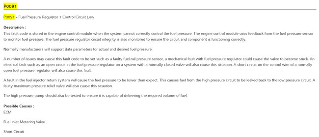

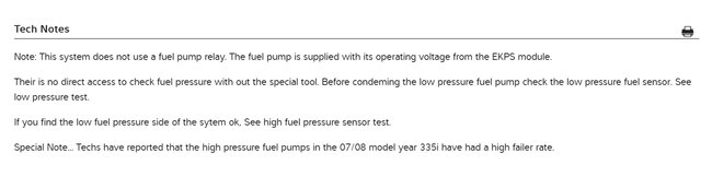

I'm posting some information on the p0091, I know this car has a High Pressure and a low-pressure fuel pump. Which is that reading of 1063psi, which seems low to me, but I cant find a spec for that. But you need special gauges to test the High-Pressure pump.
But here are some tech notes and precautions regarding this code.

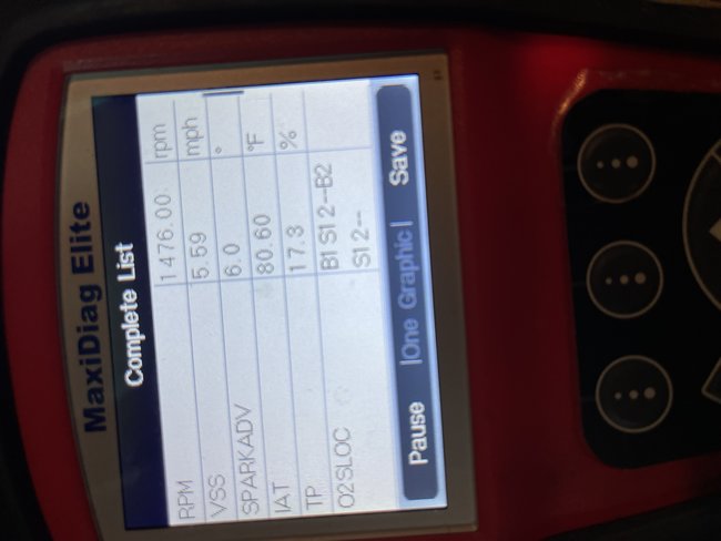

The reason i asked about if you were driving while taking this data is that the VSS in picture 3 says you're doing almost 6MPH?
So, if you're getting a reading like that and not moving, plus now you're getting all these different codes, completely different from before except the cam codes.
I'm wondering if the high voltage of 15+volts damaged the DME (ECM). You're getting some crazy data here.
Not having any fuel trim numbers is bothering me to,
It's like the car has no control over certain systems.
Did you check the ECM powers and Grounds while its running?
I mean you didn't have a thermostat code before either. This is turning into a rabbit hole type diagnostic here. The p1417 code is Throttle Control Incorrect Air Supply, which goes alone with the p1636 code.

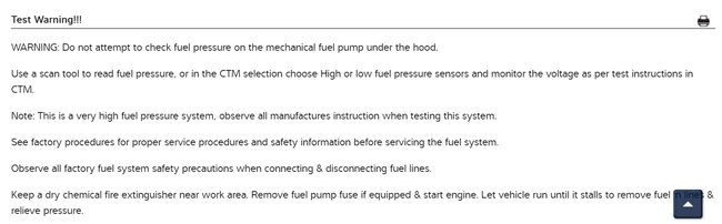

I would say that the High-Pressure Fuel pump should be checked because when they fail, because it's under such high pressure, they come apart and send pieces of the pump into the injectors, metal particles,
But you can't just put a regular fuel pressure gauge on there, 1,000PSI will do serious damage.

no, don't check the rail pressure unless you have the correct tools for that. If it's a high-pressure fuel system, it can be up 2,000-3,000-PSI in some cars. If there's no coolant in the car, that can cause it to hunt for an idle. Was that not checked before? Get the coolant filled and bleed the system and then run it, the coolant temperature sensor cannot read air, so the DME doesn't know where the fuel strategy should be. fix that first. You have to make sure all the basics are okay first.

My concern was that the VSS (vehicle speed sensor is reading almost 6-MPH, but the car is not moving. Thats not good. Thats another error going on here. If the vehicle thinks it's moving but it's actually not, this will also cause Idle issues, because the data is not adding up in the DME (ECM). This another thing that needs to be addressed and find out why its reading 5.5-MPH. it doesn't matter if it's revving up and down, it still should read 0-MPH.

Is your live data still reading anything on the VSS? And you checked for battery voltage at the DME itself?

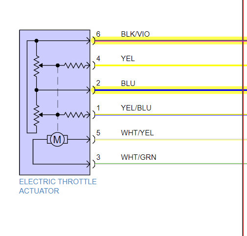

Here's the actuator control diagram the black/violet wire is labelled Throttle Ground,
the blue wire should be a 5-volts or 12-volts reference.
Yellow and yellow/blue are the signal wires going to the DME for the Motor Actuator.
I'm not saying the DME is bad but you're still getting codes for voltage issues. You should also load test the Block Grounds and to the frame, using a 12-volt light bulb is good for load testing circuits. Just connect the lightbulb to battery positive and touch the other wire to the engine block and frame to verify with loaded circuit tests.

It's hard to tell exactly where this speed data comes from. BMW isn't very giving when it comes to system diagnostics. I'm still looking for more information
And are you able to scan the ABS module for codes or just the ECM?
And it's not just about the reading of mph at a standstill, you had voltage codes to begin with that you cleared. Replaced the alternator, now have different codes on two different occasions.
There's a bigger issue going on here, it's not just one sensor causing all this. You have got strange live data, vehicle speed without any actual, no fuel trim numbers, voltage codes for the throttle actuator, fuel pressure codes, cam sensor codes,
You may have to look at the CAN bus network to make sure modules are communicating with each other. There are way too many codes and odd data to give you any definite direction here.
When I see this much going on, there's usually an issue with main Ground connections or something to tie all this together.
Not just randomly shooting in the dark here. Did you check any voltage levels at the Throttle body?
