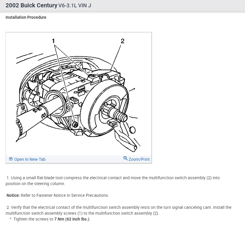

Driving at night head lights went out, had to pull forward and constantly hold lever switch towards me to get bright lights to come on ,that is the only way I could get any headlights. I think the
Multi-function switch is bad, it does not clink and stays in place.
If it is the switch, can a 1999 Buick Century with cruise control switch be used on a 2002 Buick century without cruise control?
Aug 6, 2022 at 3:10 AM
SQM
  • 6,383 POSTS

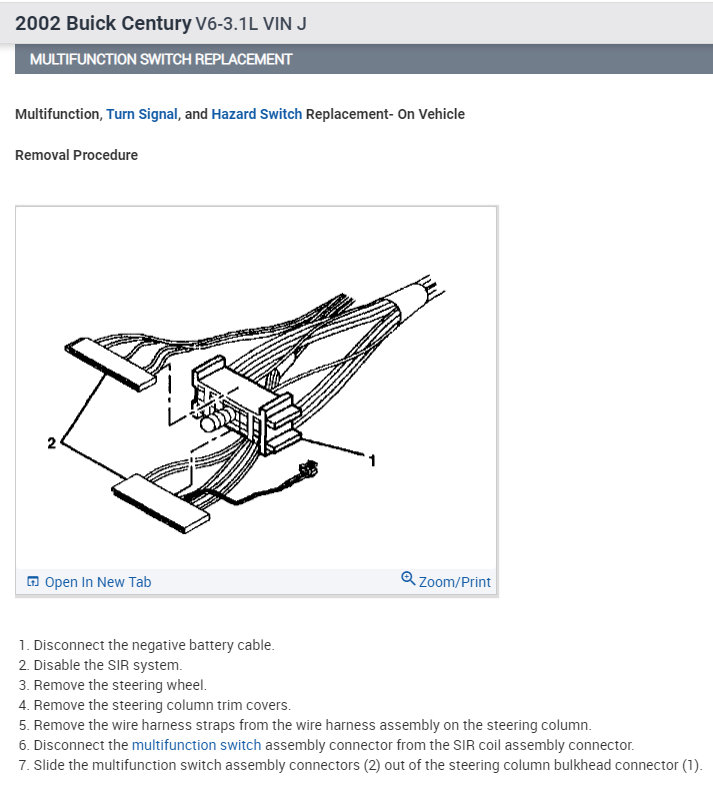

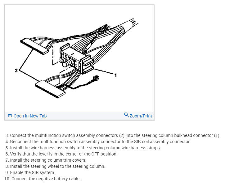

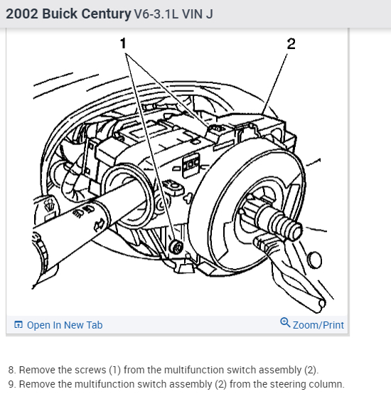

The electrical connector for the switch with and without cruise is different, you won't be able to simply just plug it in.
I have attached the replacement steps below for your reference.
Let me know of any questions.
Aug 6, 2022 at 7:06 PM
