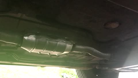

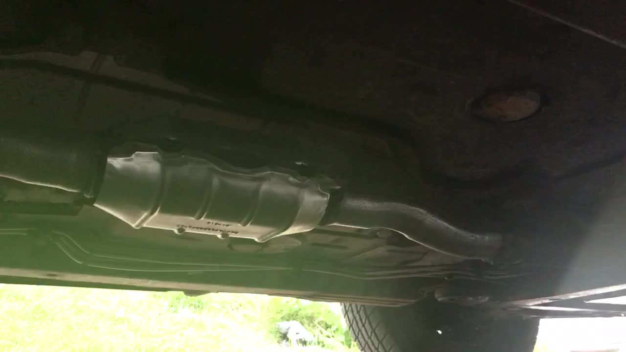

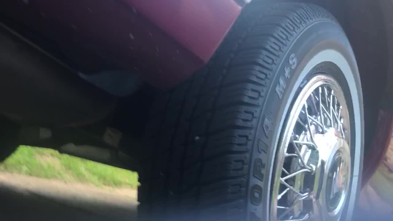

In this video you can see what seems to be making the noise when vehicle is off. All other portions of exhaust is okay. Catalytic converter outer cover is tight and not loose. It’s the muffler that is making the noise.

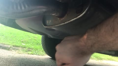

In this video the hangers seem to tight but the muffler moves back and forth. Is it supposed to have some tension making the muffler have some movement back and forth When I rock it or hangers are probably getting worn?

And for the catalytic converter. It’s new and nothing seems to be loose, cover heat shield is also tight. When I smack on the catalytic converter it makes noise from the back muffler which I said in the first videos with the muffler.

It's hard for me to tell what I'm hearing simply because I hear you tap on it only. It does appear to be bumping under the bumper, but that wouldn't explain why you hear it with the engine off.
As far as the hanger, that is normal. It's mounted on rubber and it's meant to move like that.
I know that steel will make a noise when it cools and contracts. Is that what you hear or does it seem to be something in the exhaust? Other than it may be hitting the underside of the bumper, I see nothing out of place.

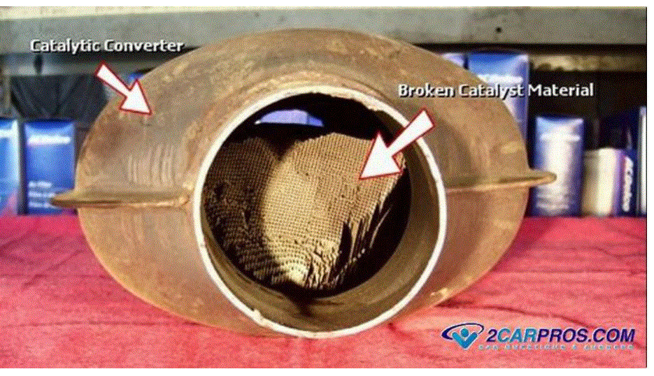

Nice to hear from you. It sounds like an issue with the inside of the catalytic converter or muffler. They can come loose and make noise. The components (exterior) are tight, but the noise comes from inside. Or, it can be coming from a loose heat shield on the exhaust.
Now, have a helper take a rubber mallet ad tap on the exhaust (start at rear) while you listen to see if you can hear the noise. Do this with the engine off.
If you look at the attached pic, it shows how the internal components can fail.
You mentioned earlier that the sound came from back near the muffler. Check back there and see if you can confirm the sound. If you can record it and upload it for me to hear, it will help. You should be able to record it with your phone.
