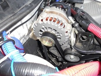

on my way home tonight my car started over heating, I popped the hood and found my belt off and my alternator laying off to the side from where it is mounted. Can I pull the 2 polley's off and replace mounting brackets or is this particular alternator brackets part of the engine? It has Ram Air .... I don't know if that matters

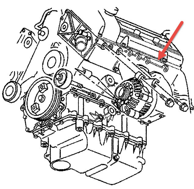

alternator and bracket seem to be combined on this with only bottom bolt going to a bracket. this is for a 3.5L so yours may be different.

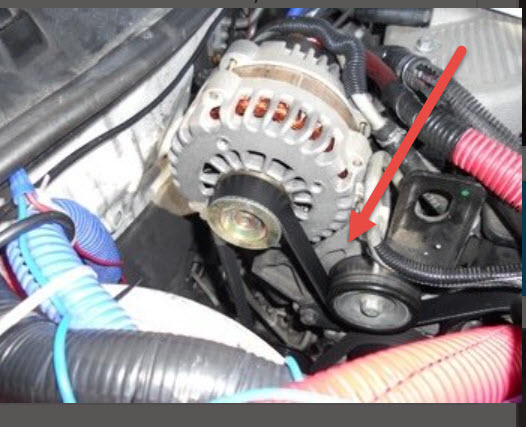

unfortunately this isn't close however, the picture below is... the alternator is mounted on a piece behind top polley... Is that replacement or is it mounted to motor ? I need to figure out if I am able to pull the pulley and replace the mount?

the piece in pic with arrow is a bracket that mounts to motor if it's broken then you might be able to get it welded the bracket if this is a 3.4L is 25.43 at gm parts direct .com plus shipping.
