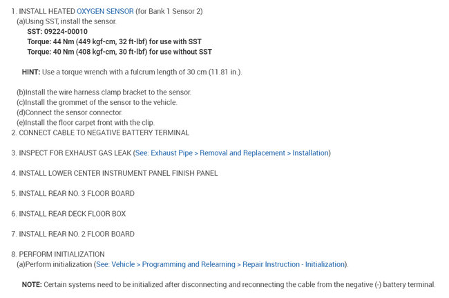

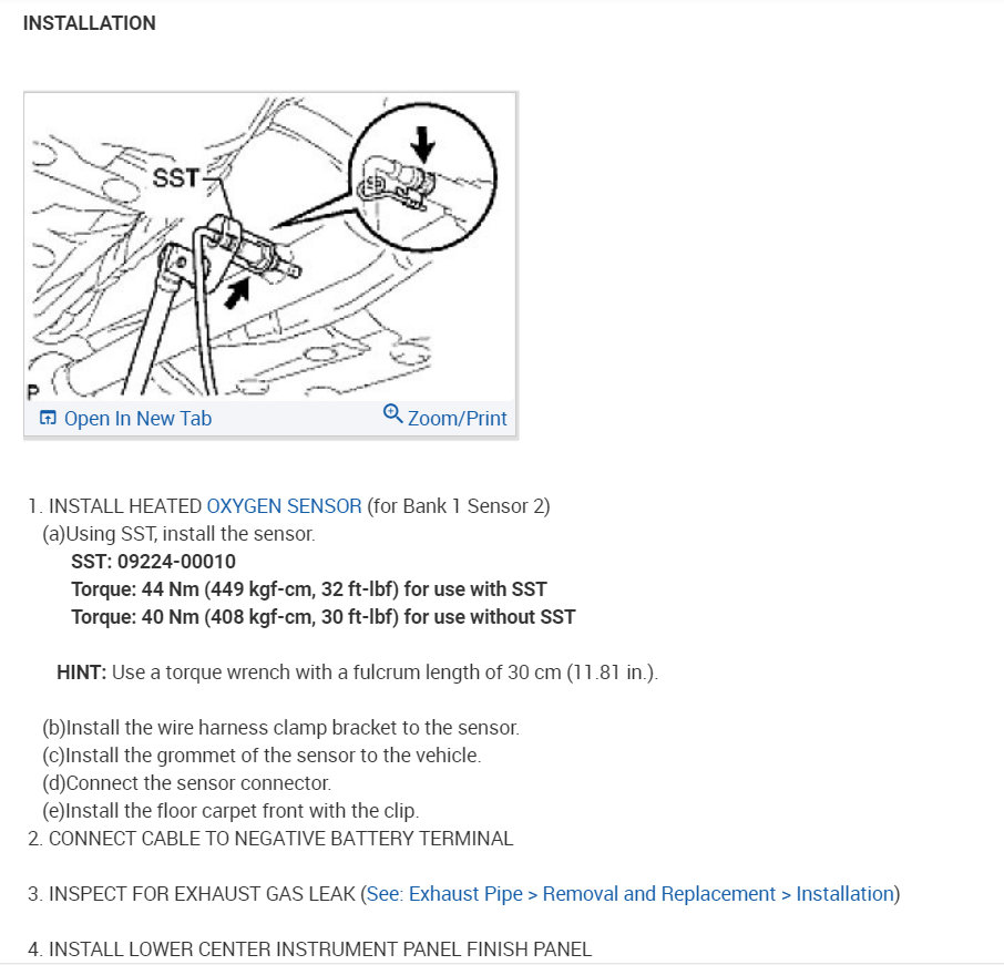

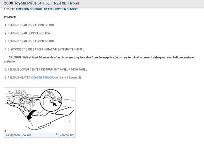

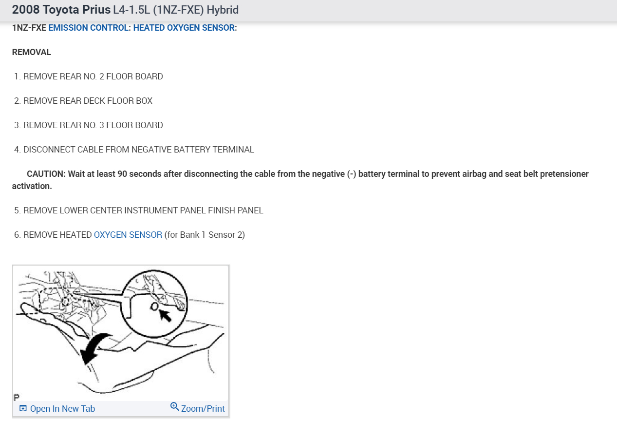

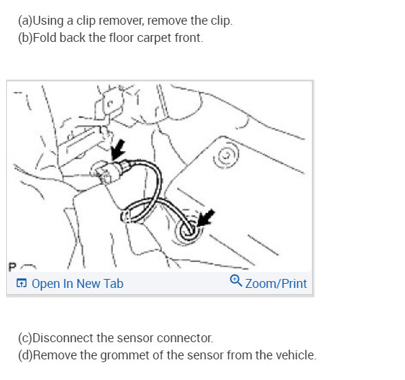

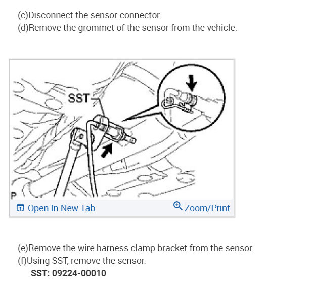

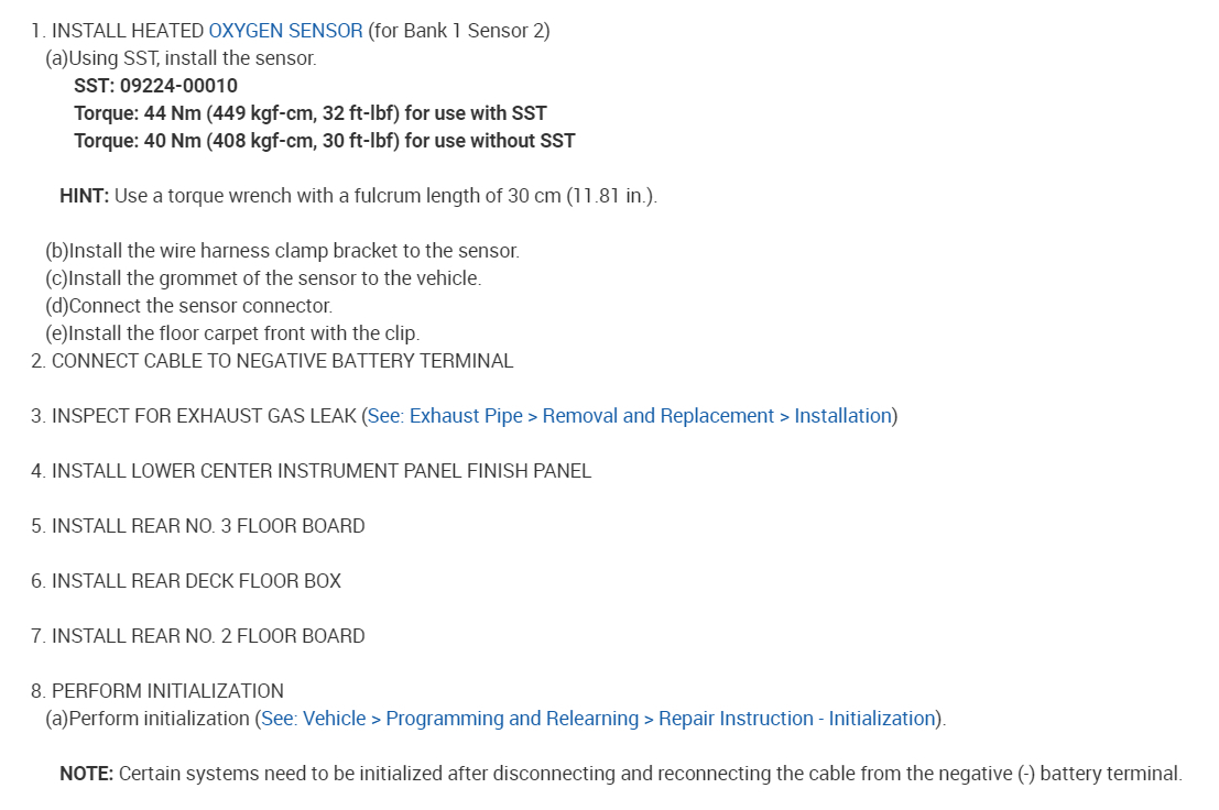

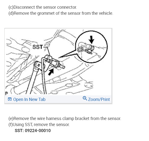

Heater Control Circuit Low (Bank 1, Sensor 2) and P0138 stands for O2 Sensor Circuit High Voltage (Bank 1, Sensor 2) So for sure the post catalytic converter oxygen sensor is bad. I would replace the sensor first to see what happens. here is the location of the sensor and how to change it out in the images below.
