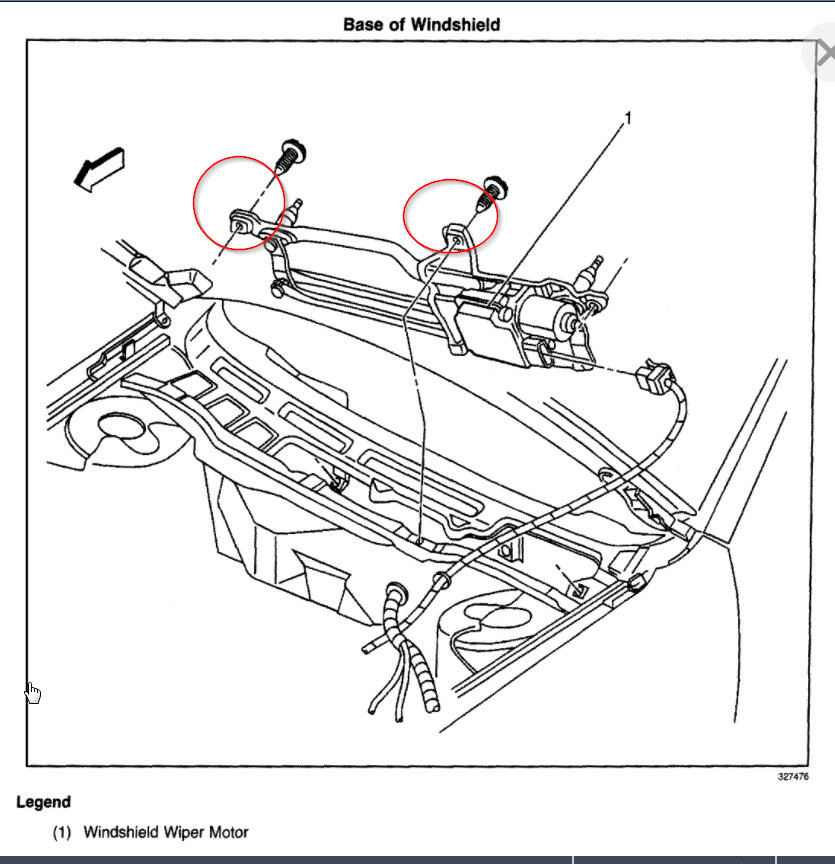

My windshield wiper motor park tab is broken. what part to I need to replace that has a new motor park tab on it. thanks
Feb 7, 2021 at 2:30 PM
Can you get a picture of the park tab that you are referring too?
I assume you mean the tabs that the motor uses to hold the assembly in place but the park tab, I am just not sure what you are referring too. So seeing a picture will help.

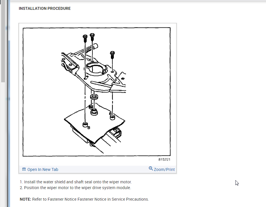

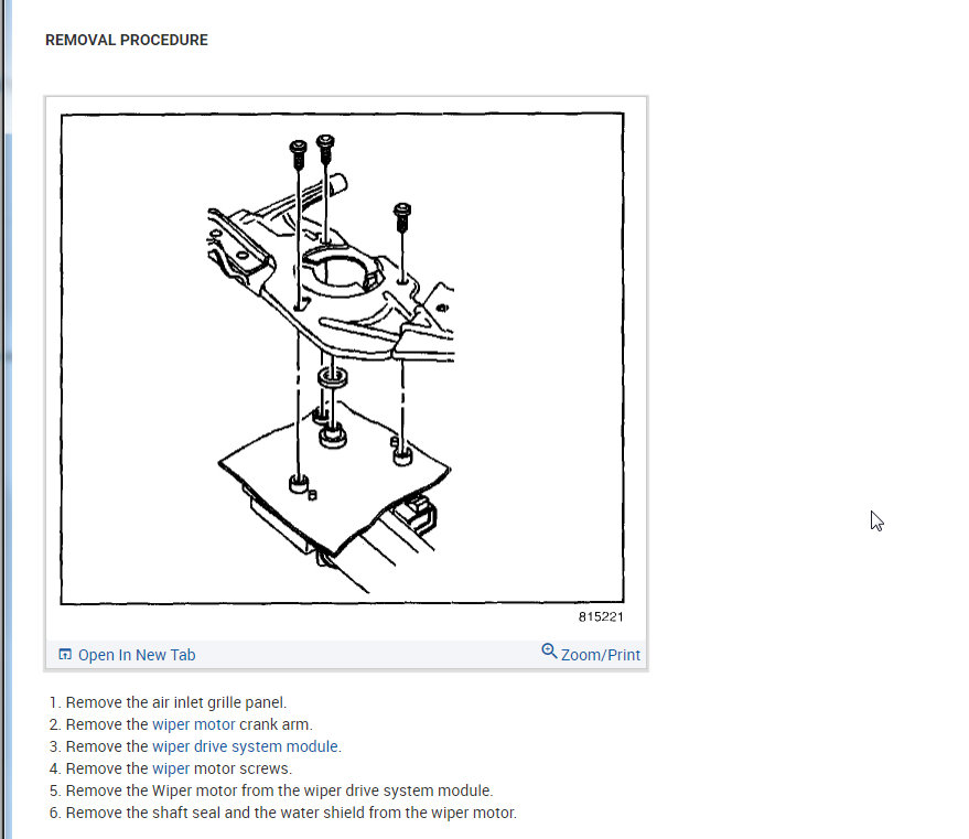

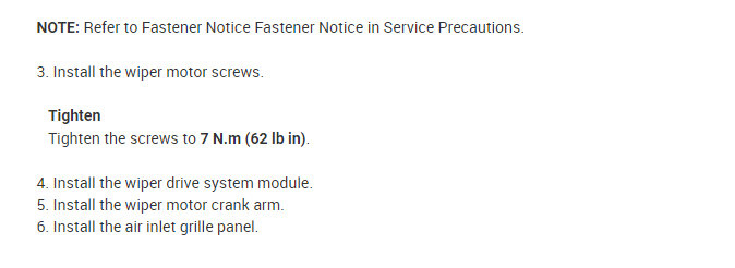

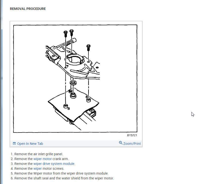

However, below is a process from the manual on how to replace the motor so let me know if you see the park tab that you are talking about. Thanks
