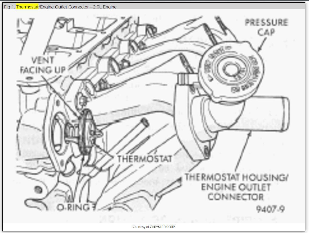

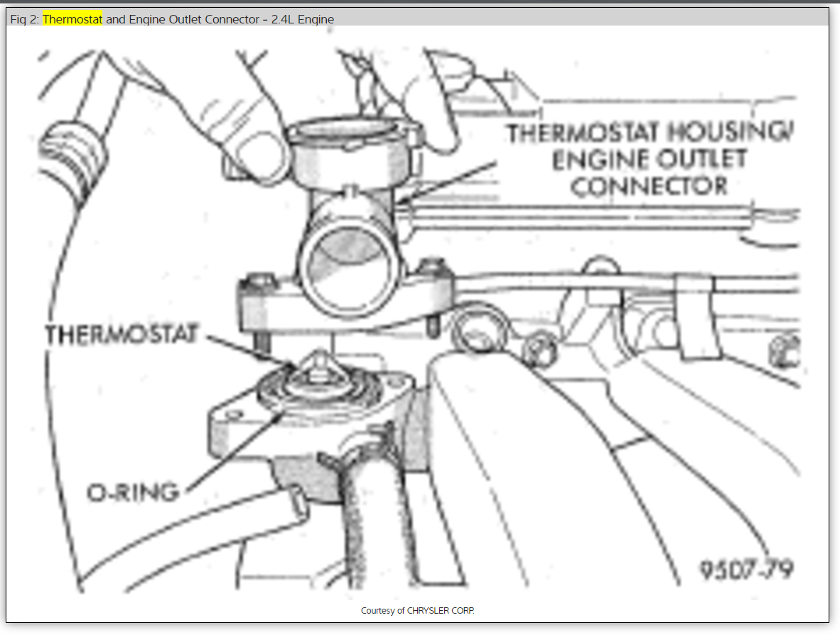

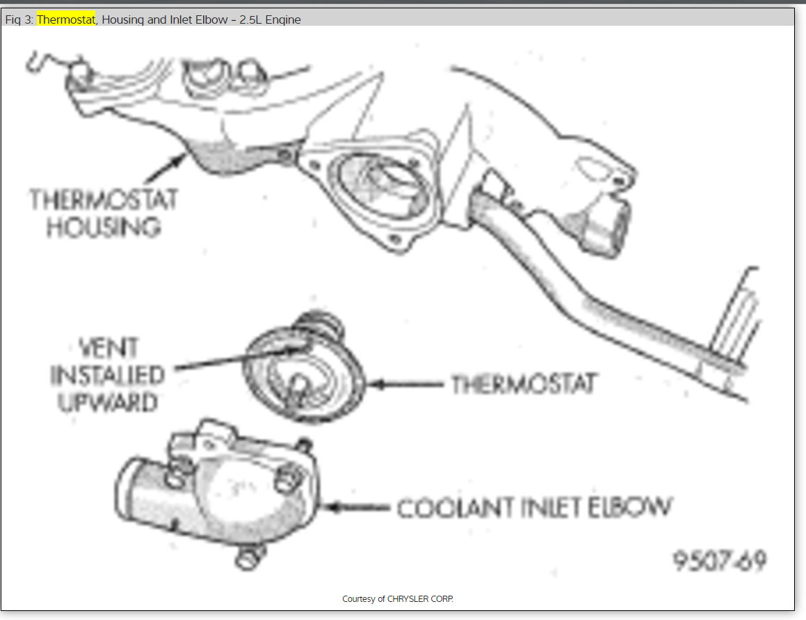

The monitors keep tripping to not ready.
Aug 24, 2017 at 6:10 PM
  • 55,224 POSTS
The main reason for the monitors not to set is a thermostat that is stuck open and the engine does not warm up within the prescribed time.
Here is a guide that will help you confirm the problem:
Here is what it will be like on your car.
