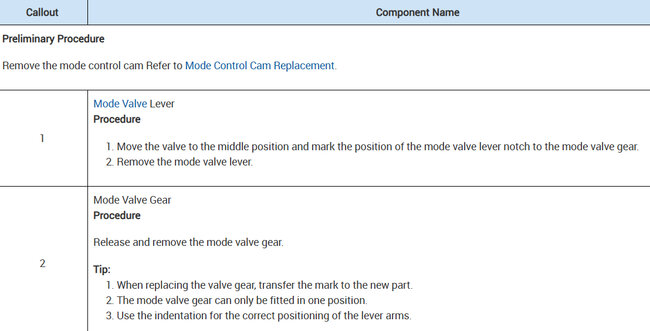

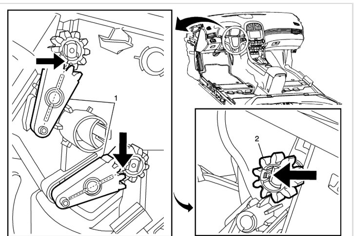

One of the HVAC door gears was stripped and needed to be replaced. Because of the location it’s hard to tell what the proper alignment should be when I replaced them. Do you have a diagram showing me the positions of the gears when installed? The proper alignment so the defrost works.
Aug 4, 2025 at 11:41 AM
  • 55,399 POSTS
Yes, the gear has a little notch on it so that must be aligned with pivot gear. Here is a diagram to help with the repair. Check out the images (below). Let us know what you find.

I cant seem to line upproperly to get the defroster door to open and blow feet works face works not defroster

Generally I'll grab an inspection mirror or a camera and use that to check the alignment if I cannot see it. However if you have the feet and dash but not the defroster you may have a damaged mode cam or mode door. What has been done so far and is your vehicle the exact same year, make and model?
