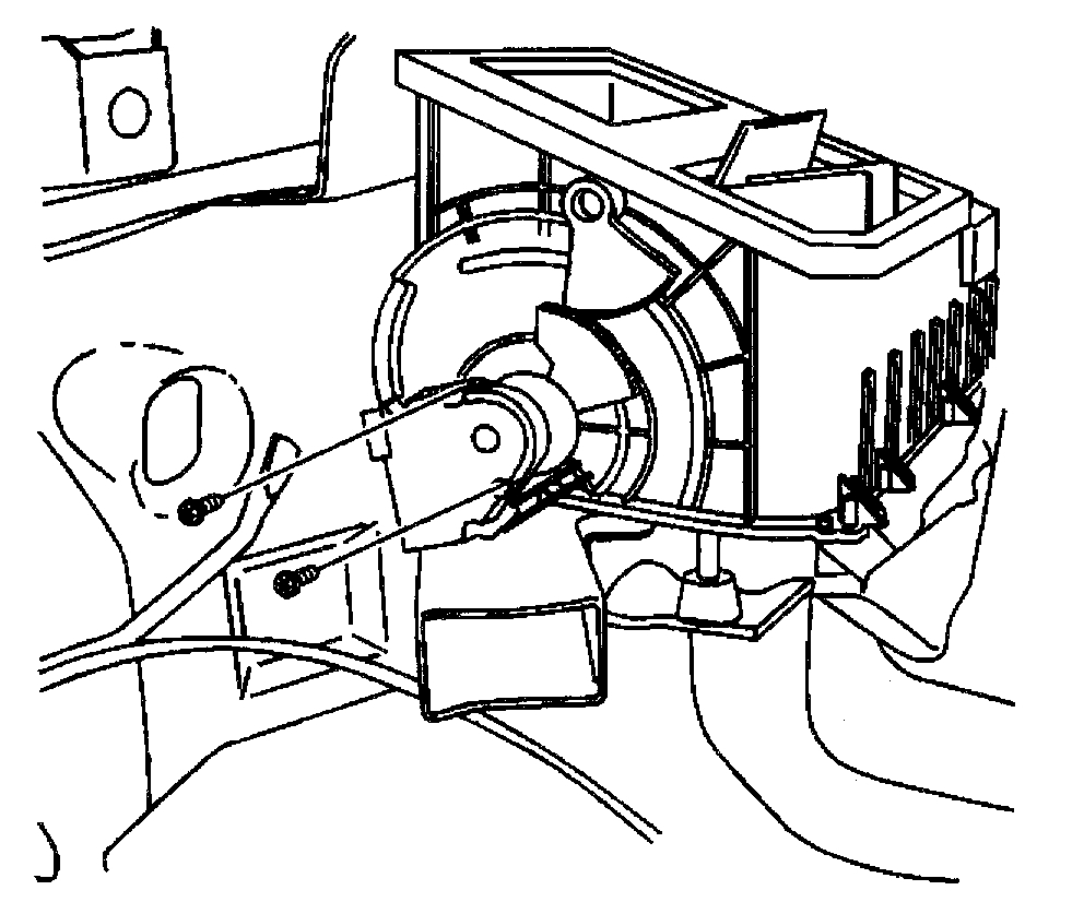

I can turn on the air or the heat and it won't blow out the cabin vents, but it has very low air flow coming through the vents going to the extended cab part of the truck on both defrost and your normal vents. Also no air or heat coming out of the floor vents either.
Friday, April 30th, 2021 AT 11:05 AM (Merged)
  • 109,885 POSTS

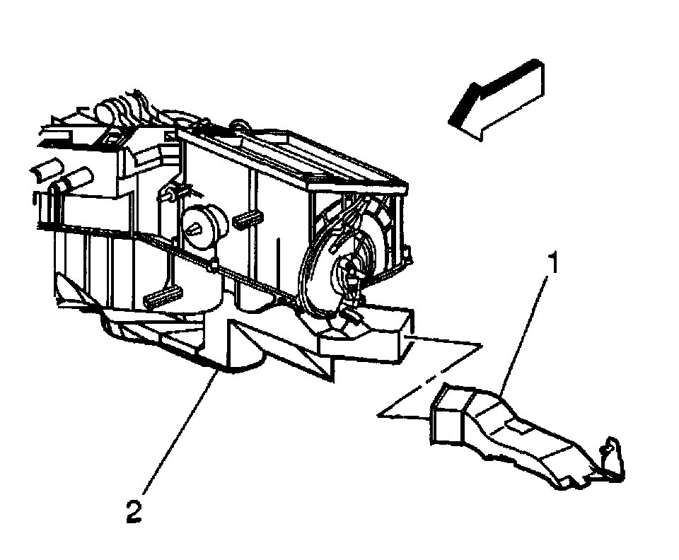

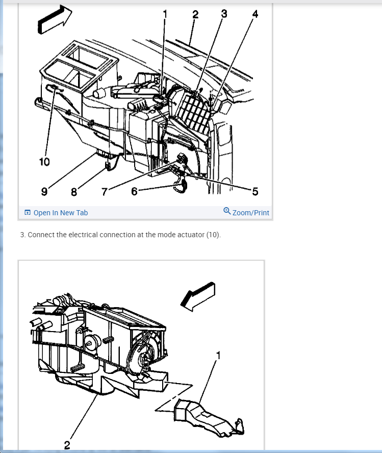

If you are unable to control the air flow direction, chances are there is an issue with what is called a mode door actuator. This actuator is responsible for directing air flow to the requested location.
If you look at pic 1, it shows the location of the mode door. What I would like you to do is remove the actuator and check to see if it moves when you change air flow directions. Also, make sure nothing is disconnected or damaged.
To access and remove the actuator isn't too hard, but will take more than a minute. Here are the directions for replacing the actuator. Before replacing it, check to make sure it isn't working and make sure nothing is disconnected or damaged. The attached pics correlate with the directions.

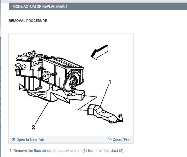

pic 2

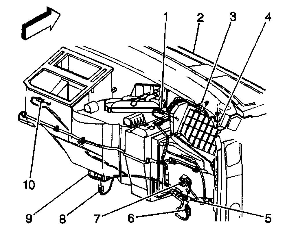

1. Remove the floor air outlet duct extension (1) from the floor duct (2).

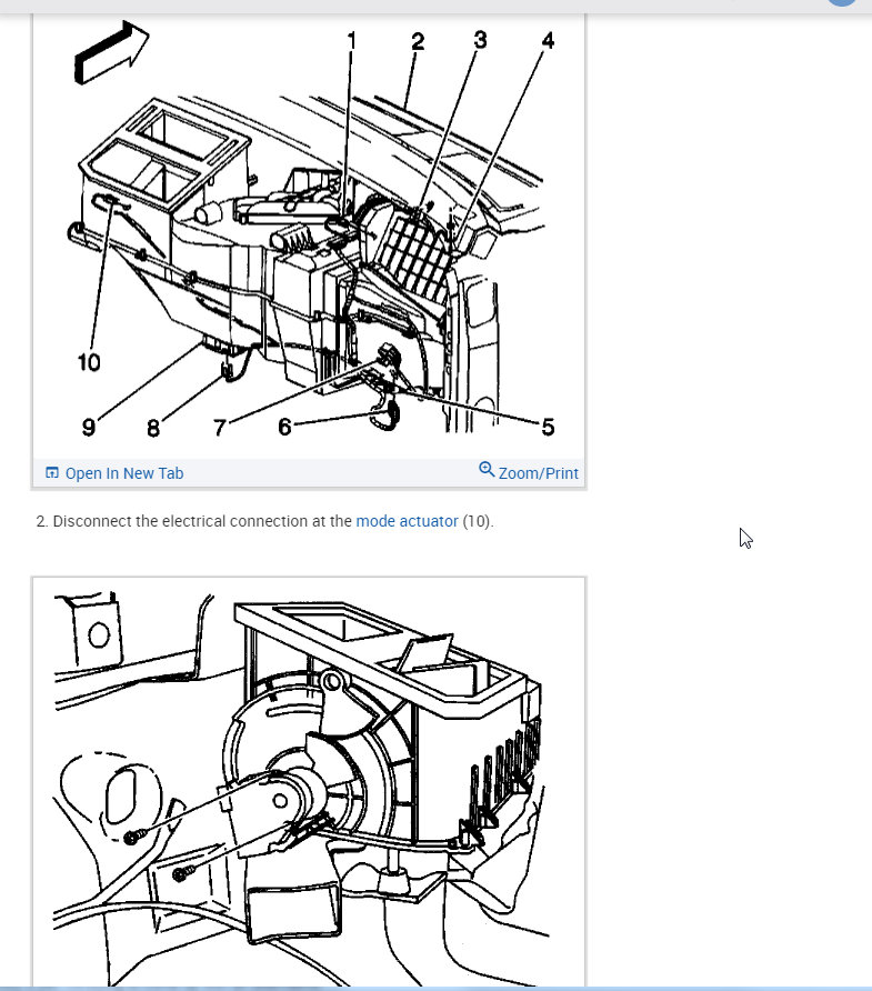

Pic 3

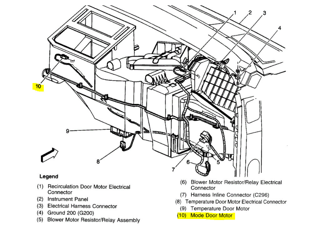

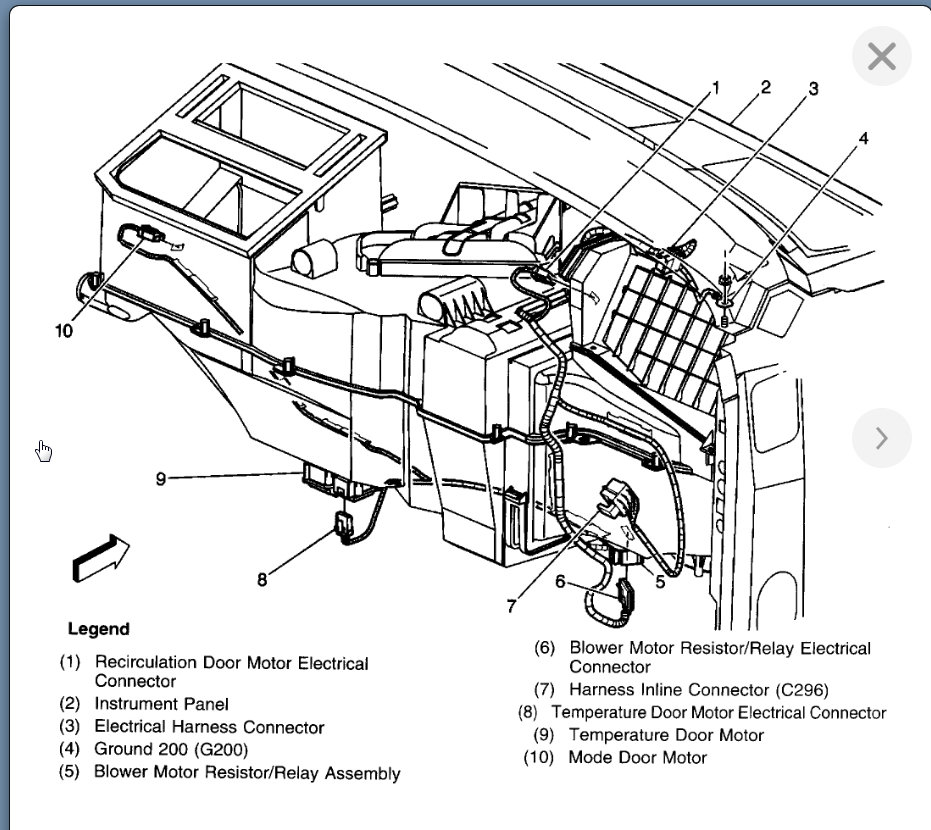

2. Disconnect the electrical connection at the mode actuator (10).

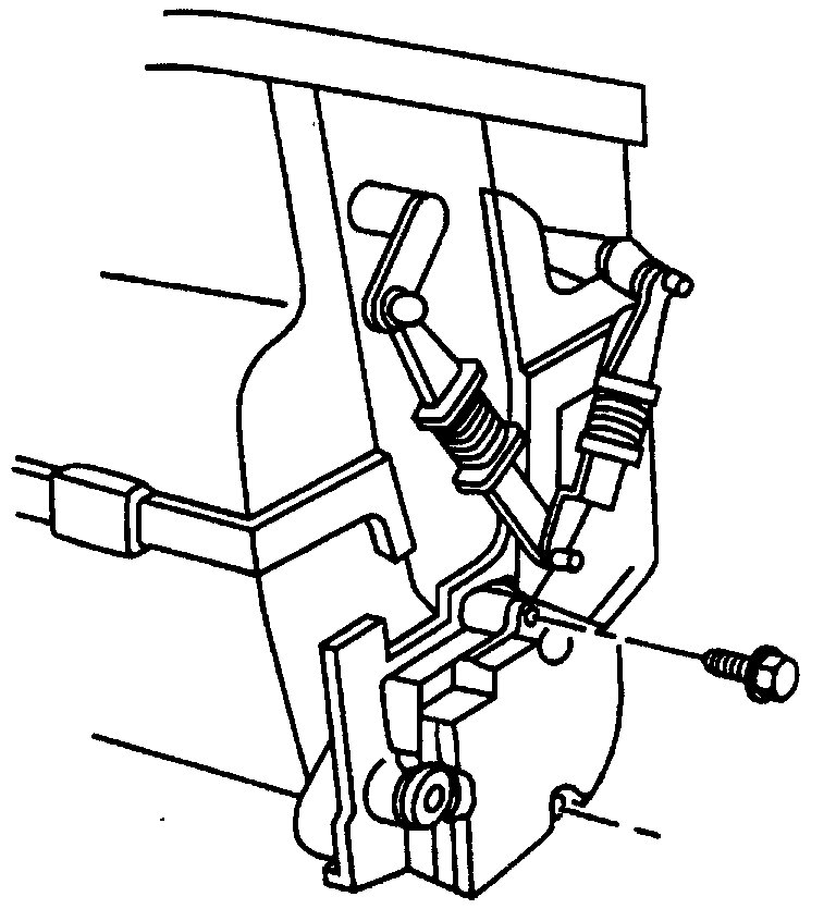

Pic 4

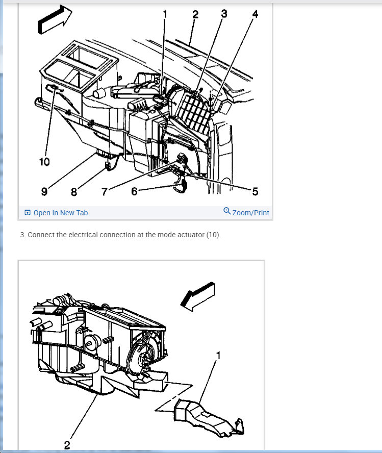

3. Remove the mode actuator mounting screws from the HVAC module.
4. Remove the mode actuator as an assembly with the actuator cam.

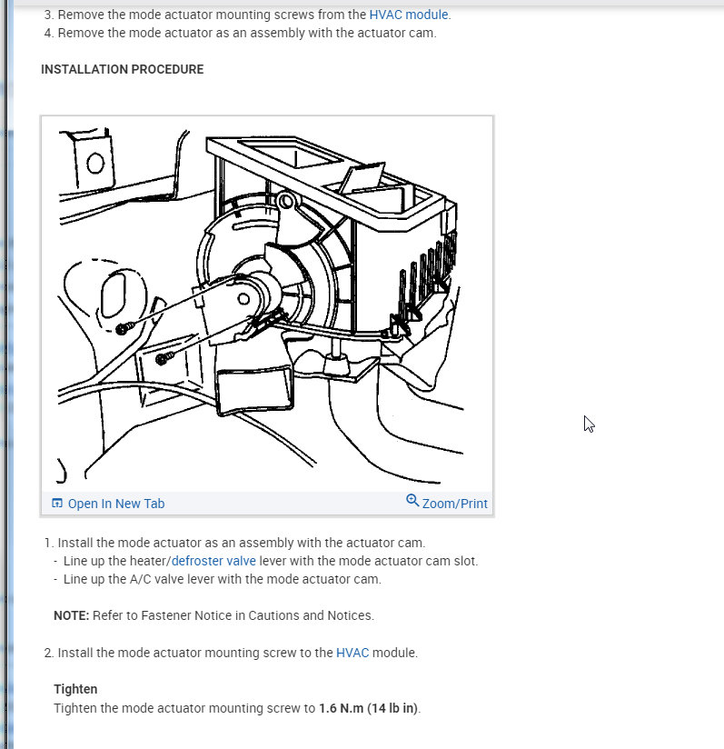

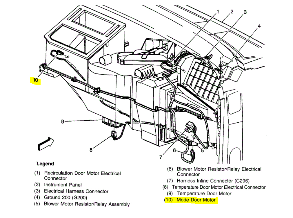

pic 5

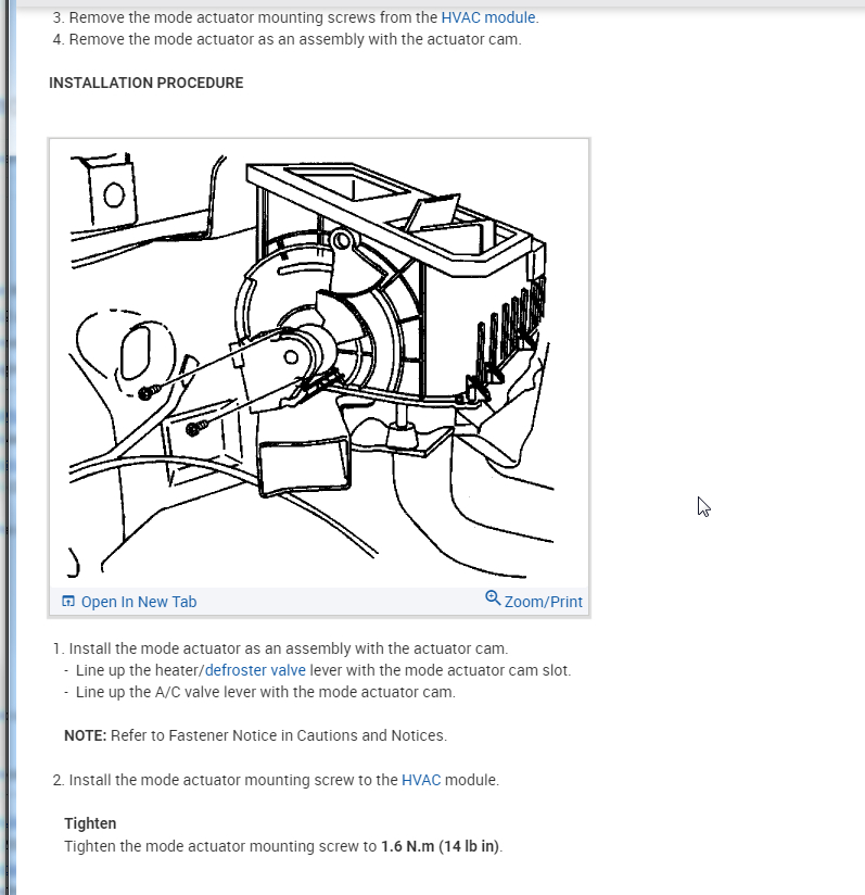

1. Install the mode actuator as an assembly with the actuator cam.
- Line up the heater/defroster valve lever with the mode actuator cam slot.
- Line up the A/C valve lever with the mode actuator cam.
NOTE: Refer to Fastener Notice in Cautions and Notices.
2. Install the mode actuator mounting screw to the HVAC module.
Tighten
Tighten the mode actuator mounting screw to 1.6 N.M (14 lb in).

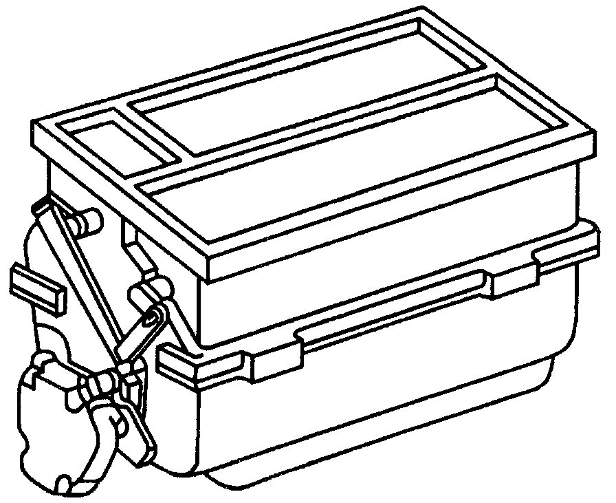

Pic 6
3. Connect the electrical connection at the mode actuator (10).

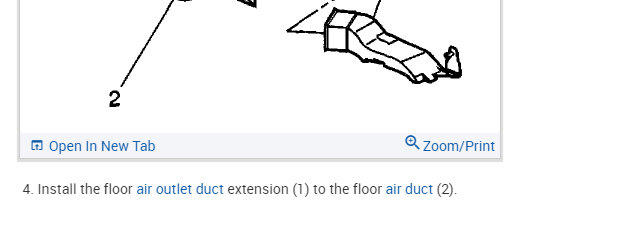

4. Install the floor air outlet duct extension (1) to the floor air duct (2).

Will not change to floor or A/C vents.
Friday, April 30th, 2021 AT 11:06 AM (Merged)
  • 109,885 POSTS
Hi:
It sounds like the mode door actuator isn't working. That is what changes air flow direction. Here are the directions specific to your vehicle for replacing the mode door actuator. The attached pictures correlate with the directions.

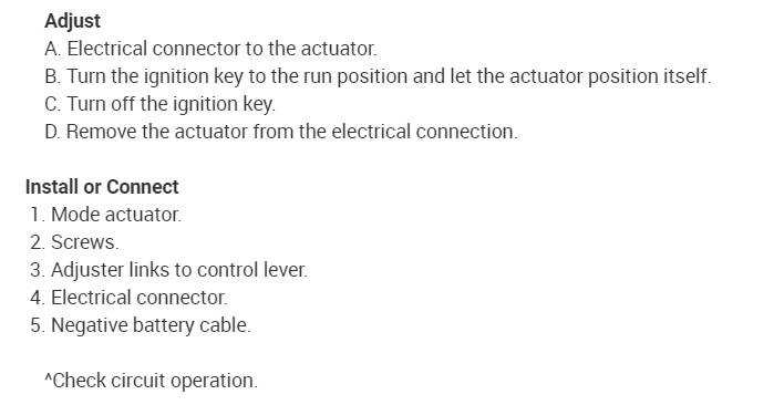

My heater works but I can't get it to blow out the defrost or the dash vents, its stuck on the floor heater. What could be the cause of this? Is it an easy fix or is it better to take it to a mechanic? Thanks for the help.
Tuesday, May 25th, 2021 AT 11:44 AM (Merged)
  • 109,885 POSTS

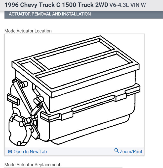

The air flow direction on this vehicle is controlled by a mode door. Based on your selection, the mode door actuator changes the direction of air flow. What I would suggest is to remove the actuator and check it for operation. Chances are the actuator itself has failed.
Here are the directions for removal and replacement. The two attached pictures correlate with the directions.
_________________________________

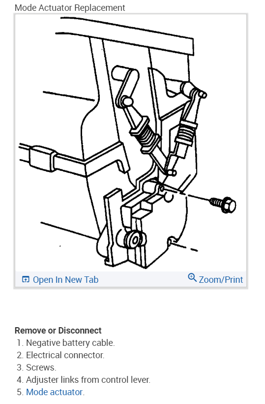

1996 Chevy Truck K 2500 Truck 4WD V8-305 5.0L VIN M SFI
Actuator Removal and Installation
Vehicle Heating and Air Conditioning Air Door Actuator / Motor Service and Repair Procedures Actuator Removal and Installation
ACTUATOR REMOVAL AND INSTALLATION
Mode Actuator Location
Pic 1
Mode Actuator Replacement
Pic 2
Remove or Disconnect
1. Negative battery cable.
2. Electrical connector.
3. Screws.
4. Adjuster links from control lever.
5. Mode actuator.
Adjust
A. Electrical connector to the actuator.
B. Turn the ignition key to the run position and let the actuator position itself.
C. Turn off the ignition key.
D. Remove the actuator from the electrical connection.
Install or Connect
1. Mode actuator.
2. Screws.
3. Adjuster links to control lever.
4. Electrical connector.
5. Negative battery cable.
Check circuit operation.

No start position when reassembling cams. Cams must be in the start position, when attaching new actuator.
