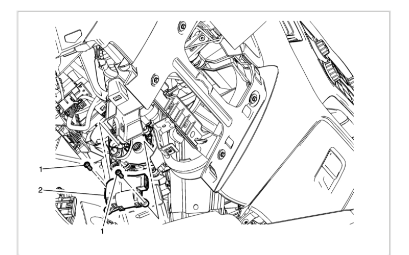

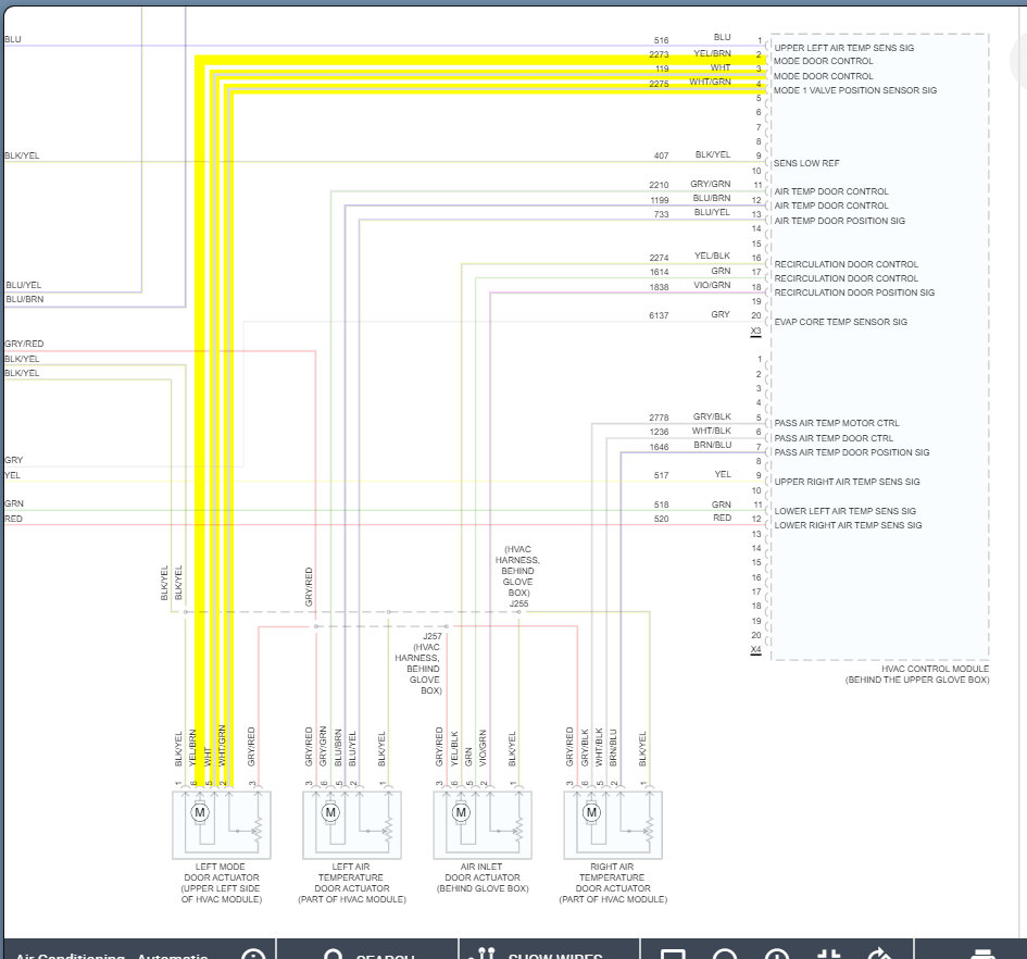

My A/C only blows on vent and so I changed the mode door actuator and it’s still not working, how can I fix it?
Sep 1, 2020 at 9:46 PM
Here is a guide to help you fix it with a video that shows the blend door to give you an idea with the location of the mode door actuator in the images below which is next to the gas pedal as well with instructions in the diagrams below.
https://youtu.be/tY6M92fA2ug
I am attaching the wiring diagram and the instructions on how to replace the mode actuator. We just need to make sure you replaced the correct one because they are commonly mistaken.
If this is the actuator that you replaced then we need to check the voltage coming from the control module because I suspect you have a control module issue.
Please run through this and let us know what you find. Thanks

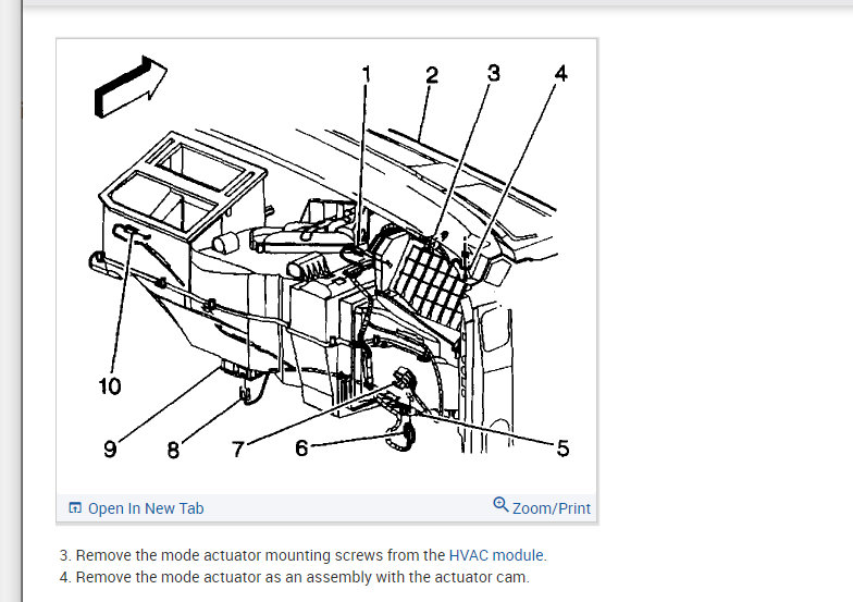

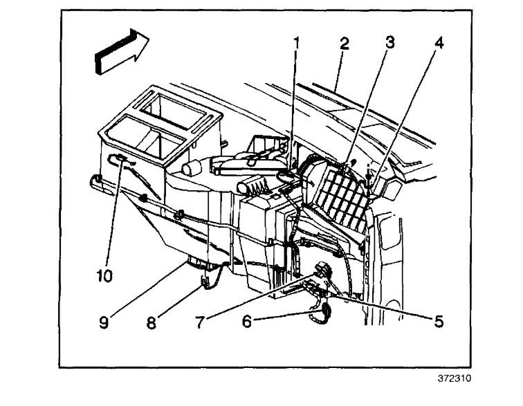

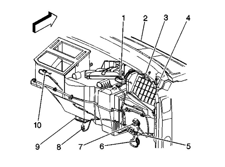

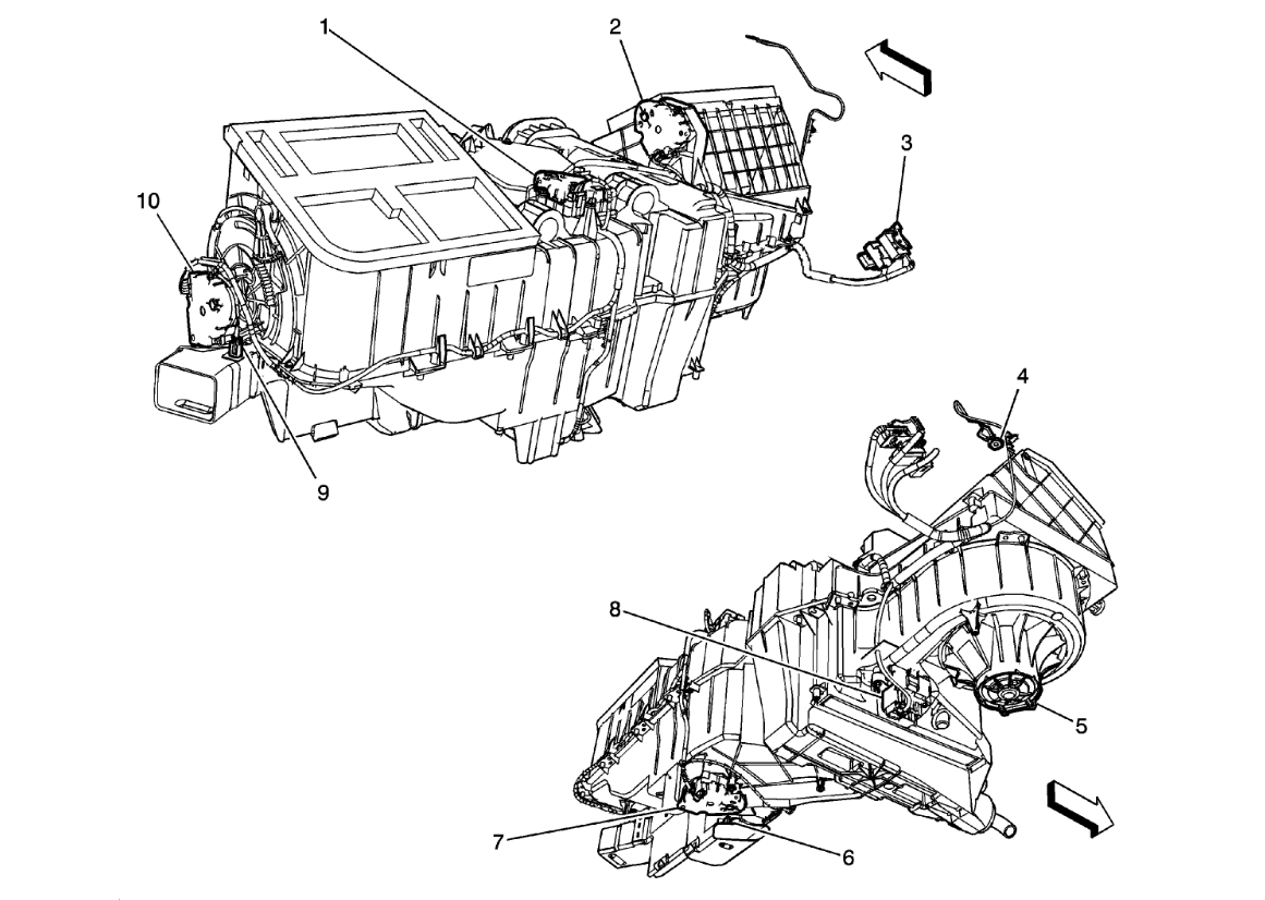

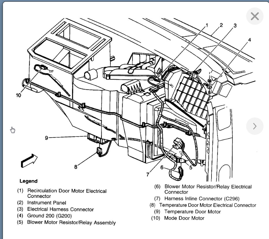

This sounds like the mode actuator is not working. Here is a guide to help you find the location of the actuator and how to replace it:
Check the diagrams below.
1 - Air Temperature Actuator - Right
2 - Re-circulation Actuator
3 - Junction Block - Right I/P X4
4 - G200
5 - Blower Motor
6 - Air Temperature Sensor - Lower Right
7 - Air Temperature Actuator - Left
8 - Blower Motor Control Module
9 - Air Temperature Sensor - Lower Left
10 - Mode Actuator

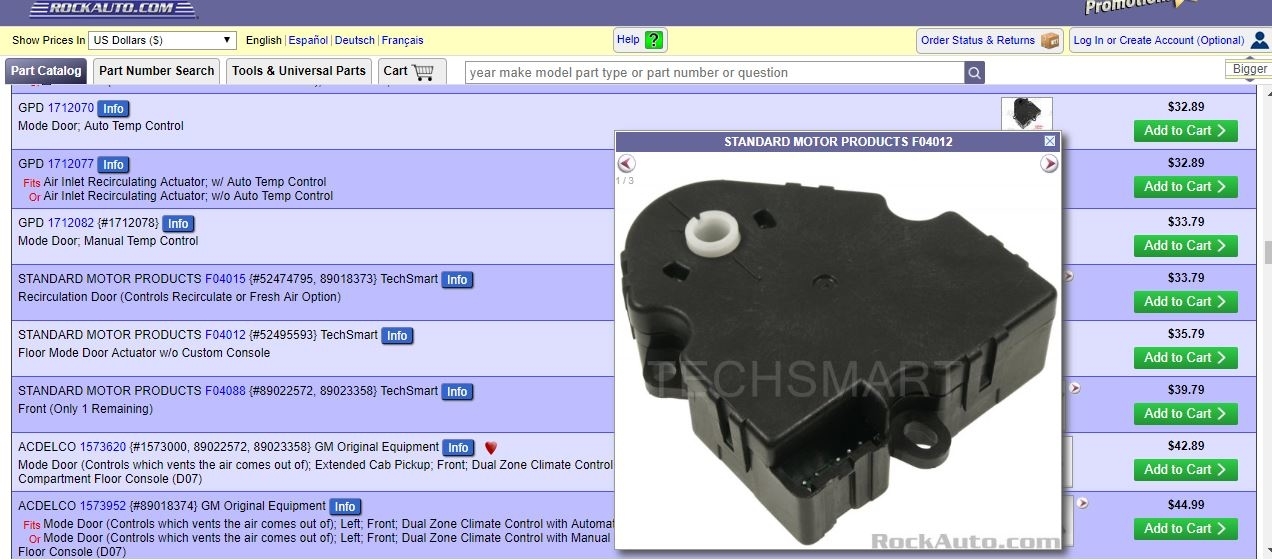

I need correct name and or part number for the actuator that moves the air flow from the defrost, to the vents and to the floor. Extend cab truck.
Apr 30, 2021 at 11:04 AM (Merged)

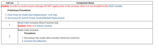

Good morning.
It is called the mode door actuator. It controls air flow out the vents.

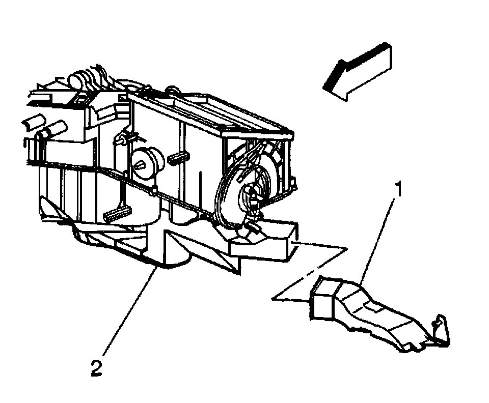

1. Remove the floor air outlet duct extension (1) from the floor duct (2).
2. Remove the center console.
3. Remove the screws from the center console duct.
4. Remove the center console duct.
5. Disconnect the electrical connection from the mode actuator (10).
6. Remove the mode actuator mounting screws from the HVAC module.
7. Remove the mode actuator as an assembly with the actuator cam.

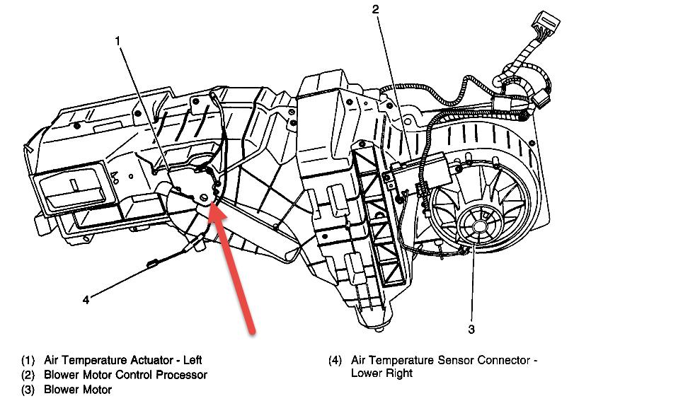

check to see if the actuator is working meaning blocking the cool are from coming in as it controls temperature.
JEFF LYDER
you are talking about the actuator on passenger side correct?
HMAC300
  • 48,601 POSTS
the picture shows drivers side but you may have on there as well. I am assuming this is manual control like you do not set the temperature. if it is auto then it is another problem and youwill need to get it scanned.

I have air blowing they the top n bottom but midlevel n and no cool air blowing as well but AC ia full so how do I know which blend actuator to replace ?

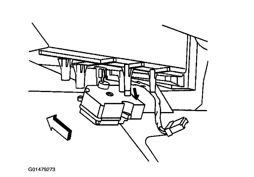

Good evening.
Attached is a diagram and procedures for the blend door actuator.
Did you verify the pressures were correct in the AC system?
REMOVAL PROCEDURE
imageZoom/Print
1. Remove the instrument panel hush panel.
2. Disconnect the electrical connector (8) from the air temperature actuator (9).
imageZoom/Print
3. Remove the air temperature actuator retaining screws.
imageZoom/Print
4. Remove the air temperature actuator.

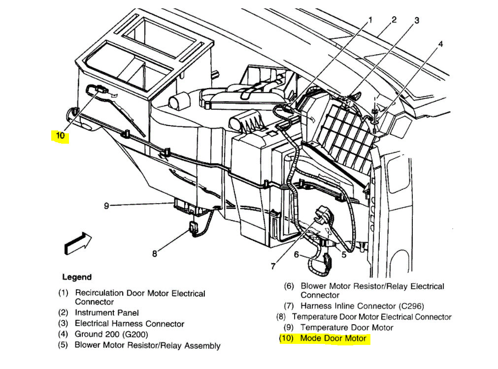

This is due to the mode door motor/actuator. I attached the process on how to replace it. Let me know what questions you have. Thanks

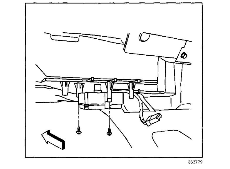

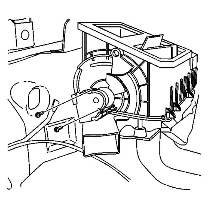

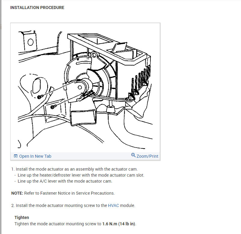

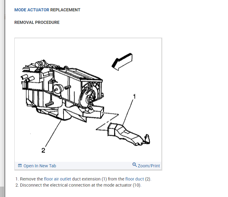

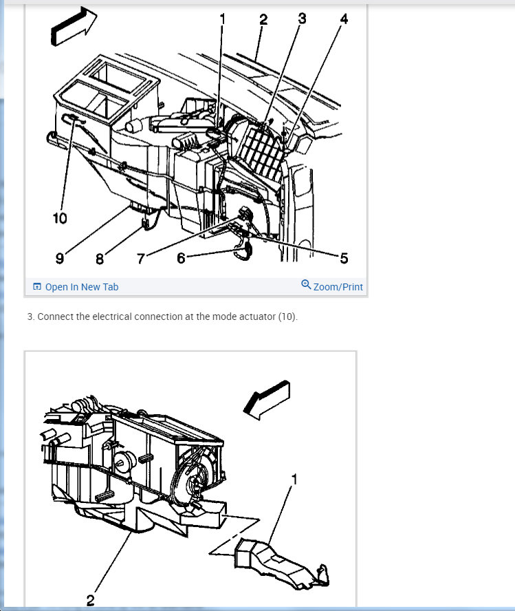

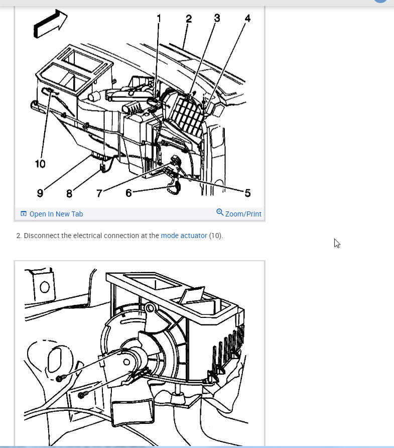

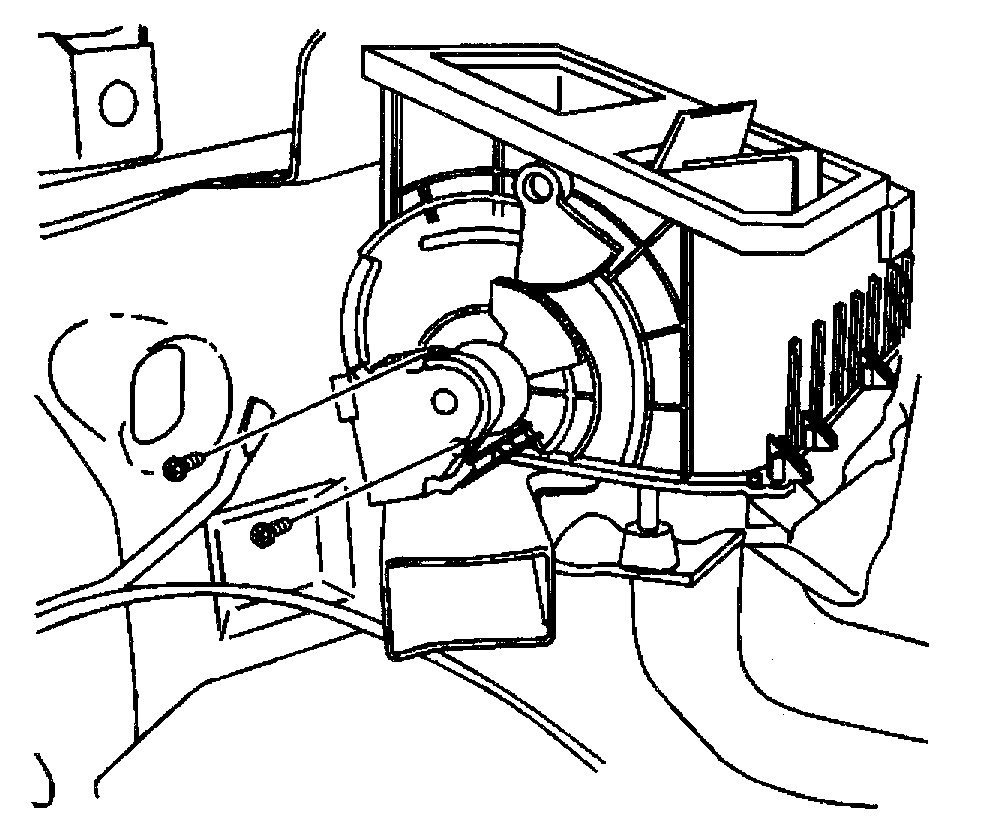

If you are unable to control the air flow direction, chances are there is an issue with what is called a mode door actuator. This actuator is responsible for directing air flow to the requested location.
If you look at pic 1, it shows the location of the mode door. What I would like you to do is remove the actuator and check to see if it moves when you change air flow directions. Also, make sure nothing is disconnected or damaged.
To access and remove the actuator isn't too hard, but will take more than a minute. Here are the directions for replacing the actuator. Before replacing it, check to make sure it isn't working and make sure nothing is disconnected or damaged. The attached pics correlate with the directions.
__________________________
1999 Chevy Truck C 1500 Truck 2WD V8-4.8L VIN V

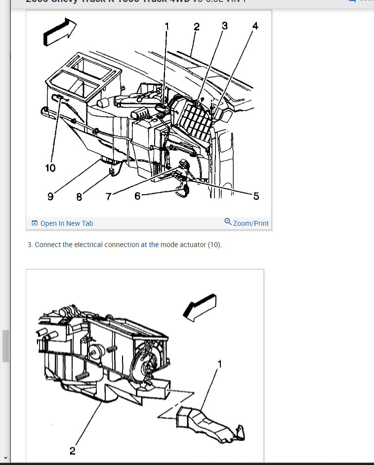

Mode Actuator Replacement
Vehicle Heating and Air Conditioning Air Door Actuator / Motor Service and Repair Procedures Heating and Ventilation Mode Actuator Replacement

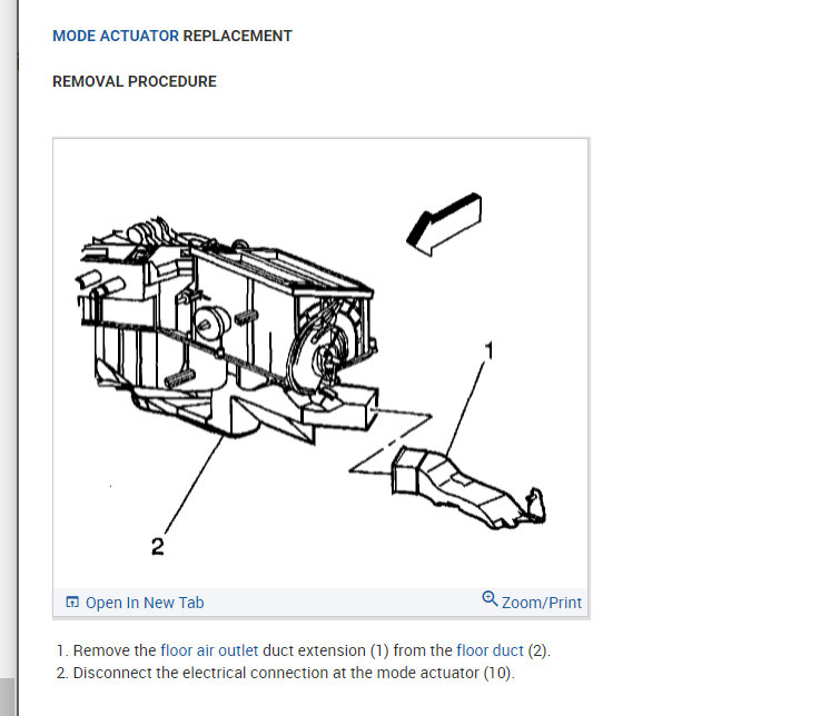

MODE ACTUATOR REPLACEMENT
REMOVAL PROCEDURE
pic 2

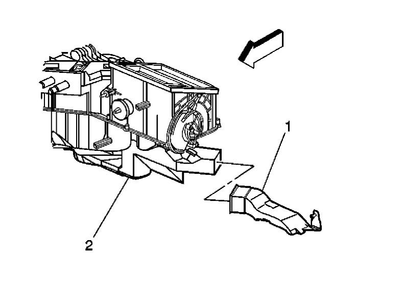

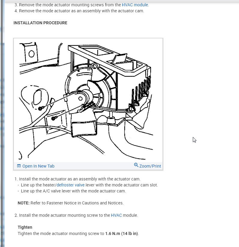

pic 3
2. Disconnect the electrical connection at the mode actuator (10).
pic 4
3. Remove the mode actuator mounting screws from the HVAC module.
4. Remove the mode actuator as an assembly with the actuator cam.

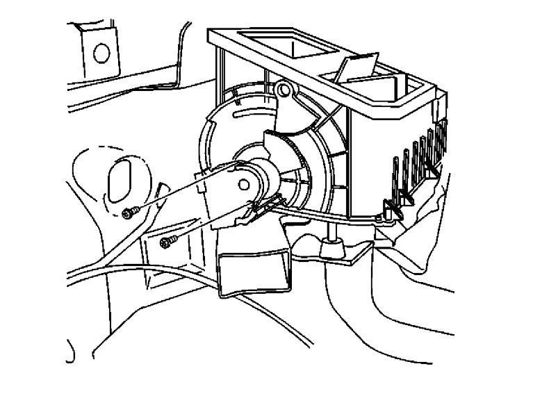

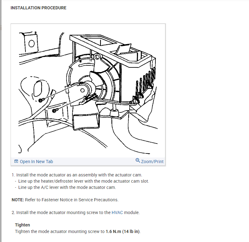

INSTALLATION PROCEDURE
pic 5
1. Install the mode actuator as an assembly with the actuator cam.
- Line up the heater/defroster valve lever with the mode actuator cam slot.
- Line up the A/C valve lever with the mode actuator cam.
NOTE: Refer to Fastener Notice in Cautions and Notices.
2. Install the mode actuator mounting screw to the HVAC module.
Tighten
Tighten the mode actuator mounting screw to 1.6 N.m (14 lb in).

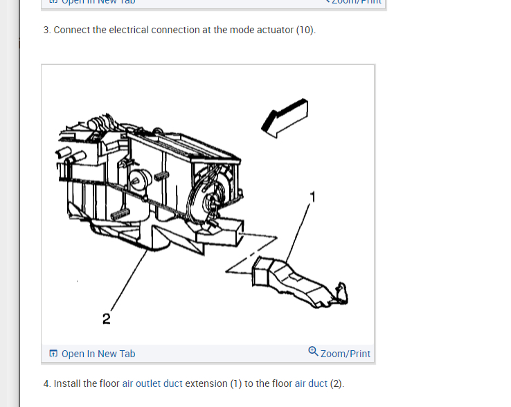

pic 6
3. Connect the electrical connection at the mode actuator (10).

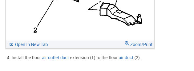

pic 7
4. Install the floor air outlet duct extension (1) to the floor air duct (2).
____________________________________

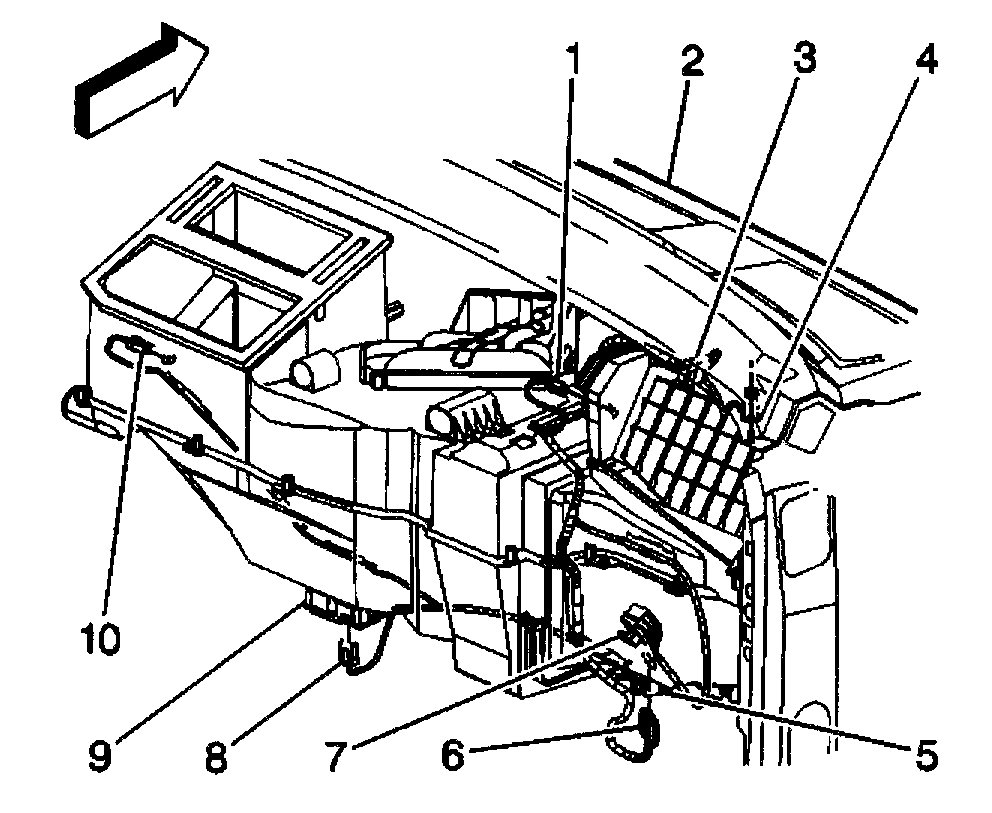

Hi:

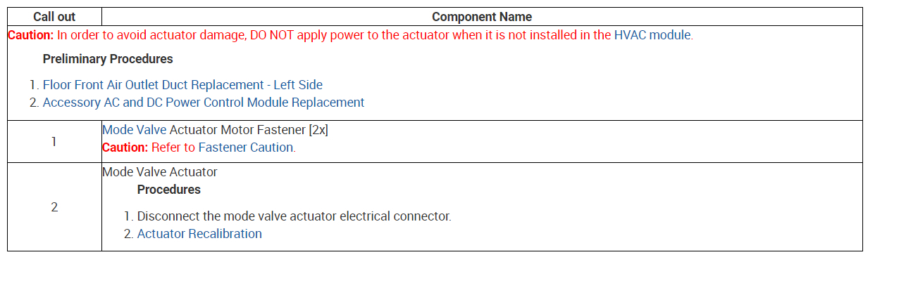

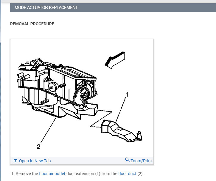

It sounds like the mode door actuator isn't working. That is what changes air flow direction. Here are the directions specific to your vehicle for replacing the mode door actuator. The attached pictures correlate with the directions.
Tighten
Check out the diagrams (Below). Let us know what happens and please upload pictures or videos of the problem.

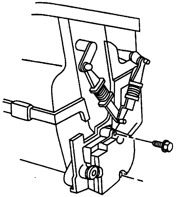

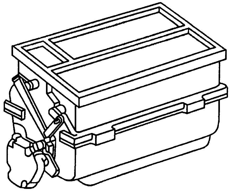

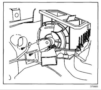

My heater works but I can't get it to blow out the defrost or the dash vents, its stuck on the floor heater. What could be the cause of this? Is it an easy fix or is it better to take it to a mechanic? Thanks for the help.
May 25, 2021 at 11:44 AM (Merged)
  • 110,194 POSTS

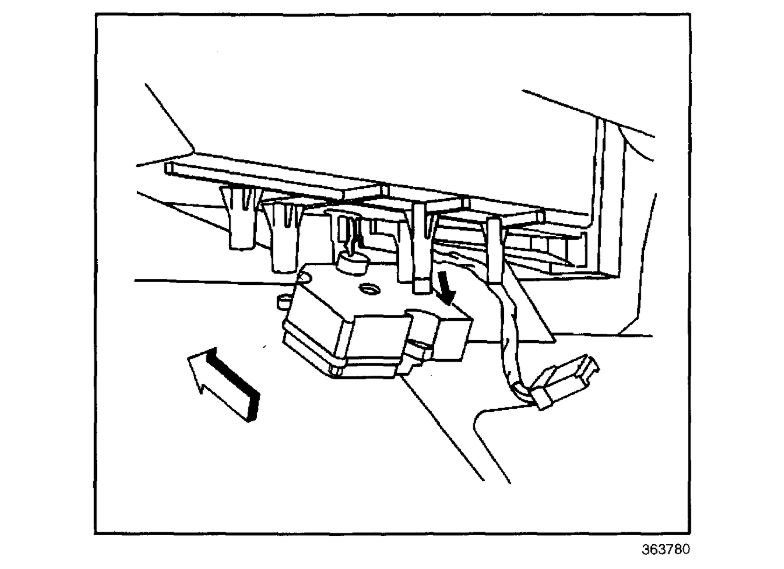

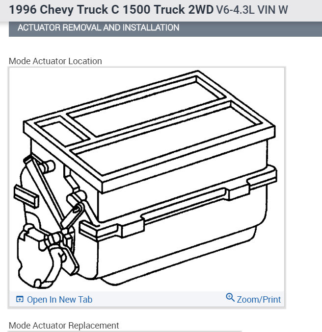

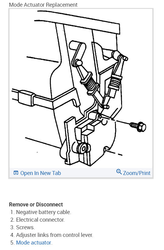

The air flow direction on this vehicle is controlled by a mode door. Based on your selection, the mode door actuator changes the direction of air flow. What I would suggest is to remove the actuator and check it for operation. Chances are the actuator itself has failed.
Here are the directions for removal and replacement. The two attached pictures correlate with the directions.

1996 Chevy Truck K 2500 Truck 4WD V8-305 5.0L VIN M SFI
Actuator Removal and Installation
Vehicle Heating and Air Conditioning Air Door Actuator / Motor Service and Repair Procedures Actuator Removal and Installation
ACTUATOR REMOVAL AND INSTALLATION
Mode Actuator Location
Pic 1

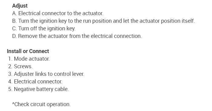

Pic 2
Remove or Disconnect
1. Negative battery cable.
2. Electrical connector.
3. Screws.
4. Adjuster links from control lever.
5. Mode actuator.
Adjust
A. Electrical connector to the actuator.
B. Turn the ignition key to the run position and let the actuator position itself.
C. Turn off the ignition key.
D. Remove the actuator from the electrical connection.
Install or Connect
1. Mode actuator.
2. Screws.
3. Adjuster links to control lever.
4. Electrical connector.
5. Negative battery cable.
^Check circuit operation.
