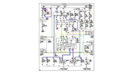

Never owned a car like this one. I have a 1999 Eclipse. The rear parking lights went out. I would assume it blew a fuse. I check all the fuses under the dash and the ones under the hood and all are fine. What could it be, all the bulbs are fine. Is there a relay of some sort for this and if so where would I find it?

Sir you need to Check the tail light relay in the engine compartment relay box see below
https://images.2carpros.com/forum/automotive_pictures/12900_1999_Eclipse_tail_light_circuit_2.jpg

Is there a chance you can email the diagram to me so I can read it? kdbeucke@sbcglobal.net

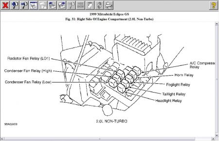

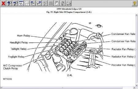

  • 75,988 POSTS
2.4L engine
https://images.2carpros.com/forum/automotive_pictures/12900_1999_Mit_Eclipse_tail_light_relay_1.jpg
2.0L Non Turbo
https://images.2carpros.com/forum/automotive_pictures/12900_1999_Mit_Eclispe_Tail_relay_2.jpg

Thanks for the manual that helped a lot. Wish I had your manual. Unfortunately the relay was fine. Is there something else I can check now?

This one gonna be tedious work but the only way to find the cause
Remove all these bulbs, license plates/combination lights front and rear.
Get a multimeter and test the green and white wire to black wire at socket- If you got continuity there's a short to ground somewhere-this is where you start disconnecting connectors.
