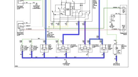

Directional and brake lights don't work on right rear of car when vehicle is cold. Running lights work. When inside of car is warm (sits all day in sun), they work. Bulbs are new. Acts like a bad ground, but don't know where to look. Any Suggestions?

The black wire that goes to every light bulb socket is the ground wire that teminates at G407. Your main ground termination point is located at G407 center rear of trunk
