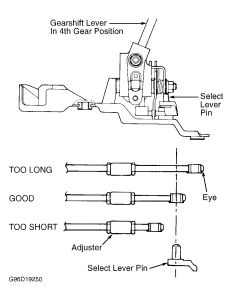

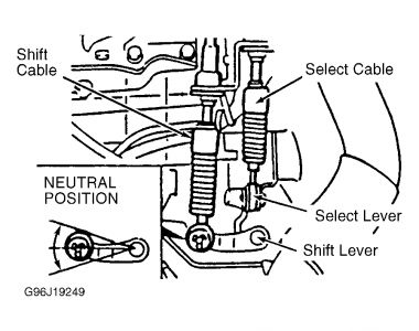

I have a 2001 mitsubishi eclipse gt manual, v6, 3.0 it has 95k in miles. The problem I am having is about 5 days ago i noticed the clutch felt wierd. Two days later i noticed it was hard to get it into gear. Then three days later I was leaving my house when my pedal just went out. I mean i pushed it to the floor and there was no resistance, oubviously it came back due to it being spring loaded. I am not sure if I have a clutch problem or master cylinder problem i just dont know

Your car has an F5M51 Manual transmission. It takes 5.9 pints of 75-85 gear oil fill it to the bottom of the plug hole.It sounds like you need one of the cables.
https://images.2carpros.com/forum/automotive_pictures/62217_Adjustment_1.jpg
https://images.2carpros.com/forum/automotive_pictures/62217_ShiftCables_1.jpg
