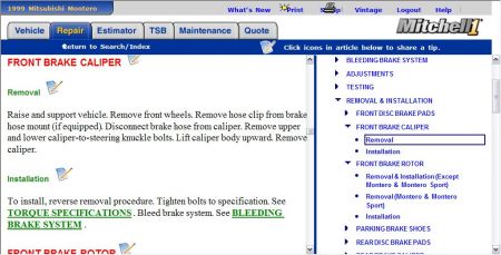

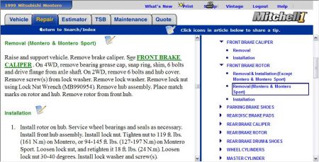

How do you remove brake rotor for 1998 Mitsubishi Montero Sport LS 2.8. Is there a special tool.The mileage is 140000. Do I have to replace it with new, it never been rotate (shave) yet. But everytime I step on the brake the stirring wheel sha
Everytime i turn the socket the rotor rotate:)
Nov 8, 2007 at 1:19 AM
  • 75,992 POSTS
All you need is millimeter socket sets/wrenches and a C-clamp/lock nut wrench
https://images.2carpros.com/forum/automotive_pictures/12900_rotor_1.jpg
see below
https://images.2carpros.com/forum/automotive_pictures/12900_caliper_1.jpg
