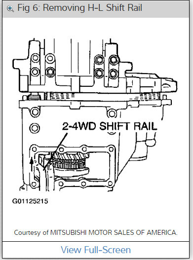

I have a manual shift lever to the transfer case that refuses to budge. I am currently sitting in AWD, but have no ability to shift up to 4hi or 4lo. I was able to move up to true 4 wheel drive for a couple of weeks after I got the car, but even then it was an ordeal getting it to engage. I was required to hold the lever in place until it "took over" and was able to run in 4hi. 4lo was always a crap shoot. Any ideas as to what the repair would be and cost?

This sounds like a retainer clip broke or the 2wd to 4wd shift fork is worn

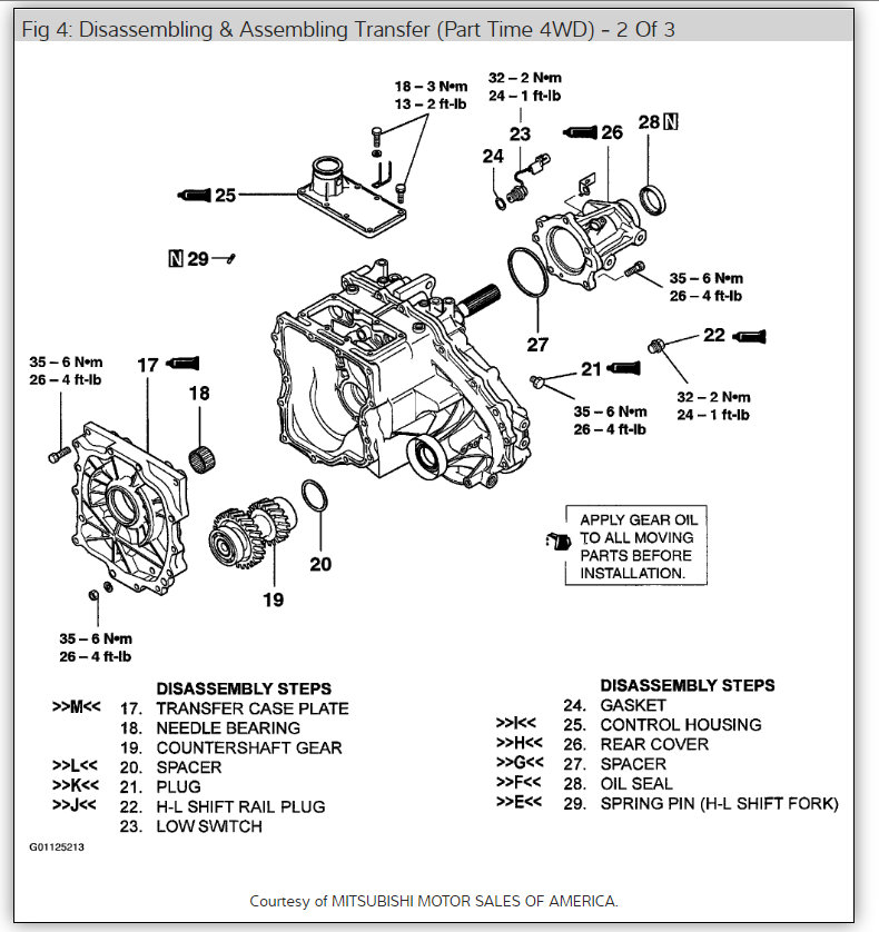

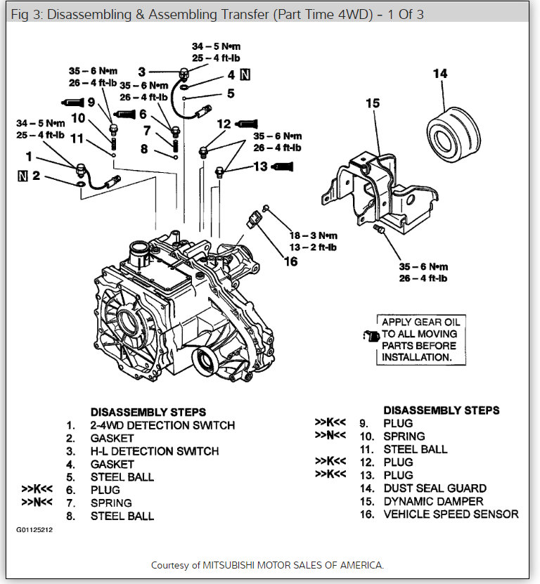

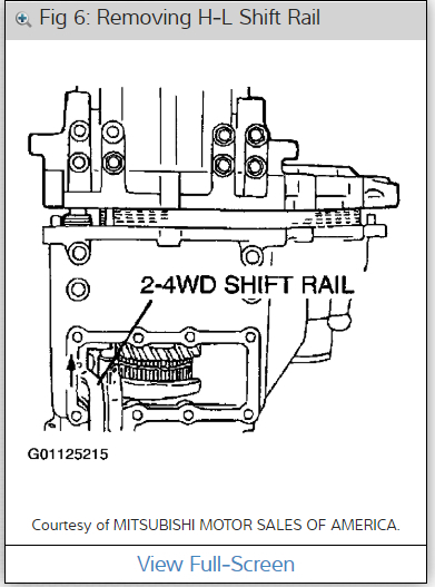

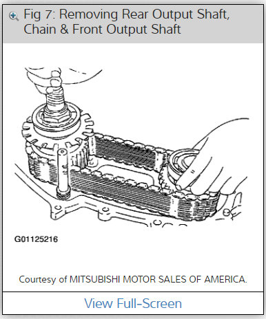

This sounds like a retainer clip broke or the 2wd to 4wd shift fork is worn here are diagrams to help you see what you are in for when doing the job. Check out the diagrams (Below). Let us know what happens and please upload pictures or videos of the problem.
