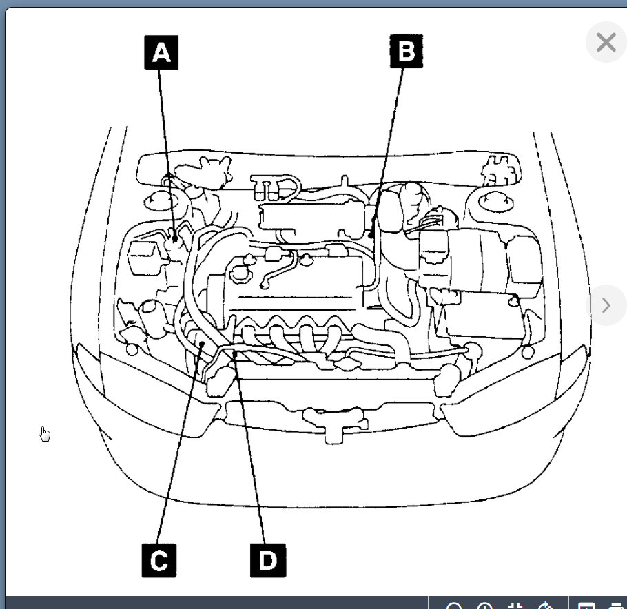

The brain is located under right side of dash, above kick panel See location no. 1
https://images.2carpros.com/forum/automotive_pictures/12900_ecu_6.jpg

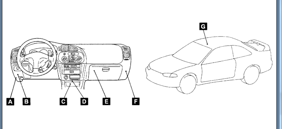

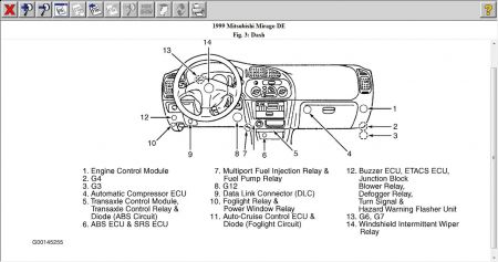

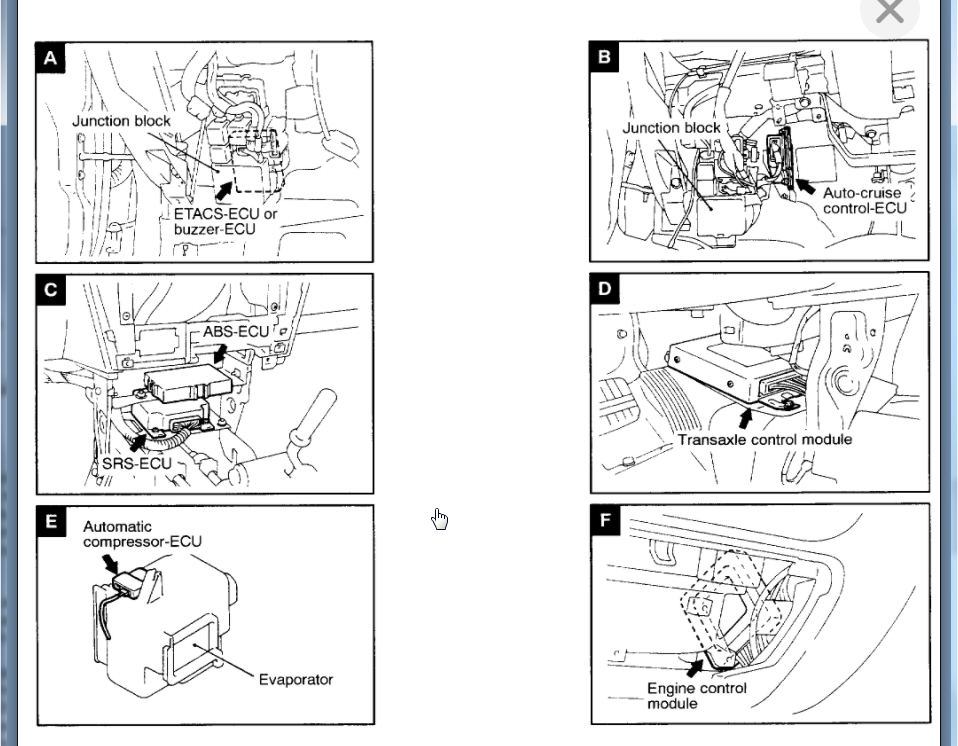

Can you tell me if the 2000 Mirage DE 4DR 1.5L also has #4...Auto Compressor ECU?
I cannot find it behind the glove box anywhere.
Apr 18, 2021 at 10:38 AM

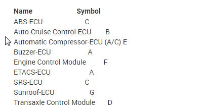

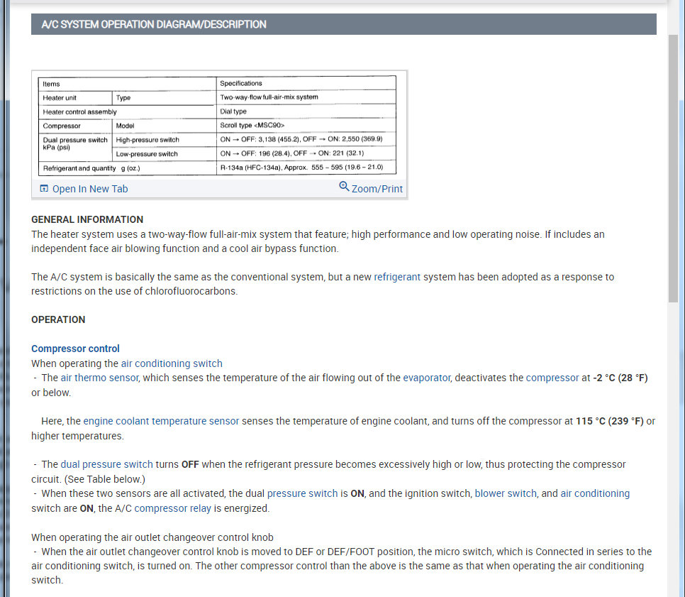

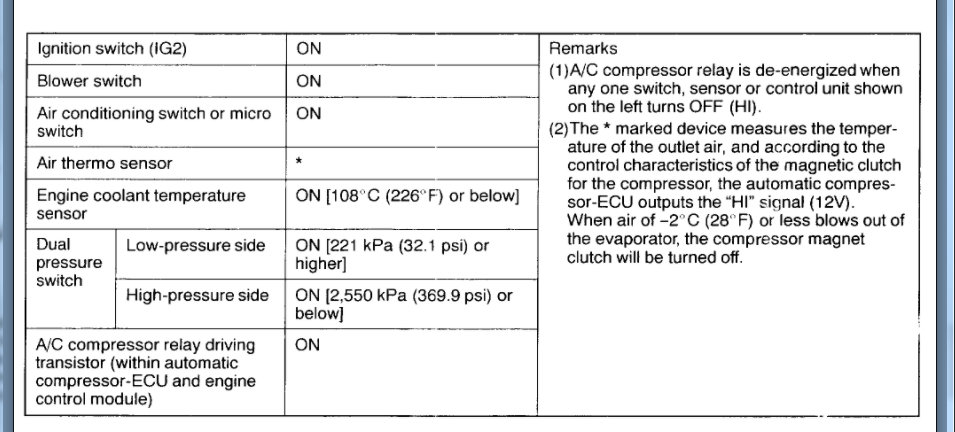

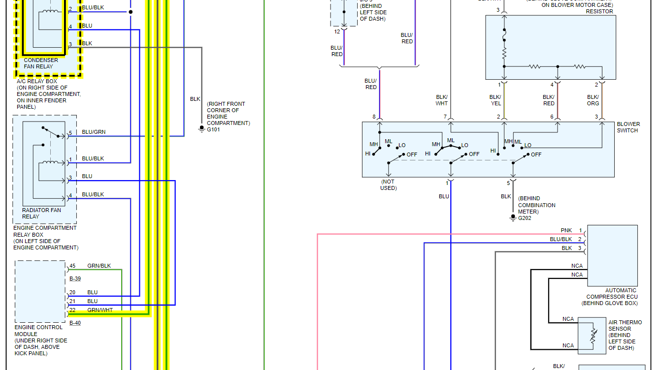

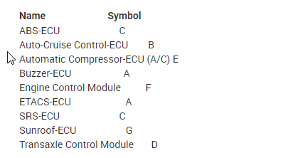

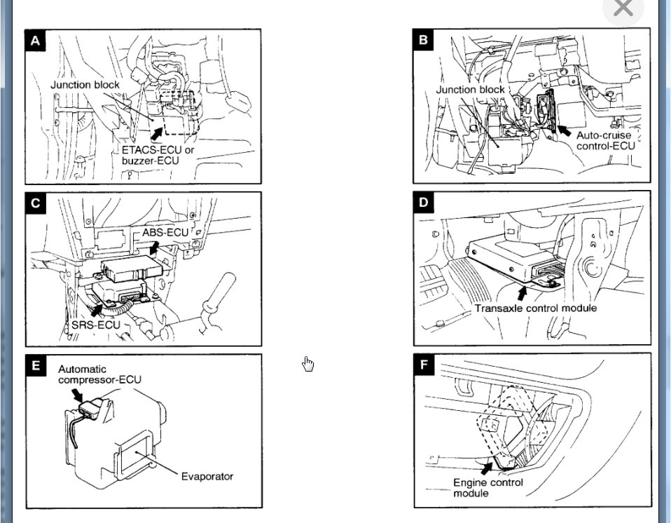

Take a look at this from the manual of this vehicle. I am showing it behind the glove box but to the driver side of it on top of the HVAC housing.
I included the testing for this as well. Here is a guide that will help with this type of testing:
Please take a look at this and let us know if you have other issues.

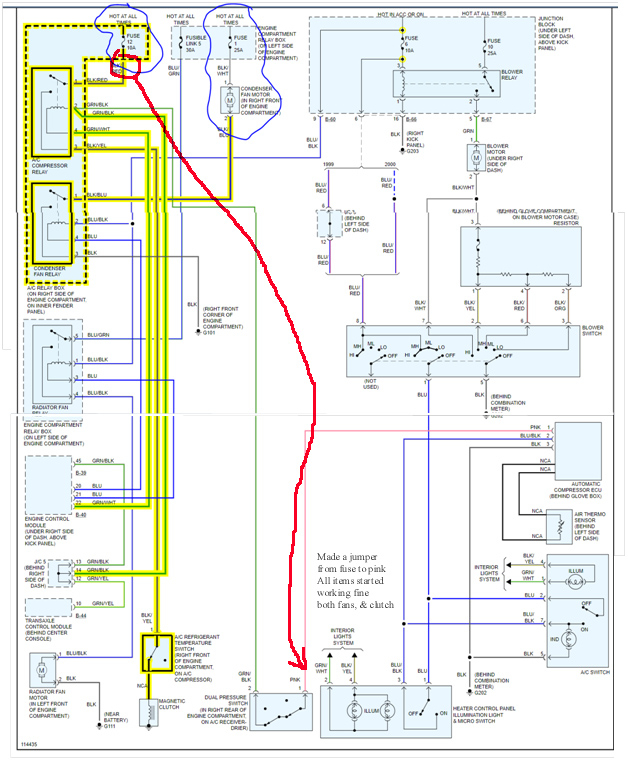

Problem is my compressor will not engage the clutch now. and I have a string of stuff under different thread with Roy...Link:
https://www.2carpros.com/questions/ac-system-relay-10056512
The compressor will engage, the condenser fan will engage if I jump them on the relays
Fuses are good etc. so I'm thinking this part has to be my issue. perhaps my issue.
Apr 18, 2021 at 11:29 AM

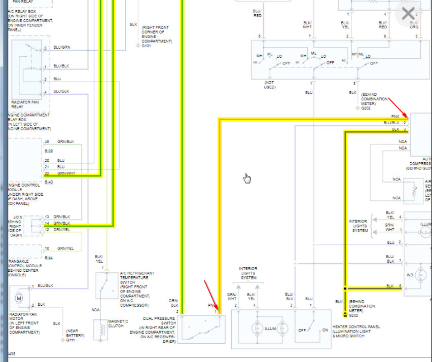

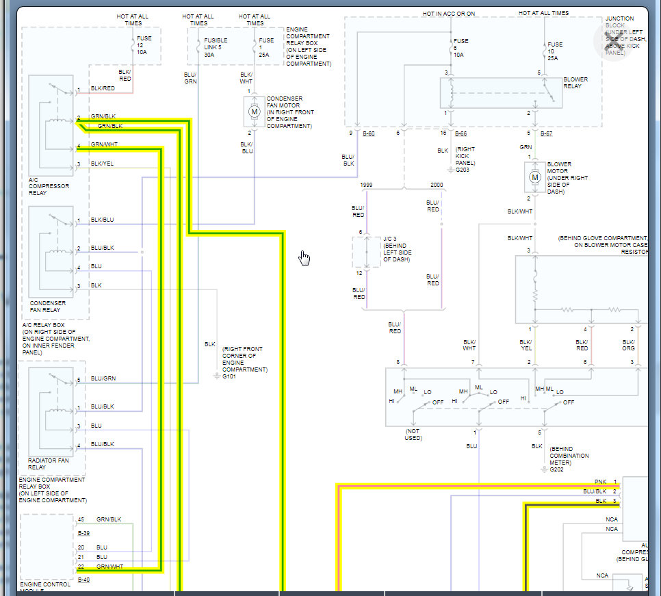

So if the compressor works when jumping the relay then we need to find out what voltage you have on the highlighted wires.
First, the green black wires at the relay when the A/C is on. You should have 12 volts on this terminal (2) at the relay. If you do then the Compressor ECU and dual pressure switch is working.
Then you need to go to number 4 and see if the ECM is grounding the relay. You do this by putting your red meter lead on battery positive and then the black lead on this terminal and then turn the A/C on. You should have 12 volts. If you do not then the ECM is not grounding the relay and it is either the issue or there is an input to the ECM that is the issue but let's start with this and go from there.
Below is this info. Let me know. Thanks

On the condenser relay, putting the test leads on: Positive on Pins 1 and 2, negative to battery negative. I get 12 volts on each pin.
On the compressor relay, doing the same, I get 12 volts on pins 1, but not pin 2.
On pin 2 of the compressor relay I get about 0.22.
This is with Key On, A/C Switch On, Blower Motor running.
On the pink wire for the pressure switch on the A/C Dryer.. I get about 2.26 volts...but it will climb
up to about 2.42 volts and I stopped checking from there.
Apr 19, 2021 at 10:33 AM

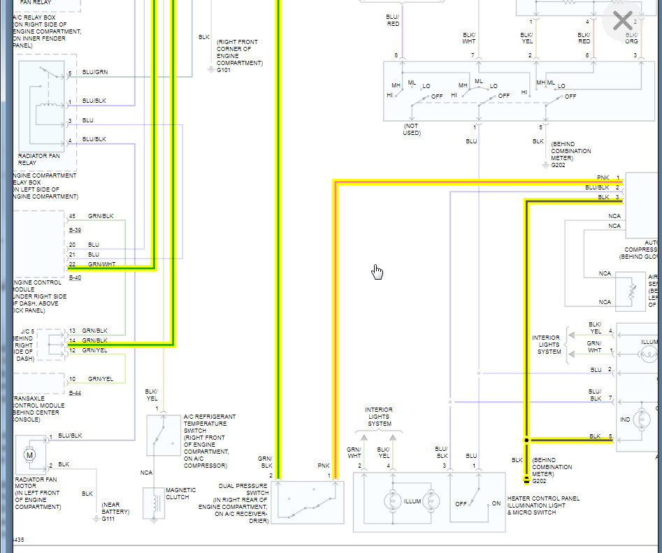

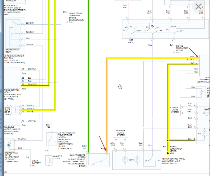

Okay. That is the green/black wire. So if you only have 2.5 volts on the pink wire we need to do a voltage drop on the wire itself. Basically put your meter leads at both ends of the wire with the circuit intake and see how much voltage is being used on the wire itself.
You either have a wiring issue or the compressor ECU is not supplying the 12 volts needed.

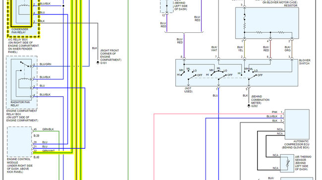

Perhaps I need to back up some. On the compressor relay, pin4 meter red to battery, and negative to pin4...yes 12 volts. Pin 2 does not produce 12 volts like the condenser relay pins 1 and 2 does.
So to test the pink wire...let me ask a stupid question...bare with me...LOL
In the 3rd picture you attached, left to right #3...1st stupid question...what is this "combination meter" it is behind...
and 2...when testing each end of the pink wire...that is positive at each end and neg to ground? Being I'll be under the dash and then under the hood...my test leads are not 10 foot long...now...when you get up off the floor from laughing...LOL...explain as best this "combination meter" I'm looking for... : ) It's like the ECU...I still cannot see it, so I guess I need to remove the pass. air bag to see it??...and the ECU is behind the Combination Meter.
I know...you saying to yourself...why...why me... : )
You know...I worked for Singer for 10 years, and sewing machines in general for over 30 years...was with Singer when the 1st electronic Athena 2000 came out in 1975. Figured out the circuit boards, had factory test procedures...and replaced chips even...
You have no idea of how stupid I am feeling right about now...LOL...

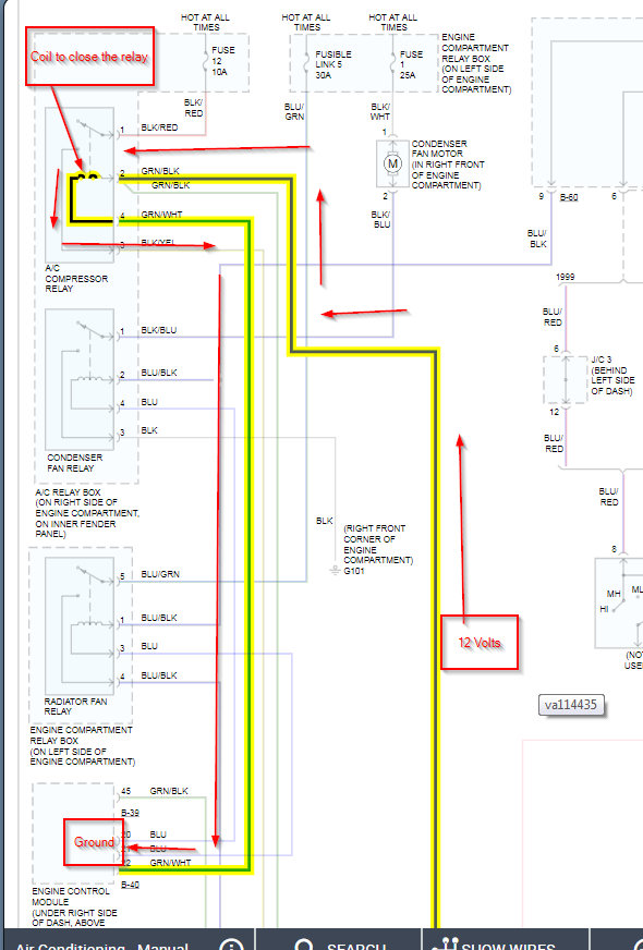

Let me start with the relay. Pin 2 of the compressor relay should have 12 volts coming into it. You proved that Pin 4 is the ground by putting your meter on positive and then grounding it on that circuit. That shows that the ECM is grounding that circuit to control it. It is called a low side driver. Meaning the ECM just completes the circuit when it wants it on to close the relay rather then supplying voltage to an already completed circuit, known as a high side driver.
In other words, the driver is what controls the current flow and is it on the high side (supply side prior to the load) of the circuit or the low side (ground side)? Most relay controls like this are low side drivers.
Also, we know that there needs to be 12 volts as this is the coil of the relay that when energized it closes the coil in the relay to engage it. So that means we need 12 volts coming in on pin 2 and out on pin 4.
Then we also have 12 volts on pin 1 coming from the fuse as this is what delivers the 12 volts through the relay when it is closed, to the AC temp switch and to the compressor.
As for the combination meter, that is my fault. I put the red arrow on there to show the pink wire but that "Behind combination meter" is for the ground to the blower switch. The combination meter is the cluster but that is not for this circuit.
Sorry for the confusion on that. I attached the info below and put some more current flow on the first one.

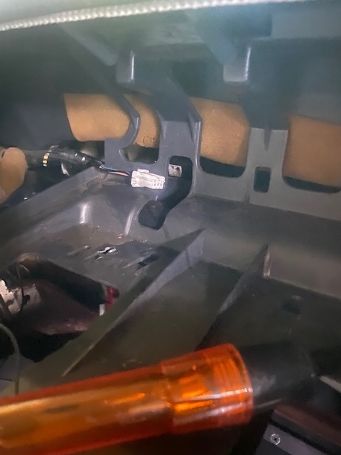

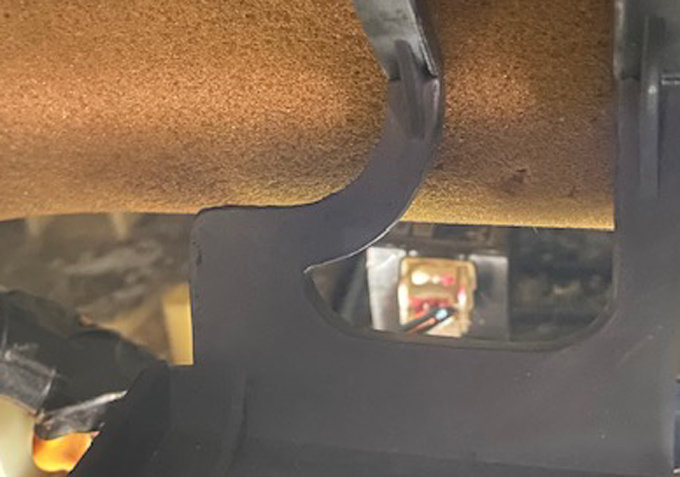

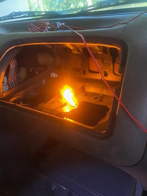

Okay, found the ECU after removing the passenger side airbag from the dash. I can see it buried in there. Just how in the world to you get to it to test it and it's wiring?
Please do not tell me I have to drop the evaporator box (again) and undo my evaporator lines from the firewall (again) just to check this thing, and go through the process of recharging my A/C system. If this turns out to be okay and I still cannot start up the compressor normally, I cannot recharge it either. I cannot reach into the area to unplug it either. it is pretty well placed behind some dash parts, and underneath the dash air duct.
Can one pop it out with a screwdriver perhaps??

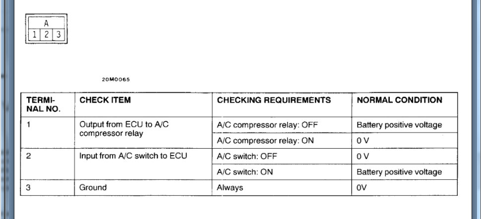

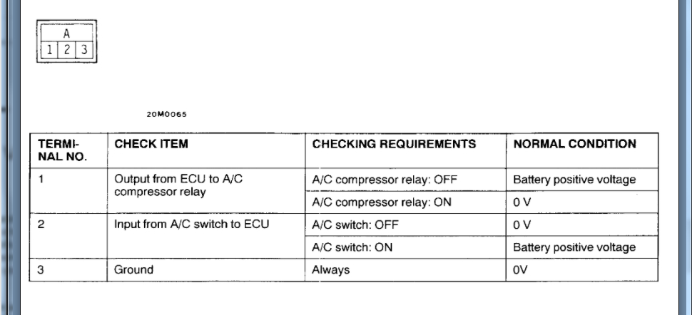

Unfortunately we don't have any detail in the manual on how to get it out and I don't remember ever doing one myself.
However, in looking for that, I just found this diagram below.

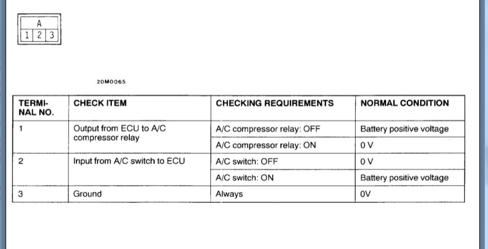

Instead of checking the voltage at the ECU. Confirm you have this voltage from the pink wire at the dual pressure switch. I think I had it backwards. You should have battery voltage with the compressor relay off.
Is this what you had? Please see below.

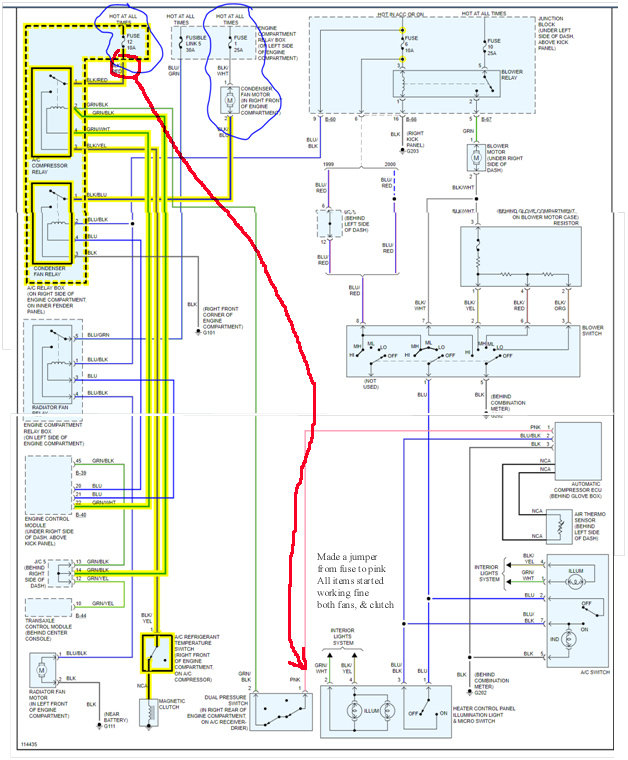

So what I did was pull 12 volts from the 10am fuse and made a jumper wire with toggle switch and ran it to the pink wire of the pressure switch. Shown in my picture. Once you toggle it on, the compressor will engage, and both fans start running as they would normally. So the problem appears to be the ECU, or related...is not sending 12 volts to the pressure switch. The pink wire on the pressure switch feeds pin 2 of the compressor relay and will energize the coil.
Now the A/C switch on the dash the little light does come on when you depress the A/C switch on. In the lower right of the picture below the ECU. it says AC switch. is that the AC switch or Accessory Switch it is talking about?
The blower motor works fine at all speeds as well. ECU problem???
May 1, 2021 at 10:35 AM
Looks like you confirmed that is the issue.
The A/C switch in the lower right corner is the switch in the passenger compartment that turns it on.
Great job in making the jumper wire. That was a good idea.

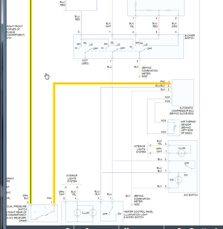

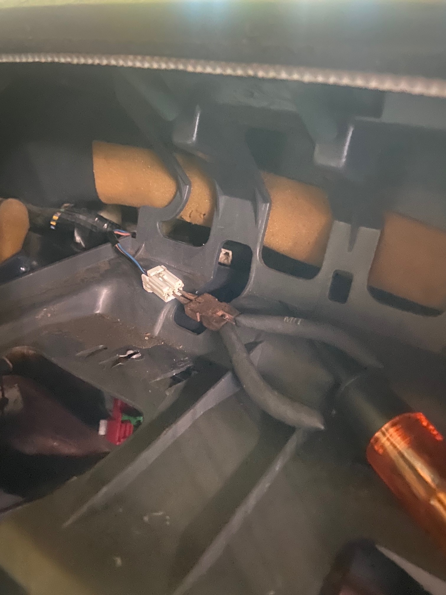

So today I finally fiddle with it some more and was able to unplug the A/C Switch harness from the ECU that is behind the passenger air bag in the dash...which you have to remove to get to. Along with the glove box as well. Attached, left to right P1, P2, P3, P4
P1 - Using jumper on plug...engine running AC switch on, all systems work.
P2 - Testing for power at the plug from the AC switch on the dash - all is good.
P3 - AC switch harness and visible is the ECU above the evaporator.
P4 - Schematic send by another tech.
So I tested for power at the harness. it has power. I plugged in back in and tested for power the A/C pressure switch (pink wire) no power, engine on and running.
Conclusion, ECU is bad.
Resolution, cut large paper clip and jump blue and pink wire on harness - seems to work just fine with the engine running, both fans running, compressor engaged.
I have no idea about the Thermo Sensor wires that come off the ECU to the left side of the dash somewhere. System seems to work.
