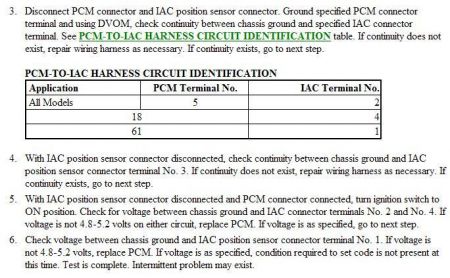

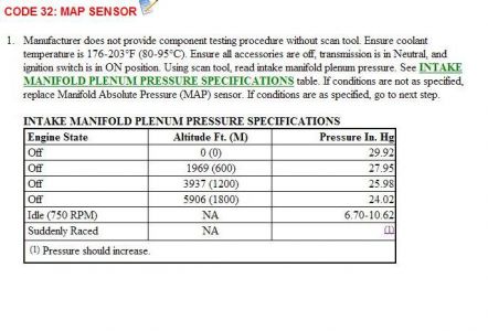

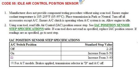

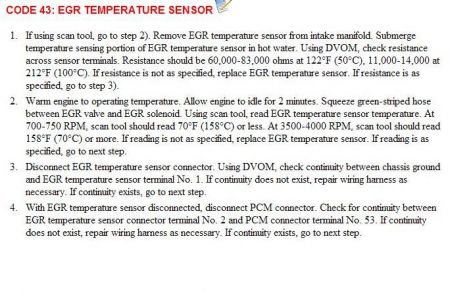

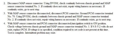

hi, i scanned my car and it shows codes 32 manifold absolute pressure sensor, code 43 egr system problems and code 55 iac valve position sensor. my question is, What part i need to buy?, since they are electrical parts and there is a not returning policy on them at my local store. where i can find a list of codes relations toward part numbers?
tks, rafael
