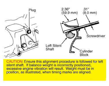

I had the timing belt and the balance shaft belts changed last week along with the tensioners and idler. I also had all the drive belts replaced. The next morning, when I started the car, there was a very loud vibrating kind of a noise from the engine. When I drove the car, it was misfiriing , then we discovered there was an oil leak, so the valve cover gasket and the plugs were then replaced. The following morning, when I started the car, the noise was still there, and it has been there every since. The RPM is stable, doesn't move up and down, however at lower RPM the vibration seems greater. None of this existed before replacing the timing belts, could there be problem with the work done?

absolutely. why was the timing belt replaced?

recheck balance shaft belt and marks
https://images.2carpros.com/forum/automotive_pictures/99387_mitsu_1.jpg

There was no timing belt issue or performance problems prior to replacing the timing belt, it was just done for maintenance reasons. Thanks :)

dont say you heard it from me but you have to put up a stink. dont be rude but let the shop know that you are not happy and want it fixed. you get more bees with honey. if they are any kind of a decent shop they will repair it. keep us posted.
