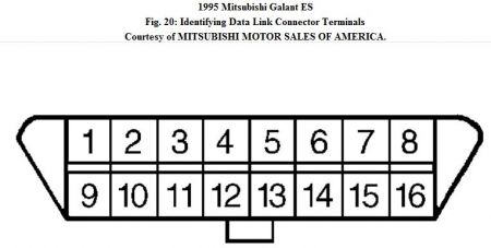

The CEL might not indicate for any trouble codes with transmission and scanning would reveal them Since you replaced the trans yourself, I trust you are able to perform diagnostics. Here are procedures for retrieving the trouble codes with the aid of an analog volmeter or a LED light. Voltmeter Method ( a led light bulb can be used as substitute and you can count the blinking) 1. Locate diagnostic connector ilocated to the right side of steering wheel under the instrument panel. Install voltmeter between ground terminal No. 4 or No. 5 and diagnostic output terminal No. 6. See Fig. 20
https://images.2carpros.com/forum/automotive_pictures/192750_DLC95GalantFig20_1.jpg
2. Turn ignition on. Note fluctuations of voltmeter needle to indicate DTC. The first fluctuation indicates first digit of DTC. Following fluctuations indicate the second digit of DTC. Record DTC's in order displayed.

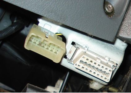

Hi again, I did not pull the end plate as of yet. I did try to get the code with a meter but the plug in the car is different than the picture of th e one you sent me. I tried to find one like the car has but had no luck. I guessed as best I could what the pin config would be but did really manage to get what I think is a good code. The meter made the same sweep at the same rate of speed and distance for 60 cycles. I attached a pic of the connector on the car,, Thanks, any help would be greatly appreciated

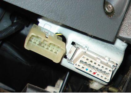

The DLC is there in your picture, just that it is inverted. I have marked terminal #4 in red and terminal # 6 in blue.
