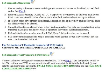

We replaced the engine and can not get the trans to go into drive or overdrive The overdrive indicator does work on the dash and indicate that it is in overdrive but the trans stay in second gear.
Jun 13, 2009 at 9:24 AM
KHLOW2008
  • 41,814 POSTS

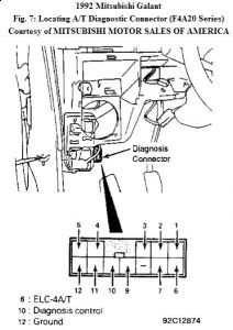

Hi rteklund, Thank you for the donation. When sensors are not correctly plugged in, loose or faulty, the transmisision would be locked in 3rd gear, limp mode and it would not shift gear. You need to go into diagnostics to know what is wrong to rectify it. I have the procedures here for you.
https://images.2carpros.com/forum/automotive_pictures/192750_DLC92Galant_1.jpg
https://images.2carpros.com/forum/automotive_pictures/192750_TransSelfDiagnostic92Galant_1.jpg
Get the codes and let me know what they are.
