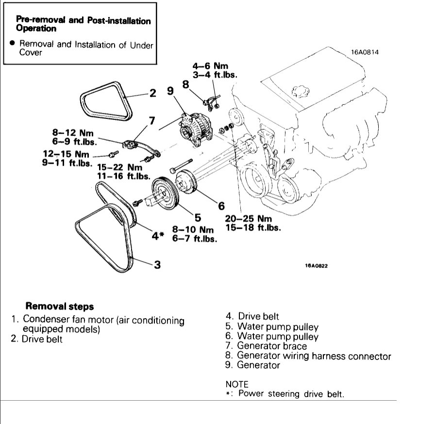

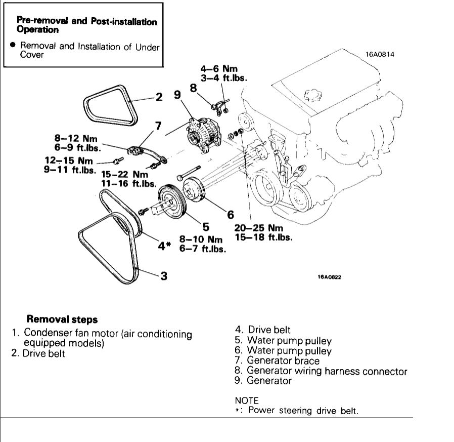

The battery light may or may not come one. With the alternator not charging it sounds like the alternator is not working. Can I ask what brand alternator you installed?
Here is a guide to check the alternator.
this will give you an idea of how to change it.
https://www.2carpros.com/articles/how-to-replace-an-alternator
And here is the way it is done on your car (Below)
Nov 15, 2017 at 2:42 AM (Merged)
