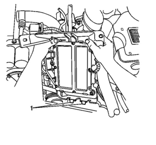

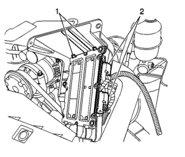

Transmission goes straight from first gear to fourth gear. No second or third. Replaced both shift solenoids, fluid, and filter, but did not help. Fluid did have some sludge in it. No DTC's present. Any ideas?
May 6, 2021 at 3:31 AM (Merged)
  • 55,224 POSTS

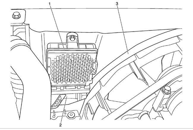

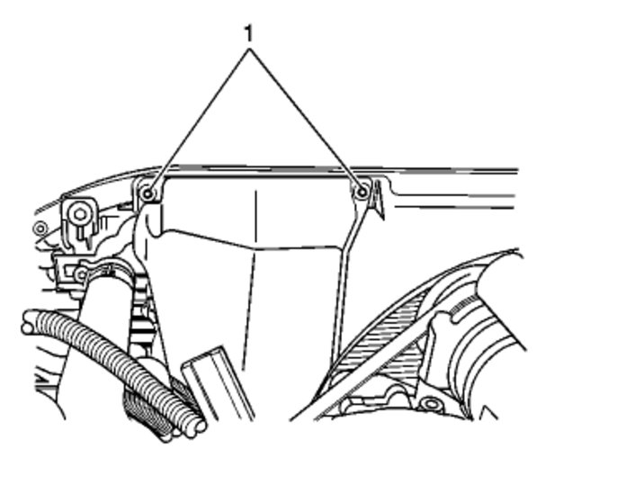

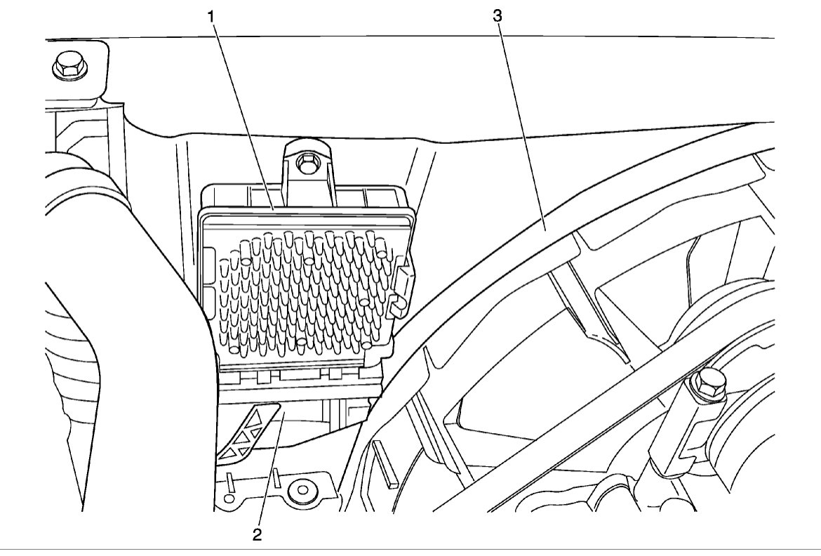

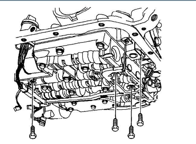

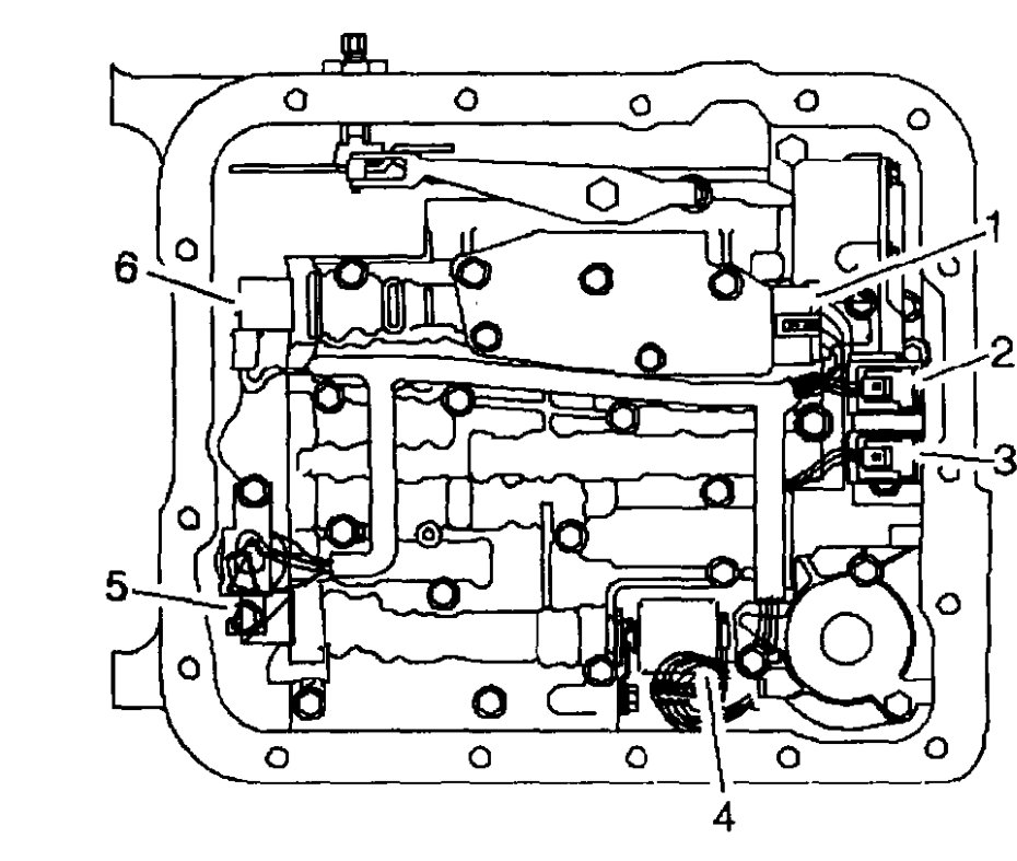

Because there is no troubles codes i am wondering if the PCM has gone bad. Also I have seen the transmission selector switch cause some weird problem when they go out.
Here are diagrams both of their locations. (below)
Please let us know what happens, we are interested to see what it is.

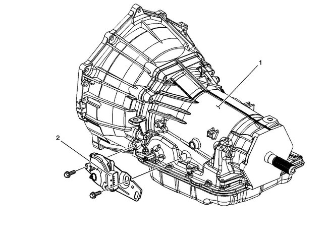

JNOVACK
  • 723 POSTS
Inspect Transmission Kickdown Solenoid Faulty transmission kickdown solenoid or solenoid circuit.
Inspect Transmission Modulator - (A/T) Worn leaking or faulty transmission modulator valve or vacuum system.
Inspect Transmission Shift Linkage (Auto) Broken or improperly adjusted shift linkage.
Inspect Transmission Shift Linkage (Manual) Broken or improperly adjusted shift linkage.
Inspect Transmission Temperature Sensor Damaged, worn, or faulty transmission temperature sensor or transmission temperature sensor circuit.
Inspect Transmission Filter (A/T) Clogged or dirty transmission filter.
Inspect Transmission Cable Detent (A/T) Damaged, worn, or incorrectly adjusted transmission detent cable.
Inspect Transmission Cable Shift (A/T) Worn, or incorrectly adjusted transmission shift cable.
Inspect Transmission Cable Shift (M/T) Worn, or incorrectly adjusted transmission shift cable.
Inspect Transmission Control Module Damaged or faulty transmission control module or circuit.
Inspect Transmission Control Solenoid Damaged or faulty transmission control solenoid or circuit.

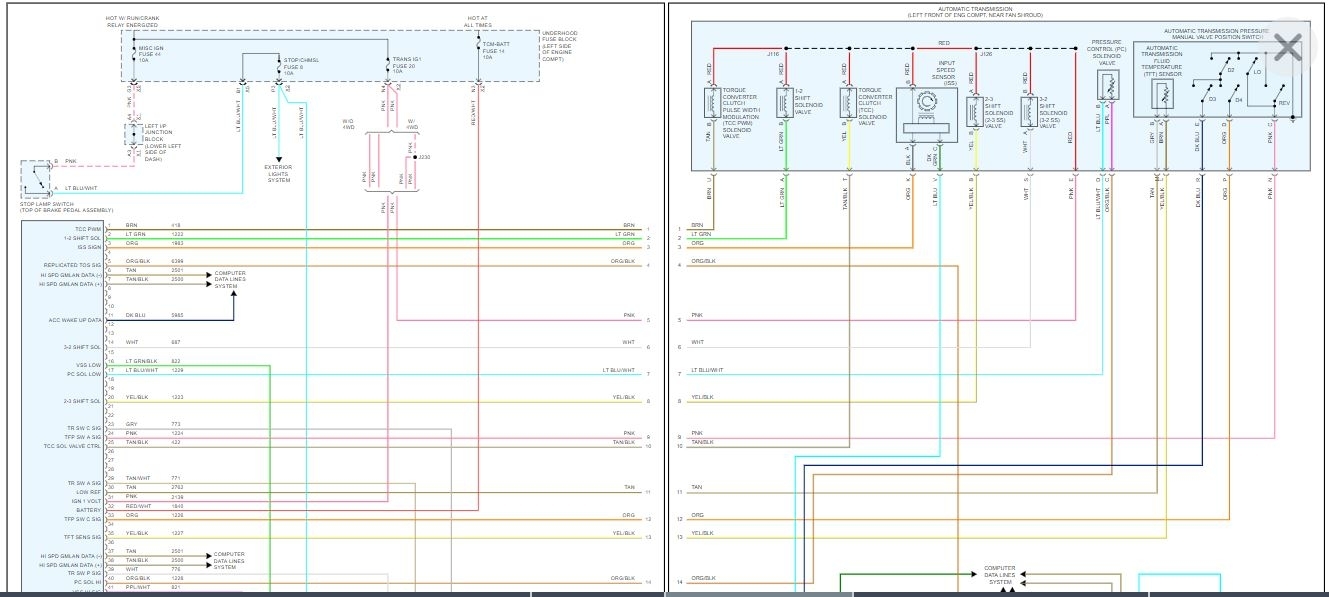

can you get a live date scanner and watch to see what is actually going on with the solenoids, this will show the operation of each shift solenoid, if the solenoid is opening and you have no gear selection, you will probably have an internal mechanical fault with the transmission. also a line pressure check will be a good idea.

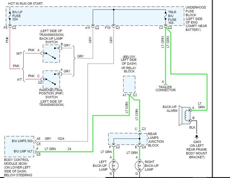

MRMISFIT138
Attached back up camera 12 volt wire from stereo to park neutral wire on transmission by accident. transmission in excellent shape as well as engine. what did I short out?
Good evening,
First, you need to remove both wires for the camera and solder and shrink wrap those wires back together.
Did you set any codes?
You need to take a power source from the fuse block. As far as the wire to the rear lights, you need to put your wire to the fuse for the backup trailer lights. There is no transmission involvement in that circuit.

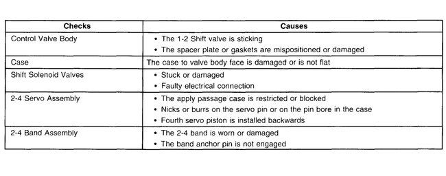

If your fluid is burned(odor) or off color, that is an indication of a need for teardown. Just a simple plate kit would probably not provide. Often times what I see is a worn 2-4 band, and by the time it is burned, the reverse clutch housing is heat damaged as well. A common problem that creates many different symptoms is a leaking input housing. For your model year there is a bulletin that describes this condition.
#PIP3136N: Slip Condition In 2nd 3rd Or 4th - Damaged 2-4 Band Or 3-4 Clutch - keywords busy chatter fourth second shudder third - (Jan 20, 2010)
Subject: Slip Condition in 2nd, 3rd or 4th - Damaged 2-4 Band or 3-4 Clutch
The following diagnosis might be helpful if the vehicle exhibits the symptom(s) described in this PI.
Condition/Concern:
The 4L60E/4L65E/4L70E automatic transmission may experience a condition of slipping, late or missed shifts in 2nd 3rd and 4th. An internal transmission disassembly may reveal a 2-4 band and or a 3-4 clutch being distressed.
Recommendation/Instructions:
Based on engineering transmission quality review sessions the following items should be inspected and or replaced as required. These items were found to be the cause of the distress to the 2-4 band and 3-4 clutch.
First check transmission fluid level. This transmission is very sensitive to low oil level. Also check:
Low Line pressure (perform a PCS test as defined in SI)
1-2 accumulator piston (56) cracked or broken
2-4 Servo Piston Seals (18, 19, 21, 26) for being cut or damaged
2-4 Servo Apply Pin (13) for being nicked/scored /binding in the pin bore, damaged clutches will frequently cause the pin to have a rough finish where it passes through the case, this is a result of the clutch debris not usually the cause of the distressed clutches or band
2-4 Servo Piston Bore for being scored or mismachined
2-4 Band Anchor Pin (41) missing (low mileage)
Servo Feed Oil Passage blocked with sediment
Forward Clutch Apply Piston (630) Seals for being cut or damaged
Forward Clutch Apply Piston (630) for being cracked
Turbine shaft oil seal rings (619) for cut or damaged.
Turbine shaft check valve retainer and ball assembly (617) is in place in the end of the turbine shaft and has not come out and gone inside the torque converter, if the retainer or ball is missing from the turbine shaft the torque converter must be replaced
Turbine shaft apply fluid passage sealing balls are in place, these are pressed into the turbine shaft end inside the input housing
3-4 Clutch Apply Piston (623) Seals for being cut or damaged
3-4 Clutch Apply Piston (623) for being cracked
3-4 Clutch and Forward Clutch oil feed passage blocked or restricted (should flow check the housing, and the passages should be inspected for proper location)
3-4 Clutch check ball (620) for leaking
3-4 Clutch air bleed orifice cup plug (698) is in place
Overrun Clutch Seal (632) damaged
#7 Checkball (located in the case) for not being seated or leaking
4-3 Sequence Valve (383) undersized
Boost Valve (219) stuck causing low line pressure
Input Sun Gear to Input Carrier Thrust Bearing (700) damaged came apart
Selective Washer (616) extra washer installed
Oil Pump Body (200) cracked/damaged
Inspect the Forward Sprag for proper operation per eSI document #215197.
Also inspect to see if the rear stator shaft bushing (241) may be worn on one side or damaged. The turbine shaft (621) may also be damaged in the stator bushing journal area.
This condition may be caused by the stator shaft (214) being non-concentric with the pump cover (215). If this condition is encountered the pump cover should be replaced along with any residual damage.
If none of the above items are found to be the root cause for the failure the Input Housing, Forward Clutch Piston and 3-4 Clutch Piston should be replaced and resealed as well as resealing the 2-4 Servo.
If clutch debris is found, it is also very important to inspect the pressure control (PC) solenoid valve fluid screens. Clean or replace the PC solenoid as necessary. It is also important to flush and flow check the transmission oil cooler using J45096. Refer to SI "Automatic Transmission Oil Cooler Flushing and Flow Test" for the procedure.
Full sized trucks and utilities should have the shift cable properly adjusted and/or replaced if the cable is not holding proper adjustment.
In the event the transmission as a repeat 2-4 Band or 3-4 Clutch Failure the transmission may require replacement due to a possible transmission case concern.

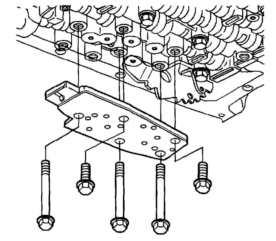

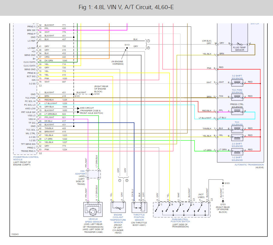

PAUL D350
  • 7 POSTS
I've got a 2002 Chevy Silverado C1500 (2WD) with the 5.3L V-8 and 4-speed automatic tranny and the HD suspension and towing package (not that I tow anything with it) and only 46,000 miles.
I noticed today that the auto trans will not start off in 1st gear. I disconnected the battery for 1 - 2 minutes in hopes of resetting the PCM, ECM or whatever - to no avail. It's still starting off in 2nd gear. No "Check Engine" or other message in the message center.
I also tried to manually shift the tranny into 1st, but it still starts off in 2nd gear.
Any thoughts as to what might be the problem?
Thanks - Paul

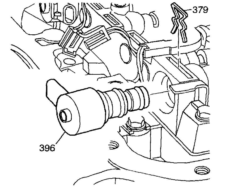

PAUL D350
  • 7 POSTS

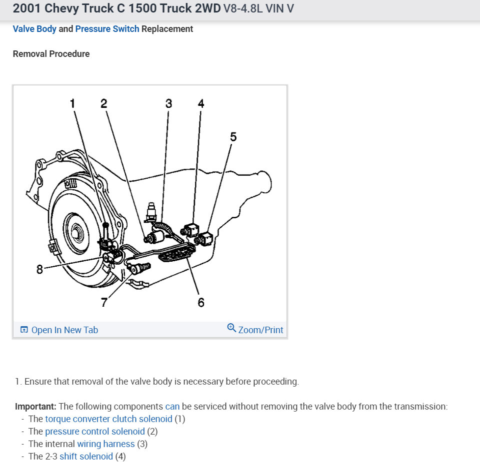

The day after I posted this the "Service Engine Soon" light came on. Went to Autozone and they hooked up their OBD II diagonostic computer which found trouble code "P0751" - "1-2 shift solenoid stuck off" or "1-2 shift solenoid circuit fault".
The rep told me that altho they don't sell auto trans parts like this one, he knew of a transmission supply company in Raleigh that would have one. He gave me their address & phone #.
Skeptical that I could repair this on my own, I called them up and asked if they had one for my tranny and he said yes. I then asked how difficult it was to replace and he said it was no big deal - "Come on over and I'll tell you what's involved".
Got over there and the solenoid was on $12 - $13. He said to drop the drain pan, pull the filter, and showed me which solenoid was the one to replace. (The 1-2 shift solenoid is identical to the 3-4 shift solenoid.)
Went ahead and bought a new filter, pan gasket, and trans fluid while I was there. Total cost - about $75.00 including a repair manual. Went home and pulled the pan. Sure enough, a disassembly of the solenoid revealed a tiny piece of metal that prevented the check valve ball from seating properly, which allowed fluid to continue to flow thru the solenoid-activated valve when it tried to shut off.
I installed the new solenoid, trans filter and gasket, refilled it with fluid, and presto! Works like a charm!
I saved myself approx. $300 - $400 a trans shop would have charged. And you know they would have tried to talk me into add'l charges for a complete overhaul with the line "We won't warranty anything we do to it w/o doing a complete rebuild" even though the truck only has 48,000 miles...
Fixed it myself - and lovin' it :D

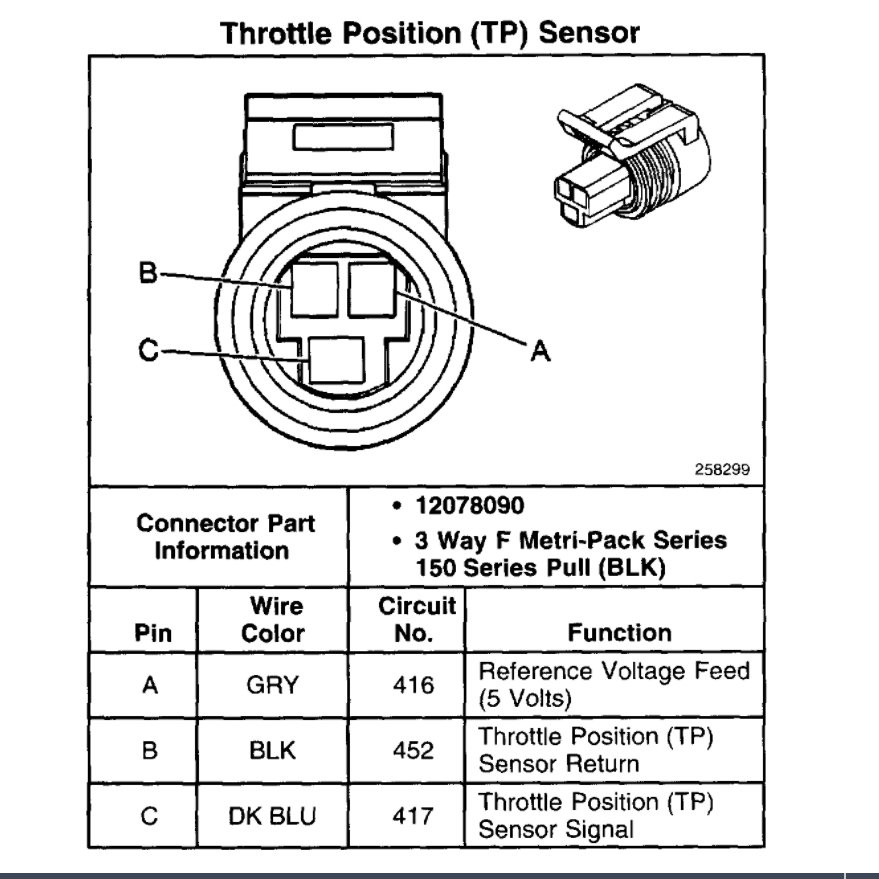

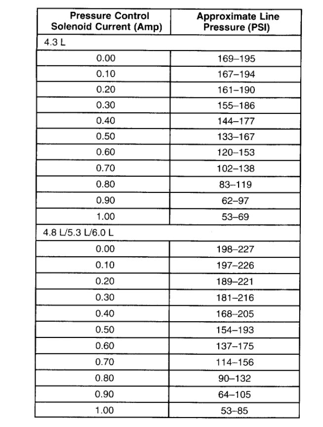

Good morning,
Did you test the TPS or throttle position sensor? This is the sensor responsible for shifting. I attached a picture of the connector. Make sure you have 5 volts at both the reference pin and the signal pin.
I attached the possible issue for no shifting below. I also attached the line pressure chart.
May 6, 2021 at 3:32 AM (Merged)
SCOT2802
Yes, I have tested the top and I also replaced it. The one thing I was wondering about is the ignition. Someone tried to steel my truck and I had to replace the tumbler for the key. Yes I did check the TPS it was good. I also replaced it in case. I also replaced the crankshaft sensor to try to cover everything.,
Okay, what about the pressures? Without the proper pressure, it will not shift.

  • 55,224 POSTS
I have seen a bad fluid pressure switch cause this issue. Here is the location so you can check it out. Check out the diagrams (below). Please let us know what you find. We are interested to see what it is.

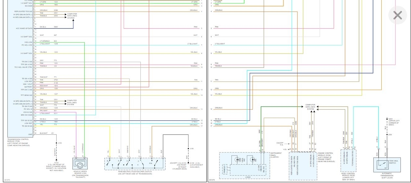

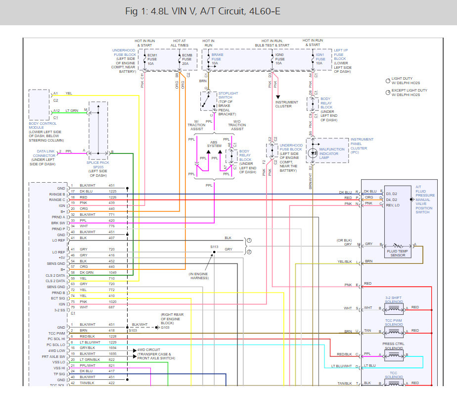

ANTHONY SCOTT RICHARDS
I've already checked the pressure switch or solenoid. This weekend I took my meter and checked the current going to the three speed sensors. The wires going to the in put and out put sensors where okay. the one that go's the the vehicles speed sensor was low on ohms. I followed it all the way to where it go's in to the ECM I checked it just before it go's in and it was low all the way to there. When I turn the ignition on the Ohms drop to no current witch was already real low. I did take the truck to the healer to have the EUM checked it they said there's no problem with it. So now I don't know what the problem could be. I've also checked all the grounds unless there's one that's on the ECM that I don't know about.
  • 55,224 POSTS
Here is the wring diagrams for the transmission and a guide to help you test them to confirm, if anything check out the transmission is having an issue internally and should be replaced/rebuilt. Make sure there is power at the fuses in the wiring diagrams
This video will help walk you through the transmission remove and replace:
https://youtu.be/3vJAojsrfuU
Check out the diagrams (below). Please run this test and get back to us.

LEAKENNEDY
Now transmission will not shift into 1st gear or overdrive. Takes off in 2nd gear, shifts to 3rd, but does not go to overdrive. Please let me know. I have worked on this problem for 4 days. Thank you very much in advance.
May 6, 2021 at 3:33 AM (Merged)
Good afternoon,
Are there any codes stored in the system?
It sounds like the valve body. First gear is not electrical, it is mechanical.
I would change the fluid and filter and check for any debris in the pan from the clutches.
I attached the location of the torque converter solenoid for you.
