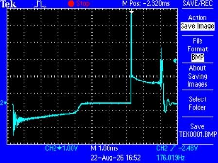

95 ford 460 engine has injector fire pulse of 5us but with a 0.2 us flicker. engine misfires only slightly. Does not change with RPM. drivability is very good. wont quite pass smog of less than 1 percent CO have replaced plugs, wires, ICM, coil. have tested fuel pressure, MAP, EGR idle air control. TPS,

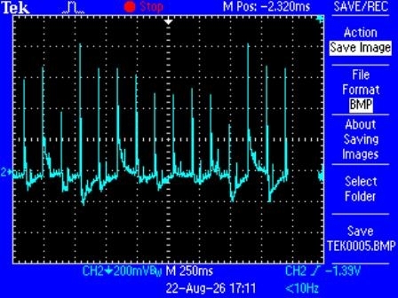

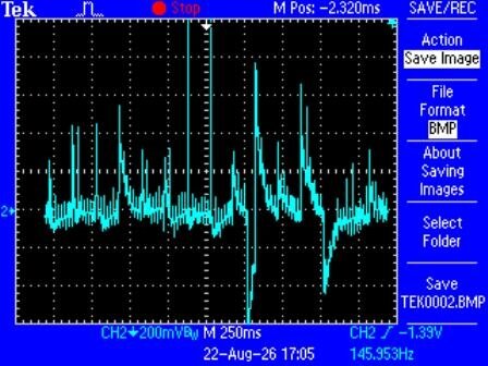

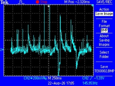

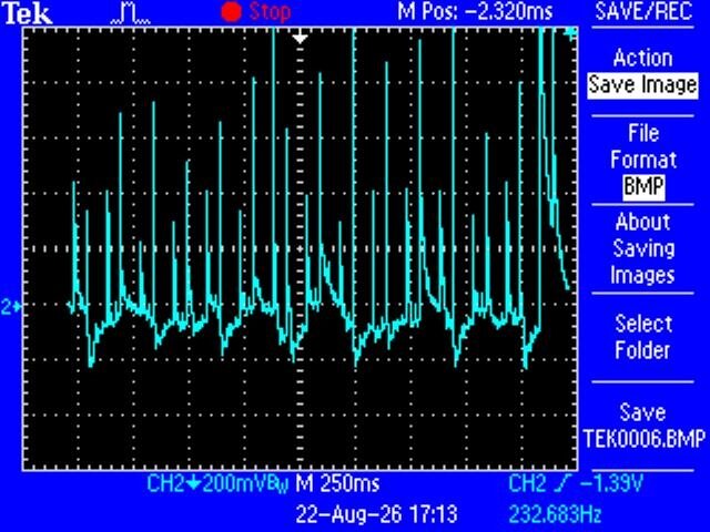

I went through the spark profiles again today and captured them on my oscilloscope. Some curious images, but I can't get them to attach to this reply
Aug 22, 2026 at 7:18 PM
  • 55,647 POSTS
Here is a test image it seem to work okay, can you please test the system with an image?

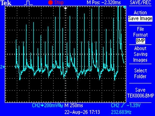

I went through the spark profiles again today and captured them on my oscilloscope. Coil waveform is consistent across all 8.
Do you have any idea how I can get a double fire on only one plug out of a distributor?? Going out to do more checking on the double one.

Now the double fire pulse is not present.

Thanks for the graphs, yes this can be caused by a shorted ignition coil, rotor, cap or coil, spark plug wire, but you said you replaced all of those correct?

I verified the right side: injector power, Injector switching to Gnd, sequentially pulled injector wires 1-4 and the rough idle only got worse.

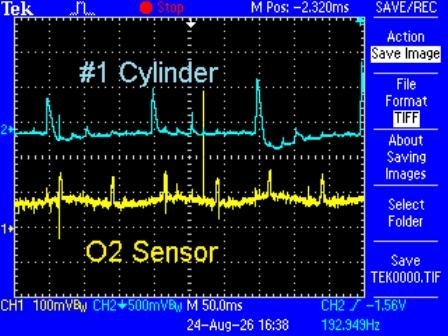

Attached image for your opinion. Am I chasing a O2 condition (regular pulsing)that is not really a problem?
I measured the temp on by Cat: input 484F, outlet 418F after 20 min idle and then running ~2000RPM to test. Research says this is bad.
Aug 24, 2026 at 5:58 PM
  • 55,647 POSTS
Yep, that does look like the cat is bad. I would try driving it though and test it again, idle might not give you an accurate test.

the O2 waveform is the (only) upstream sensor.
What would cause the syncronis-to-spark pulses / are they enough to throw off the emissions?? (I haven't seen them on any waveforms online for reference)
Aug 25, 2026 at 2:26 PM
  • 55,647 POSTS
An exhaust leak will cause this, can you hear any when the engine is running?

The pulses are only on 2 cylinders.
I was planning an Exhaust leak test anyway.
Aug 26, 2026 at 12:15 PM
  • 55,647 POSTS
Yep, that will cause the issue we are having.

The pulses on the O2 are from ground bounce caused by fuel injectors firing 4 at a time.
