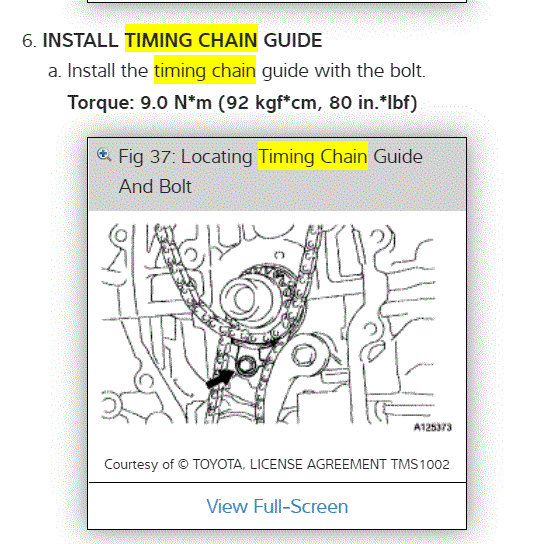

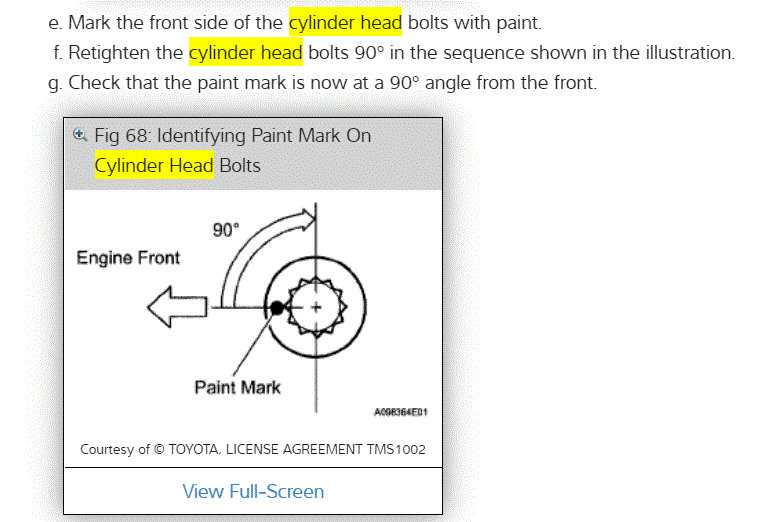

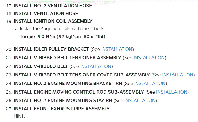

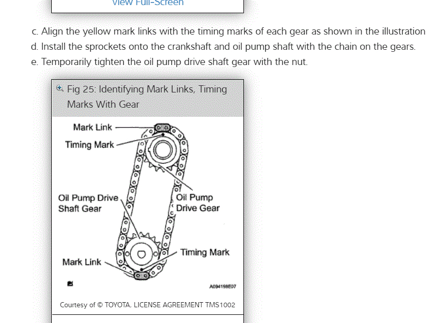

Okay, was able to remove the head without taking off the timing chain cover. Made some space with loose bolts and was able to get the one stupid chain guide bolt out but left in place. Head was quite warped in the center which matches the 2 and 3 missing problem. Head is back on somewhat, was able to get the guide bolt back in. Waiting for some head bolt washers as I misplaced 2 (more rookie stuff). I did tie the timing chain up to hopefully keep it in place and I sealed the timing chain cover where it separated. So if the timing links up above match the picture I took before removing the cams and I do not have an oil leak, I will be the luckiest rookie alive. Russ.
Thursday, May 20th, 2021 AT 10:11 AM
  • 109,867 POSTS
Russ,

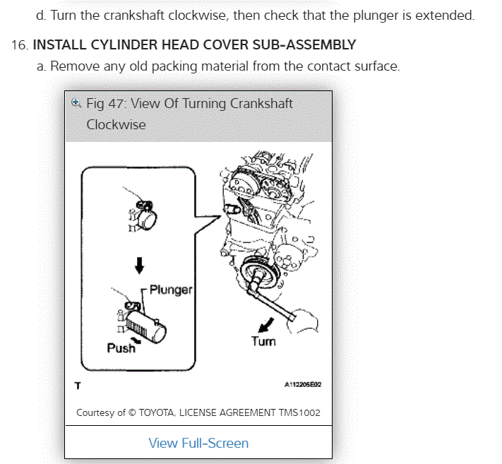

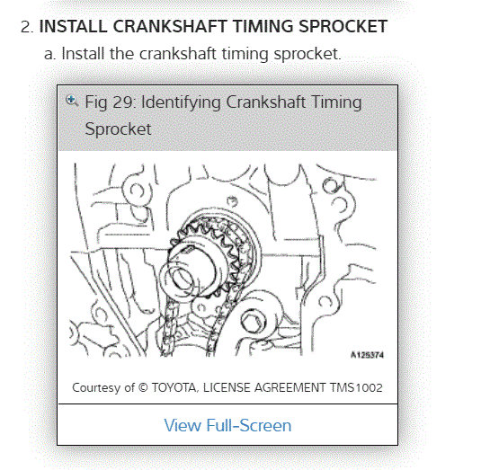

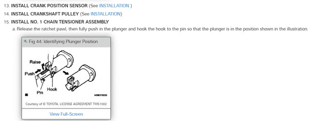

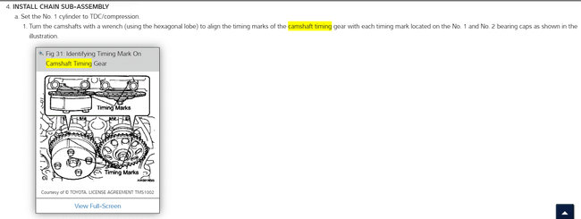

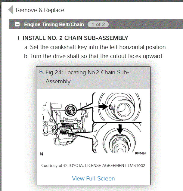

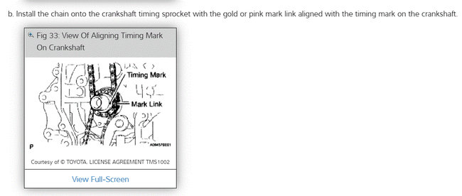

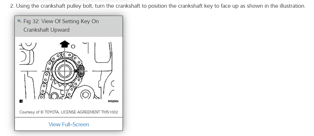

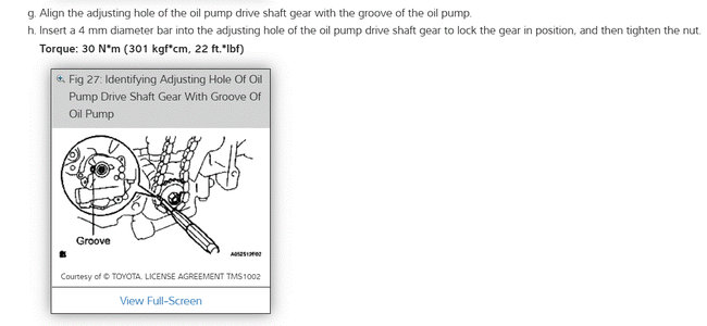

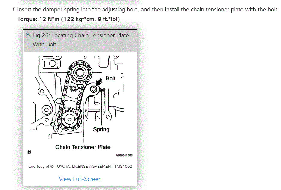

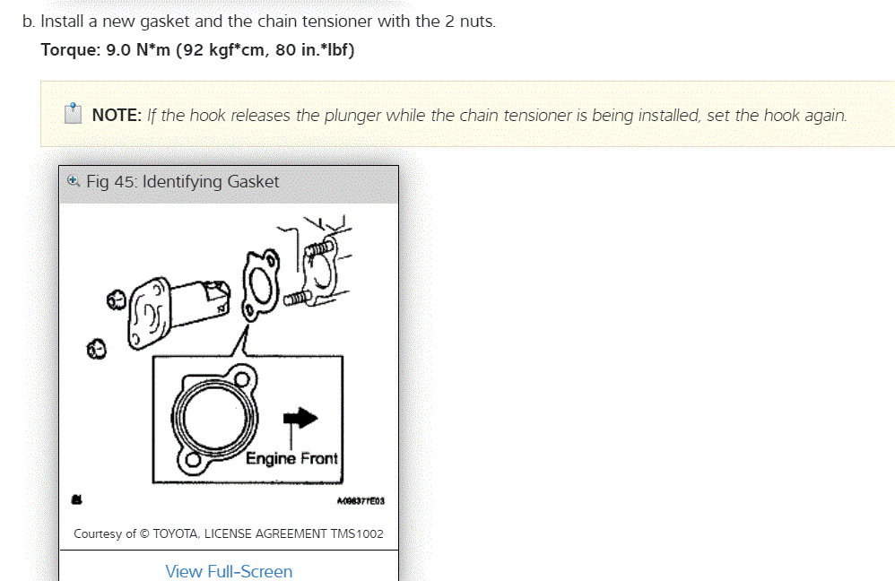

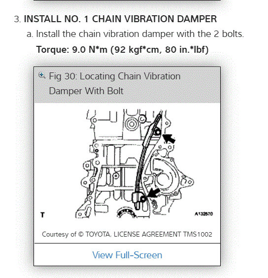

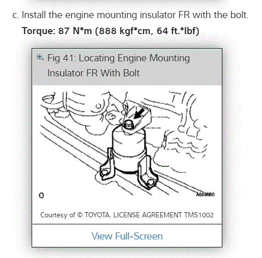

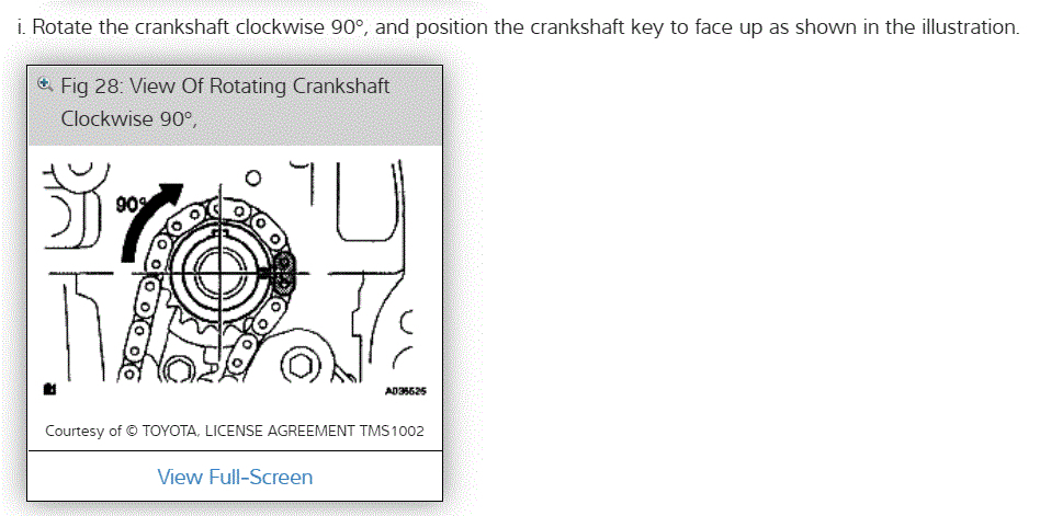

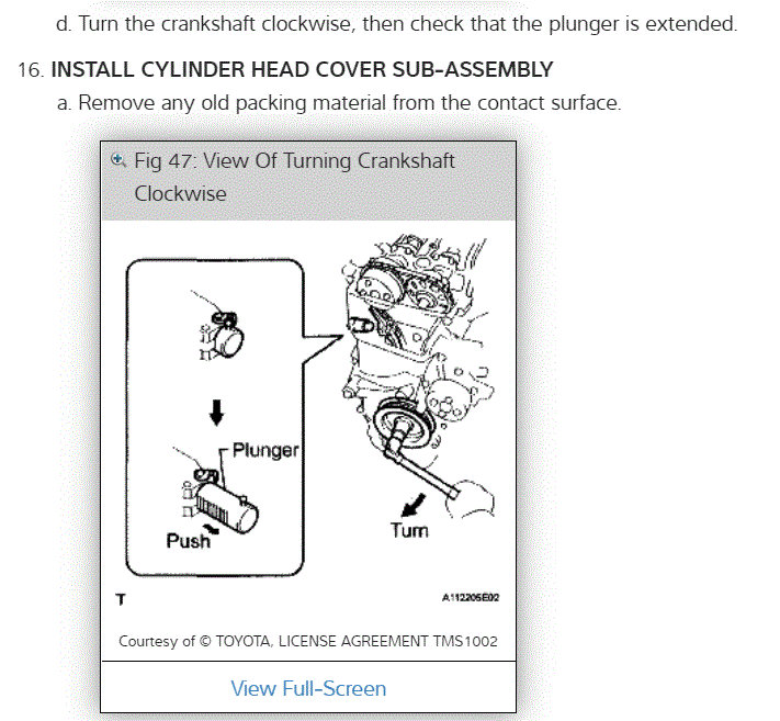

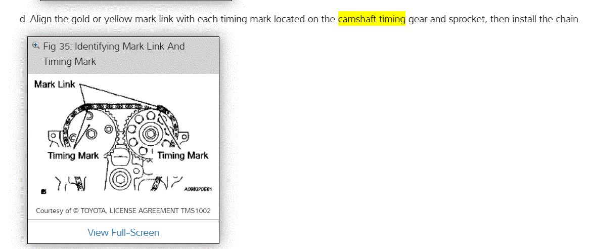

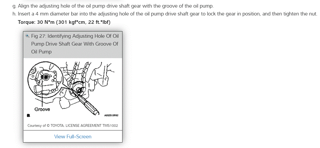

Make sure the timing is correct. I don't believe any Toyota 4 cylinder engine is an interference engine. However, turn the engine by hand when you have the chain on it. Make sure the crank makes several full revolutions. If you feel anything binding (and I don't think you will) do not force it.

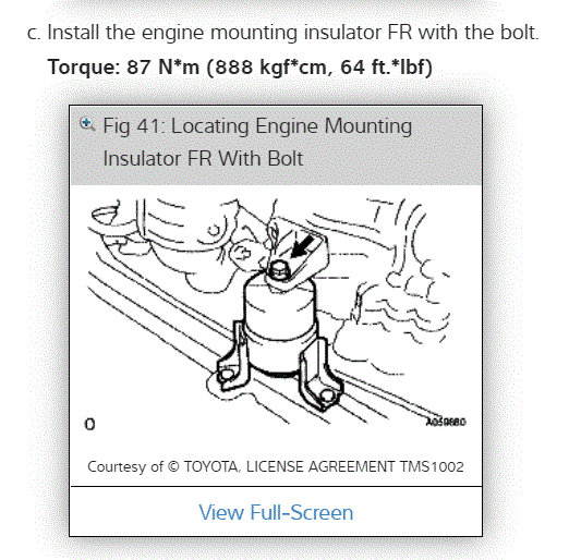

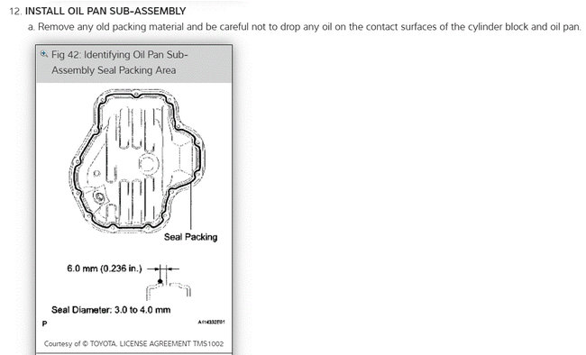

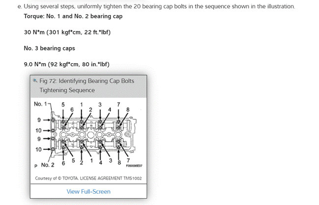

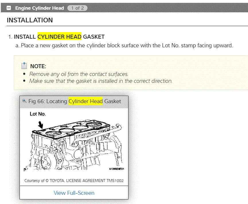

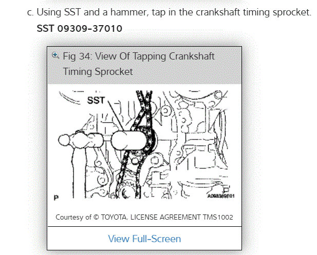

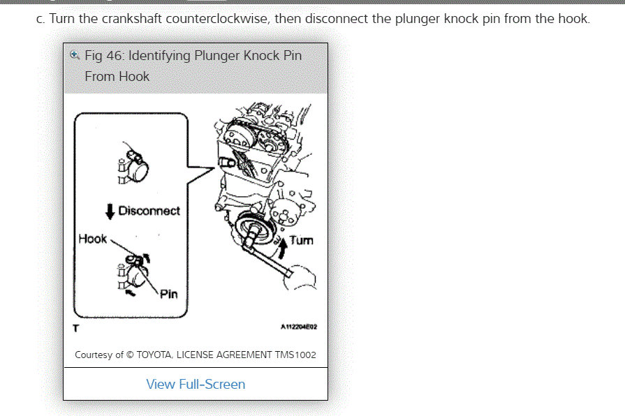

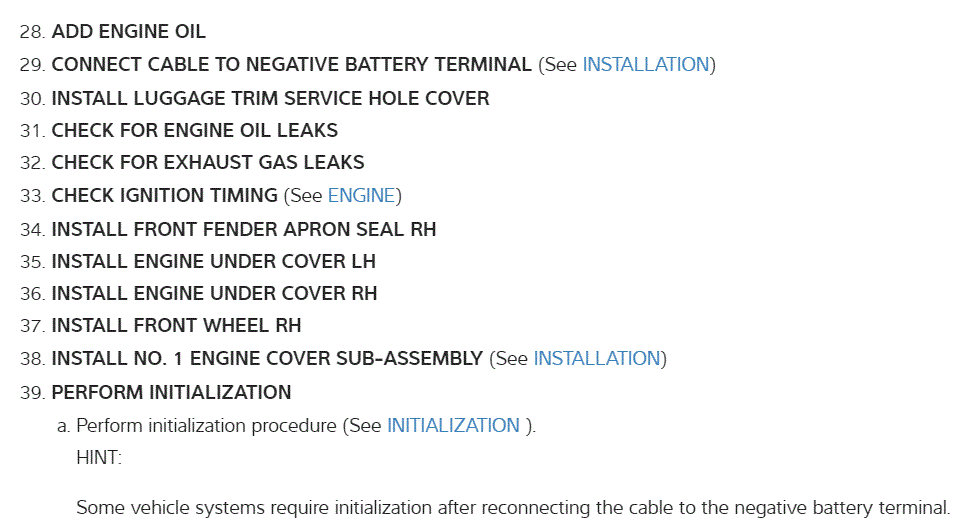

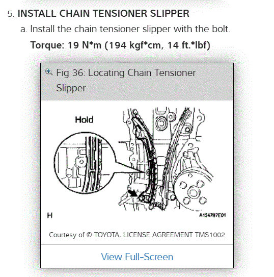

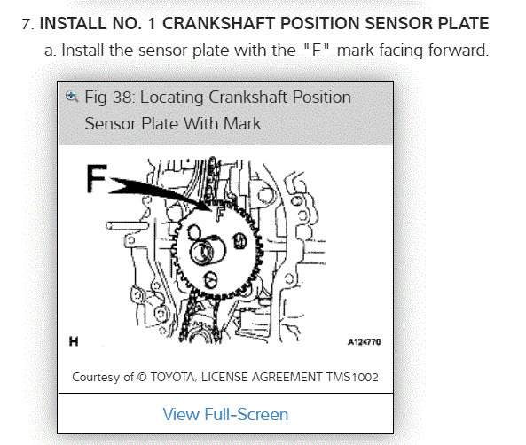

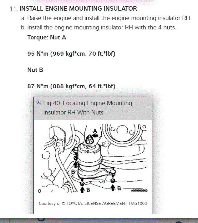

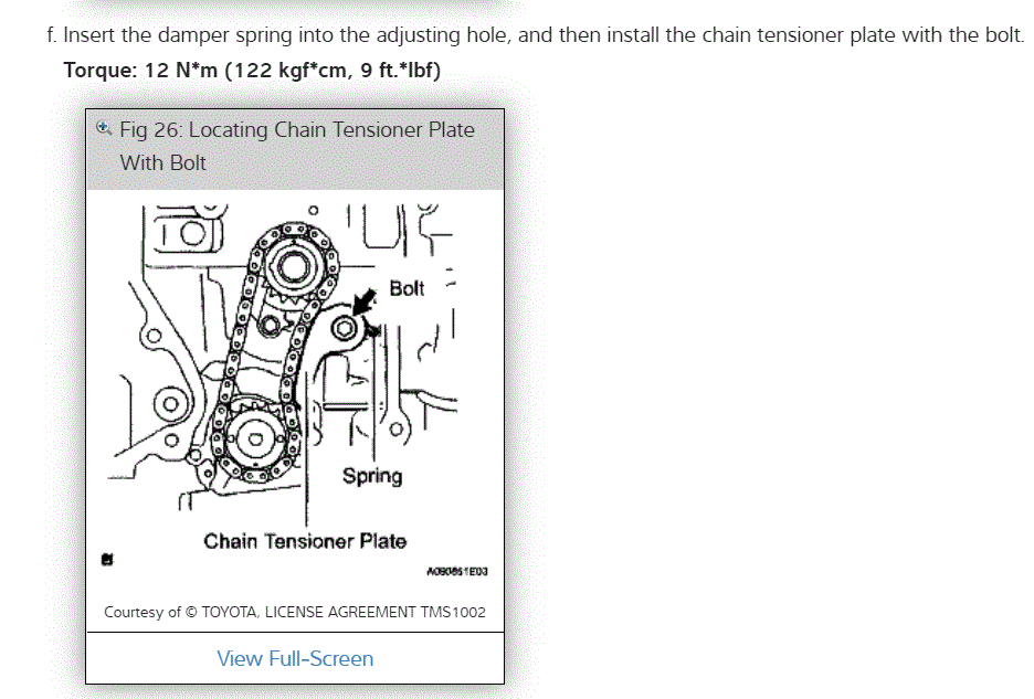

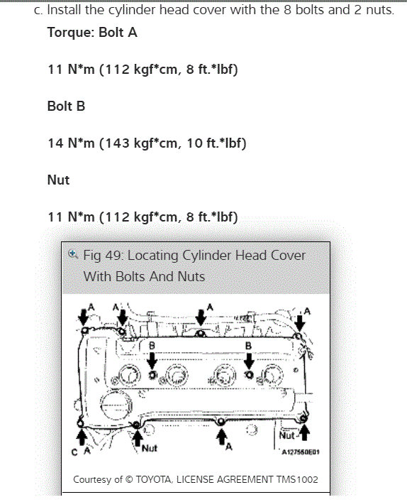

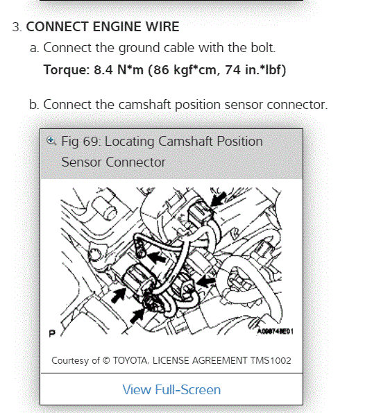

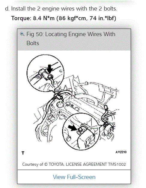

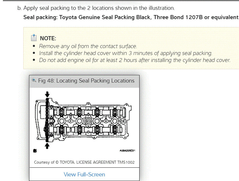

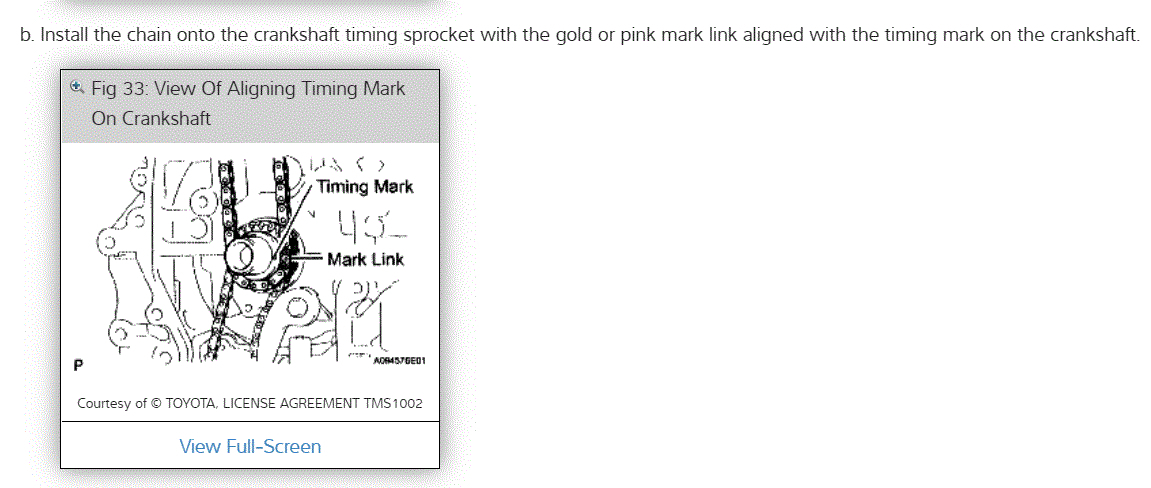

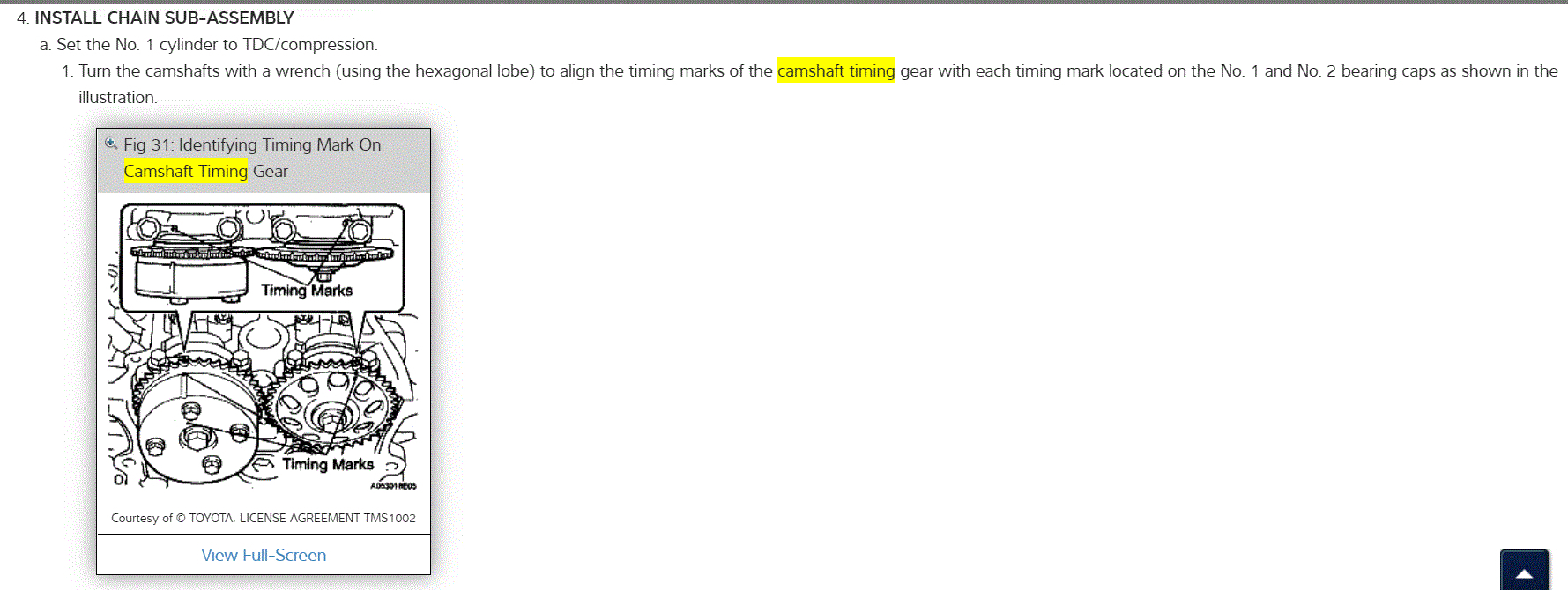

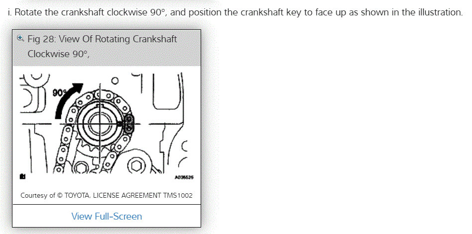

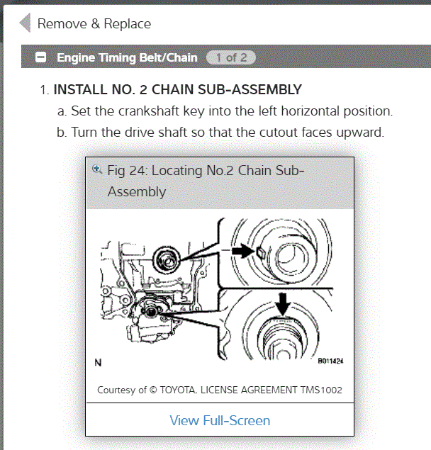

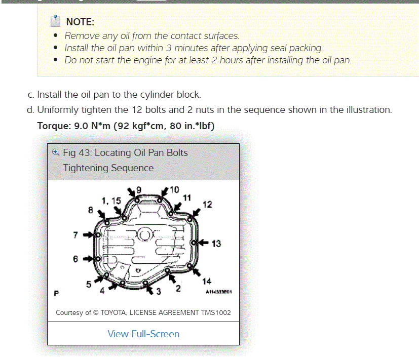

I attached the directions for the total replacement of the chains. They show how everything aligns. I'm adding these so you have them in the event they are needed.

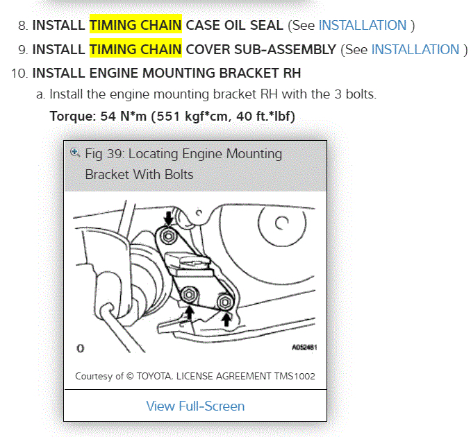

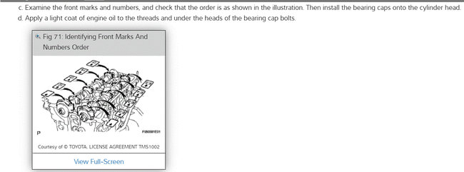

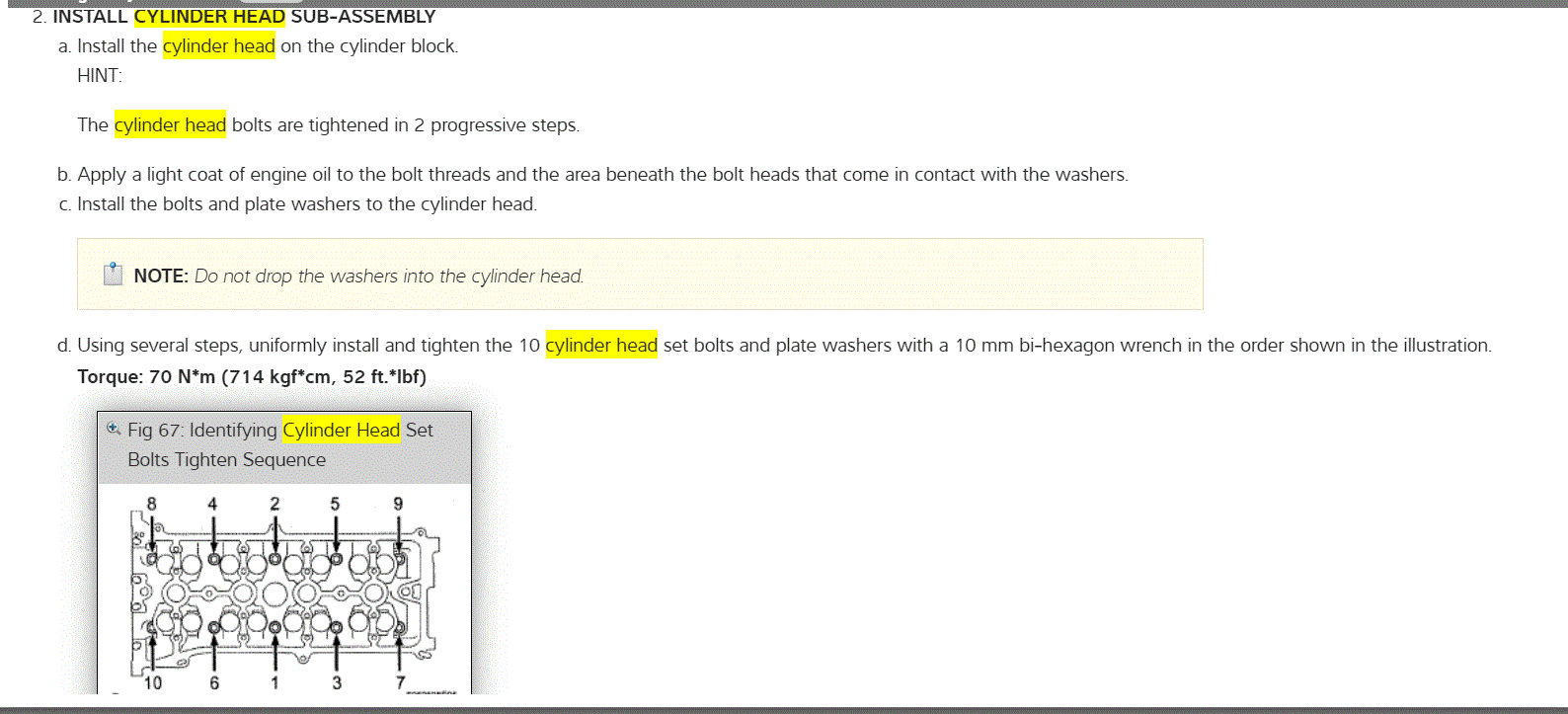

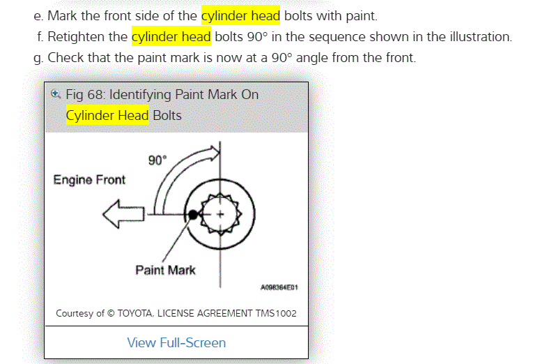

Starting with pic 30, the directions for head replacement are included. These directions include the torque specs and tightening sequence when torquing the cylinder head. Make sure to follow both.
Let me know how you make out of if you need help.
Thursday, May 20th, 2021 AT 7:01 PM

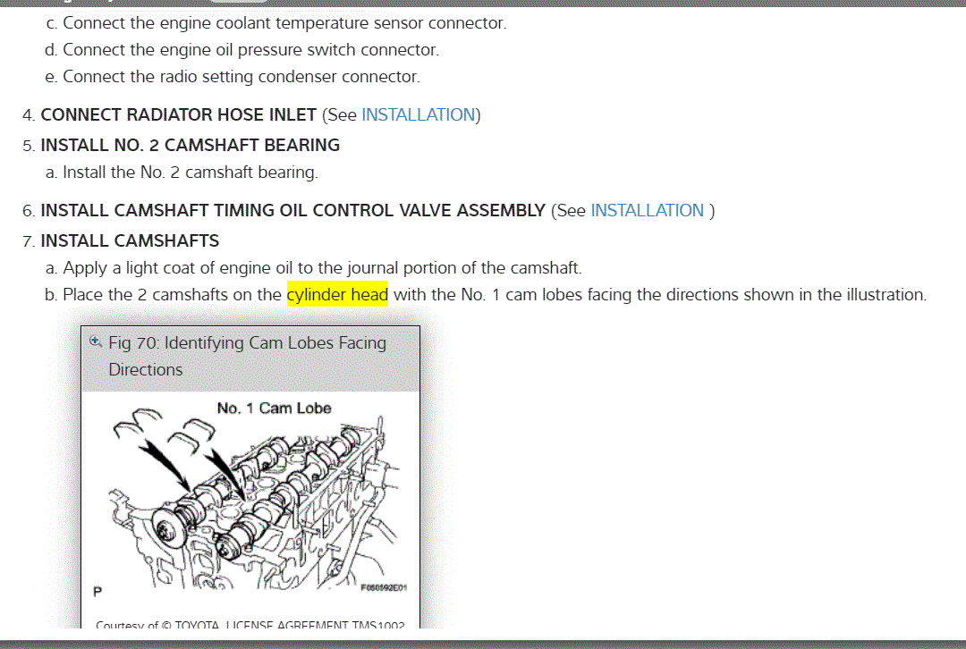

Joe, I did continue to rotate the engine until the links lined up properly with the cam marks. Piston 1 is up and both cam knobs, intake and exhaust, should be pointing out horizontally when I put the cams back in. I was planning on manually rotating the engine several revolutions just to make sure there was no issues. Thanks for all the detail above. Hope I do not have to take the timing cover off. Russ.

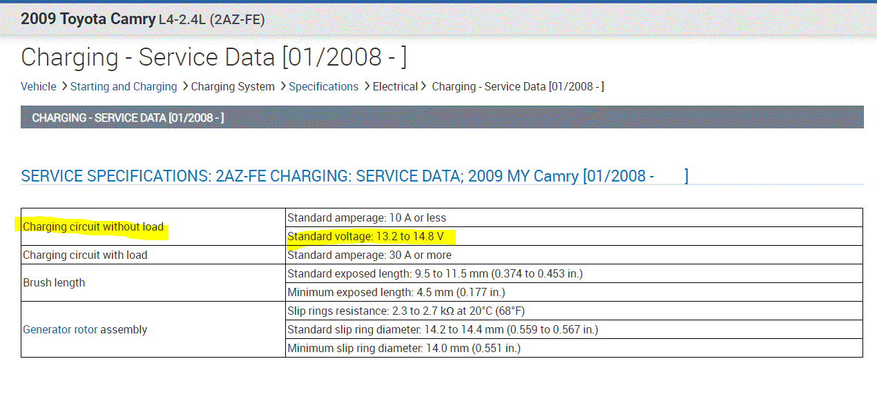

Success, so far. The engine idles nicely when warm, no white exhaust smoke. Not driven yet so well not know about an oil leak until I put some miles on it but very happy with the result so far. Have a battery light and the alternator is only putting out 13.45, so that is most likely the problem and need to reset the engine light or chase another problem. Cars, just love them. Russ.

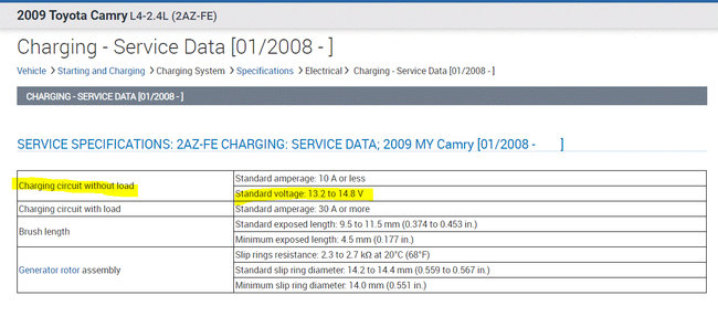

Russ, the 13.45 with the engine running and loaded is good as far as alt output. Are you checking it at the battery? Even if the electrical system isn't fully loaded, that is still a good voltage. Make sure nothing around the alt has been damaged or left unplugged.

Joe, the 13.45 was not loaded. The battery tested okay. Changed out the alternator and the battery light went out right away. BTW, had read somewhere on the net that the unloaded voltage should be 14V or above. I am not sure where the trip voltage is for a 2009 Camry but there is probably a spec someplace that states that voltage in the control unit docs. I will measure the voltage of the remanufactured alternator and let you know. Just curious myself. Very much appreciate your support and very much enjoy the dialogue. Thanks, Russ.

You are very welcome. I really did nothing. You did the work. As far as the alternator, I'm glad the new one turned off the light.
The voltage of the old one was within the manufacturer's specifications. However, that doesn't mean something wasn't wrong internally causing the light issue.
If you look at the attached pic, it shows the unloaded voltage range.

Joe, given that spec, I am surprised the light was on. The old alternator was on the very low end of the range and I guess the control unit sensing may not be exactly 13.2V. Anyway, just a thought. It is my Son's car and he is driving it. He was over last night and came in for just a moment that turned into 15 minutes while the car was idling. Seemed that the engine was quite warm and one fan was kicking on intermittently. The dash temperature gauge was a little less than half towards hot. I do not want an overheat due to a faulty sensor but not sure I should be alarmed. Any ideas or suggestions? Thanks, Russ.
