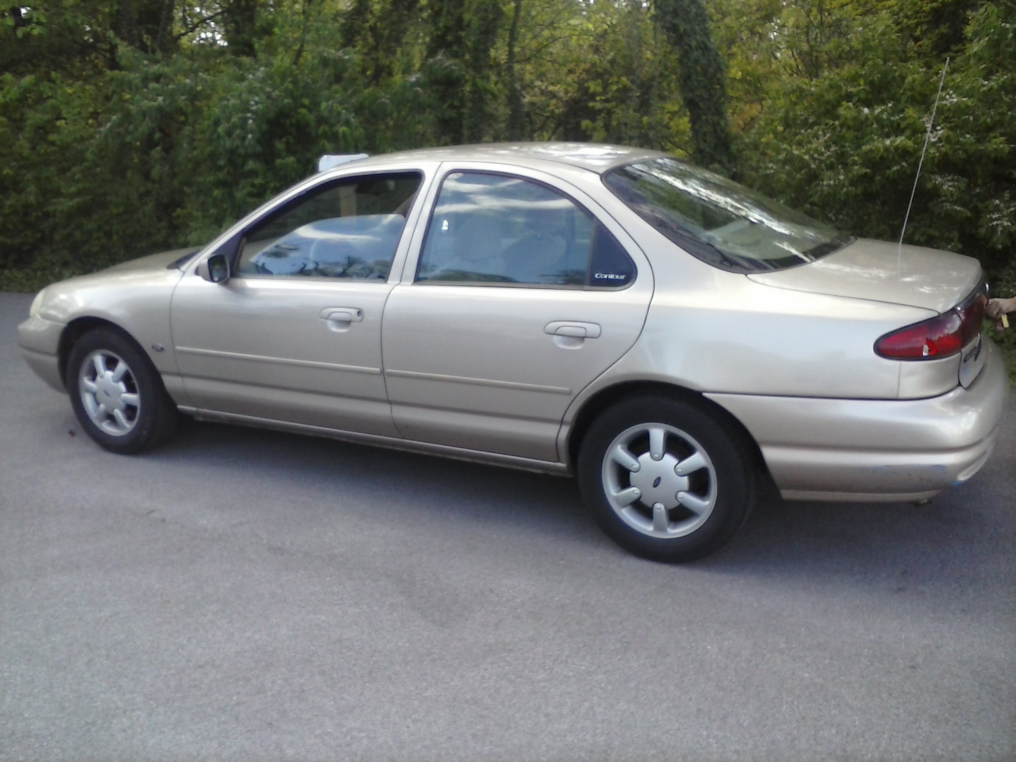

misfiring bog down
1999 FORD CONTOUR
137,000 MILES
KELLYGHORMLEY
Ran diagnostic test came back with 2 codes 3 cylinder misfire and back lean. Replaced plugs and wires with new ones. Ran another diagnostic test. Came back with 3&4 cylinder misfire and back lean. Replaced coil pack with new one. Also replaced thermostat because got stuck same day. The car still missing and when overdrive is on it runs worse what else could be causing this? Was running normal until 5 days ago this started. My check engine, light was staying on till replaced coil pack now it flashes periodically.
