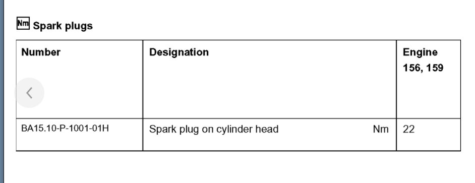

Thank you. What is the spark plug torque on these?
Monday, June 14th, 2021 AT 7:44 AM
DIVIDES
  • 898 POSTS
I don't have that.
Monday, June 14th, 2021 AT 12:31 PM
Attached below is the torque spec of spark plugs. Thanks
Tuesday, June 15th, 2021 AT 7:17 PM

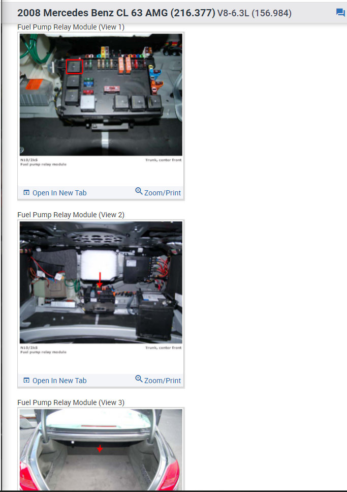

Thanks. Can you find me the location of the fuel pump relay or module? The picture you sent me doesn't match.
Tuesday, June 15th, 2021 AT 7:20 PM
DIVIDES
  • 898 POSTS
Do you know where is the fuel pump relay/ module? The picture you sent me for the truck area looks different than what I have. I have an 08 cl63, if this is all you have just tell me that.
Thursday, June 17th, 2021 AT 6:41 AM
My apologies. You noted that this was a CL and not a CLS but I looked in the heading for the vehicle when pulling that info.
Below is the info for the CL.
Thursday, June 17th, 2021 AT 10:12 AM

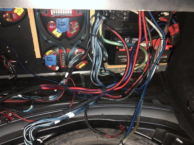

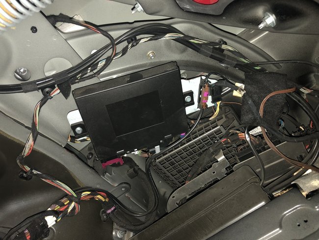

Nothing in the trunk like this, I pulled the back panel and the battery is in there as well as some amplifier connections that were previously installed. Battery does not sit in like the picture and there is no fuse or relay box like the picture.

Unfortunately we are limited to what the manual says and this is where it shows this for a 2008 CL63 as you can see in the header of the picture.
Is this vehicle in the USA? If not, then that may be the issue. They more then likely put this in a different location for international vehicles and we only have USA manuals.

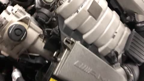

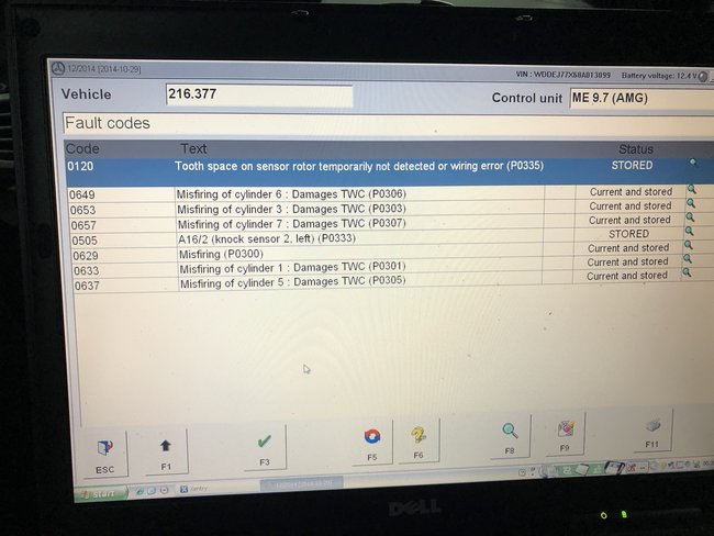

With new plugs torqued to 22 started much better and without needing to hit the gas pedal. I suspect this noise I am hearing is from a torn/broken manifold gasket. I will need to jack it up to get a better feel.

Runs better with new plugs but still the noise and stalls. Gotten the xentry software and it keeps giving different misfires every time I delete them. But always a knock sensor bank 2.

I noticed the sound around the intake and that the front part was so hot even when the motor wasn't very warm.

I looked through the post and did not see the knock sensor code. So if you have had that the entire time, what is the actual code?
More than likely that is a result of the serious knock that you have but if the sensor is faulty then it is not going to sense the knock and try to adjust for it. However, knock sensors are meant for detonation and not engine knocks like this so even if the sensor is an issue, I doubt that is going to go away.
I suspect that is a spun bearing and if you are feeling heat on the intake then I suspect there is either metal to metal causing heat or valves allowing combustion back into the intake due to them not sealing.

No just recently seen it.
Tuesday, June 29th, 2021 AT 7:55 PM
Okay. That code is stored while the others are all current/active. So that means it may have seen an issue but that is not causing this issue.

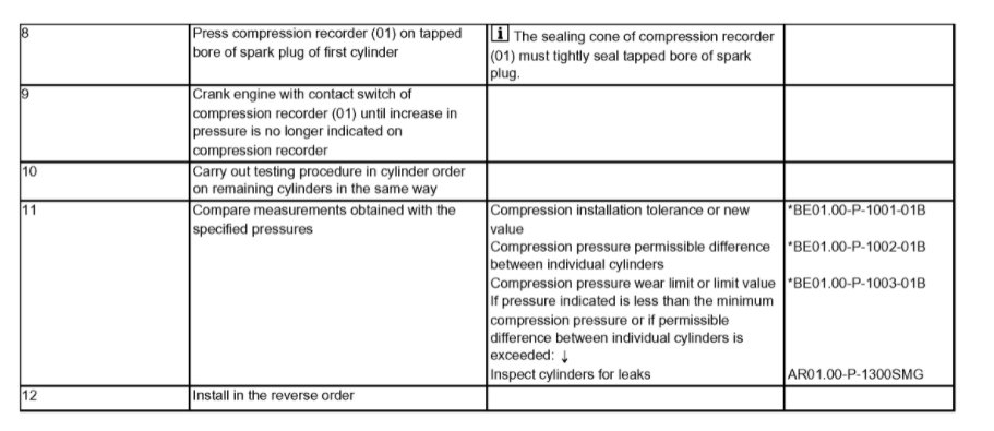

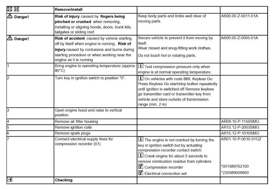

Just circling back on the compression check, did you ever check compression, at least on the cylinders that are misfiring? Have you drained the oil and checked for metal? Also, have you checked it again since it has been running for coolant again? I know you said it had coolant in the oil when you bought it.
I know we had an issue with the relay but you should be able to do what is called a clear flood and crank the engine and it not start for when you check the compression. This is where you hold the accelerator wide open while you are cranking the engine.
This will cut the injector pulse so that the engine doesn't start. Basically you are telling the PCM that the engine is flooded and you don't want any more fuel so that it doesn't hydrolock.
Clearly try this first just to be sure it works because while I show this in the manual, we have had enough issues with this that I wouldn't want have this be incorrect as well.

No not even with the pedal down it will eventually start. I didn't say there was coolant in the oil, there is no mixing and the oil is very clean, coolant is full and clean. Someone suggested the adjusters but am familiar with adjusters noise and it's usually on startups bit the noise is away from the front of the cams. I didn't do any compression tests cause it would still start and am afraid the values won't be correct.
Wednesday, June 30th, 2021 AT 7:39 PM
Okay. Here is the process from the manual. It just tells you to remove all the coils and plugs which will clearly prevent the start and vent the cylinders so any fuel will evaporate quickly.
