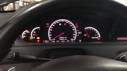

this is actually a cl63 but I didn't see an option for it, its an AMG 6.3l.. I bought it non runner even though it starts and barely drives.. when I scanned it it came with misfires on all cylinders, has oil and coolant, does not overheat if left running, but I can only drive it short distance as in getting in and out of garage and it stalls a lot. hardly any response to the throttle, if I pump it a bit I can get it to rev.. but check engine light is flashing.. where would you start on something like this?

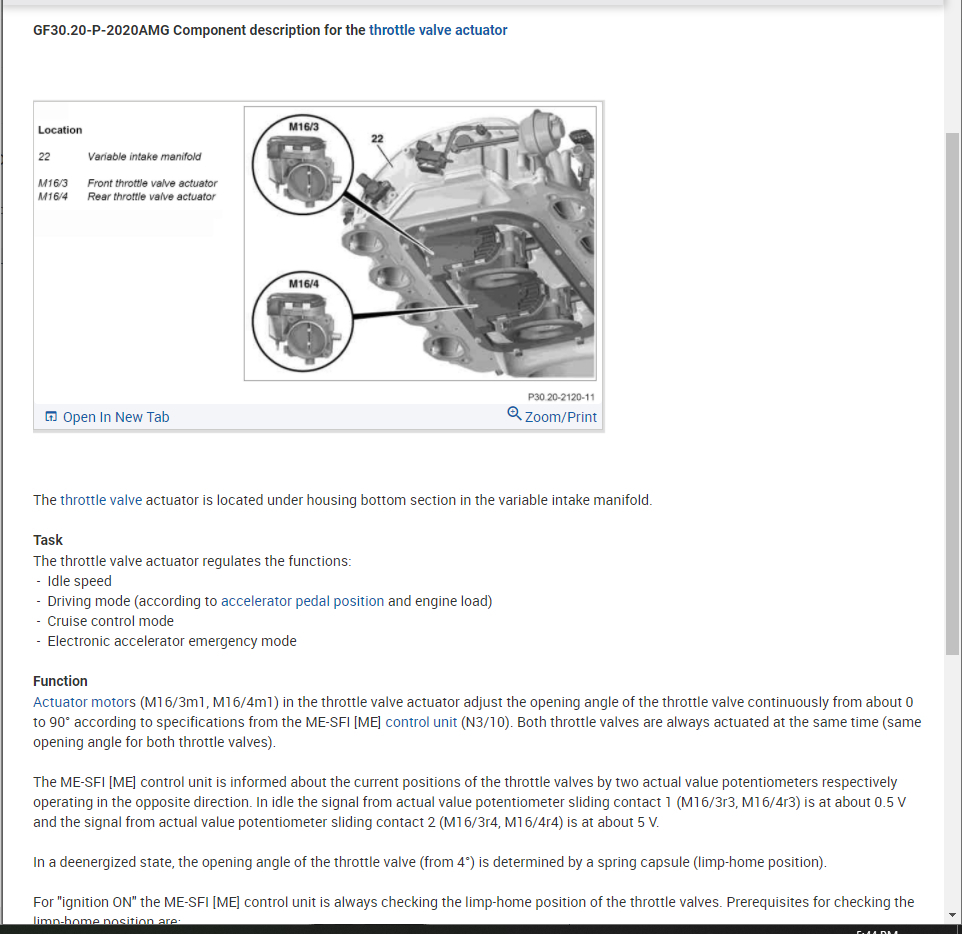

I am leaning towards a clogged up/blocked catalytic, especially if it's an aftermarket. I have not checked whether it is yet. Or maybe a fuel delivery issue or a bad ECU, no way that all 8 misfire even if the motor has a head gasket or is bad.
Jun 7, 2021 at 10:50 AM
You are correct. That if all cylinders are missing then it is something that affects all cylinders. This would be air or fuel.
So I would start with checking fuel pressure and make sure it is okay.
If the fuel pressure is ok then we need to check for exhaust restrictions like you are suspecting. To do this, I would just remove the up stream o2 sensors and see if the throttle responds better. If it does then the converters are backed up.
If it does not then we could still have an issue with the torque converter. Does the engine rev normally in park or neutral? In other words do you only get this misfire or poor throttle response when in gear?
Lastly, do you only have the misfire codes or do you have others?

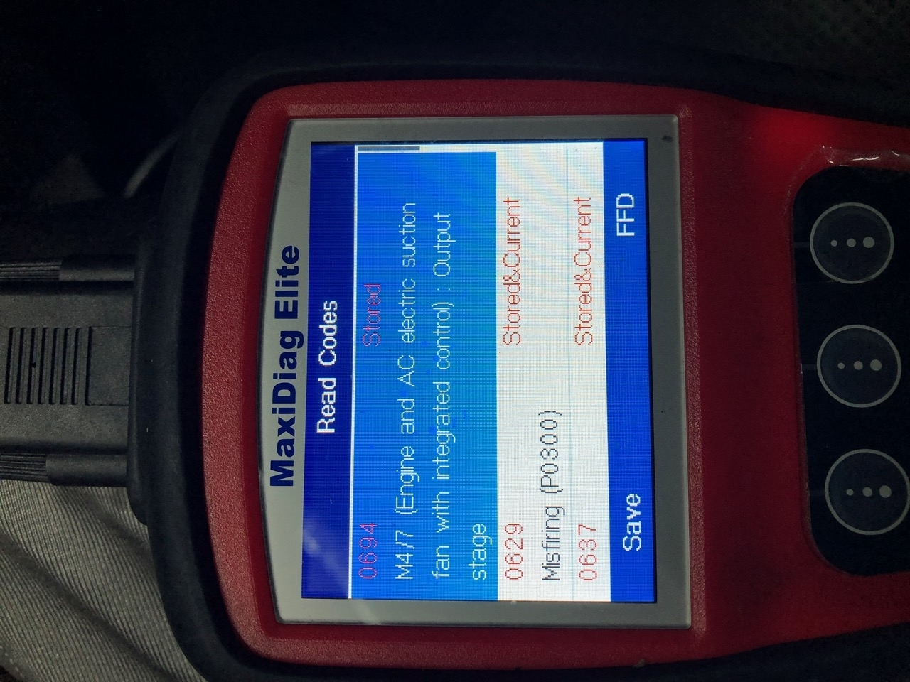

No codes other than misfires, have not done a thorough scan but i will. Yes the 6.3.

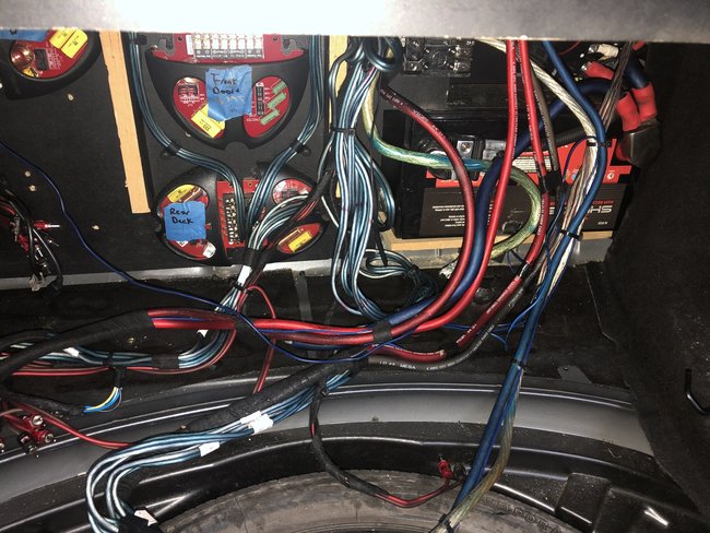

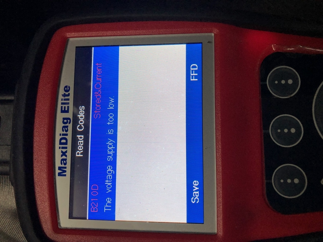

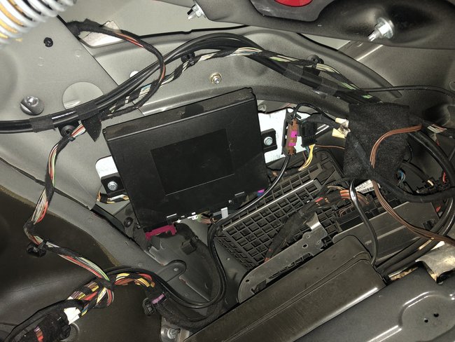

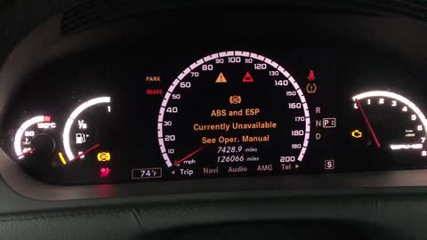

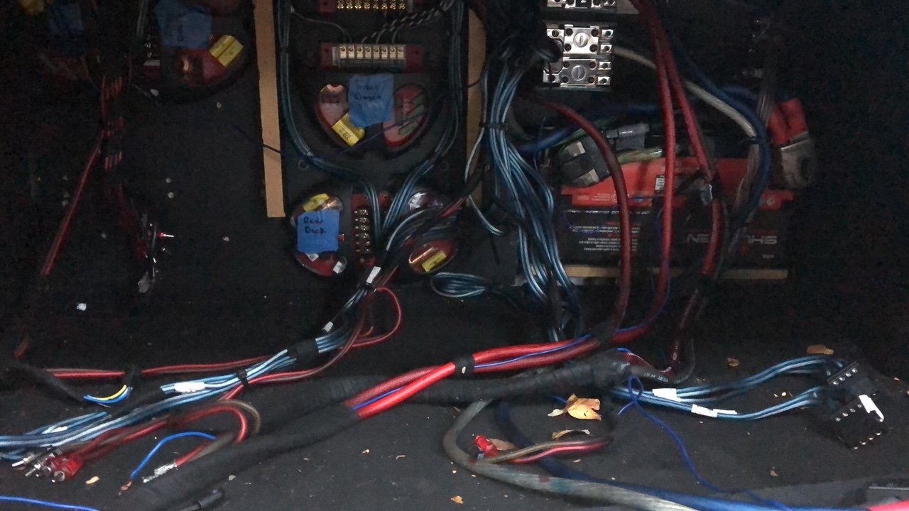

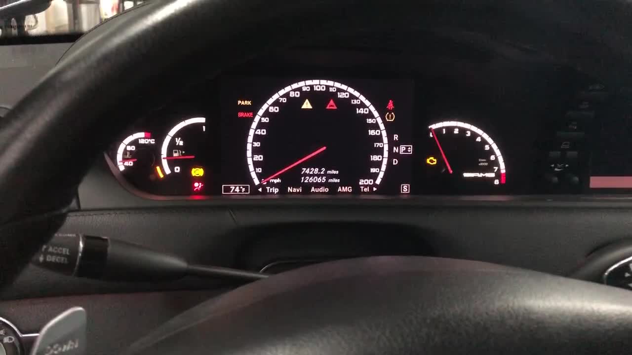

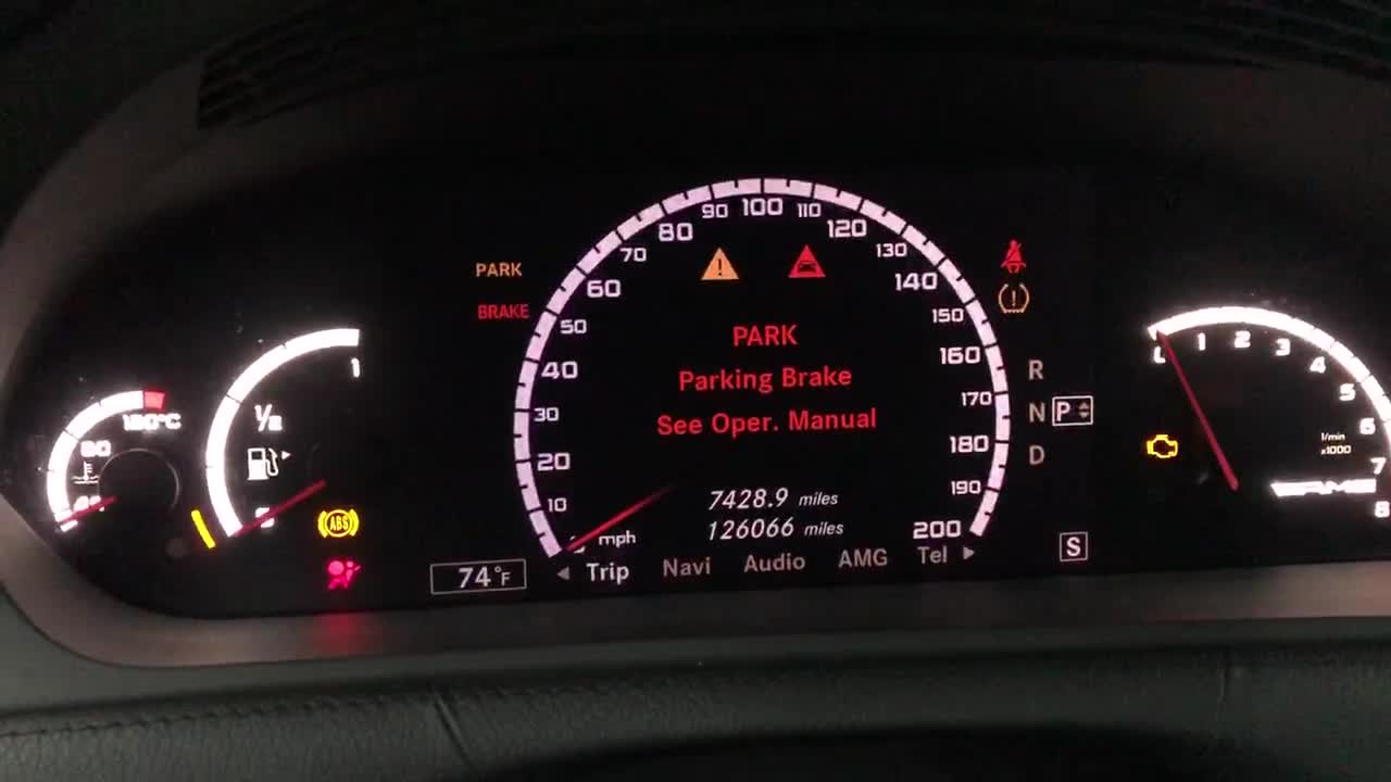

I think we have an electrical issue. I changed 4 coils, then cleared it, and started it, still misfiring but gave me a misfire for another cylinder. This car has so much wires/amps in the trunk that was left in it, they only removed the speaker box they had in it, must be expensive stuff. I have never seen anything like this before.
Anyways, there is an additional battery in the trunk with all the amps and wires. Unless I am mistaken this battery has nothing to do with the car itself. So I disconnected the negative battery just in case it has an effect.
Reason I suspect an electrical issue is because the cluster and lights and the whole car just goes off on its own, even before disconnecting the rear battery. While I am scanning it it does that. Once I turn the ignition off and then remove it and reinsert it it comes back to life, and there is flickering a lot...I measured the battery which is not an AGM under the hood and its 12.20...while running around 14....very strange..I will send you pictures, and videos
Jun 10, 2021 at 4:06 AM

Attached.

measured the rear battery and it's 10.95, am trickle charging it. I also realized this is the second battery as well which runs the electronics so it must be connected.
Jun 10, 2021 at 4:48 AM
Just to take a step back. I should have asked for a video before because that is not just a misfire. When you are revving the engine it sounds like it is knocking pretty bad. It could be just dead cylinders but have you checked compression on this engine?
Either way, it sounds like this has some serious issues so before we dig further into the other issues, I would suggest confirming the base engine is okay.
Jun 10, 2021 at 12:39 PM

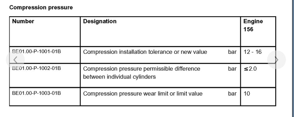

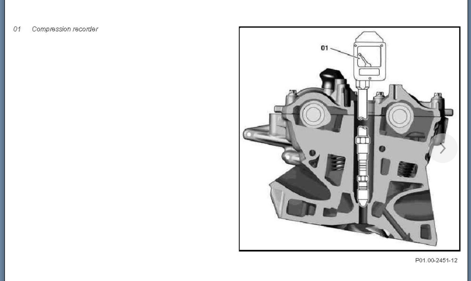

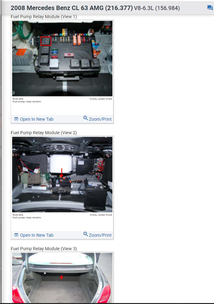

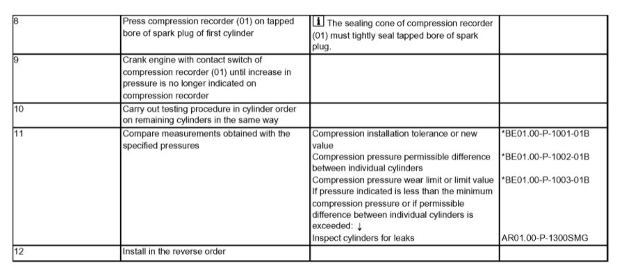

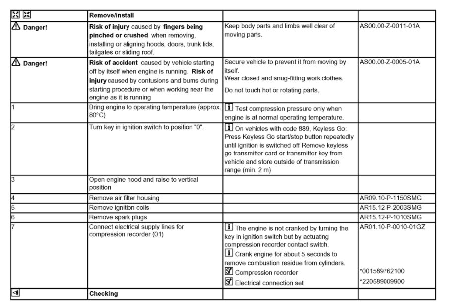

I want to do a compression test on 2 cylinders on bank 2, do you know where the fuel relay is? Or fuse? I will remove two spark plugs and measure both cylinders or 4, i don't need to remove all do i? And dry i guess. Also, keep the gas to the floor when doing that? And what is the range if PSI i should look for?
Jun 13, 2021 at 11:56 AM
DIVIDES
  • 903 POSTS

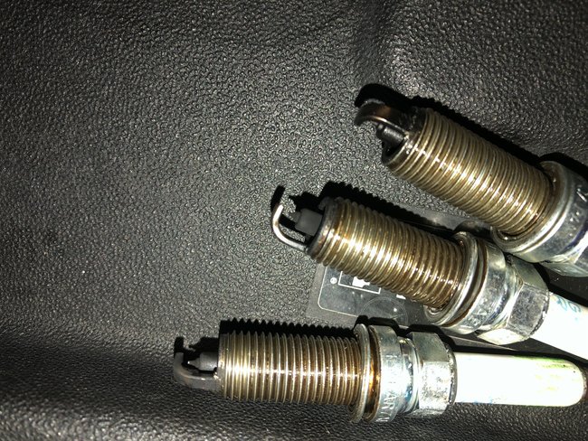

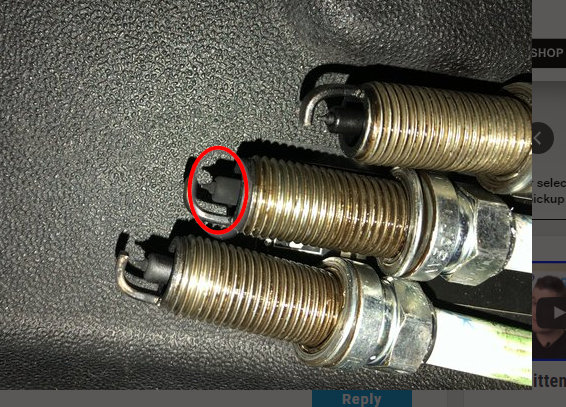

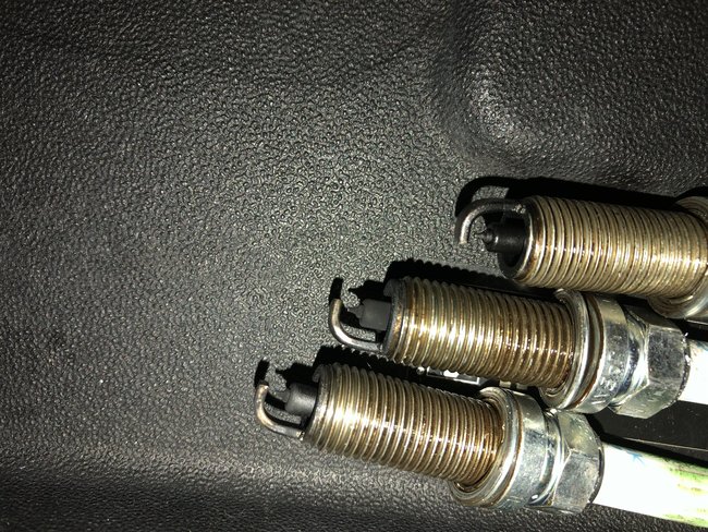

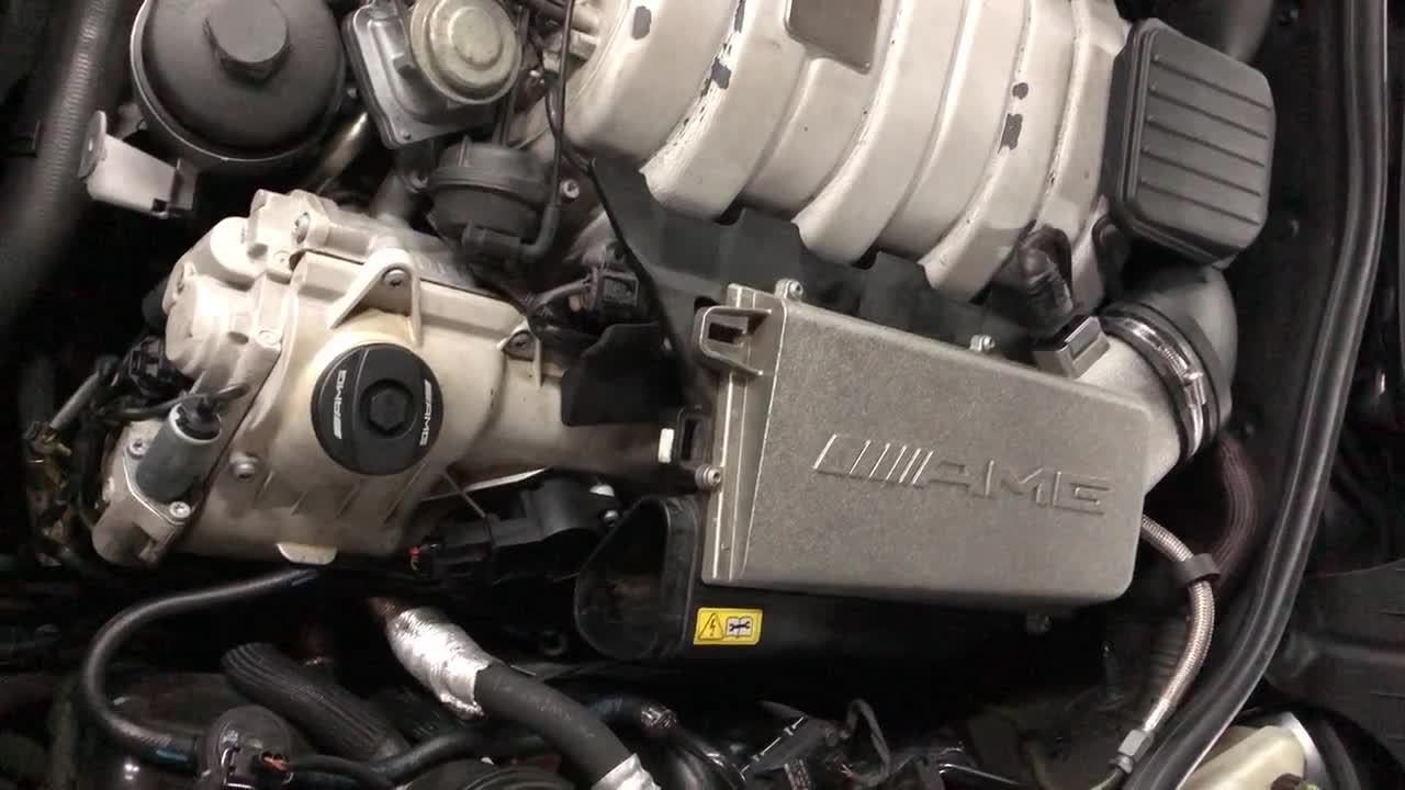

Pictures of some of the plugs, and the top of cylinders. Can't find the fuel relay to remove and do a compression test.
Jun 13, 2021 at 1:07 PM

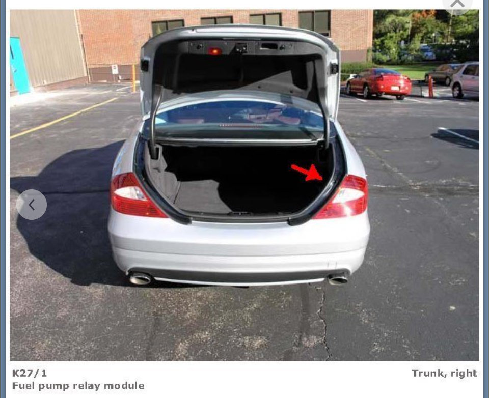

It may just be the flash but some look okay. However, others appear to be very carbon fouled. That means there is too much fuel going through the engine. Either due to misfire or leaking injectors. Based on this we need to check the fuel pressure and see how long it holds after the key is shut off. Basically how long does it take to bleed down.

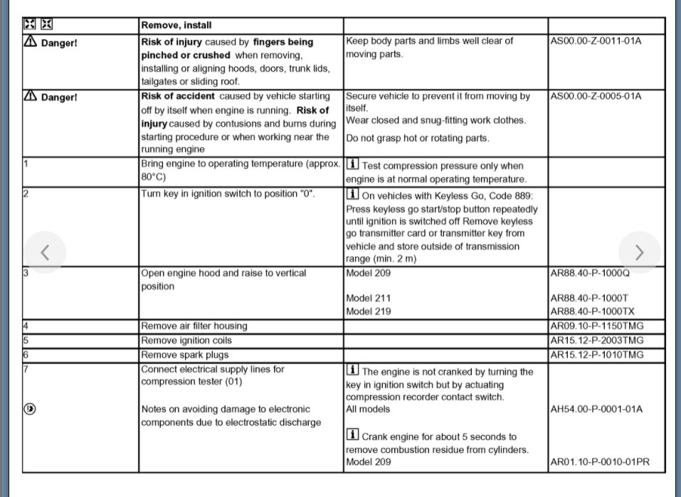

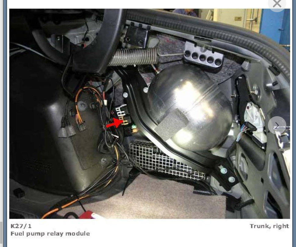

Also, to do the compression test, you are going to have to use the relay control module in the trunk because you don't have a traditional relay. If you just unplug this module then the pump won't run. Or you can do the clear flood method as you stated where you hold the pedal to the floor and crank the engine but this is best with two people. I attached the process from the manual to do this test.
Plus here is a guide that will help as well:
Jun 13, 2021 at 11:35 PM

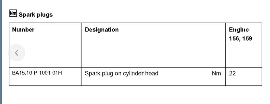

Thank you. What is the spark plug torque on these?
Jun 14, 2021 at 12:44 AM
DIVIDES
  • 903 POSTS
I don't have that.
Jun 14, 2021 at 5:31 AM
Attached below is the torque spec of spark plugs. Thanks

Thanks. Can you find me the location of the fuel pump relay or module? The picture you sent me doesn't match.
Jun 15, 2021 at 12:20 PM
DIVIDES
  • 903 POSTS
Do you know where is the fuel pump relay/ module? The picture you sent me for the truck area looks different than what i have. I have an 08 cl63, if this is all you have just tell me that.
Jun 16, 2021 at 11:41 PM
My apologies. You noted that this was a CL and not a CLS but I looked in the heading for the vehicle when pulling that info.
Below is the info for the CL.
Jun 17, 2021 at 3:12 AM

Nothing in the trunk like this, i pulled the back panel and the battery is in there as well as some amplifier connections that were previously installed. battery does not sit in like the picture and there is no fuse or relay box like the picture.
Jun 17, 2021 at 4:20 AM
DIVIDES
  • 903 POSTS
Can you please find it?
Jun 23, 2021 at 10:58 PM
Unfortunately we are limited to what the manual says and this is where it shows this for a 2008 CL63 as you can see in the header of the picture.
Is this vehicle in the USA? If not, then that may be the issue. They more then likely put this in a different location for international vehicles and we only have USA manuals.

With new plugs torqued to 22 started much better and without needing to hit the gas pedal. I suspect this noise I am hearing is from a torn/broken manifold gasket. I will need to jack it up to get a better feel.

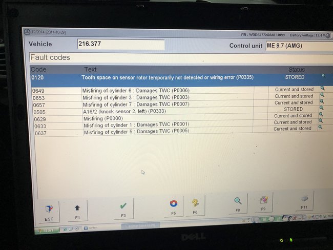

Runs better with new plugs but still the noise and stalls. Gotten the xentry software and it keeps giving different misfires every time I delete them. But always a knock sensor bank 2.

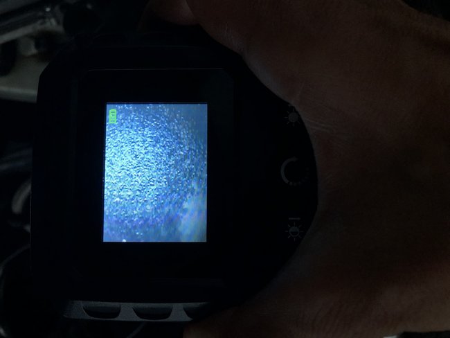

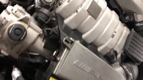

I noticed the sound around the intake and that the front part was so hot even when the motor wasn't very warm.
Jun 28, 2021 at 11:17 PM
I looked through the post and did not see the knock sensor code. So if you have had that the entire time, what is the actual code?
More than likely that is a result of the serious knock that you have but if the sensor is faulty then it is not going to sense the knock and try to adjust for it. However, knock sensors are meant for detonation and not engine knocks like this so even if the sensor is an issue, I doubt that is going to go away.
I suspect that is a spun bearing and if you are feeling heat on the intake then I suspect there is either metal to metal causing heat or valves allowing combustion back into the intake due to them not sealing.
Jun 29, 2021 at 12:18 PM
DIVIDES
  • 903 POSTS
No just recently seen it.
Jun 29, 2021 at 12:55 PM
Okay. That code is stored while the others are all current/active. So that means it may have seen an issue but that is not causing this issue.

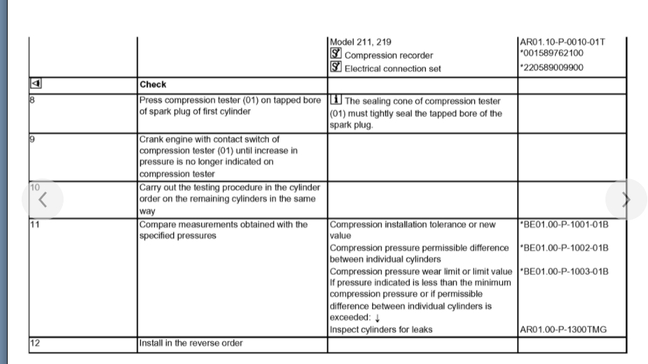

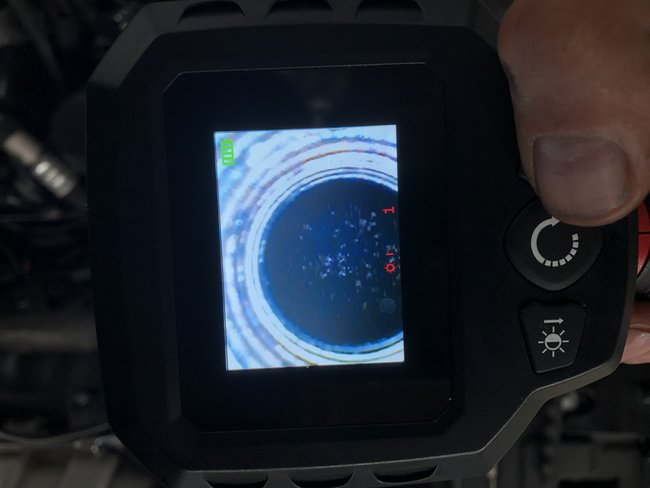

Just circling back on the compression check, did you ever check compression, at least on the cylinders that are misfiring? Have you drained the oil and checked for metal? Also, have you checked it again since it has been running for coolant again? I know you said it had coolant in the oil when you bought it.
I know we had an issue with the relay but you should be able to do what is called a clear flood and crank the engine and it not start for when you check the compression. This is where you hold the accelerator wide open while you are cranking the engine.
This will cut the injector pulse so that the engine doesn't start. Basically you are telling the PCM that the engine is flooded and you don't want any more fuel so that it doesn't hydrolock.
Clearly try this first just to be sure it works because while I show this in the manual, we have had enough issues with this that I wouldn't want have this be incorrect as well.

No not even with the pedal down it will eventually start. I didn't say there was coolant in the oil, there is no mixing and the oil is very clean, coolant is full and clean. Someone suggested the adjusters but am familiar with adjusters noise and it's usually on startups bit the noise is away from the front of the cams. I didn't do any compression tests cause it would still start and am afraid the values won't be correct.
Jun 30, 2021 at 12:39 PM
Okay. Here is the process from the manual. It just tells you to remove all the coils and plugs which will clearly prevent the start and vent the cylinders so any fuel will evaporate quickly.
