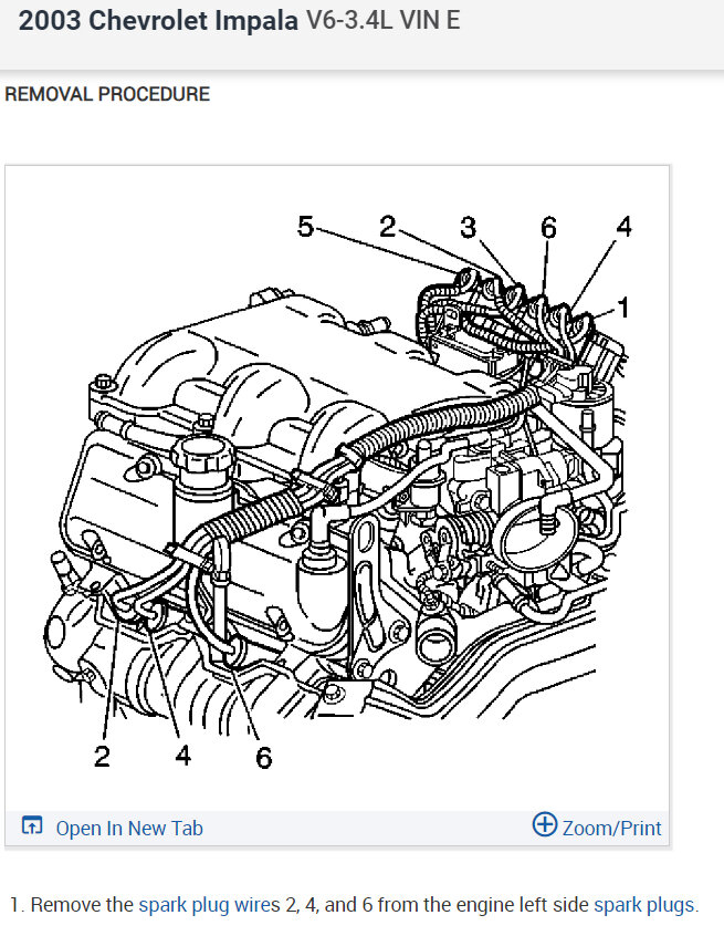

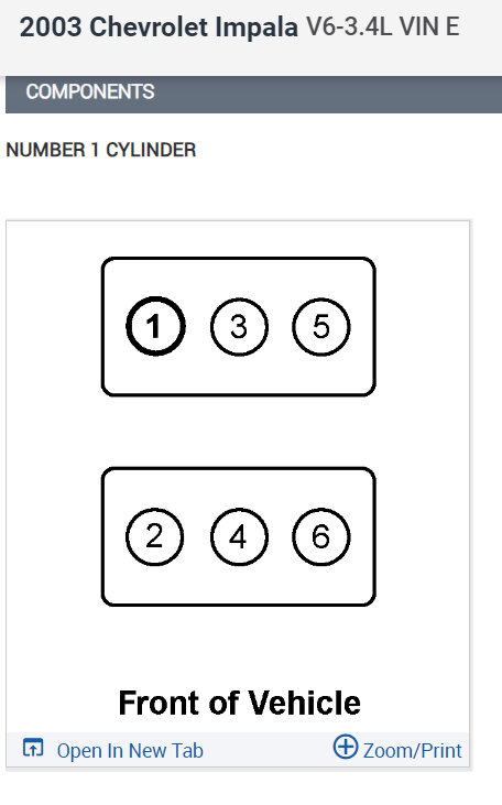

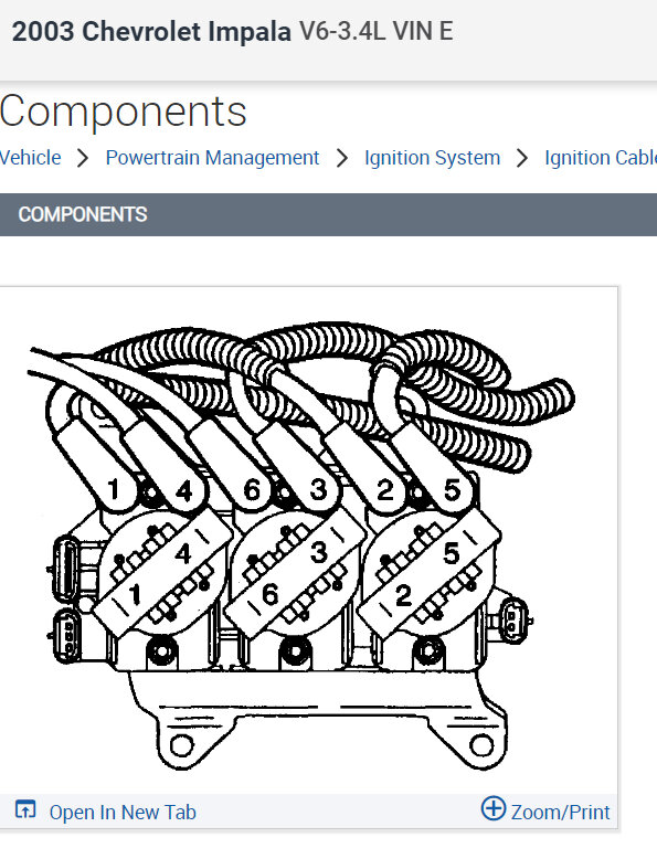

I need to know how to route the spark plug wires, I didn't remove them and have been looking everywhere for a schematic to no avail.
Oct 22, 2024 at 12:42 AM
  • 55,688 POSTS
Sure, here is the engine ignition system firing order.
Firing Order .................... 1-2-3-4-5-6
Check out the images (below). Let us know if you need anything else.
Oct 22, 2024 at 4:15 AM
Suggested Repair
Route the spark plug wires using firing order 1-2-3-4-5-6 and the ignition system diagram.
