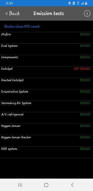

It all started when I changed the o2 sensor right after I changed spark plugs. I bought the van a couple months ago and have been doing a ton of preventive maintenance, so I was trying to get ahead of it.
Soon as I got on the road it started misfiring, usually when I accelerate after stopping. Just bucks like gas isn't reaching properly.

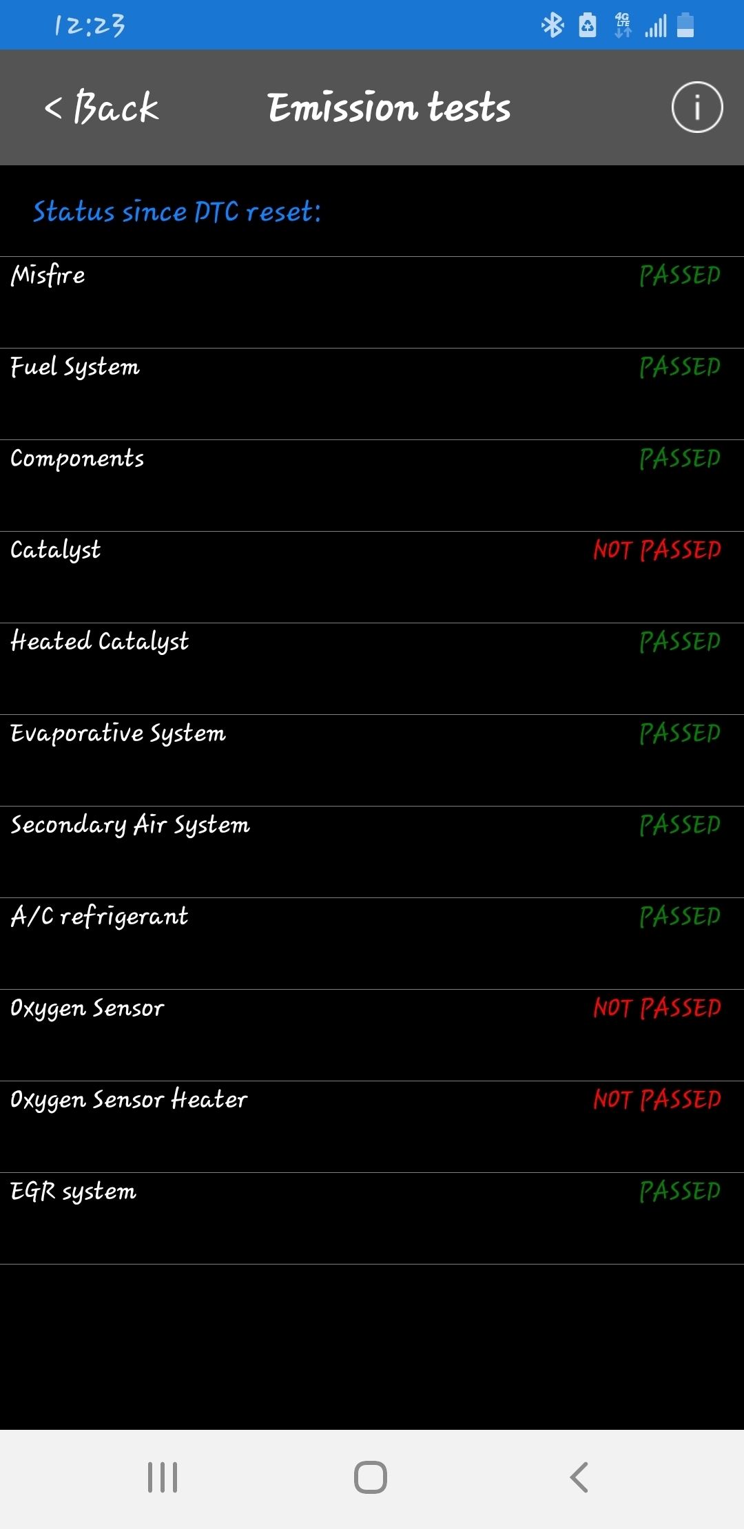

Since there were no codes, I ran my emission test on the OBD scanner and both bank 1 sensor and catalyst came back failed. Thought I had a faulty sensor or something, so I popped the old one back in. Nothing changed. Long story short, a new catalytic converter along with a new sensor fixed nothing. It occurs to me only then that the spark plugs may be to blame. Sure enough 2 of them were already burned after driving about 10 miles. Replaced all of them again and after thinking I was good for about a mile, it started again. This time it even turned off at a stop sign though started right back up. I'd never lost total power before.
I did NOT have any of these issues before the new spark plugs and sensor. Now I'm in quite a bit of money and the spark plug wires are my last guess. The boots were really hard to get off during the first change and I'm wondering if they could be damaged from getting them out and damaging new plugs? They don't have any obvious damage but I don't have experience with this. Also, I ran emissions again after driving with new catalytic and sensor (o2 passed but catalyst still failed). Plugs are all gapped properly and correct for the van. Any advice would be greatly appreciated!

Hey Joe, thanks for the quick reply! The thing is it's not throwing any codes. Not one. But it's jerking like crazy when I drive. The only thing that's been consistent is the catalyst "failed" when I run the emissions test. Also, when I look at the live data the short-term fuel shows gaps. Today was the first time it shut off altogether after I put the 2nd set of plugs in. Don't I have to spray some water to test for wire failure? Idk, saw it on YouTube. Thanks!

I'm definitely going to do the water test and let you know. I have no codes at all though on the converter. When I run codes, none are found but when I run emissions, I get that catalyst failed. But that's it. I had that same feeling about the wires today, so I double checked all the routing from the distributor to each cylinder to be sure and they were all correct.

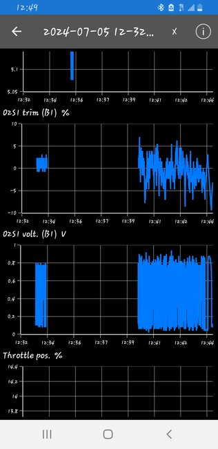

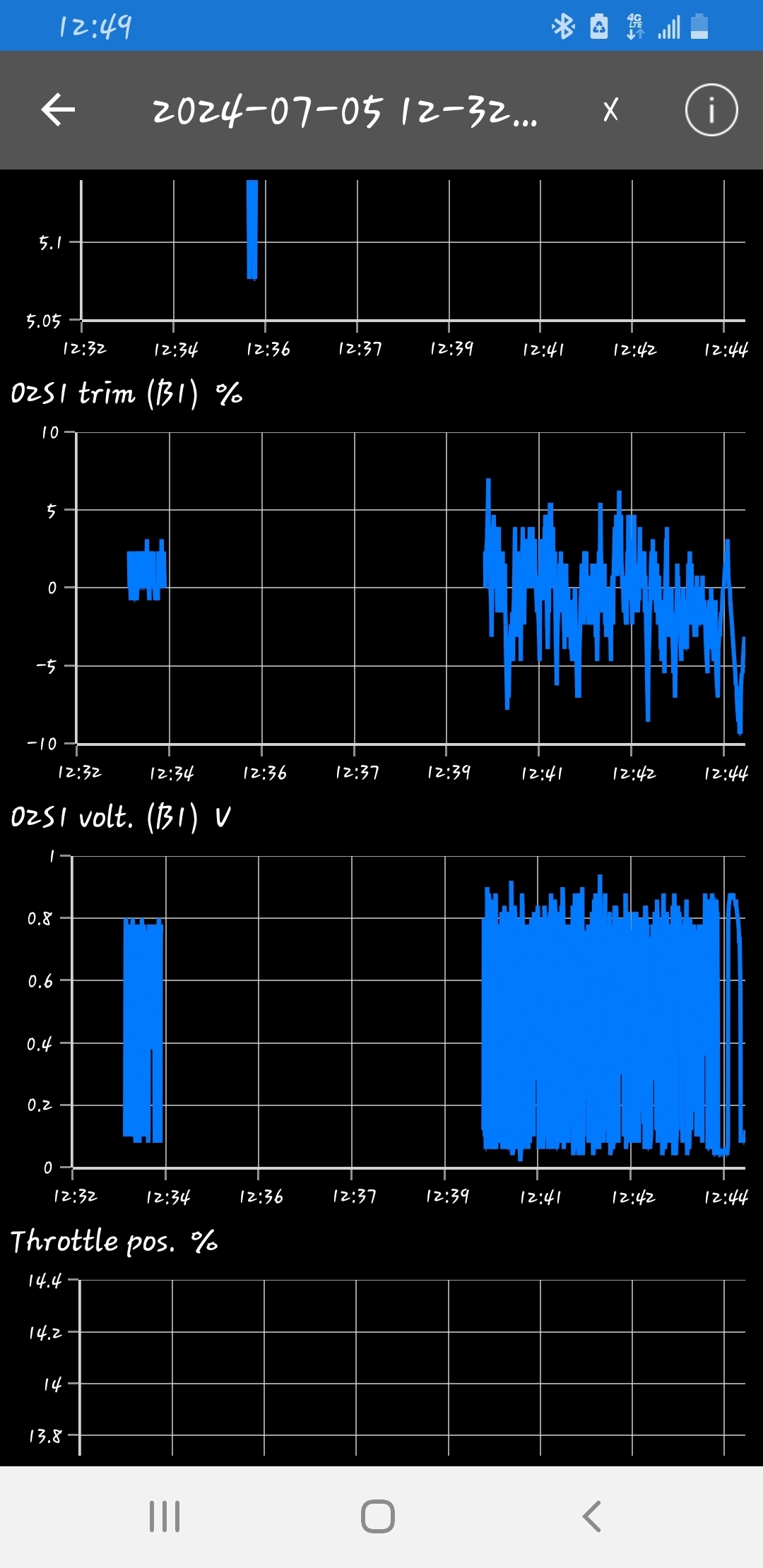

Have more info today (I think). Changed the wires which seemed to stop it from misfiring as frequently but still definitely doing it. Then I ran emissions and a freeze frame this time and got error p0000c8. But also my sensor and catalyst failed this time. I did disconnect the battery when changing the wires but it should still be reading from last computer read? I'm just so confused. Are all these things related to one another? Just seems like it all started with that o2 sensor and plug change. Again, its misfiring much less with the new plugs but still doing it so I'm kind of at the end of my expertise here. Any thoughts?

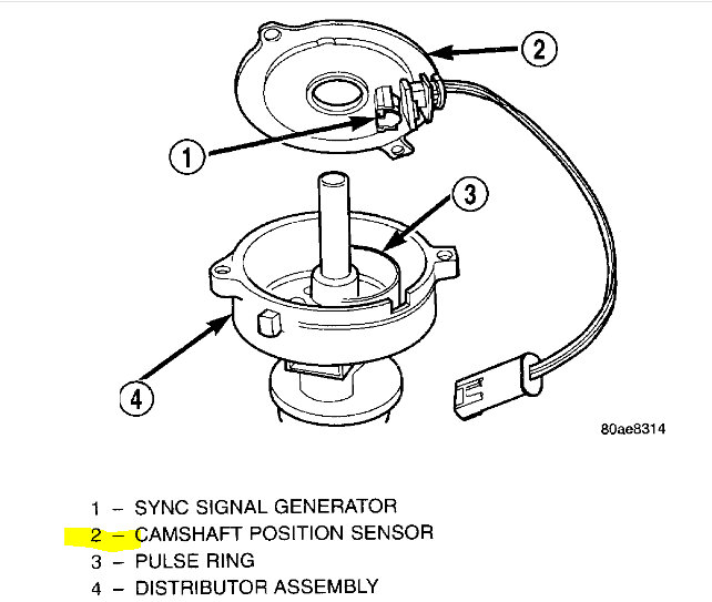

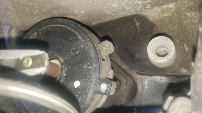

I don't hear any kind of odd noises coming from the engine whatsoever. Is there any chance it could be camshaft position sensor?
Jul 7, 2024 at 2:24 PM
  • 110,194 POSTS

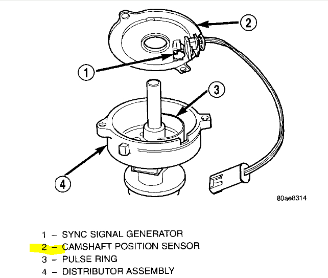

Anything is certainly possible. On this engine, the camshaft position sensor is located in the distributor housing. I attached a picture below showing it.
I do have another question. I just want to confirm the code you gave me. Is it a P0008?
See pic below.
Jul 7, 2024 at 9:47 PM

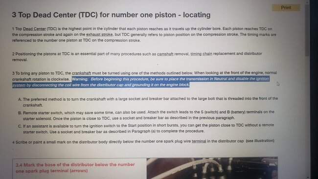

Hey Joe! I had a quick question about what's highlighted in the picture I attached. This is the first time I've seen this requirement in all the repair info I've researched and just wanted to run it by you and see if this was crucial? I've not seen anyone do this finding TDC but it's in my manual. Any thoughts?
Jul 10, 2024 at 1:59 PM
  • 110,194 POSTS
If I had to guess, they added that to protect themselves. LOL I don't see any specific reason that would be listed unless they worried you would start it while working.

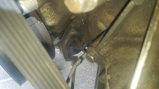

Hope the week is treating you well! I wanted to run these pics by you regarding TDC. My damper seems to make this easy, but my real question is can I be sure this is the compression stroke? Everything seems to line up including my distributor rotor on cylinder 1 (which is a little confusing because should this be off if I jumped timing?) Can you let me know your thoughts before I take the belt off and water pump and begin attacking this thing? As always, so much appreciated!
Jul 17, 2024 at 3:39 PM
  • 110,194 POSTS
The timing appears to be correct. Does the belt seem tight? In other words, does there seem to be enough tension and what is the condition of the belt? It could be stretched.

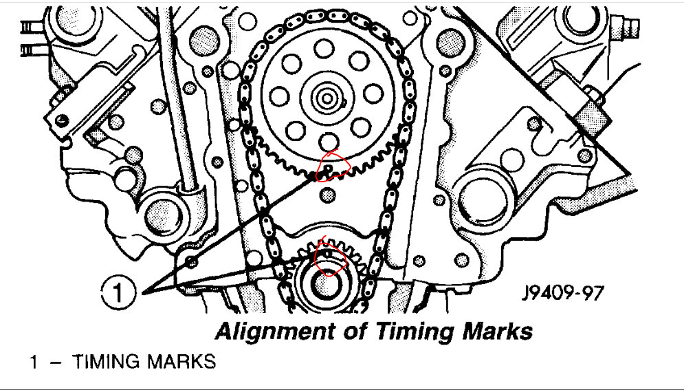

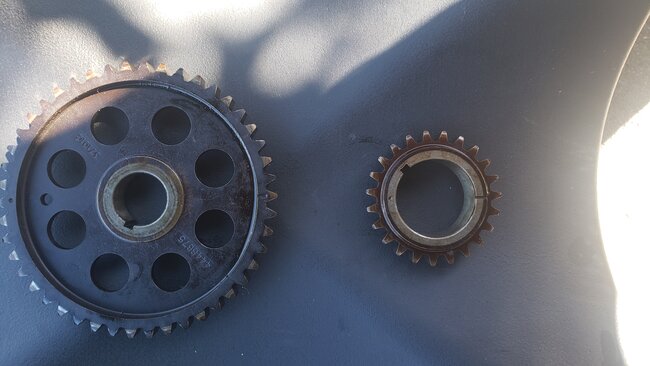

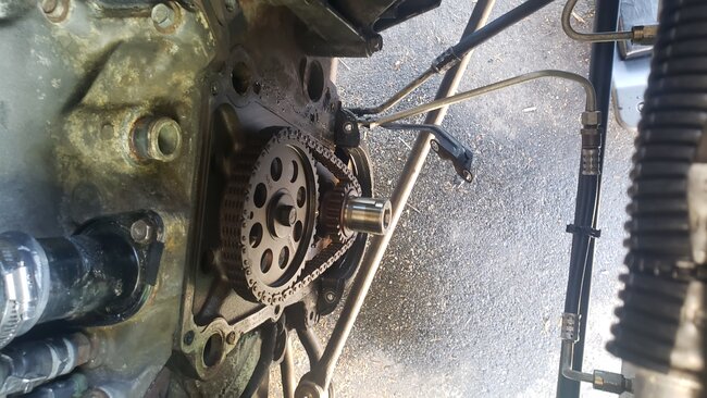

Joe! Check this picture out. This is how it was aligned before I took the chain off. Confused because of the timing marks. The dots vs the slits look opposite to one another. What do you think?
Jul 23, 2024 at 4:07 PM
  • 110,194 POSTS
Actually, the two dots should be pointing at each other. In this case, the cam gear is correct if the engine wasn't on a compression stroke. See pic below.
Was there play in the chain or anything that seemed out of the ordinary?
See pic below.

The chain definitely had play. I have a new chain but can you clarify it's not correct right? See the dot on the cam gear is at 12 o'clock and so is the crank. But on this cam gear there's a dot and a slit. Only the cam gear slit is aligned with the crankshaft sprocket dot. So is my camgear completely turned around? There's a groove thats only going to allow me to install the same exact way and the dots would both be at 12 o'clock. My understanding is the cam should be at 6 o'clock. If my camshaft is completely turned around what would that indicate?

Sure, I'll upload again. Because of the notches in the cam gear and crankshaft I would have to install the new one exactly the same way with both dots at 12 o'clock.
Jul 25, 2024 at 12:48 PM
  • 54,832 POSTS
Sorry about that, yep, the dots are the marks you want to use. I don't know why they would have lines on there.
Jul 26, 2024 at 12:42 PM
AVALONIYEM2024
  • 20 POSTS
Yeah, the new cam doesn't have a line. So, should I rotate the camshaft then? That seems to be the only way to get the dots facing each other. Thanks for your reply!
Jul 26, 2024 at 1:22 PM
  • 110,194 POSTS
Yes, turn it until the dots align as seen in the pic above. Once to that point, the number 1 piston should be at TDC and if you can see the cylinder 1 valves or cam, the valves should be the furthest away from opening.
