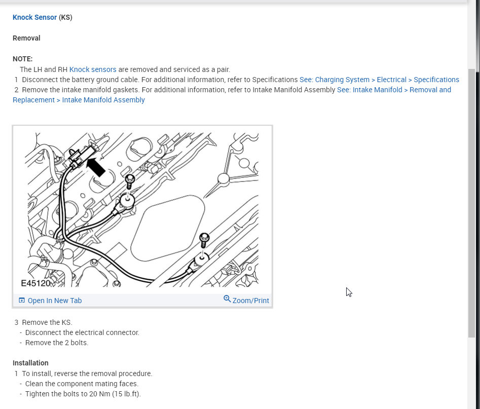

Also a knock sensor code p0322 or p0332 can't remember.
Do these have carbon build up issue as being common? Could a knock sensor cause it to misfire?
Sep 27, 2020 at 3:10 PM
I attached the info on this sensor. This code is for bank 2 and yes. This code can cause a misfire because it is there to detect when an engine starts to detonate and it adjusts the air fuel to compensate for it. If this is not happening then the vehicle may misfire.
Let's address this code first and then tackle the misfires if they are still there.
