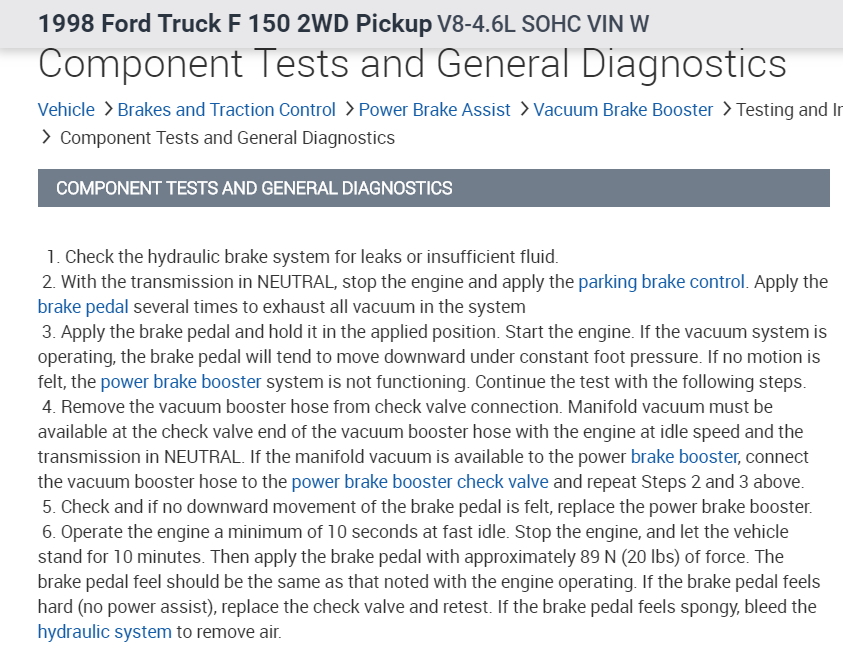

Thank u for getting back to me. I did not find any vacuum lines leaking after I inspected them. I also did the carb cleaner test nothing there either. But my brakes r spongy so I bleed them. It ran better when I drove it to test the brakes. But the next morning it ran rough again and my brakes where spongy again. With the truck running I can mash the brake pedal and it holds for a second the gradually goes all the way to the floor. Could it be the master cylinder or the booster gone bad? Please let me know what u think. An again thanks for your help.

Absolutely, this could a problem with the Power Brake Booster on your vehicle, which requires engine vacuum to operate properly. In the diagrams down below I have included the instructions from the vehicle manufacturer on how to inspect and test your vehicle's Power Brake Booster for proper operation. Please go through this guide and get back to us with what you are able to find out.

Thank you for your help. It was the booster. Truck is running great.
